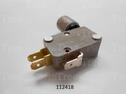

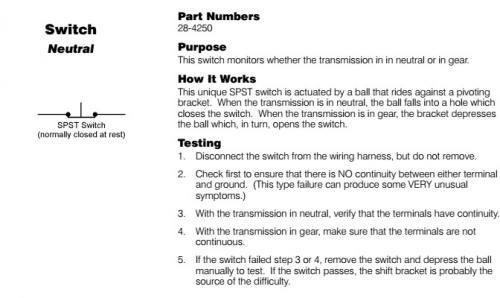

    Clutch pedal and neutral switch taken from #492-4207 Electrical Service Manual
    Also used as a pto switch on some models
    Plastic 2-wire slide-on connector 106024 less terminals used 1977-1980 - nla
    Plastic 2-wire slide-on connector 106771 less terminals used 1980-1983 - still available from Toro
    9/16-18 threads on 102277 mounting nut
    82-12o502* - Correct
    82 -12o502 - Not correct
    82-12o502 - Suspicious and not checked or determined yet
    105877 replaced by 38-0430 after tractor production. Ball switch NO=Normally open - Nail head terminals for a slide on Packard connector. Some illustrations show a switch with flat spade terminals.
    38-0430 also replaces 40-7410, 40-7440 and 517281 - No record of where these were used.

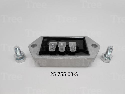

  2. Free
    15 amp 2-wire voltage regulator 109313
    Smaller unit with 2-wire leads - 15 amp - One AC lead from stator jumpered to the DC+ terminal
    109313 used 1982-1984
    1982 models 01-08K803, 01-10K803, 01-12K803, 01-14KE03, 01-17K803, 01-17KE02
    1983 models 01-14KE04, 01-17KE03, 11-08K801, 11-10K801, 11-12K801, 11-17K801
    1984 models 11-10K802, 11-12K802, 11-14KE01, 11-16K801, 11-17KE01

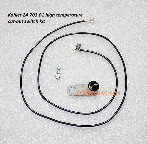

  3. Free
    Found on the crankshaft illustrated parts page for the 269-H model 72102.
    In the parts list but not illustrated
    Could be wired to the magneto ignition wire to shut of the ignition by grounding it with an over-heat condition.
    Some of the 72102 tractor diagrams show a high temp light in the dash but no sensor at the engine. May be considered part of the Kohler wiring harness. When over-heated would provide a ground for the dash temperature light.
    24 703 01 used on
    1996-1998 269-H model 72102 with 6-bulb module with one being hot lamp
    1997-1998 267-H model 72085 with 4-bulb module with no hot lamp
    1997-1998 267-H model 72104 - Export model 267-He with 4-bulb module with no hot lamp
    1999 268-H model 72086 with 4-bulb module with no hot lamp
    1999 268-H model 72105 - Export model 268-He with 4-bulb module with no hot lamp
    2000-2002 268-H model 72087 with 4-bulb module with no hot lamp

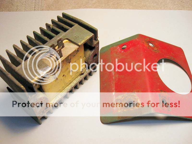

  4. Free
    Regulator Rectifier Kohler Autopsy from OLD Redsquare forum.pdf
    Regulator Rectifier repair tutorial by save_old_iron
    91 pages and a good read by SOI
    501 downloads
    Updated

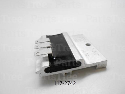

  5. Free
    Taken from #492-4509 Electrical Manual
    NN10261, 57-9430 replaced by 117-2742 20 amp Onan  Regulator/Rectifier
    150 downloads
    Updated

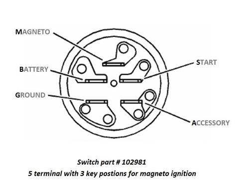

    Switch Ignition Magneto Keyed 102981 List.pdf
    Switch rotated to place single terminal at the top
    1 page 95KB
    Magneto ignition with electric start 102981 switch used on 2-0230 with a solenoid
    (Threads 5/8"-32 switch)
    5-terminal 3-position
    Used on the model 2-0230 only. Switch listed in 1969-73 Lawn Ranger ipl
    Switch also listed for the Dixie Chopper which is where the diagram came from. Diagram included to show how switch was used.

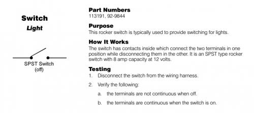

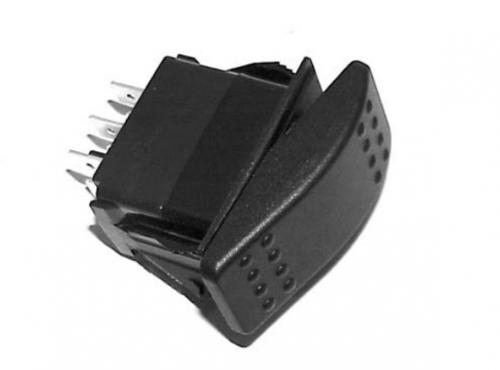

    Taken from the #492-4509 Electrical Manual
    107-9238 replacement after tractor production
    113191, 92-9844 replaced by 107-9238 rocker switch
    113191 rocker light switch used on

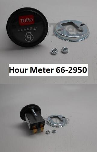

    Taken from Demystification Guide #492-4509
    1 page 101KB
    Gage Hourmeter
    Taken from Demystification Guide #492-4761
    Hour meter 2002-2003 description
    Operating voltage 12 volts +/- 20% = 9.6 volts to 14.4 volts
    103717 Round Hour Meter used on - (replaced by 108767)

    12-9990 Round Hour Meter - (replaced by 66-2950) - Toro Groundsmaster used 1983-1991
    12-8130 Round Hour Meter - (replaced by 66-2950) - Toro Groundsmaster used 1991-1992
    30-3190 Round Hour Meter - (replaced by 66-2950) - No record of use
    30-3200 Round Hour Meter - (replaced by 66-2950) - No record of use
    66-2950 Round Hour Meter used on - (Still available January 22, 2021)

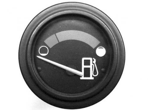

    Taken from #492-4761 Electrical manual
    Gage Fuel 2002-2003 description
    113466 Fuel Dash Gauge used on

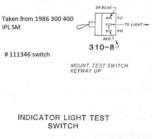

    Taken from 1986 300-Series IPL SM Wiring
    Indicator light test switch 111346 used on
    28-4250 neutral ball switch used on
    1977 models 57300, 57351
    1978 models 57300, 57305, 57356, 57360
    1979 models 57356, 57375
    1980 models 57300, 57356, 57360, 57375
    1981 models 57356, 57357
    1982 models 56125, 57300, 57356, 57357, 57360
    1983 models 56125, 56138, 56145, 56155, 57300, 57356, 57357, 57360
    1984 models 56125, 56138, 56145, 56155
    1985 models 56125, 56138, 56145, 56170
    1986 models 56125, 56138, 56145, 56150, 56155, 56170
    1987 models 56125, 56138, 56145, 56150, 56155, 56170
    1988 models 56127, 56150, 56175
    1989 models 55600, 55620, 56123, 56127, 56128, 56150, 56175
    1990 models 55660, 55670, 56123, 56128, 56145, 56165, 56175
    1991 models 56132, 56133, 56176, 56177, 56185, 56190, 56195
    1992 models 56132, 56133, 56177, 56185, 56190, 56195

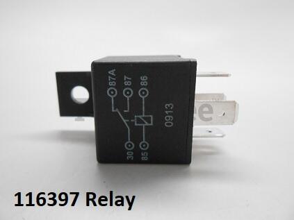

    116397 relay used 1989-1998 and replaces 116379 and 48-4700
    116379 relay used 1992-1993 and most likely a typo for 116397
    48-4700 relay used 1994-1998
    106833 3-terminal relay replaced by a 5 terminal substitute in production because of a parts shortage.
    These were replaced by SA121378 service assembly which was replaced by 99-5365 kit.
    The 99-5365 kit contained a 48-4700 relay which has been replaced by 116397 relay.
    116397 relay used on 1990 300-Series for the low oil starter circuit and 1990 200-Series, 400-Series and 500-Series as a starter relay.
    Picture only jpg
    1 page 10KB
    82-12o502* - Correct and tractor series
    116397 Start relay used on
    1989 model Y1 -16OE01
    1990 models 31 -10K801, 31 -12K801, 31 -12KE01, 31-16O802*400, 32 -10B501, 32 -10BE01, 32-12O501*200, 32-12OE01*200, 32-16BE01, 41-16OE01*400, 41-20O801*500, 41-20OE01*500, R1 -12K802, R1-16O802*300, R1-18OE02*500, Y1-12OE01*Z, Y1-16OE02*Z, Z1-24OE03*Z
    1991 models 22-14O501*200, 22-14OE01*200, 31 -10K802, 31 -12K802, 31-16O803*400, 32-10B502*200, 32-10BE02*200, 32-1205A1*200, 32-12OEA1*200, 32-12O502*200, 32-12OE02*200, 41-20OE02*500, 51 -12KE01, 51-16OE01*400, R2-12O501*200, R2-12OE01*200, S2-12B502*200, Y1-12OE02*Z, Y1-16OE03*Z, Y1-20OE02*Z, Z1-27OE04*Z
    1992 models 22-14O502, 22-14OE02, 31-10K803, 31-10K804, 31-16O804, 32-10B503, 32-10BE03, 32-12O503, 32-10OE03, 41-20OE03, 42-16BE01, 51-12KE02, 51-16OE02, R1-12K804, R1-16O804, R1-20OE02*, R2-12O502, R2-12OE02, R2-16BE01, Y1-16OE04*Z, Y1-16OEE4*Z, Y1-20OE03*Z, Z1-24OE05*Z
    ------------------------------------------Models below may not use this start relay----------------------------------------------
    1993 models 70040, 70042, 70060, 70080, 70120, 70140, 71140, 71180, 71181, 71200, 71202, 71203, 72040, 72041, 72060, 72081, 72101, 73320, 73380, 73400, 73401, 73420, 73421, 73440, 73501, 73520*, 74021, 74041, 74101, 74140
    1994 models 71182, 71184, 71191, 71200, 71202, 71213, 72042, 72043, 72062, 72063, 72083, 72103, 73362, 73380, 73400, 73401, 73420, 73421, 73440, 73501, 73520, 74021, 74041, 74101, 74120
    1995 models 71182, 71184 x 2, 71191 x 2, 71192, 71200, x 2, 71202, 71205, 71213 x 2, 71216, 72042 x 2, 72043 x 2, 72062 x 2, 72063 x 2, 72084, 72103 x 2, 73362, 73400, 73401 x 2, 73420 x 3, 73421 x 2, 73440 x 2, 73501 x 4, 73520 x 2, 74021, 74101, 74120
    1996 models 70060, 70081, 70131, 70142, 70183, 71182, 71184, 71185, 71188, 71191, 71192, 71193, 71196, 71201, 71205, 71217, 71218, 72042, 72043, 72045, 72046, 72062, 72064, 72084, 72085, 72102, 72104, 72110, 73362, 73363, 73400, 73401, 73402, 73403, 73420, 73421, 73422, 73423, 73441, 73501, 73502, 73521
    1997 models 70060, 70081, 70131, 70142, 70183, 71185, 71188, 71189, 71190, 71193, 71196, 71201, 71205, 71208, 71215, 71217, 71218, 71219, 72045, 72046, 72064, 72085, 72102, 72104, 72110, 73363, 73402, 73403, 73422, 73423, 73441, 73502, 73521
    1998 models 70041, 70060, 70082, 70084, 71185, 71188, 71189, 71190, 71196, 71201, 71208, 71215, 71218, 71219, 72045, 72045, 72046 x 2, 72064 x 2, 72085 x 2, 72102 x 2, 72104 x 2, 72110 x 2, 73428 x 2, 73448 x 2
    116379 Relay most likely a typo
    1992 model R1-20OE02 (Original parts list shows 116397 so a typo was made somewhere)
    1993 model 73520 (Original parts list shows 116397 so a typo was made somewhere)
    48-4700 Relay used on
    1994 models 70040, 70060, 70100, 70141, 74140
    1995 models 70040, 70060, 70141, 70142, 74140
    1996 model 70040
    1997 model 70040 x 2
    1998 model 70040
    77 downloads

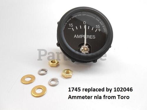

    Wheel Horse ammeter 1745  used 1961-1969
    replaced by 102046 used 1973-1984
    Screen shot
    1 page 56KB
    1745 Ammeter used on
    1961 model 701
    1962 models 32E Lawn Ranger, 552, 702
    1963 models 33E Lawn Ranger, 653, 753
    1964 models 854
    1969 model 1-7441 GT-14
    102046 Ammeter used on
    1973 models 1-0340, 1-0350, 1-0355, 1-0360, 1-0365, 1-0370, 1-0430, 1-0435, 1-0440, 1-0460, 1-0465, 1-0470, 1-0475, 1-0600, 1-0601, 1-0610, 1-0620
    1974 models 1-0353, 1-0354, 1-0356, 1-0380, 1-0385, 1-0390, 1-0480, 1-0485, 1-0490, 1-0495, 1-0510, 1-0611, 1-0630, 1-0650
    1975 models 1-0357, 1-0375, 1-0381, 1-0391, 1-0395, 1-0396, 1-0481, 1-0491, 1-0511, 1-0612, 1-0631, 1-0651
    1976 models 61-08K801, 61-08K802, 61-08K803, 61-08K804, 61-10K801, 61-10K802, 61-10K803, 61-10K804, 61-12K801, 61-12K802, 61-12K803, 61-12K804, 61-16K801, 61-16K802, 61-16K803, 61-12KS01, 61-12KS02, 61-12KS03, 61-12KS04, 61-16KS01, 61-16KS02, 61-16KS03, 61-16KS04, 61-16OS01, 61-16OS02, 61-20KS01, 61-20KS02
    1977 models 71-08K801, 71-10K801, 71-12K801*, 71-16K801, 71-16K802, 71-12KS01, 71-12KS02, 71-16KS01, 71-16KS02, 71-16OS01, 71-20KS01
    1978 models 81-08K801, 81-10K801, 81-12K801, 81-14K801, 81-16B81, 81-16K801, 81-12KS01, 81-14KS01, 81-16BS01, 81-16KS01, 81-16OS01, 81-20KS01,
    1979 models 91-08K801, 91-08K802, 91-10K801, 91-10K802, 91-11B801, 91-12K801, 91-12K802, 91-14K801, 91-14K802, 91-16B801, 91-16B802, 91-16K801, 91-12KS01, 91-14KS01, 91-16BS01, 91-16BS02, 91-16KS01, 91-16OS01, 91-20KS01, 91-20KS02
    1980 models 01-08K801, 01-10K801, 01-12K801, 01-14K801, 01-16K801, 01-17K801, 01-12KE01, 01-12KS01, 01-14KE01, 01-14KS01, 01-16KE01, 01-16KS01, 01-16OS01, 01-17KE01, 01-17KS02, 01-20KS00
    1981 models 01-08K802, 01-10K802, 01-12K802, 01-14K802, 01-16K802, 01-17K802, 01-12KE02, 01-14KE02, 01-16KE02, 01-17KE01, 01-20KS00
    1982 models 01-08K803, 01-10K803, 01-11BH01, 01-12K803, 01-16KH01*, 01-17K803, 01-14KE03, 01-17KE02, 01-19KE01
    Description and testing
    Rocker light switch 94-1742 used on
    1996 models 72102, 72110
    1997 models 72102, 72110
    1998 models 72102 x 2, 72110 x 2
    1999 models 72106, 72115
    2000 models 72108, 72116
    2001 models 72108, 72116
    2002 models 72108, 72116
    2003 models 72116, 72202
    2004 models 72202, 72212
    2005 models 72202, 72212
    2006 model 72212

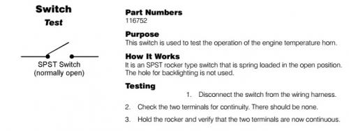

    116752 rocker test switch used on

    Regulator Rectifier Kohler 15 amp small KH10215
    Regulator Rectifier Small 15 amp
    KH10215 replaced by 4140305 replaced by 2575503 replaced by 2575503S
    Kohler 3-wire connector body 25 155 41-S
    1 page 166KB from Demystification Guide #492-4509
    Rotated switch to place single terminal at the top
    1 page 142KB
    How to troubleshoot
    23-0660 switch for magneto ignition
    5-terminal 3-position key switch
    This switch requires a starter solenoid
    Tractor Switch Ignition Magneto ignition with electric start 23-0660
    (Threads 5/8"-32) 5-terminal switch replaces 63-5630
    23-0660 5-terminal available 08/08 $23.53 from RCPW Stens replacement 430-538
    Used 1974 thru 2007
    Magneto ignition switch 63-5630 used on
    1988 models 56138, 56145, 56150, 56175,
    1989 models 56145, 56150, 56175
    1990 models 56145, 56165, 56175
    1991 models 56176, 56177, 56185, 56195
    1992 models 56177, 56185, 56195
    Magneto ignition switch 23-0660 used on
    1988 models 21738, 38095, 38155, 38160, 57300, 57356, 57357, 57360
