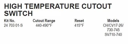

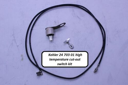

Found on the crankshaft illustrated parts page for the 269-H model 72102.
In the parts list but not illustrated
Could be wired to the magneto ignition wire to shut of the ignition by grounding it with an over-heat condition.
Some of the 72102 tractor diagrams show a high temp light in the dash but no sensor at the engine. May be considered part of the Kohler wiring harness. When over-heated would provide a ground for the dash temperature light.
24 703 01 used on
1996-1998 269-H model 72102 with 6-bulb module with one being hot lamp
1997-1998 267-H model 72085 with 4-bulb module with no hot lamp
1997-1998 267-H model 72104 - Export model 267-He with 4-bulb module with no hot lamp
1999 268-H model 72086 with 4-bulb module with no hot lamp
1999 268-H model 72105 - Export model 268-He with 4-bulb module with no hot lamp
2000-2002 268-H model 72087 with 4-bulb module with no hot lamp
