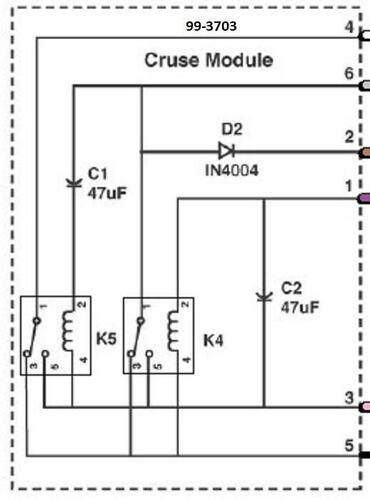

    Cruise module 95-3029 used in 1998 only on 5xi models
    1998 models 73470, 73540, 73541, 73545, 73546, 73550, 73551, 73560
    Cruise module 99-3703
    Found in manual 492-4761 for 5xi
    Used on 5xi models
    Internal wiring
    1 page
    Used on
    1999 models 73471, 73542, 73547, 73552, 73561, 73570, 73580, 73590
    2000 models 73471 x 2, 73542 x 2, 73547, 73552, 73561 x 2, 73561SEI, 73570, 73580, 73590
    2001 models  73471, 73542, 73547, 73561, 73580, 73590
    2002 models 73542, 73561, 73570, 73590
    2003 models 73542, 73561, 73570, 73590
    2004 models 73542, 73561, 73590
    2005 model 73561
    282 downloads

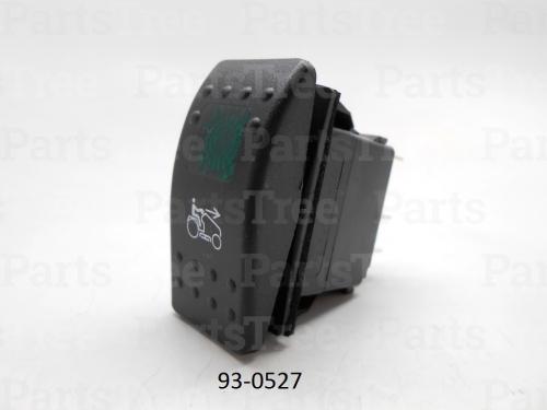

    Taken from #492-4761 Electrical Manual
    93-0527 cruise control switch
    94-7602 cruise control switch
    69 downloads

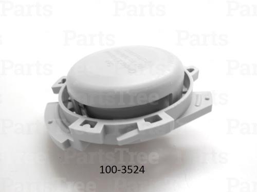

    Taken from #492-4761 Electrical manual
    Seat switch used 2001 and later description
    100-3524 seat switch used on the
    2002 315-8 model 73450
    2004 71245
    96 downloads

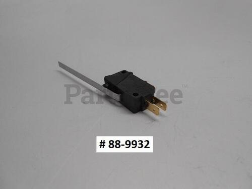

    82-12o502* - Correct
    82 -12o502 - Not correct
    82-12o502 - Suspicious and not checked or determined yet
    88-9932 Micro Lever Switch used on

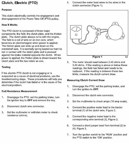

    Clutch Electric pto 94-2190 List.pdf
    Taken from Demystification Guide #492-9137
    2 pages 692KB
    Coil resistance should be 2.40 to 3.40 ohms.
    Current draw should be 3.5 amps or above.
    94-2190 electric pto used on
    2000 models 73471 x 2, 73542 x 2, 73547 x 2, 73552, 73561 x 3, 73561SEI, 73570, 73580, 73590
    2005 model 73561
    128 downloads
