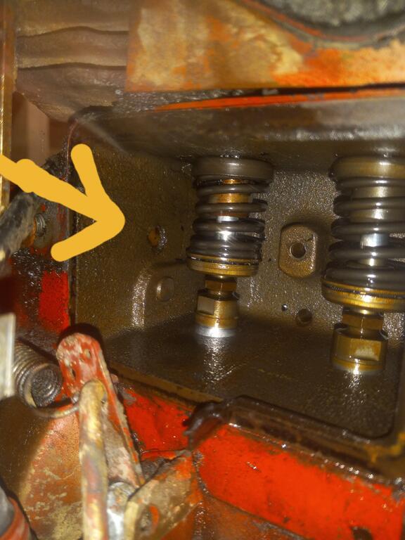

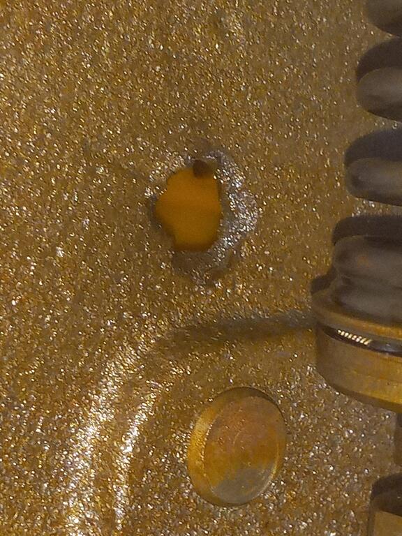

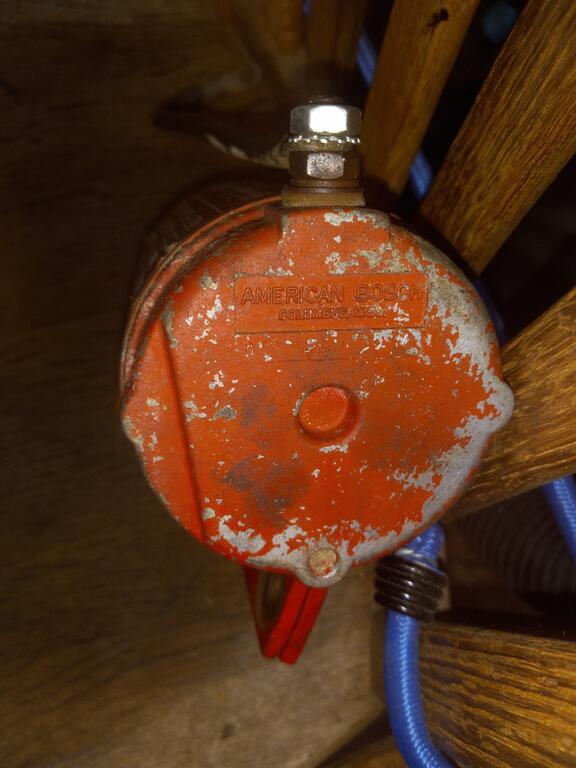

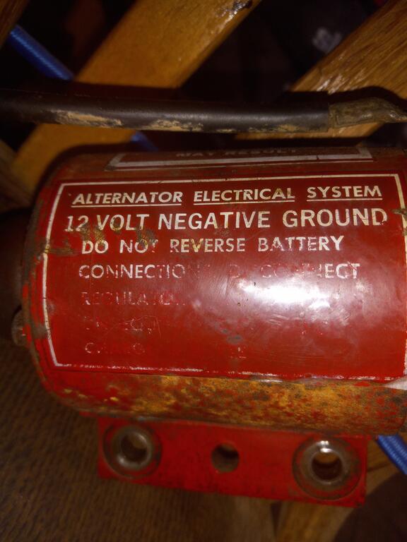

oliver2-44 11,628 #56 Posted July 6, 2022 On 7/4/2022 at 10:29 AM, Cee245 said: I did find and know to use OEM kohler carb kit. Every trustworthy person says they are worth it. Reminds me of my 90's F150's on how they like Motorcraft parts and not the cheap stuff or super expensive stuff. Anyway, not wanting to get the wrong starter rebuild kit, here are pics of my starter.... there is what I assume a date? of [1 10 1977] on the starter as well.. it also says American Bosch Columbus Miss. And I can't read anything else. I found bendix rebuild kits, but not sure which to get... I also see the kits WITHOUT the engagement sprocket thingy. That kit just has the internal stuff only. ALSO, in the bottom Pic, I opened the part to get to the valve adjustment, see where there is a hole? Does NOT look factory... there is a yellow color INSIDE the hole that the arrow is pointing to..... 👉 not sure what's up with that... The hole in the side of the valve adjustment area is normal. I suspect the whitish yellow your seeing is part of the plastic governor gear. Below is a thread on Starter repairs/rebuilds. I've bought some starter kohler repair parts from DB Electric and was pleased with them. 1 Share this post Link to post Share on other sites
953 nut 67,382 #57 Posted July 6, 2022 On 7/4/2022 at 11:29 AM, Cee245 said: n the bottom Pic, I opened the part to get to the valve adjustment, see where there is a hole? As the piston moves up and down in the cylinder it produces a pressure in the crank case. That hole allows the pulsation to be able to vent to the outside. Probably allows splash lubrication of the valves and lifters via the governor gear.. 2 Share this post Link to post Share on other sites
Cee245 857 #58 Posted July 7, 2022 @953 nut @oliver2-44 thanks, I figured something like that. I was just concerned as to why the hole is not perfectly round and looks jagged. 1 Share this post Link to post Share on other sites

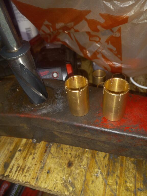

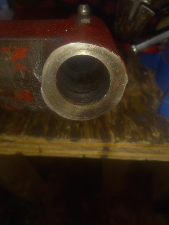

Cee245 857 #59 Posted July 17, 2022 (edited) Think this will work? I put a couple cuts in the bushing to allow grease to get around a touch better. Maybe it won't do anything.... maybe more cuts? Haven't installed yet... so I can decide later, while I wait for a couple more parts to come. Bushings are 1.5" and fit good. The length of the center hole on the axle is 3". I could use 1.25" bushings to give the grease a place to go, but i think they would sorta float on the pivot pin for the axle. Same for the spindles, except the length is a tad less than 3". I used a reamer to drill out from both ends to try to keep it true straight as possible doing it this way (with a hand drill).... Used a ton of cutting oil, but it worked well. Edited July 17, 2022 by Cee245 2 Share this post Link to post Share on other sites
