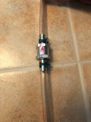

peter lena 10,016 #1 Posted February 21, 2022 this is the set up I use on my kohler magnum engines , the check valve is a 5/16 " size , fits snugly into a 1/4 " ID , clear fuel line , use the dark green small squeeze clamps , also use super lube or a light swipe of dielectric grease on the valve end stubs , make it slide / screw on exactly size to size . I put this together before installation , makes it easy , the arrow should be vertically in the up position , between fuel pump and carb . that will trap a fuel charge for quick starts , of course if your fuel pump is weak , that will not help . but this makes for instant starts , and very little choke , pete 6 Share this post Link to post Share on other sites

peter lena 10,016 #7 Posted February 21, 2022 (edited) @pfrederi very simple , the 3/8 OD of a clear fuel line , covers the I D of 1/4" snugly fitting a 5/16 fuel barb , no leaks no issues , have it on 3 engines , instant starts , no leaks , correct size spring clamps , put spring clamps on the line before sliding on the hose , then lineman's plyers to install , simple ,easy . thanks for the kind words , pete Edited February 21, 2022 by peter lena 2 Share this post Link to post Share on other sites

peter lena 10,016 #20 Posted February 27, 2022 @dmoore picture of the fuel check valve already in line , just cut it down to the same size of your fuel line from fuel pump to carb ,note the dark colored spring clamps , thats the size to size clamp you want . local h/w store. I put a very small amount of dielectric grease on the sides of the sliding hose barb fittings , that hose is size to size , 1/4 " ID . put clamps on hose ,slide them up out of the way . mount new hose/ valve set up , then just squeeze and slide them down to hose barb . make sure you have VALVE FLOW facing up to carb , ARROW UP . this consistently works . instant starts , for me . all 3 of my kohlers have this , just moved more snow , pete Share this post Link to post Share on other sites
peter lena 10,016 #21 Posted February 27, 2022 @dmoore top picture of this response , is my picture of check valve in fuel line set up , just cut it down to duplicate the original fuel line to carb length , and install it . title is FUEL CHECK VALVES , PETE 1 Share this post Link to post Share on other sites
