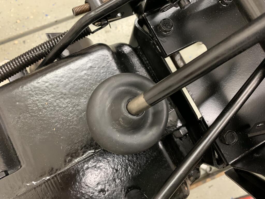

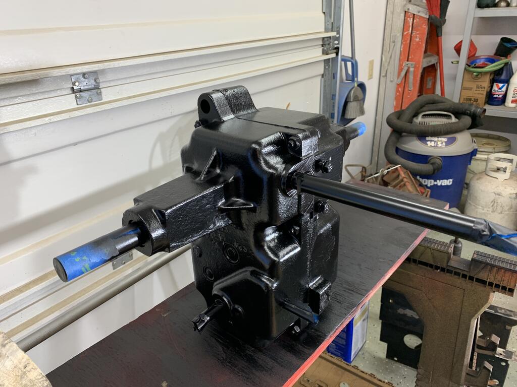

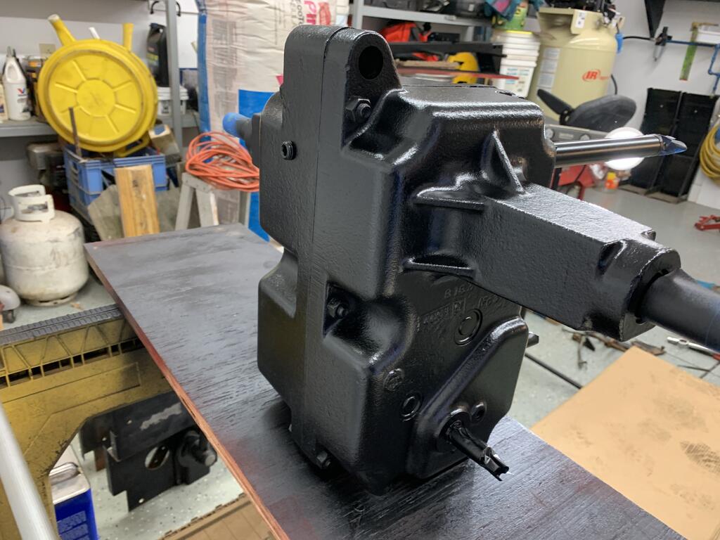

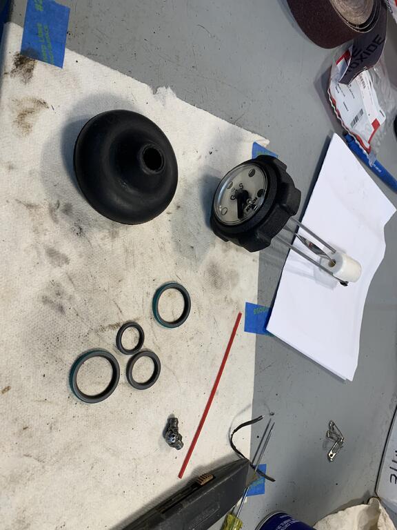

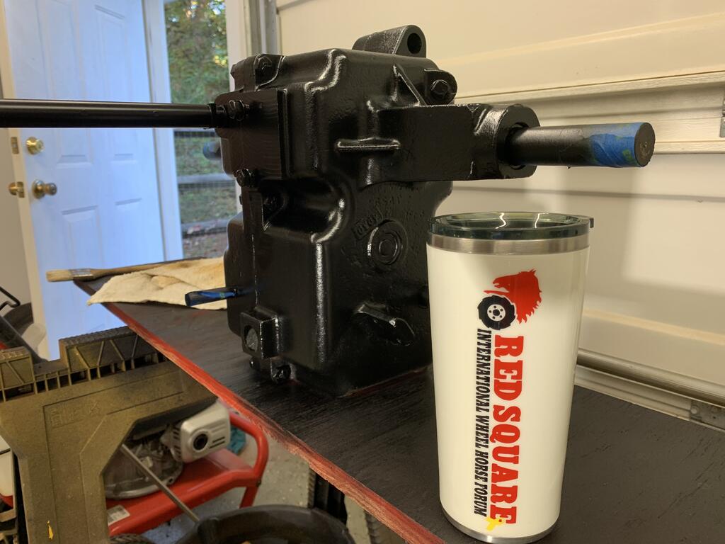

Horse Newbie 7,405 #15 Posted November 19, 2021 (edited) 21 hours ago, gwest_ca said: The engine was made in 1984 but the first year for the 312-8 was the 1985 model year. 1985 312-8 model 21-12K801 21 files on this model https://www.wheelhorseforum.com/search/?q=21-12k801&quick=1&type=downloads_file Look in these for your part numbers… 18 hours ago, moe1965 said: definatly going to need to replace all the trans seals any idea what seal part numbers I will need. I got my seals from Lowell at Wheel Horse Parts and More. Look in the Classifieds in this Forum, under vendors and you will find his site. I just bought seals tor an 1984 transmission and I believe the seals were : INPUT SHAFT SEAL # 100442 / 1461 (need 1 , but I would get at least 2 because I boogered 1 up trying to install, to me it was the hardest 1 to do ) BRAKE SHAFT SEAL ( need 1 ) # 100441 / 1303 AXLE SEALS ( need 2 ) # 100863 / 1263 / 1232 If your boot is bad I would replace that too… should find one on Lowell’s site. Drain the transmission and check for water. Lift the front end up as high as you can to get as much old oil and water past the hump in the casting in the trans as you can. If the trans oil is at a good level I would drive it a little if it’s running to warm it up before you drain it. I have been told on here to flush the transmission with diesel fuel a few times to help clean it by draining oil and water, fill with diesel, drive the tractor / in all gears and reverse around to warm trans, drain, refill repeat a few times, refill with 80-90 wt. gear oil. Here are some pics of my transmission . Last pic is seals and boot I got from Wheel Horse Parts and More. Edited November 19, 2021 by Horse Newbie 1 Share this post Link to post Share on other sites
