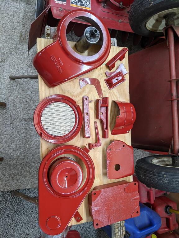

Horse Newbie 7,405 #151 Posted October 27, 2021 Maybe after the wipe down with paint thinner I should just let it dry at its own pace... Share this post Link to post Share on other sites
Horse Newbie 7,405 #152 Posted October 27, 2021 2 minutes ago, rjg854 said: If I remember correctly, within an hour, or after 48 hours. I just got done painting engine parts myself. Show off !!! 2 Share this post Link to post Share on other sites
Horse Newbie 7,405 #153 Posted October 27, 2021 5 minutes ago, rjg854 said: If I remember correctly, within an hour, or after 48 hours. I just got done painting engine parts myself. Do you use a spray gun or rattle cans ? Share this post Link to post Share on other sites
rjg854 13,371 #154 Posted October 27, 2021 Sorry not trying to steal your thunder 1 Share this post Link to post Share on other sites
rjg854 13,371 #155 Posted October 27, 2021 Rust-Oleum spray bombs 1 Share this post Link to post Share on other sites
Horse Newbie 7,405 #156 Posted October 27, 2021 7 minutes ago, rjg854 said: Sorry not trying to steal your thunder You are not stealing nothing here...all are welcome. I love the comments and pics ! 1 1 Share this post Link to post Share on other sites
WheelHorse520H 710 #157 Posted October 28, 2021 On the VHT paint I used a couple months ago all coats had to be applied within an hour or after a full 7 days. 1 Share this post Link to post Share on other sites
Lee1977 7,783 #158 Posted October 28, 2021 The last thing I do before painting small pieces Is wash it off with hot water. You may have had some paint thinner left on it. 1 Share this post Link to post Share on other sites
Horse Newbie 7,405 #159 Posted October 28, 2021 5 hours ago, Lee1977 said: The last thing I do before painting small pieces Is wash it off with hot water. You may have had some paint thinner left on it. How do you dry the part after that ? Share this post Link to post Share on other sites
Lee1977 7,783 #160 Posted October 29, 2021 4 hours ago, Horse Newbie said: How do you dry the part after that ? Metal drys fast If you use hot water 1 Share this post Link to post Share on other sites
Horse Newbie 7,405 #161 Posted October 29, 2021 16 hours ago, Lee1977 said: Metal drys fast If you use hot water So you let it dry on it's own instead of using something like compressed air ? Share this post Link to post Share on other sites

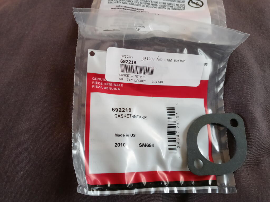

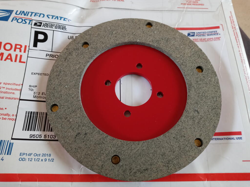

Horse Newbie 7,405 #162 Posted October 29, 2021 (edited) My intake manifold gaskets arrived at the lawn care equipment center so I swung by and picked them up... Also received my new clutch disc from K & B Horse Parts ( @76c12091520h )... progress on the 1984 Work Horse GT-1600 8 SPEED anticipated... Edited October 29, 2021 by Horse Newbie 4 Share this post Link to post Share on other sites

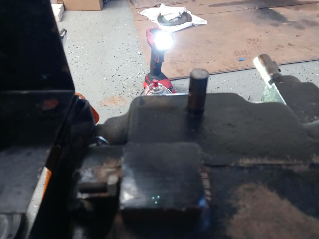

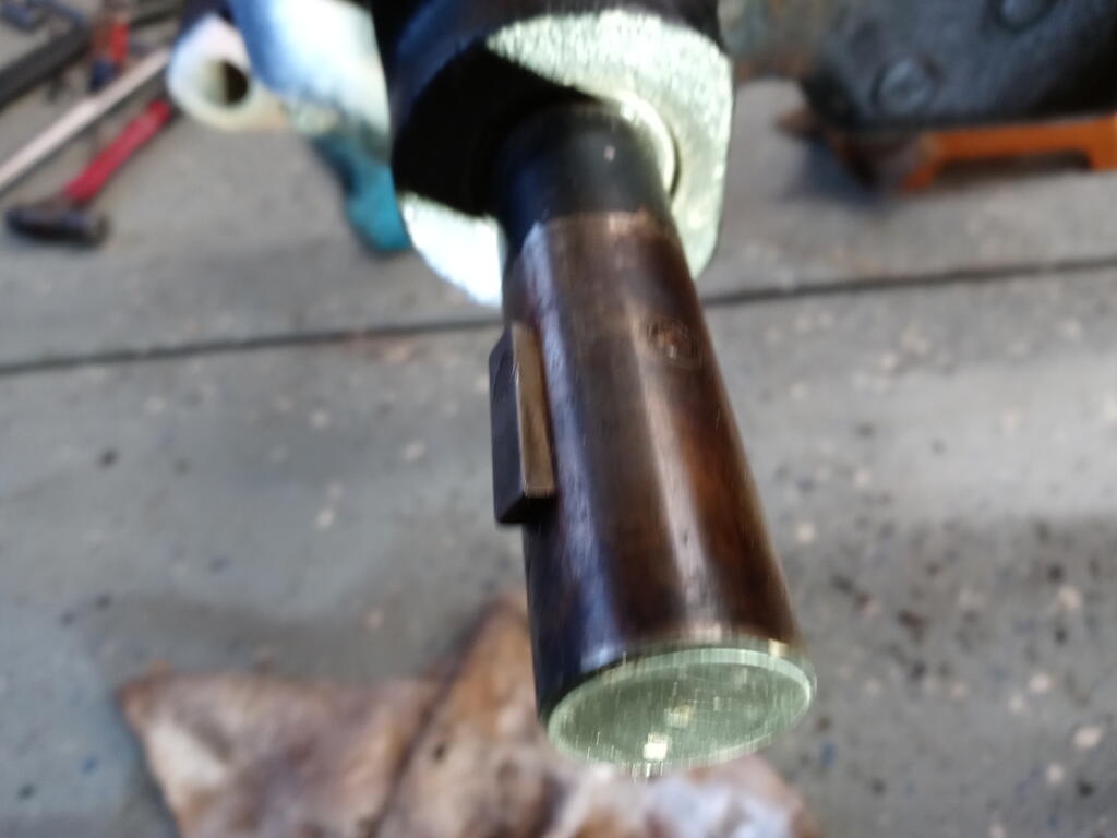

Horse Newbie 7,405 #163 Posted October 30, 2021 I really wasn't planning on all this ! I guess you would call this the input shaft on the transmission/ gearbox on the 1984 Work Horse GT-1600. Is there a seal here, and if there is, can you replace it without taking the trans apart ? Share this post Link to post Share on other sites
Gregor 4,848 #164 Posted October 30, 2021 apparently so, although I am not familiar with this particular tractor. There pretty much has to be a seal, and it has to be replaced from the outside. All you have to do is get the old one out. Key # 13 in the diagram. Part # 100442 Someone else may be able to tell you the inside and outside diameters. Share this post Link to post Share on other sites
Horse Newbie 7,405 #165 Posted October 30, 2021 Thanks @Gregor...I feel like I need to research more as I am definitely going into uncharted territory for me. @ebinmaine , @lynnmor , @WHX?? can on of you tag the transmission GURU. on Red Square for me ?... I can't recall who it is... Share this post Link to post Share on other sites
rjg854 13,371 #166 Posted October 30, 2021 @stevasaurus Share this post Link to post Share on other sites
Gregor 4,848 #167 Posted October 30, 2021 22 minutes ago, Gregor said: All you have to do is get the old one out. On second thought, your shaft doesn't look too bad. If there is room in the boss, simply add another seal. If this is a bad idea, hopefully someone will say so. Personally, I have never done it. 1 Share this post Link to post Share on other sites
stevasaurus 23,856 #168 Posted October 30, 2021 Hello @Horse Newbie, looks like you have been doing some very nice work. You should have the #5086 Wheel Horse transmission. It has 1" axles and a 4 pinion differential. That input gasket is about 1/8" thick, so be careful when you dig it out. An awl or a very small punch can dig it out...just work it around. They come out fairly easily. The replacement is, like is shown above, #100442 which crosses to SKF #6105. File any burrs on the end of the shaft and the key way and then tape with masking tape to avoid ripping the rubber in the seal when replacing. Tap in working around in little bits with a punch and ball peen or a piece of 1" PVC. Any other questions, just ask. Edited post to reflect #5086 trans. Share this post Link to post Share on other sites

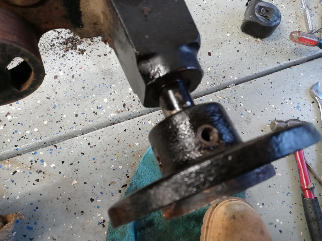

Horse Newbie 7,405 #169 Posted October 30, 2021 (edited) @stevasaurus, thank you a lot for helping me with the input shaft seal... And yes I do have more questions... Can the other seals- axles, brake shaft, be replaced also without taking the transmission apart ? I'm not gonna tell the members how I got that right side hub off ! Also, is there any kind of seal around the Hi-Lo selector shaft ? Pics attached for members viewing pleasure... Edited October 30, 2021 by Horse Newbie Share this post Link to post Share on other sites

kpinnc 18,970 #172 Posted October 31, 2021 And nope- nothing seals the hi/lo shifter. Always wondered why, but it is what it is. All the seals can be replaced without splitting the case. 2 Share this post Link to post Share on other sites
