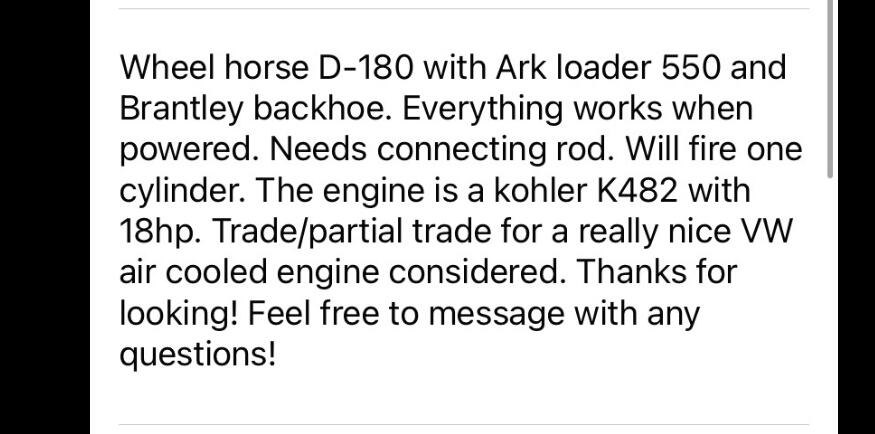

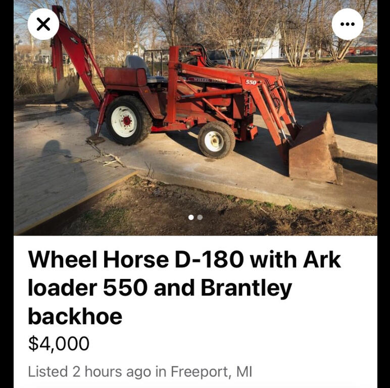

Pullstart 71,482 #1 Posted May 6, 2021 Well, my buddy sends me a picture last night and is now the proud owner of a D-180 with an ARK550 and Brantley Back Hoe. Seems we have been discussing ‘hoes quite a bit lately... @Wheel Horse 3D @ebinmaine @wallfish @roadapples I am looking, but haven’t found any detailed threads about swapping a 22 hp predator into a D series. This has one broken rod and who knows what other damage internally, so for speed of putting this to use, I think my buddy is going the Predator route. Here are the pictures and details he sent me... 5 1 Share this post Link to post Share on other sites
