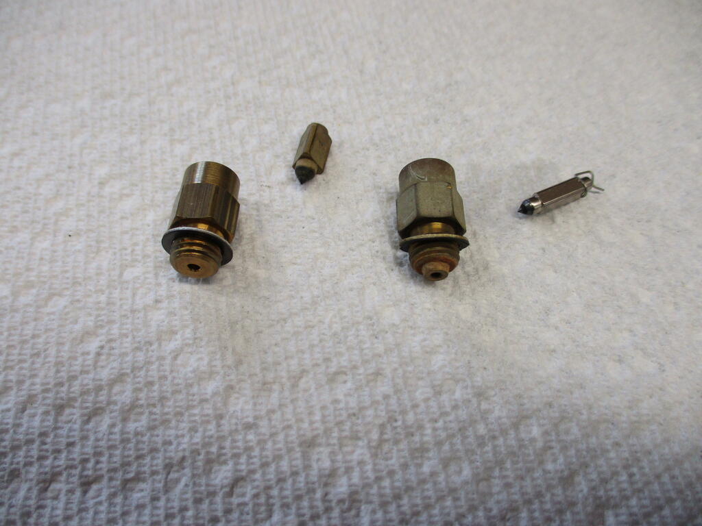

roadapples 6,987 #4 Posted April 16, 2021 Between 01 and 02 the tip of the seat is the only difference. But it does matter... 2 1 Share this post Link to post Share on other sites

pfrederi 21,301 #7 Posted April 16, 2021 The 2575711s is for walbro carbs ..Long skinny float valve. Right inpic You can see the difference on the valve seat road apples mentioned 4 1 Share this post Link to post Share on other sites

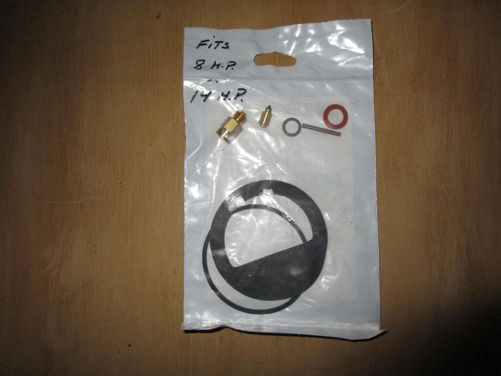

JCM 11,451 #12 Posted April 17, 2021 Came across this Kohler kit in the house this morning and I know I have more in the shop, but passing on this info in case it helps. #25 757 01-S with my handwritten note backside fits 8 hp-14 hp. 3 Share this post Link to post Share on other sites
ebinmaine 81,139 #13 Posted April 17, 2021 2 minutes ago, JCM said: Came across this Kohler kit in the house this morning and I know I have more in the shop, but passing on this info in case it helps. #25 757 01-S with my handwritten note backside fits 8 hp-14 hp. Fits my 16 too Jim. 1 Share this post Link to post Share on other sites

ACman 7,761 #20 Posted July 25, 2022 On 4/16/2021 at 3:03 PM, pfrederi said: The 2575711s is for walbro carbs ..Long skinny float valve. Right inpic You can see the difference on the valve seat road apples mentioned did you mean 01-s not 11s and do you know if the gaskets are the same ? @ebinmaine it just got me wondering because it seems all the aftermarket are the same generic stuff inside the bag . 1 Share this post Link to post Share on other sites
ebinmaine 81,139 #21 Posted July 25, 2022 1 minute ago, ACman said: did you mean 01-s not 11s and do you know if the gaskets are the same ? @ebinmaine it just got me wondering because it seems all the aftermarket are the same generic stuff inside the bag . I can take a look at the two specific different Kohler kits when I get home in about an hour. I'm wondering if maybe the bowl size is different? Share this post Link to post Share on other sites
roadapples 6,987 #22 Posted July 25, 2022 Only rebuilt 10 through 16s. The only difference I know of is in pfrederi's picture... @oldredrider??? Share this post Link to post Share on other sites
