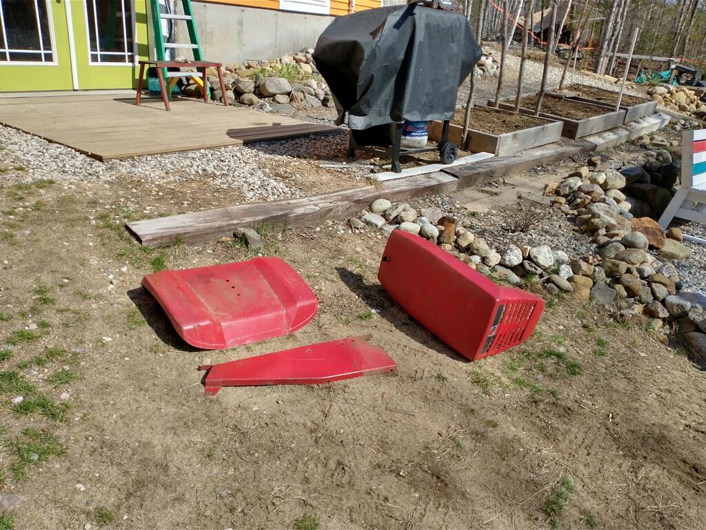

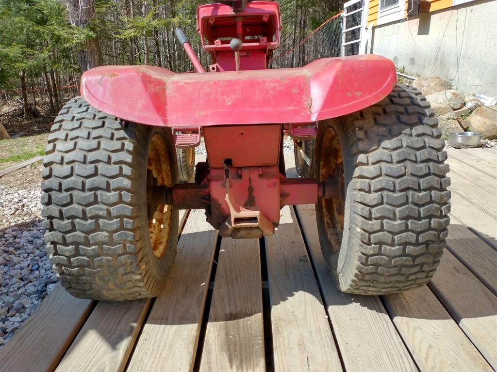

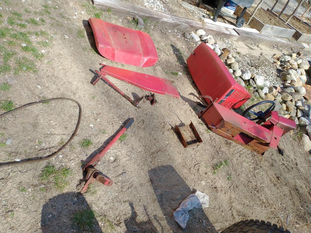

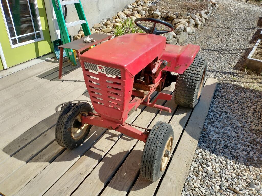

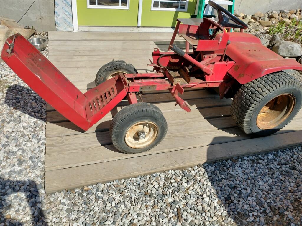

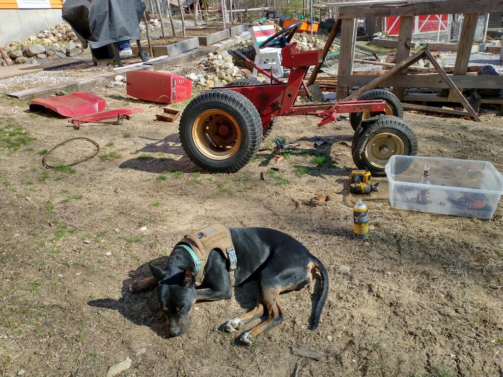

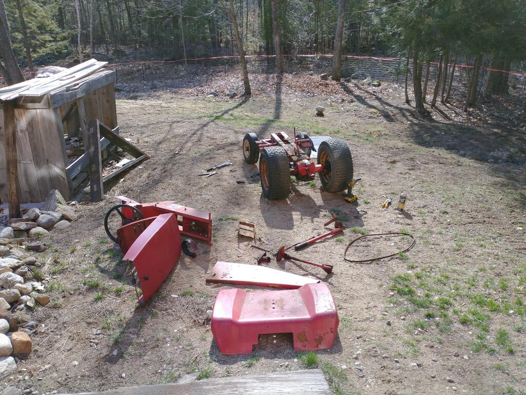

Lee1977 7,805 #26 Posted April 12, 2021 On 4/4/2021 at 4:58 PM, ebinmaine said: BBT started her Military Tribute Tractor build this afternoon. The chassis was/is a gift from @Herder Adam maybe 3 years(?) ago. We'll be using the mid 70s Chrysler mil-spec single cylinder engine from @Stepney Spenser. The wheels to be installed are a nice set we picked up from @Sparky last fall at @JCM Jim's North Berwick Maine meet n greet. The Dismantling Department went right to work this afternoon and spent less then 2 hours to get to where she is in the pics. The cleanup crew will be taking over soon. Here's what we'll call the Before section: And here's the current progress: Build Trina A Shop! It's just not right treating a Horse like that, having to laid it out on the ground. Good hard working woman and you want even give her a nice place to work. 2 Share this post Link to post Share on other sites
ebinmaine 80,975 #27 Posted April 12, 2021 6 minutes ago, Lee1977 said: Build Trina A Shop! It's just not right treating a Horse like that, having to laid it out on the ground. Good hard working woman and you want even give her a nice place to work. Her choice. OUTSIDE.... Share this post Link to post Share on other sites
seuadr 490 #28 Posted April 12, 2021 i need to get a paint department. 1 2 Share this post Link to post Share on other sites
ebinmaine 80,975 #29 Posted April 12, 2021 1 minute ago, seuadr said: i need to get a paint department. Very difficult to find. 1 Share this post Link to post Share on other sites

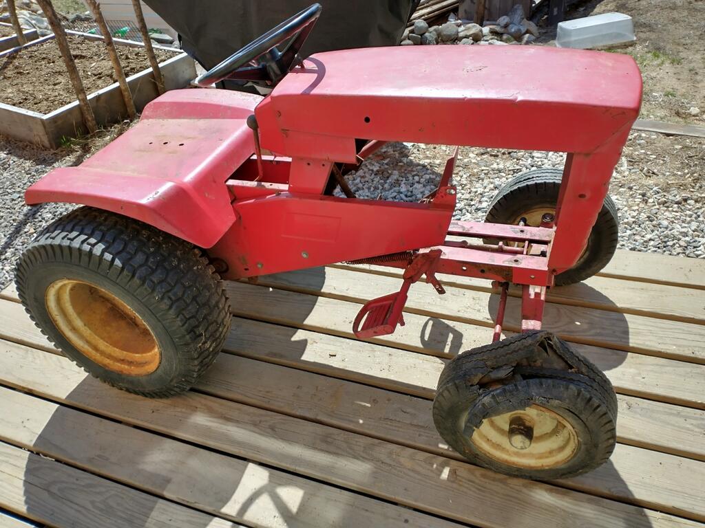

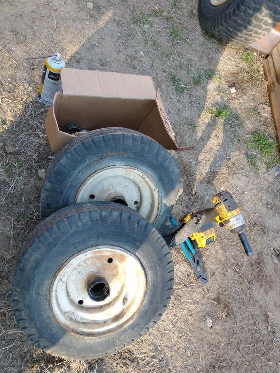

squonk 48,231 #30 Posted April 12, 2021 On 4/4/2021 at 8:05 PM, ebinmaine said: Not being familiar with the older horses.... These rims have bearings in them. Is that a Wheelhorse thing?? Almost look like 953/1054 wheels. They have the tapered brgs. Also GT-14 and 520's have them too 1 Share this post Link to post Share on other sites
OldWorkHorse 3,156 #31 Posted April 26, 2021 On 4/4/2021 at 4:58 PM, ebinmaine said: Have you checked to see if the tires still hold air? 4 Share this post Link to post Share on other sites
ebinmaine 80,975 #32 Posted April 26, 2021 8 minutes ago, OldWorkHorse said: Have you checked to see if the tires still hold air? That one on the right front has some difficulty keeping pressure 1 2 1 Share this post Link to post Share on other sites
Pullstart 71,386 #33 Posted April 26, 2021 20 minutes ago, ebinmaine said: That one on the right front has some difficulty keeping pressure Roll it over 1/2 turn. It’s supposed to only be flat on the bottom... 4 Share this post Link to post Share on other sites

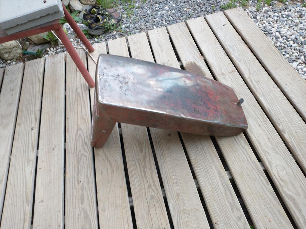

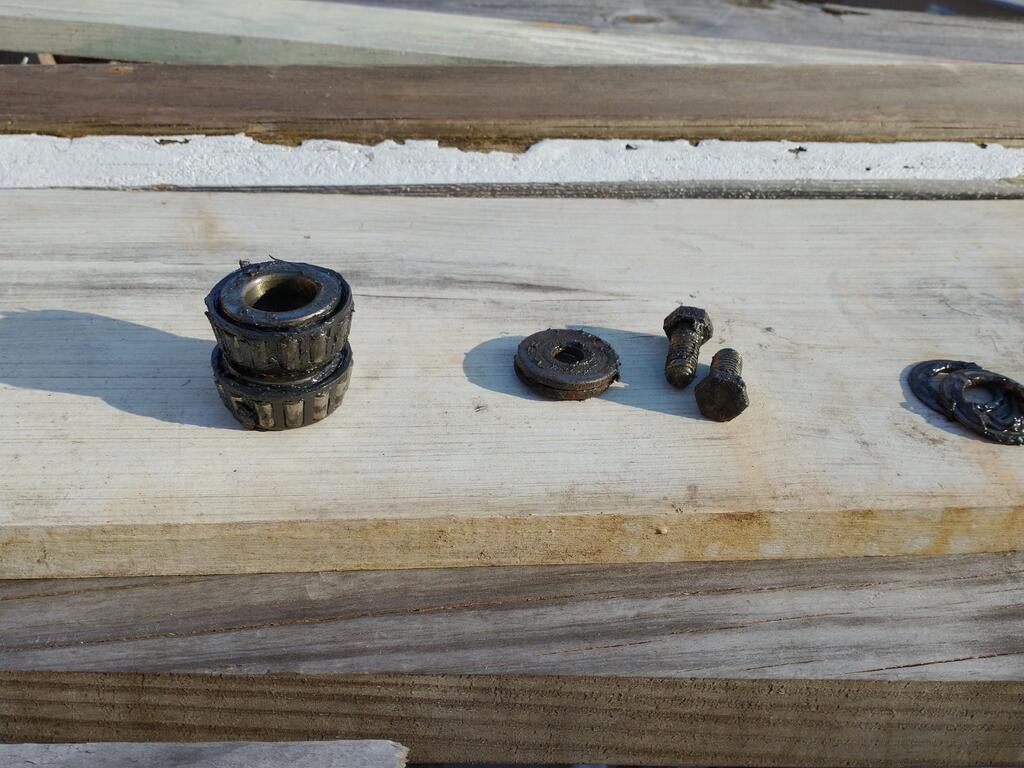

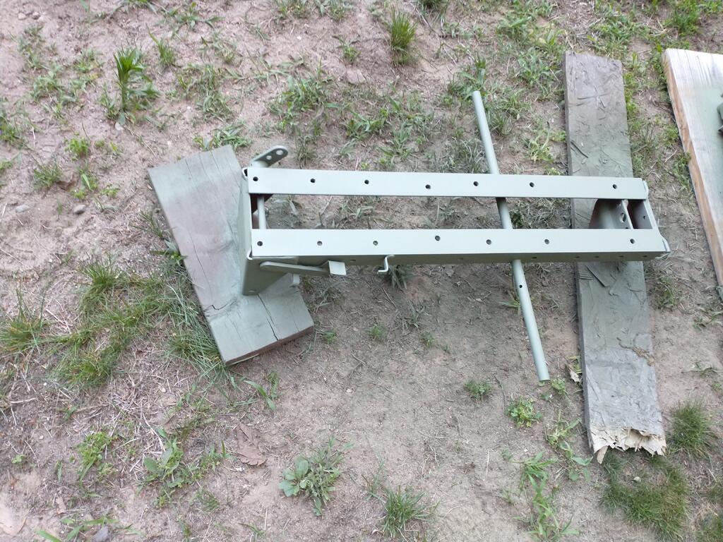

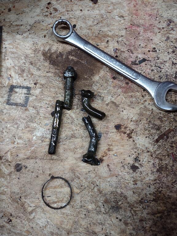

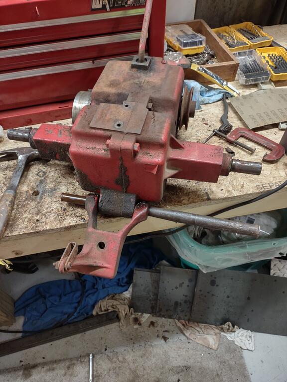

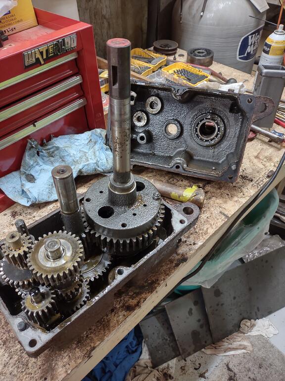

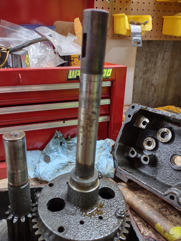

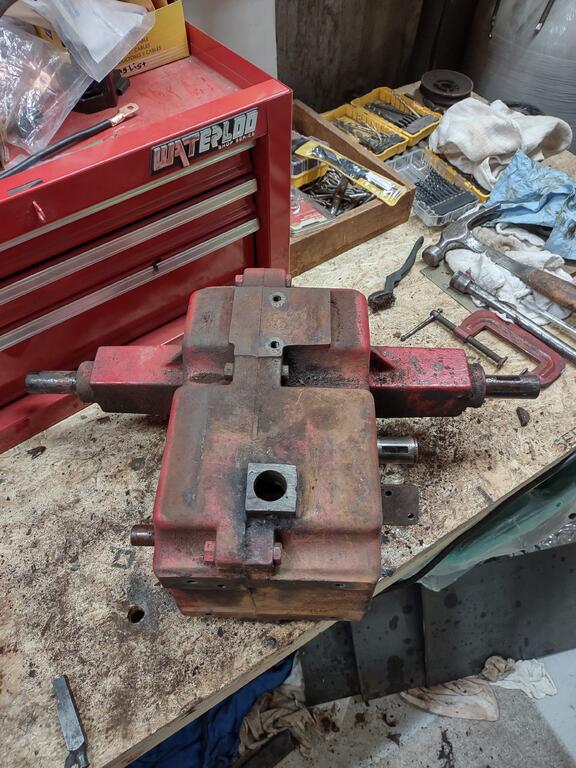

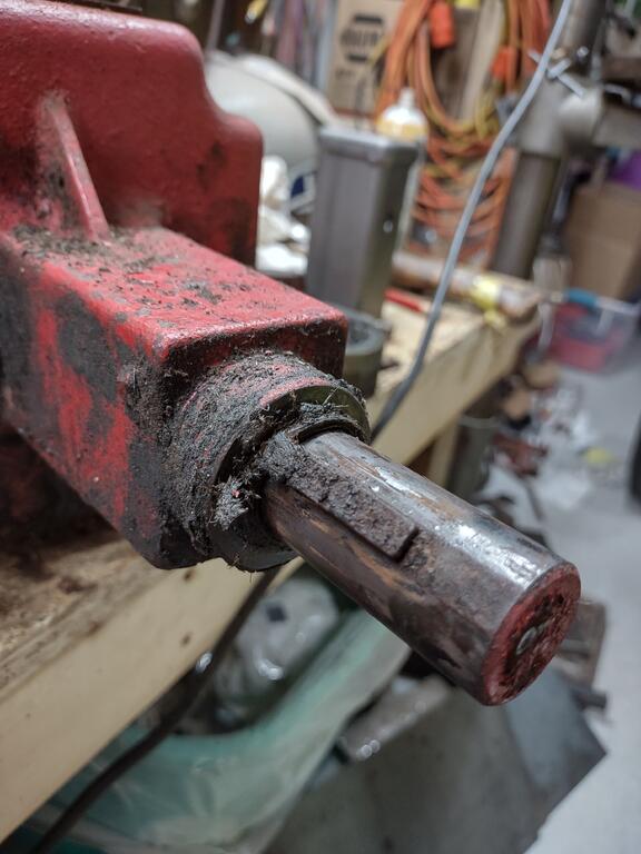

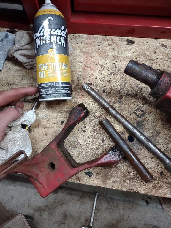

ebinmaine 80,975 #34 Posted June 7, 2021 Trina spent some time wire brushing her hood today. Top and sides are down to bare metal. We also were able to get the engine to fire again. Not quite running right but it's headed the right direction. Thanks to @OldWorkHorse Steve's help we were able to get the hubs off the transmission. Sooooo I figured since it was blazing hot 🔥🔥 outside I'd dig into the gearbox. First thing was obviously the dreaded hitch pin. I pulled the C-clips out and massaged the pin back and forth a few (or a dozen) times with a hammer and a couple chisels. Eventually it came out. Next on the fun agenda was the input and brake pulleys. Brake pulley slid right off once I removed the C-clip. Input pulley. Fought. Me. All. The. Way. But I won. I planned on disassembly and cleaning at the very least and today had noticed that it has a bad wheel bearing. Looked like perhaps someone tried the old school "rope seal" method. Who's to say if or how long it held but it was falling right out today. Good news is that the axle is still in good shape. Note the differential bolts. 4 holes. 2 bolts. And they were floppy loose. Well I found them in the bottom of the case. 3 2 Share this post Link to post Share on other sites
OldWorkHorse 3,156 #35 Posted June 7, 2021 @ebinmaine any damage to the gears with thos bolts swimming around in there. I usually find it difficult to fold a bolt into a horseshoe seems your transmission found the secret. 2 Share this post Link to post Share on other sites
ebinmaine 80,975 #36 Posted June 7, 2021 1 minute ago, OldWorkHorse said: usually find it difficult to fold a bolt into a horseshoe Usually??? I dunno yet... Looked ok from the outside but who knows what up there. Next time I'm at it I'll double check ✅ all the bearings and gears. 2 Share this post Link to post Share on other sites

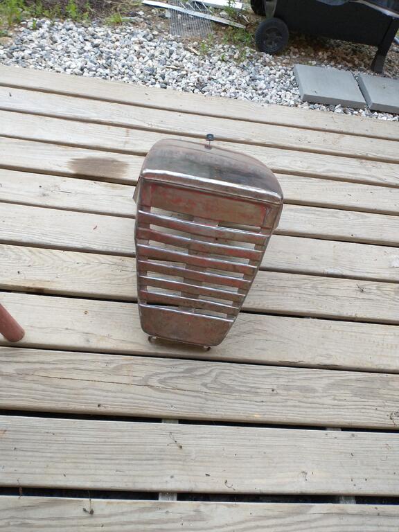

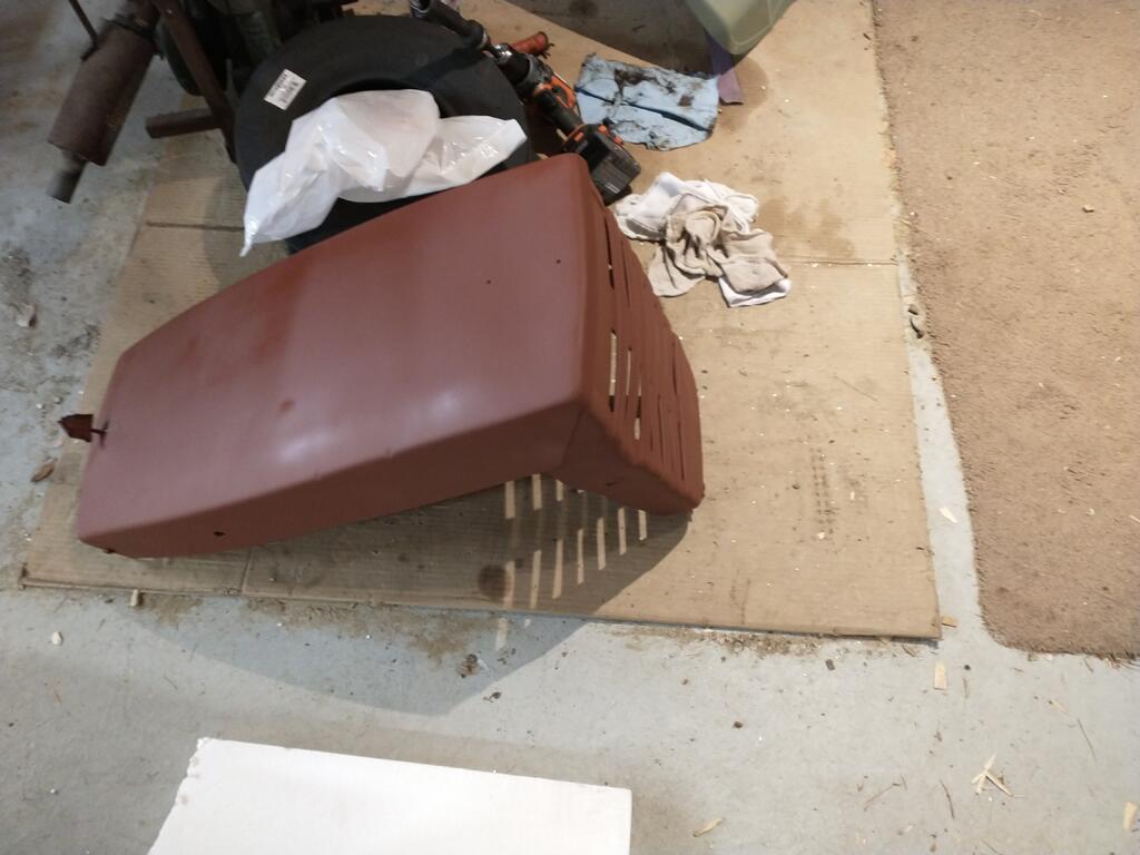

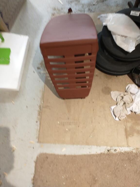

ebinmaine 80,975 #37 Posted June 10, 2021 BBT got the hood wire brushed this evening. 1 7 Share this post Link to post Share on other sites
ebinmaine 80,975 #38 Posted June 10, 2021 And a coat of red oxide primer.. 5 Share this post Link to post Share on other sites

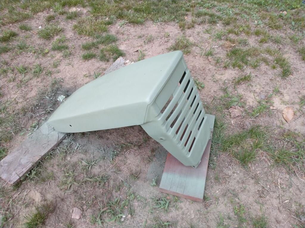

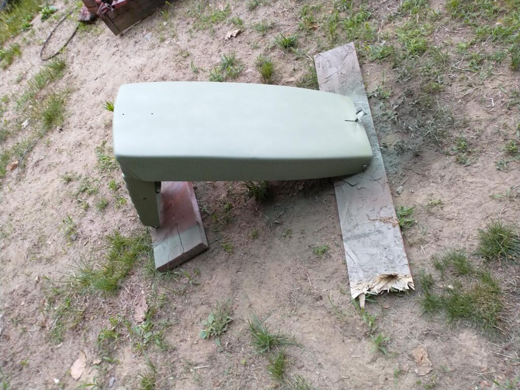

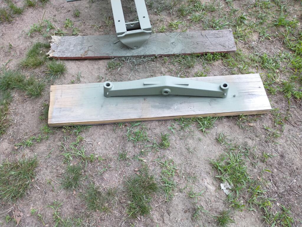

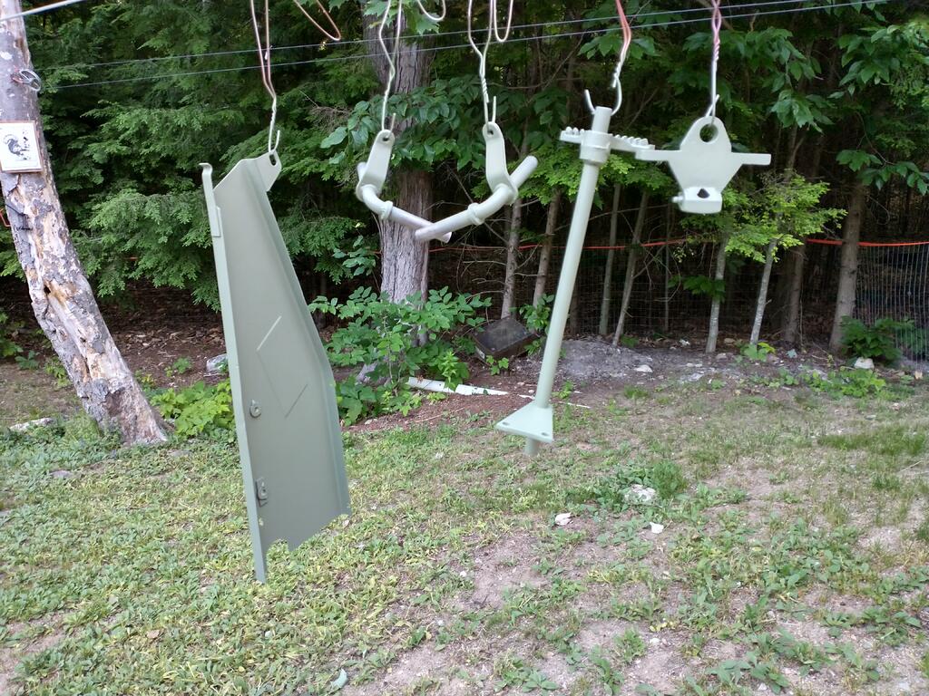

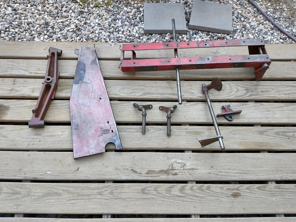

ebinmaine 80,975 #41 Posted June 13, 2021 More paint off more parts.... 2 Share this post Link to post Share on other sites

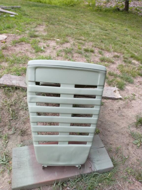

ebinmaine 80,975 #42 Posted June 14, 2021 More paint ON more parts.... 6 1 Share this post Link to post Share on other sites
