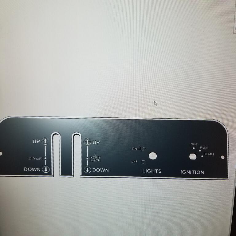

Wheel Horse 3D

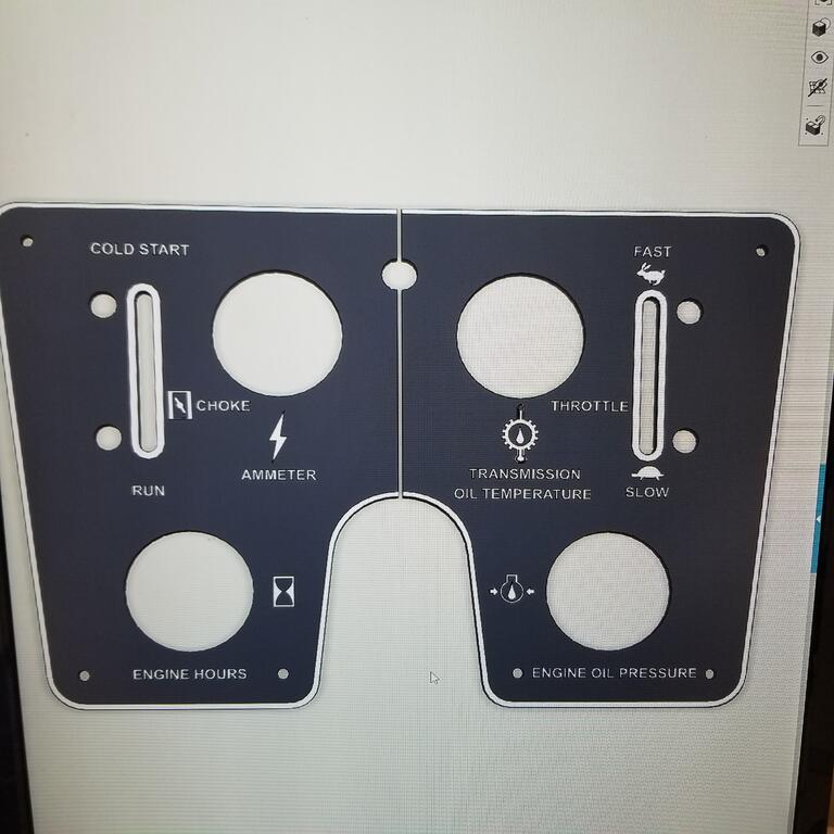

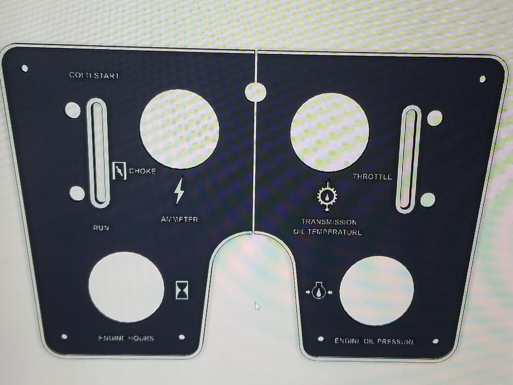

Progress continues on the D dash!

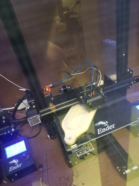

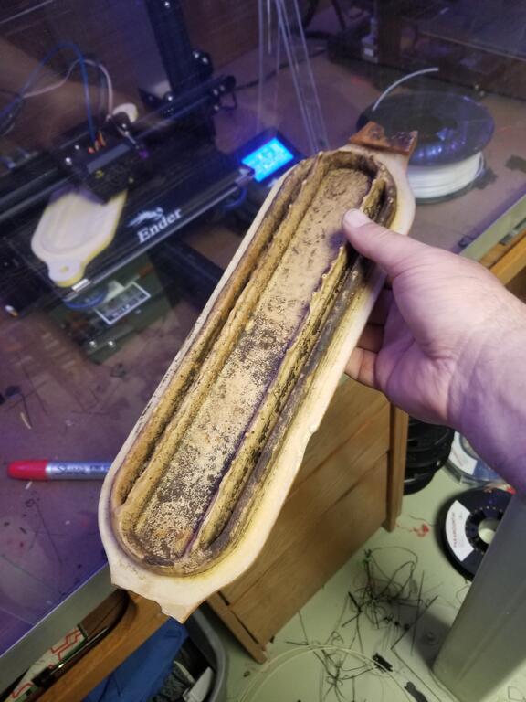

Wheel Horse 3D
Anyone know what this even is????
Appears to be some sort of cover that is supposed to get oil flung up on it and then drip back down. A local dropped the part of with my folks. Not sure what it is but the print sure is looking nice!

K a set of GT 14 dash and console plates are headed to @buckrancher. Once he tries 'em out we should be able to add those to the store.
Model for upper D dash is complete, but I need to a hole alignment test before we try a full print on those. Getting to start model of the lower D dash portion here in the next day or so.

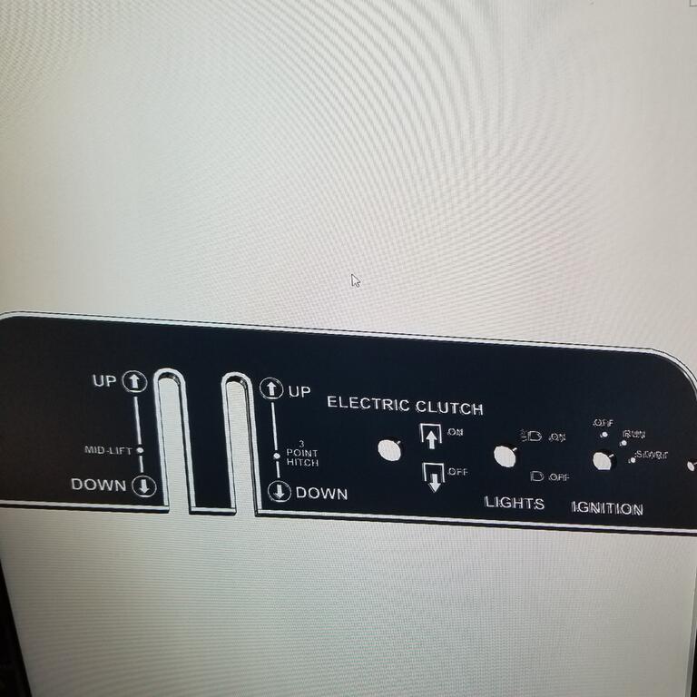

D dashes continue..lower dash with and without electric clutch

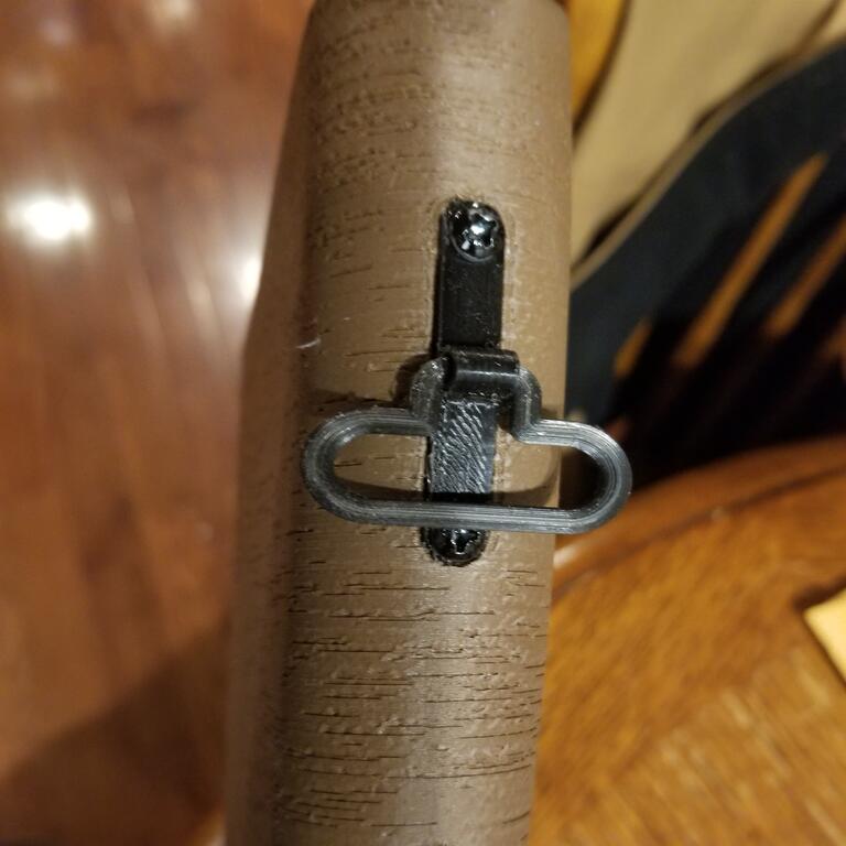

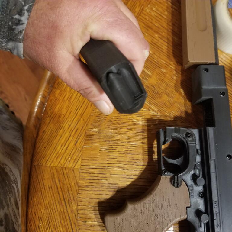

Wheel Horse 3D

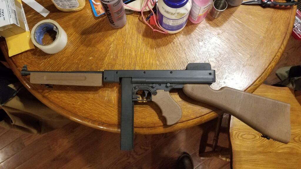

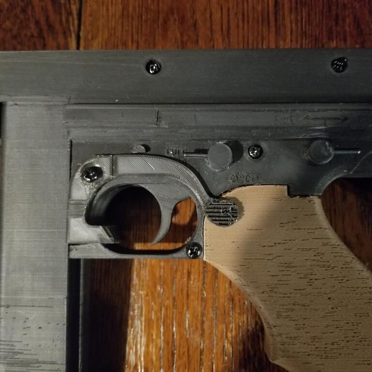

Done with this prototype! Theres a few changes for the final versions including a more sturdy rubber band catch which failed on this one and I'll use different filament for a better finish. but this one ia ready to hang on a wall! I got the mag catch working and installed the new sling hardware

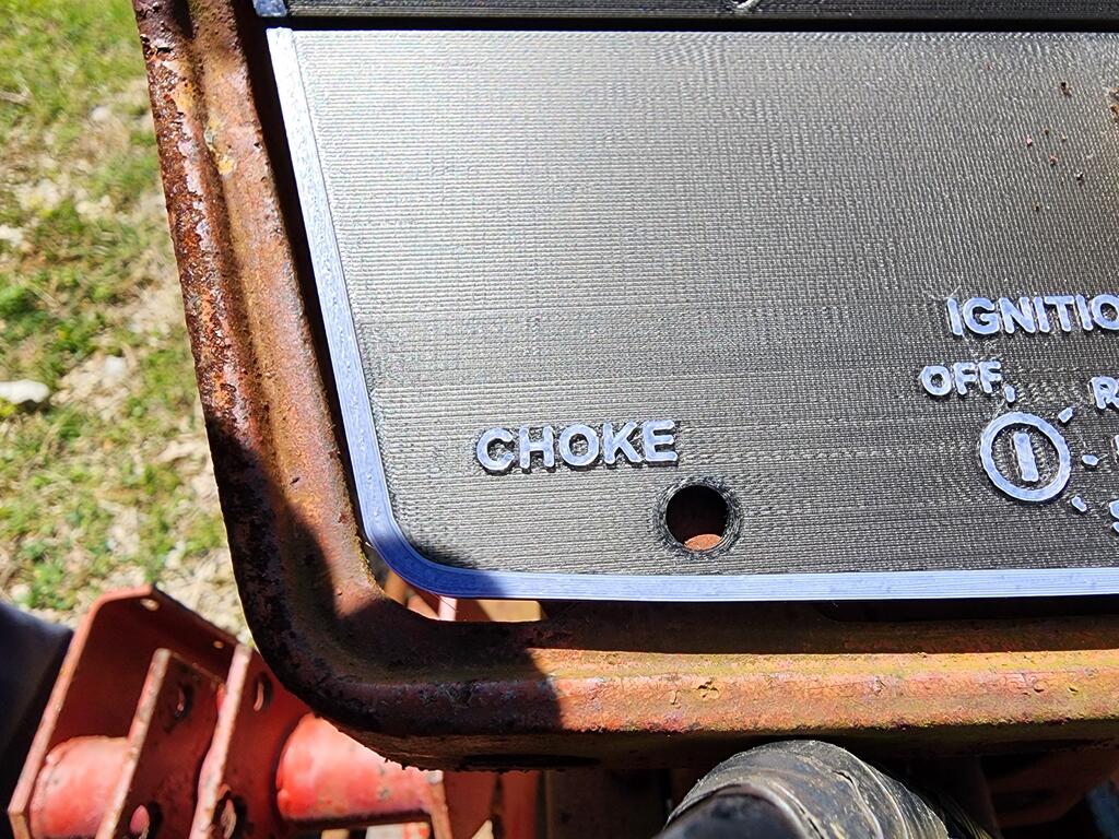

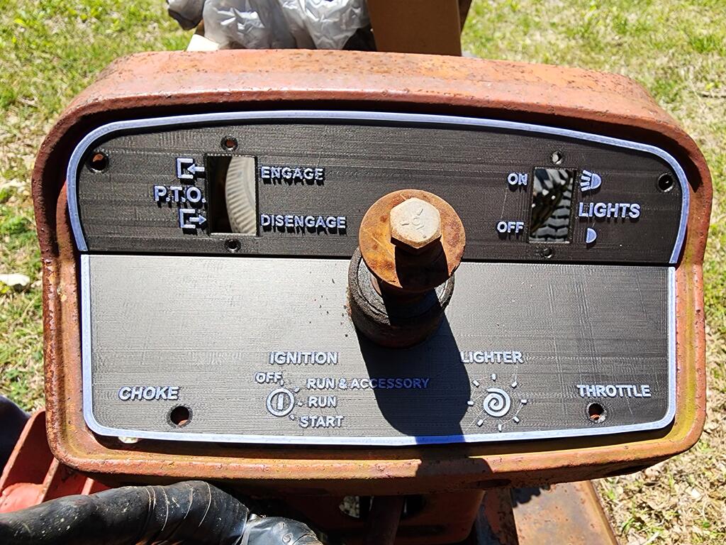

cafoose
On 4/26/2023 at 10:23 PM, Wheel Horse 3D said:
Ya'll are welcome! How'd they fit?

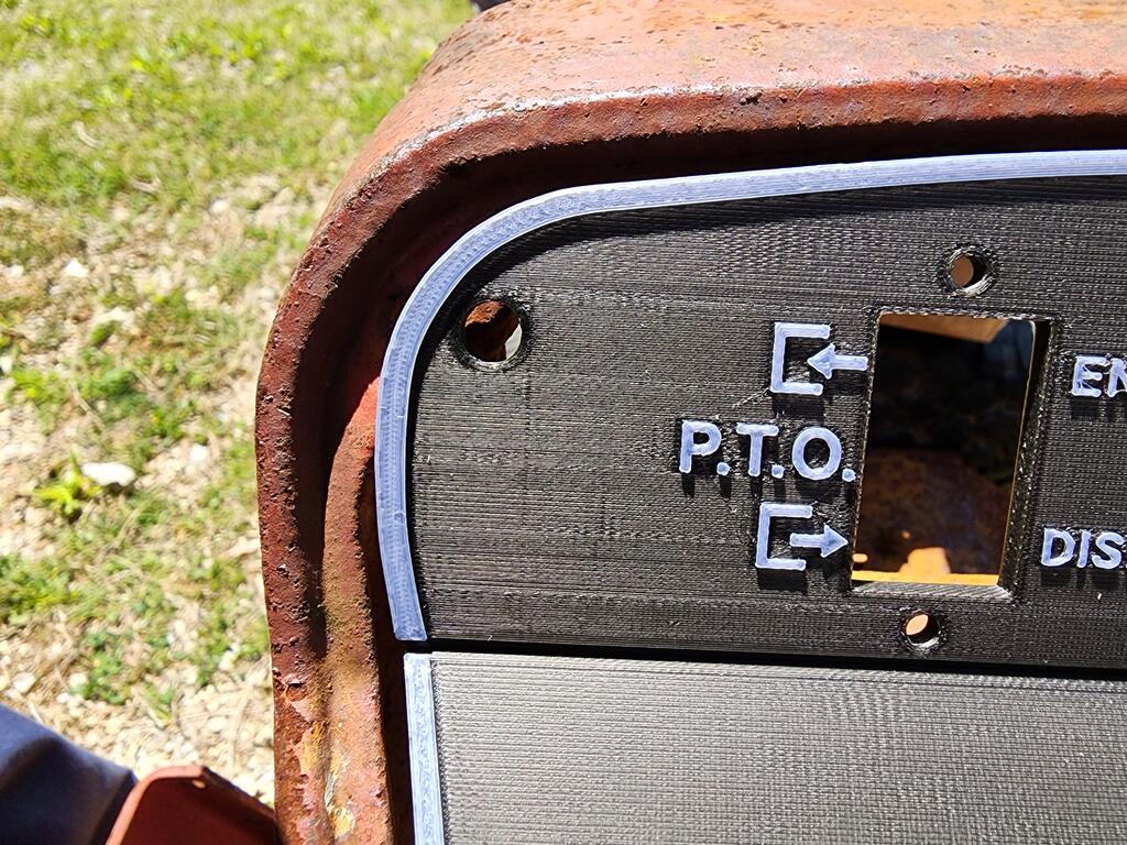

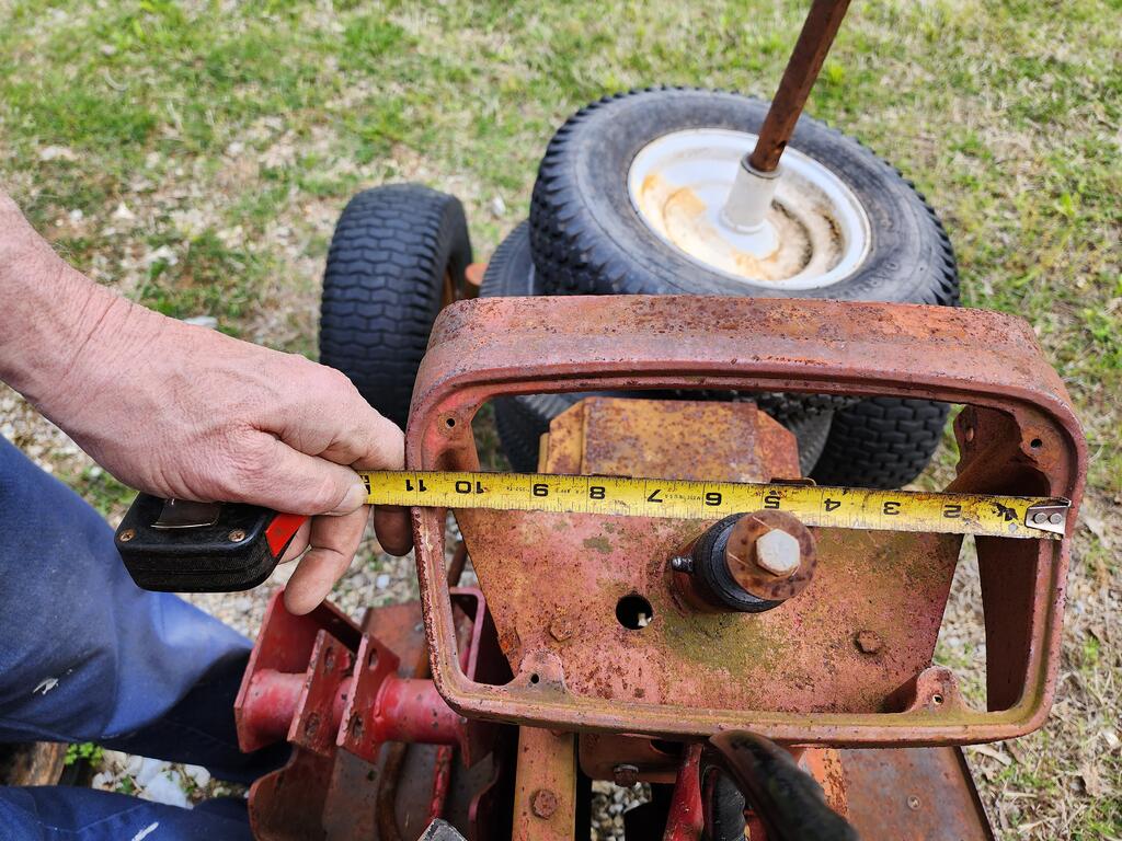

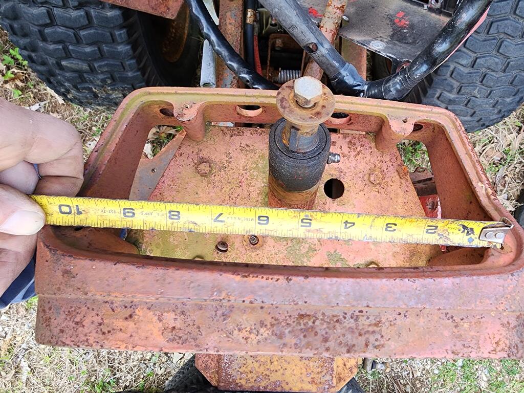

They don't fit :sad-darkcloud: I have one from Glen Pettit a while back that fits. I think @wheelhorseman has some new ones from Glen's old inventory. I can send you the one I have for measurements or maybe @wheelhorseman can help with measurements?
  • Sad 1
Wheel Horse 3D
Full refund issued! That looks like half an inch off! I just sent a plate to buckrancher along with his original, and they line up. Is there a variance of dash sizes I'm missing?

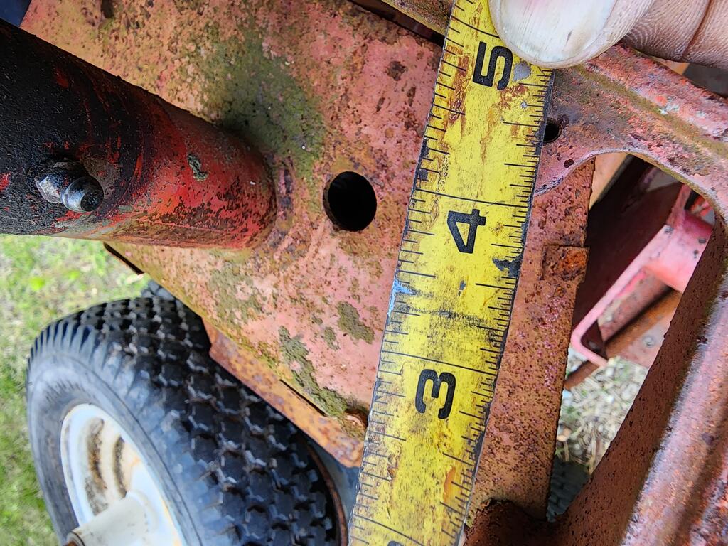

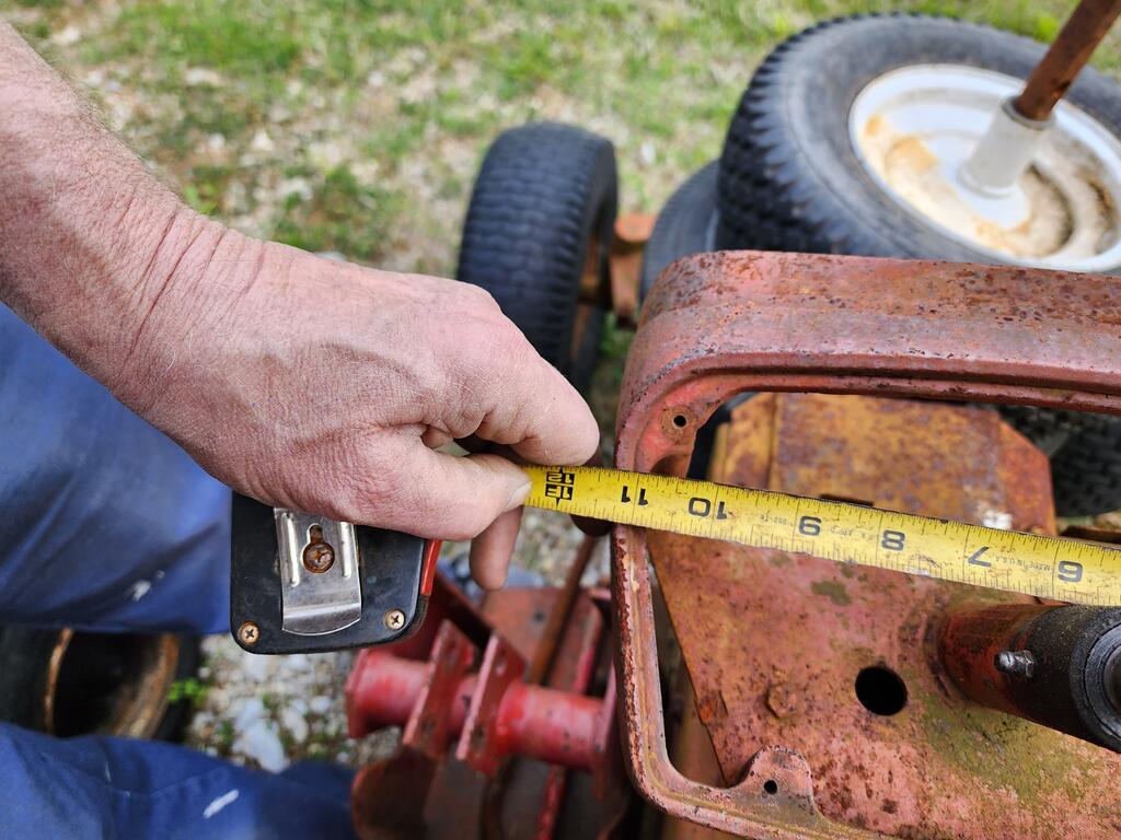

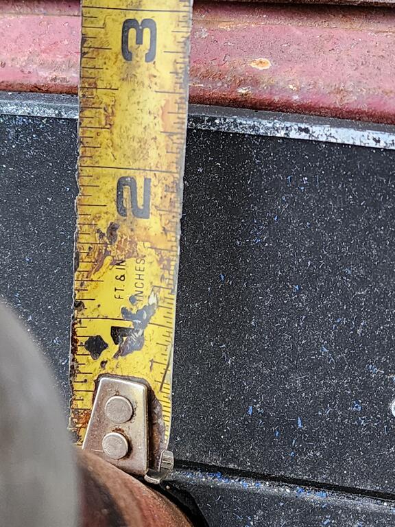

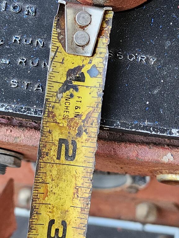

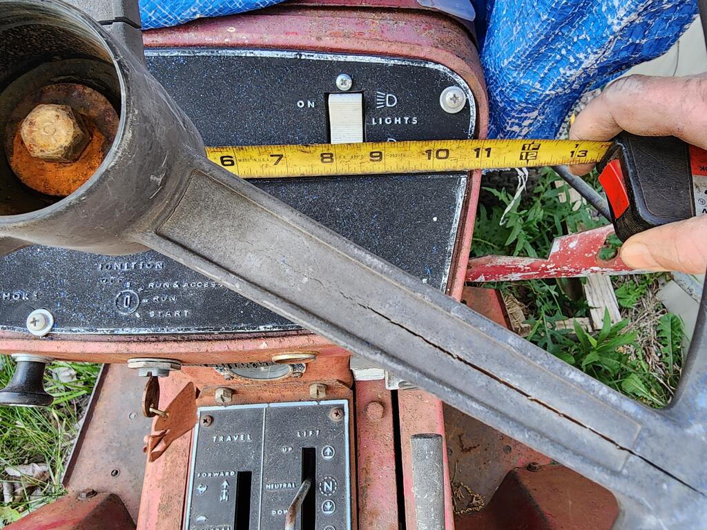

cafoose

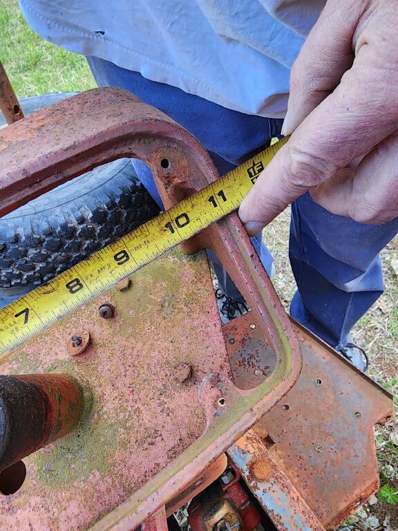

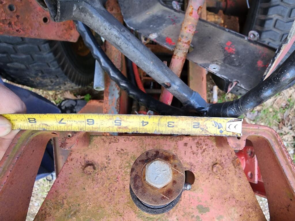

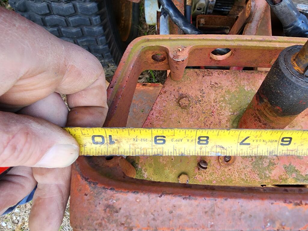

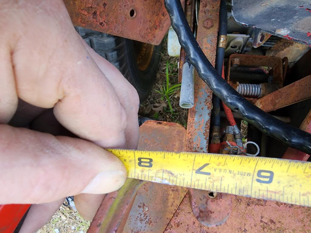

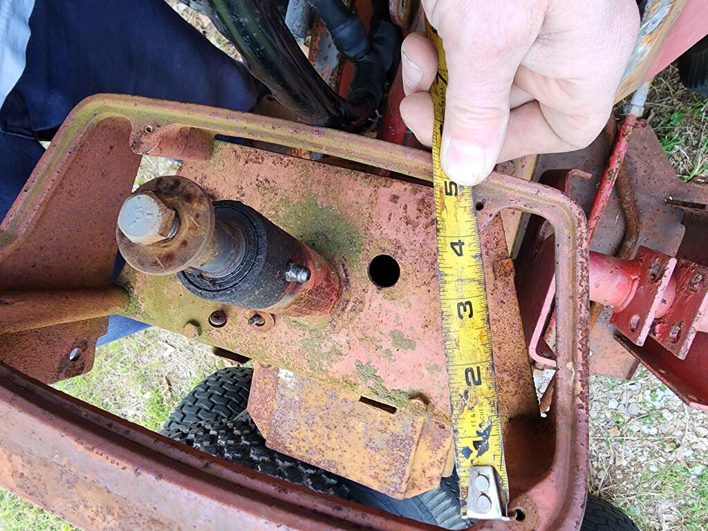

Here are my measurements. The dash plate in the pictures is from Glen Pettit

Wheel Horse 3D
Looks like right at 11 at the widest or there abouts. And my model clearly shows 10.583.
Hopefully @buckrancher can shed some light. Maybe I completely missed a half inch difference from the print and the dash I've worked with on and off for 2 years? Dear lord somebody shoot me if that's the case!:confusion-scratchheadblue:

@cafoose would you mind sending me a tracing of the dash that fits? It should fit nicely on a regular piece of paper. I originally traced the large portion first including holes and openings, then tipped the dash keeping it aligned and traced the top portion and switch holes.

I can send you the actual dash that fits but I need to remove it from the tractor if that works for you. Either way I would have to remove it anyway. I can remove it tomorrow. I think you would be able to see the differences better if you had the actual dash plate that fits.

Wheel Horse 3D
Thank you so much! I just heard back from @buckrancher and his is short too, but so is the original! Apparently somehow it SHRUNK that much! He removed it from the dash, tossed in a box, and sent to me. I did my original sketches and measurements right after it arrived! CRAZY!
Just glad to know I'm not crazy, I was about to hang up my calipers!

I not only sent you the dash but I was also able to remove the housing that the dash plate screws on to. I'm in no hurry if you need to keep the housing until the big show if you are going. You can get it back to me then or if you want to keep it so you can verify the dash plates you make will fit then you can trade me an extra dash plate for it, your choice :D

Not a bad idea especially now that I know they can tend to shrink!

Do you know if the material you use maintains it's original size or can that shrink?

Thanks for doing that, we are all looking forward to a successful conclusion to this.
My guess is that the UV shrinks the plastic and since we tend to keep our GT-14s under cover when not in use shrinkage isn't going to be an issue.

I would have never imagined 1/2 in over 11 inches of shrinkage, all plastic can warp and heat and uv and could imagine regular expansion and contraction with these but nothing else. I guess REALLY high temps could be a factor(over 150 C). When I've had to weld some of this plastic it actually tends to swell when I get the iron on it.
