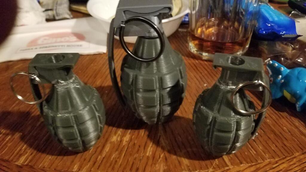

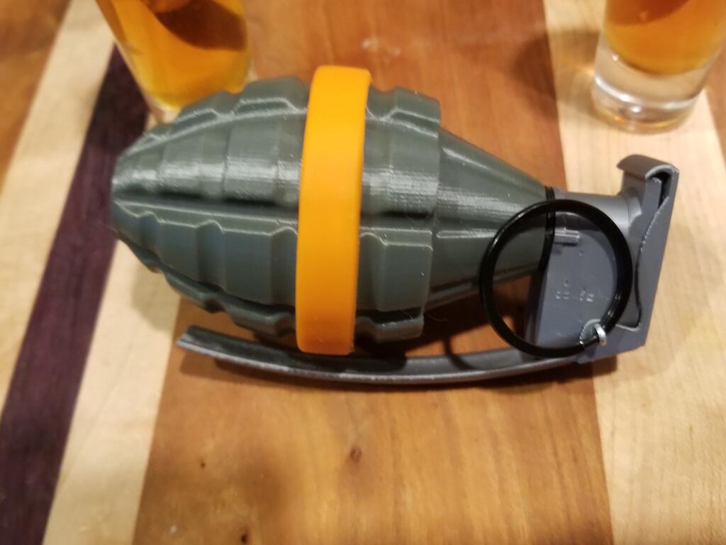

It's possible I may have a couple of extra reinforced, small scale, grenades at the house...

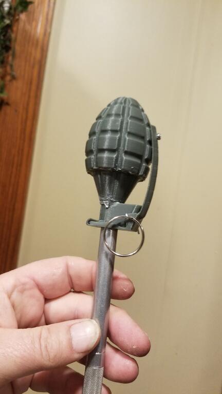

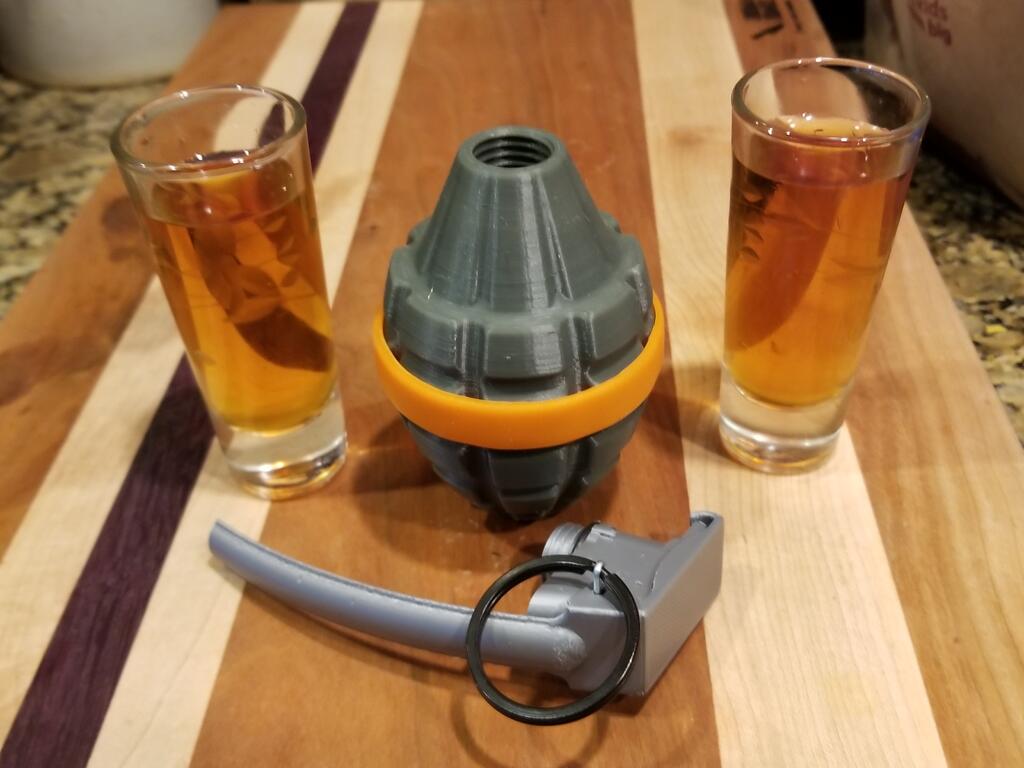

Includes 7/16 pocket to slide over the 3/8 shaft to get the threads up into the body of the grenade, and a pilot hole into the body so ya can drill and tap.

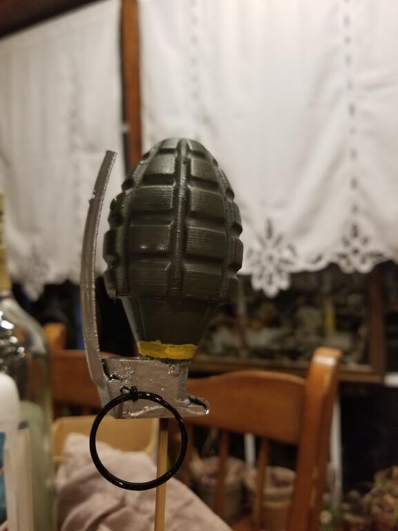

Wheel Horse 3D

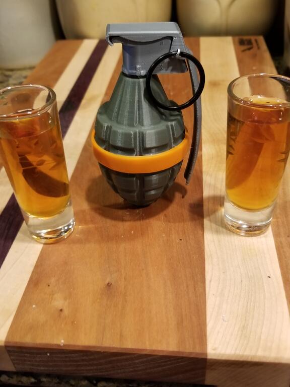

A painted shifter knob that's DA BOMB!
  • Excellent 1
ebinmaine
8 hours ago, Wheel Horse 3D said:
 shifter knob
Grey is there enough substance to the center that if Trina wants to set the grenade right side up we could drill the bottom?
Wheel Horse 3D
Yup!

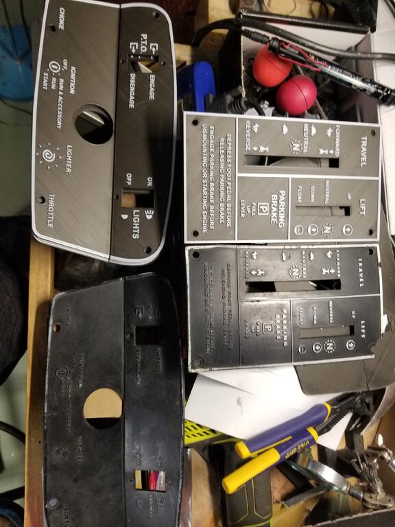

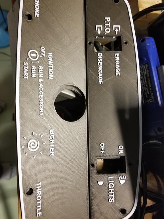

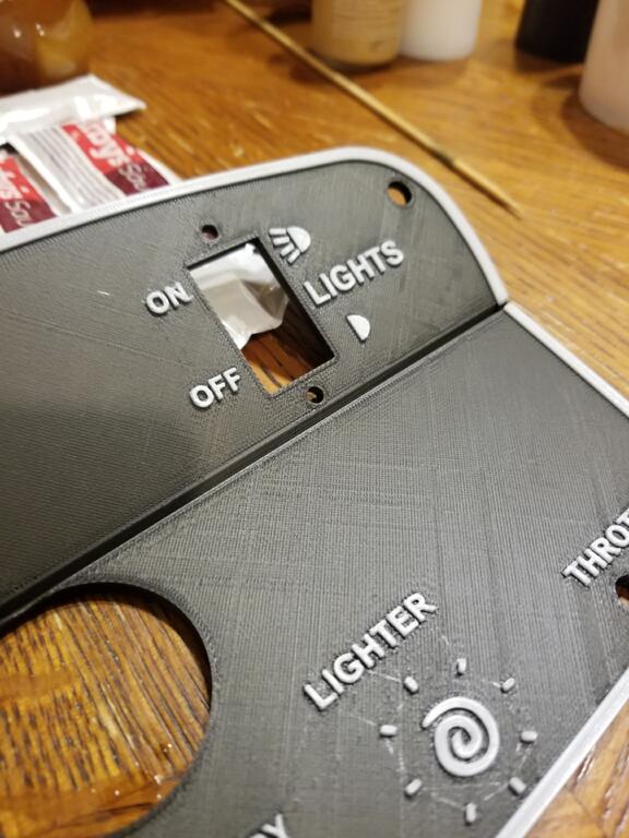

Another gt14 attempt...fine tuning the letter height to be just enough for fully white.(layers are so very thin ya need 3 or 4 layers, but don't want em to stick up too much!
  • Like 4
Wheel Horse 3D

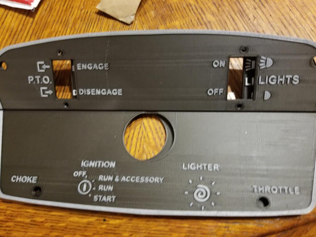

Ok now I'm happy with the lettering! I'm thinking the surface still may need work, but I may be picking knits. The surface is super smooth you cant even feel the lines,but ya can still see a little unevenness in the pattern. What do ya'll think?

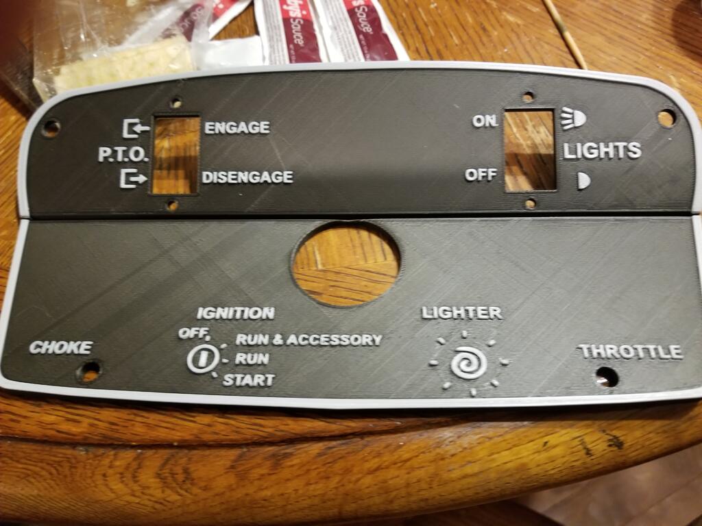

Also need to rotate that 45 like the one before so the lines run left and right or up and down rather than at a 45.theres also 2 other "ironing" options I haven't tried yet and a few parameters under those I can tweak. One basic ironing pattern gave results like this: came out very well except for the right edge. The tolerances here are so close a variance in the glass thickness can matter and cause an issue like this.

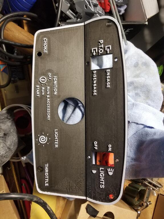

@buckrancher what do ya think of the latest run? Gonna do one more 45 degrees rotated. Have a console plate running now, should be ready to change color when I get home.

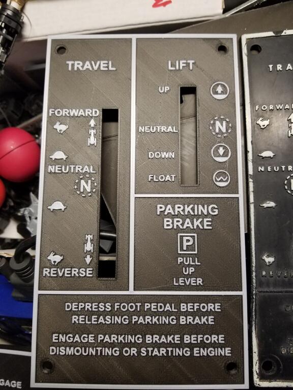

I think were FINALLY there! I want to do one more set with the horizontal layer(rotated 45)
But these look pretty good I think.and these at only a slight increase in thickness feel a bit more rigid to me. Mounting should still be done with Glenn Pettits good advice...rubber washers, finger tight, with a dab of locktight on each screw. I think over tightening contributes to the failure of a lot of these dashes.

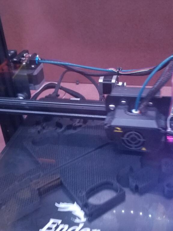

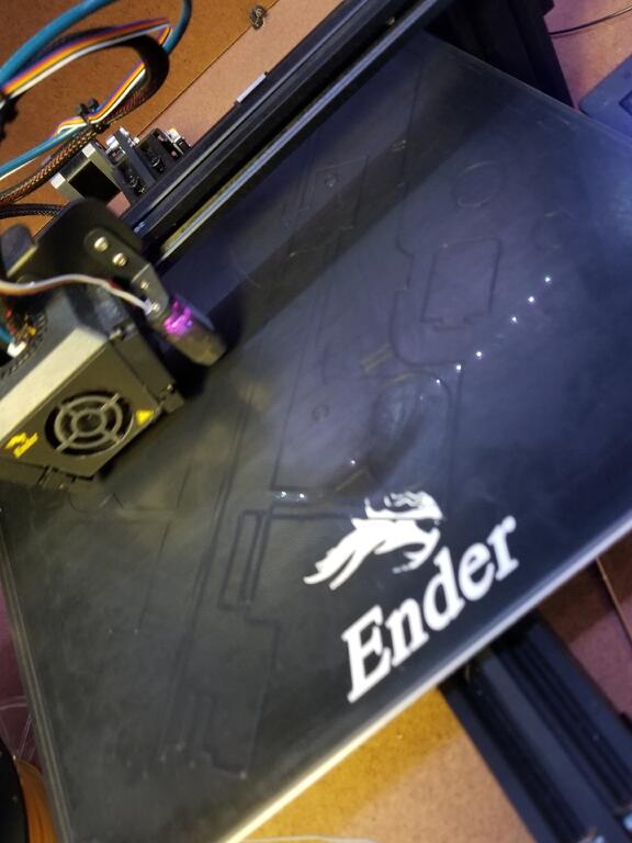

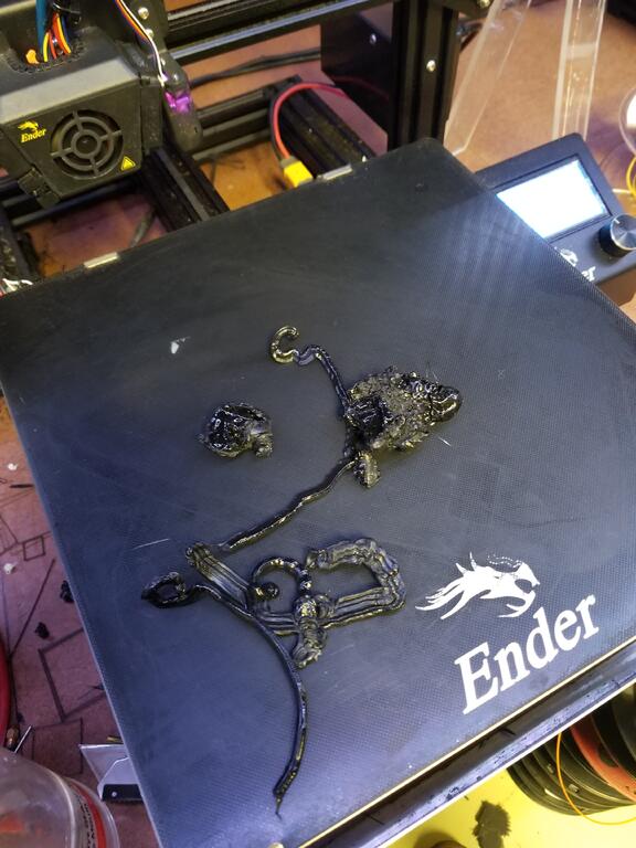

Ok most of the time ya get decent results...but every now and then ya get the old school horror flic...  aka. THE BLOB! So starting the dash over. This machine MAX1 will from now on be just for dashes and plaques etc. Pretty sure the nozzle needs swapped, got plastic all the way up into the fan!
Edited by Wheel Horse 3D

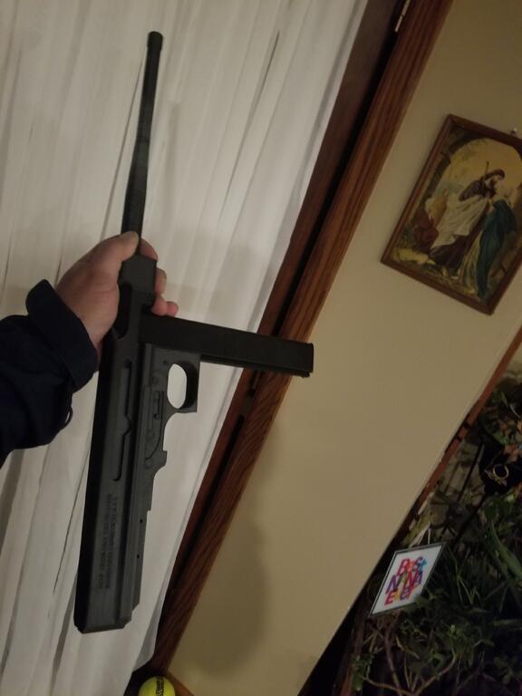

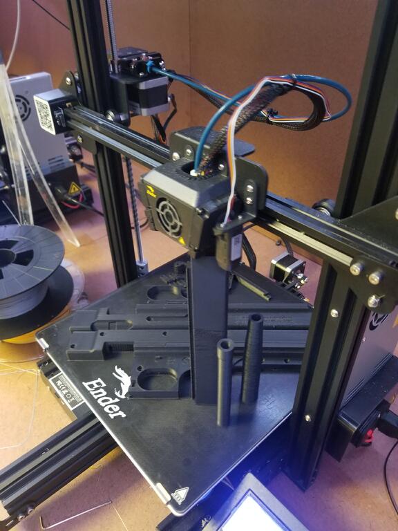

While that has now had a nozzle change and seems to be running correctly, on MAX#2(12x12x12inch) the hardware portions of a thompson sub machine gun have started!

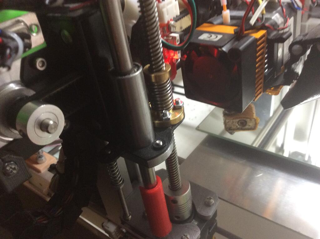

Tractorhead
Had the same issue sometimes.
Especially after a longer Printing breaks,
thought also it must be the nozzles and each time after a cleaning it works for few day‘s
my results where 2 things
1. since i allway‘s keep the feedroller clean,
to do that i use piece of sponge slides over the Filament what removes dust and dirt.
2. ground the Frame
to remove electrostatic charge /discarge
that solves lots of problems i had before with dust and dirt clamped via static on the Filament.
the Static issues in my opinion be the reason for the clogging of nozzles and for printer troubles,
sometimes more than moisture.
but depending on moisture also this can happen a clogging in the nozzle.
i heat up my printer 1/2h first after a longer break, to be sure no moisture is in bthe nozzle,
than feed some filament and we‘re ready to go.
No problem since and my again actual used nozzle is now 3 years old.
Edited by Tractorhead
  • Like 1
  • Excellent 1
Wheel Horse 3D
@Tractorhead I must've bumped that bed and knocked it outta perfect alignment, then the resulting blob etc did the nozzle in. Usually run a brass nozzle forever unless I run glow in the dark filament or run it against the bed. Have some steel nozzles that last even longer. I releveled the bed and double checked my probe offset and still wouldn't run correct until I swapped that nozzle. Probably had a side blowout that caused curling. I should have monitored those first layers closer, durn thing ended running all day just spewing plastic while I was at work. Filament and machines stay in a heated enclosure to combat moisture. Nifty idea on the grounding! Not only help keep the filament clean but should help with dust n debris on the guide rails and rollers etc.  Basically all over.

Tractorhead
Yap, that helps me to solve a lot of problems i had in the beginning.
Because i mostly print prototypes, i be not soo focused on each small detail,
 i use it primary for quick testimonials, to check the results before, or if they will fit.
i.eg like my carb spacer i built for my Ford Transit Project, before i machine them in Aluminum.
The few meters plastic is much cheaper and easier to get than a machined Part.
My Bed is just manually leveled once and secured by spring preloaded Screws.
while the whole printer is in a heated enclosure, i never need a recalibration since.
that all helps me a lot.
Used print heights are between 0.4mm - 0.25mm
thats accurate enough for my needs.
Another big help was the electric separating of my z- axes, each motor has its own Driver now.
actually there be much better motor drivers available, but i use it not that much that i was the upgrade worth.
my biggest wins where the grounding and the enclosure with Leaded Airstream for Cooling.
