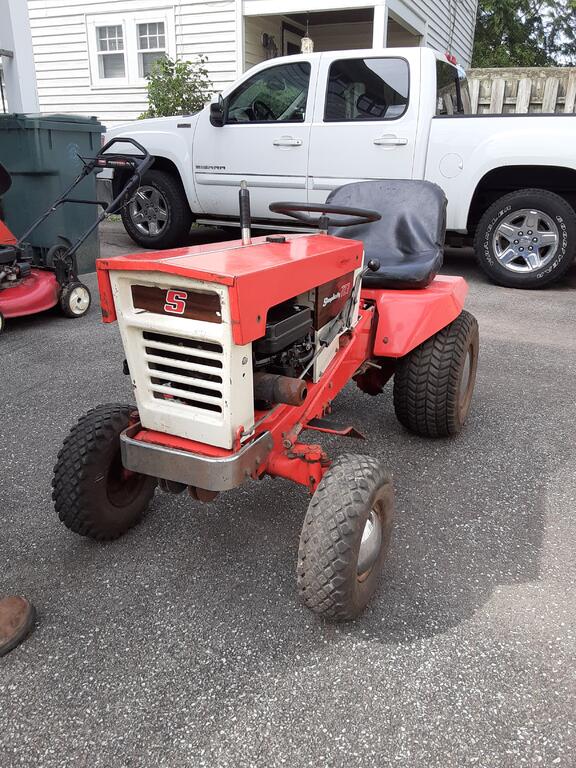

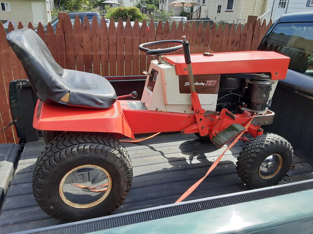

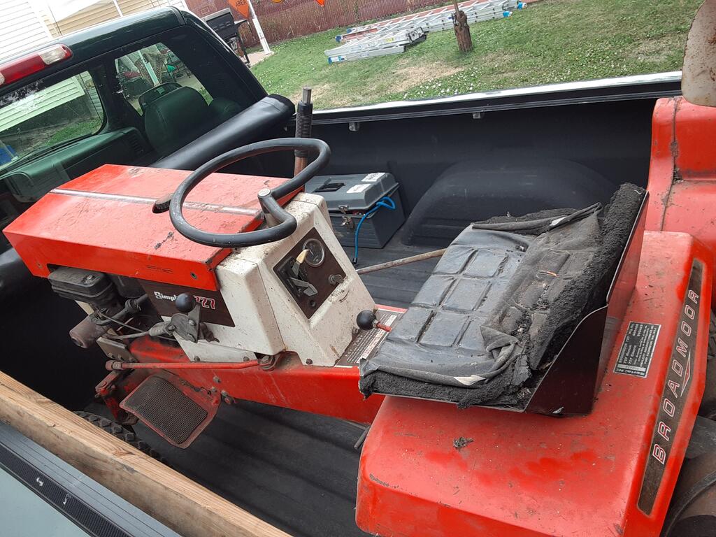

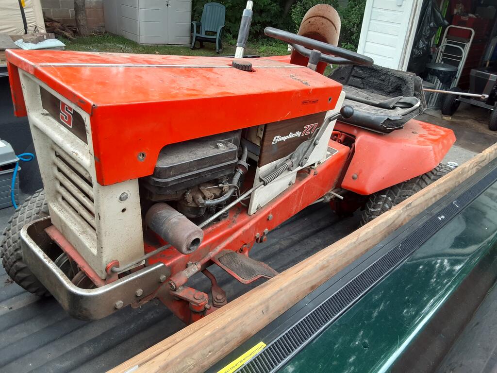

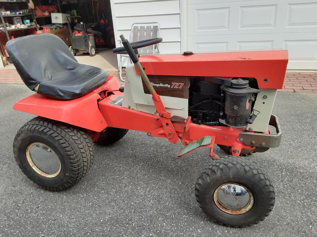

D_Mac 9,337 #1 Posted July 11, 2020 Well I asked if I should and none of you stopped me, I blame all of you ! After seeing this at a garage sale and passing on it, I had a change of heart and decided to go take a better look at it. Well went back to the house and no more garage sale and no one living there. Drove by the house several times until today when I saw someone there. He still had it. Took me a lil bit to get it to "roll". I saw roll but it dosnt roll. All 4 tires flat, 3 the beads are broke. Put in neutral and had to rock it some to unstick it. Well the tranny spins. Now what? I was alone and he wouldnt help me. He has a hernia and going for surgery. If I wanted it I was going to have to do it myself. Of course the driveway is long and cant get my truck down it cause of all the " garage sale stuff" that was still all over it. Dragged this POS all the way to the street. Now what? I had my ramps but its not rolling because of the tires. First I tried lifting the front on to the tailgate. Guess what... cant do that cause this thing twists in the middle. Cancer has made me much weaker then I was. I used to be able to lift the front ends on tailgate then lift up the back to shove it in. Not anymore. So i was struggling hard to get it up the ramps when a 72 year old man taking a walk offered to help me. Thank God ! I shoved it from behing, then he held the brake until I got a better grip and footing to shove again. Repeated that untill my heart was thumping out of my chest and I got it in. Thank God again. Well here it is.... home now. It is still in the back of my truck as it started pouring rain right after I took these pictures. The owner didnt charge for it as he WATCHED me fight so hard to get it. Took me over an hour. Well its " ours " now. You know the drill.... I need help. Anyone with any advice on these I want to hear it. Can anyone tell me what that thing on the back is ? As you see it came with the snow blower... is that thing on the back part of the snowblower attachment? I need to figure out how I am going to get it down and try to get air in the tires. Wish me LUCK ! 7 1 1 1 Share this post Link to post Share on other sites

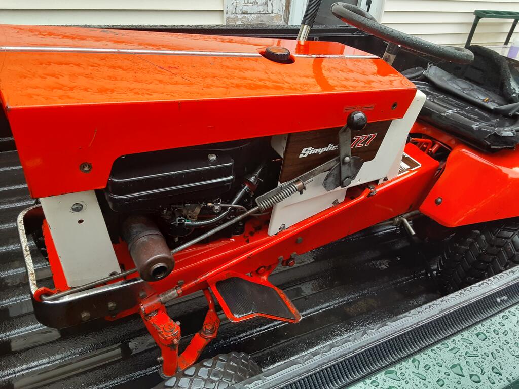

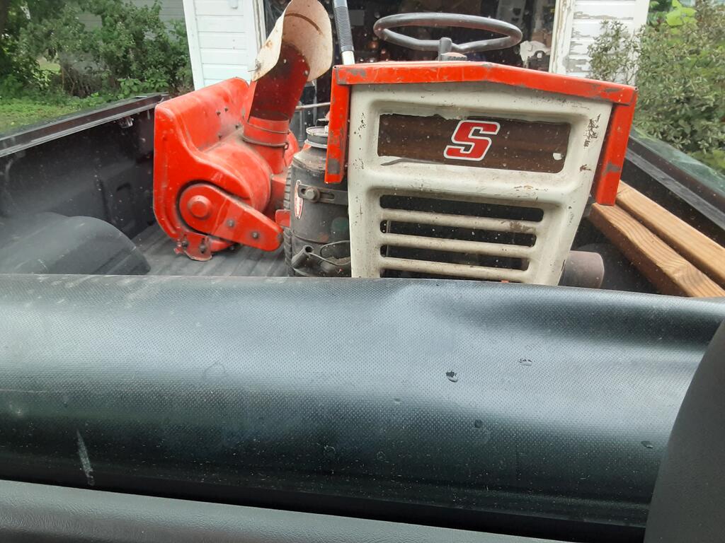

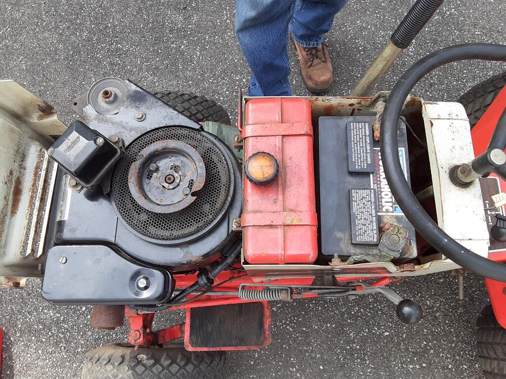

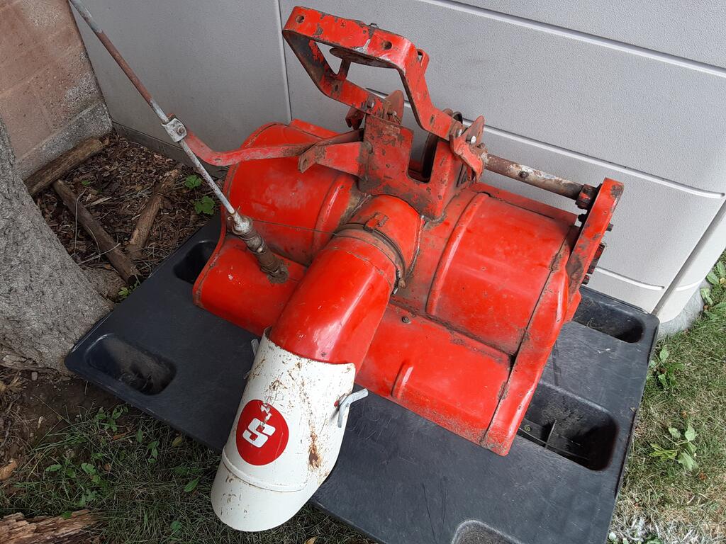

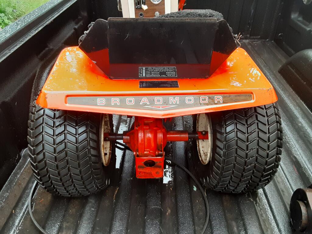

D_Mac 9,337 #4 Posted July 11, 2020 Anyone have an idea whats on the back of it? Share this post Link to post Share on other sites
WHNJ701 4,173 #5 Posted July 11, 2020 29 minutes ago, D_Mac said: Anyone have an idea whats on the back of it? weight for the snowblower Share this post Link to post Share on other sites

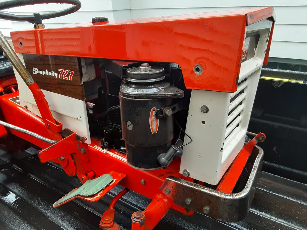

D_Mac 9,337 #6 Posted July 11, 2020 17 minutes ago, jabelman said: weight for the snowblower I think you are right. I just ran out in the rain to take a better look. Looks like just weights. Wish it would stop pouring out so I can take a better look at it all. Looks like a car battery in it as well. Can we talk about the size of that starter. Over kill for an 7hp dont you think ? So what I have read this is an off brand of Allis Chalmers ? Does anyone know the reason why it pivots before the rear wheels? It twists there. I know its designed to do it but why? Share this post Link to post Share on other sites

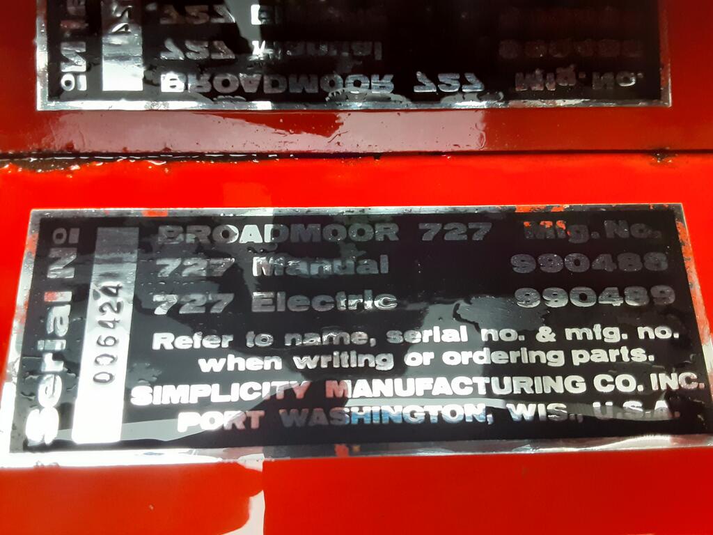

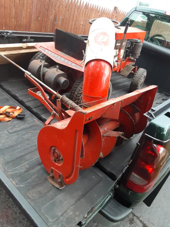

gwest_ca-(File Mod) 12,397 #8 Posted July 11, 2020 Found the 990489 model number and then the manuals for the 727 https://www.simplicitymfg.com/eu/en_gb/search.html?searchrequested=990489 Manuals for 990477 snowthrower https://www.simplicitymfg.com/eu/en_gb/search.html?searchrequested=990477 Garry 1 Share this post Link to post Share on other sites
D_Mac 9,337 #9 Posted July 11, 2020 11 minutes ago, gwest_ca said: Found the 990489 model number and then the manuals for the 727 https://www.simplicitymfg.com/eu/en_gb/search.html?searchrequested=990489 Manuals for 990477 snowthrower https://www.simplicitymfg.com/eu/en_gb/search.html?searchrequested=990477 Garry Sweet.. thanks Garry Share this post Link to post Share on other sites

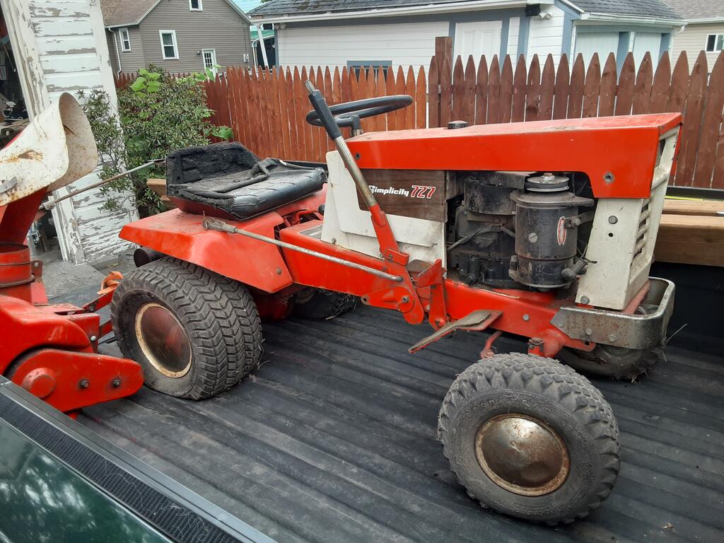

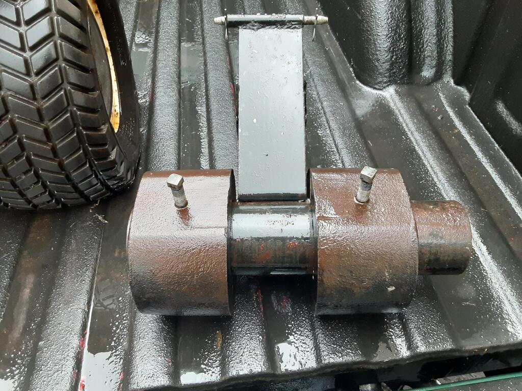

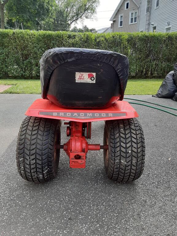

elcamino/wheelhorse 9,363 #10 Posted July 11, 2020 It twists in the middle because engineers designed it and no body has any idea why. It takes some getting use to the ride. 1 Share this post Link to post Share on other sites
ebinmaine 79,828 #11 Posted July 11, 2020 Nice save D. Really is a cute little guy. The center twist ... Is it side to side like a front end loader? Pivot steer AND the front wheels steer?? Share this post Link to post Share on other sites
elcamino/wheelhorse 9,363 #12 Posted July 12, 2020 The front wheels steer , the rear articulates with ground. If the ground on the right side is higher than the left , the right side rear tire rises. No pivot point on the front axle . It a strange set up , on level ground you don't notice the difference . If you take a good look at the front axle you can see where it is welded to the frame. See the last picture. 2 Share this post Link to post Share on other sites
oliver2-44 11,652 #13 Posted July 12, 2020 Can you block it up on the truck and pull and fix the tires The you can reinstall them and it’s a roller Share this post Link to post Share on other sites
WHNJ701 4,173 #14 Posted July 12, 2020 Looks nice, I would keep it all original, clean and shine it up. they are kind of an odd tractor never really held much in value. might want to check our the simplicity forum for more info Share this post Link to post Share on other sites
D_Mac 9,337 #15 Posted July 12, 2020 Yes @ebinmaine it is a weird design. The front axle is stantionary, most front axles pivot in the center. This pivots the rear end. @elcamino/wheelhorse explained perfectly. I wonder how many riders fell off before they changed this design ? @oliver2-44 I plan on bringing over to my friends house tomorrow as I have no room to put it again. I sold the C-161 and had a spot cleared in my garage but the guys painting my house have all there stuff in there now. I will have to wait until they finish. I took the back weights off. I wish I would have removed them when I was loading it !!! Should make getting it off the truck easier. I will just get tubes for the tires and put them in at my friends. Then I will see about getting it running. @jabelman yes the paint on it is great for being 1969. Couple small rust spots but it shines nice. Funny it has sat in a garage under cover for many years and one day with me and its out in the pouring rain. I did spray it down with degreaser in the back of my truck, let the rain wash it off. Cant wait to get my hands on it. Look how nice it looks just from letting the rain wash it off. I LOVE the wood grain decals ! Reminds me of an old station wagon I had. 1 1 Share this post Link to post Share on other sites

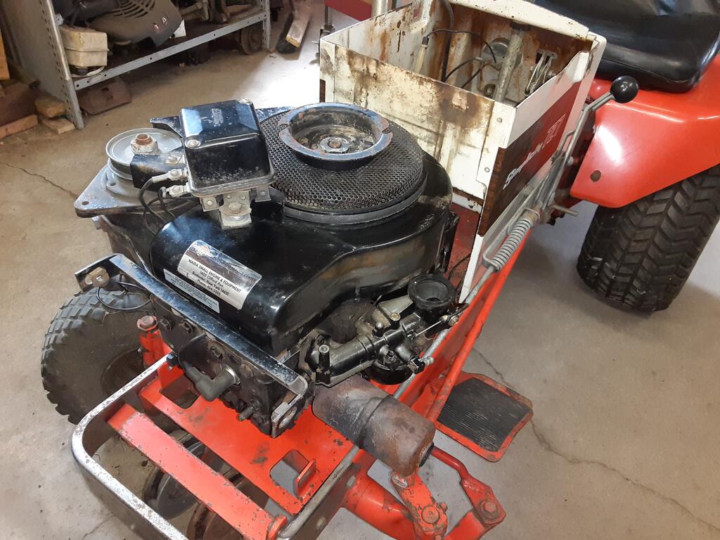

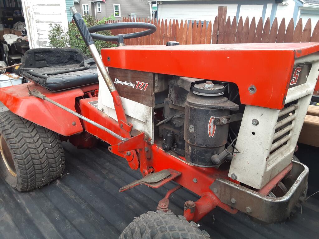

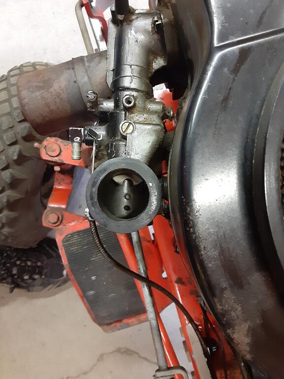

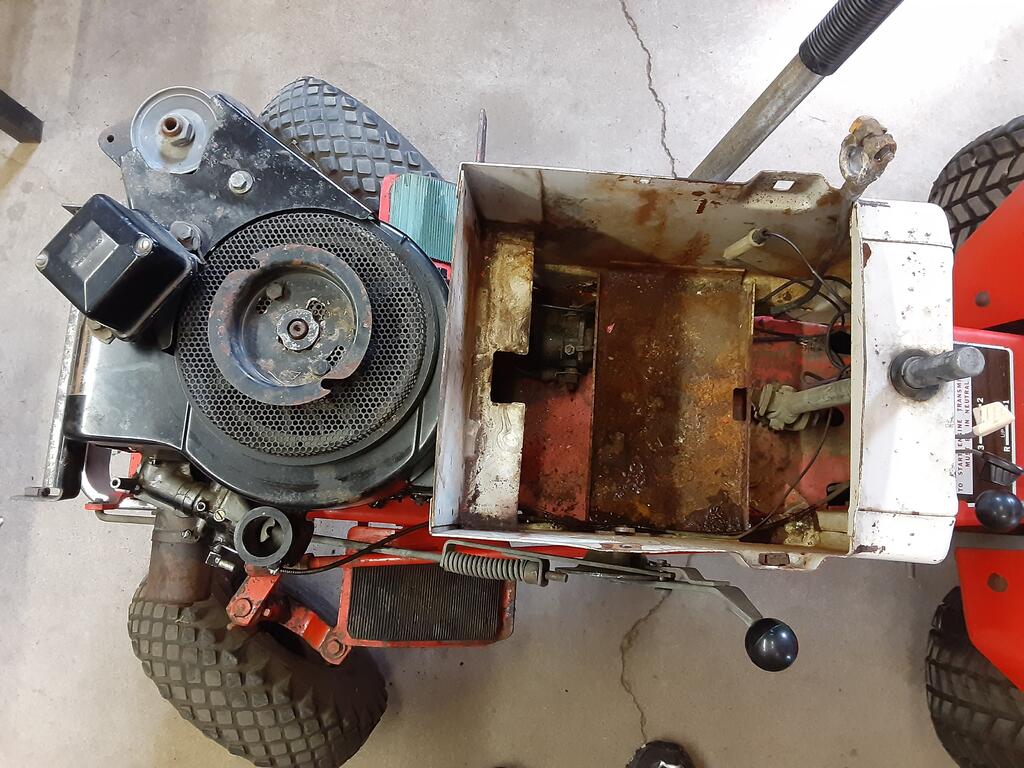

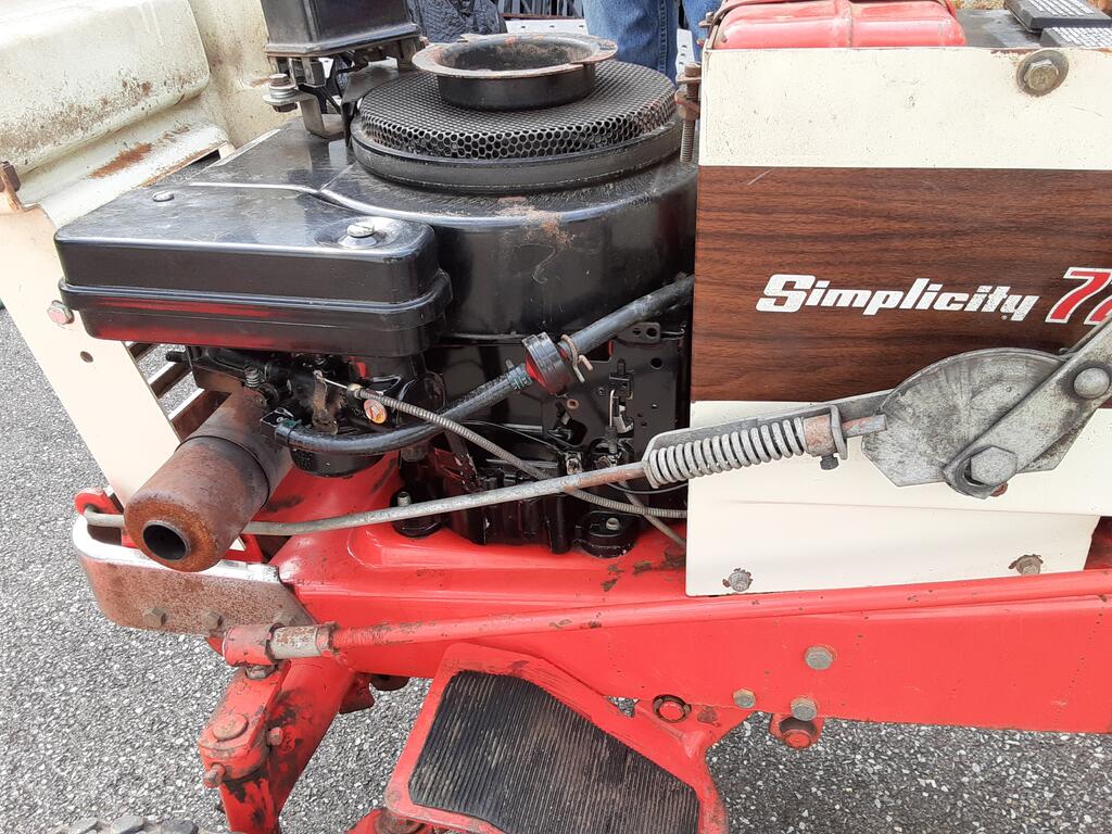

D_Mac 9,337 #17 Posted July 14, 2020 Well I worked on it today and made a few discoveries. The engine is supposed to be a 7hp Briggs # 171702. This one has a Briggs # 191700 making it an 8hp. So some where in its life time it was replaced. Since its replacement I do not think it was used much do to how new and fresh everything looked. Pulled the battery and fuel tank and to make that easier the steering wheel was also removed. I wanted to flush the tank and put gas in it to see how it runs to know if I should order a new carb or not. Took the bowl off seemed real clean. Sprayed some carb cleaner through it all. Thinking the carb was going to be fine. Well while flushing the tank I noticed a tiny pin hole on the bottom of the tank.... it was leaking. Being that you fill the gas tank through the hood I didnt want to try and figure out where and how to mount another tank so I decided to see if my cousin could solder it. Brought the tank over to his house and he lead soldered it. No more leaks. Hopefully no new holes will pop up. So tomorrow I will put new fuel lines and fuel filter on it. Change the oil and see if I can start it. Then I need to get a battery for it and replace the battery cables. Any thoughts on a battery? Do I need to replace it with a full size battery or will a smaller tractor battery be fine? Not going to get the cables until I know what battery I am going with. The battery I pulled out was an Interstate Workaholic Sp-22NF. Rather not buy such an expensive battery if a cheap tractor battery will do. Let me know your thoughts. @squonk you have an opion? Thanks 1 Share this post Link to post Share on other sites

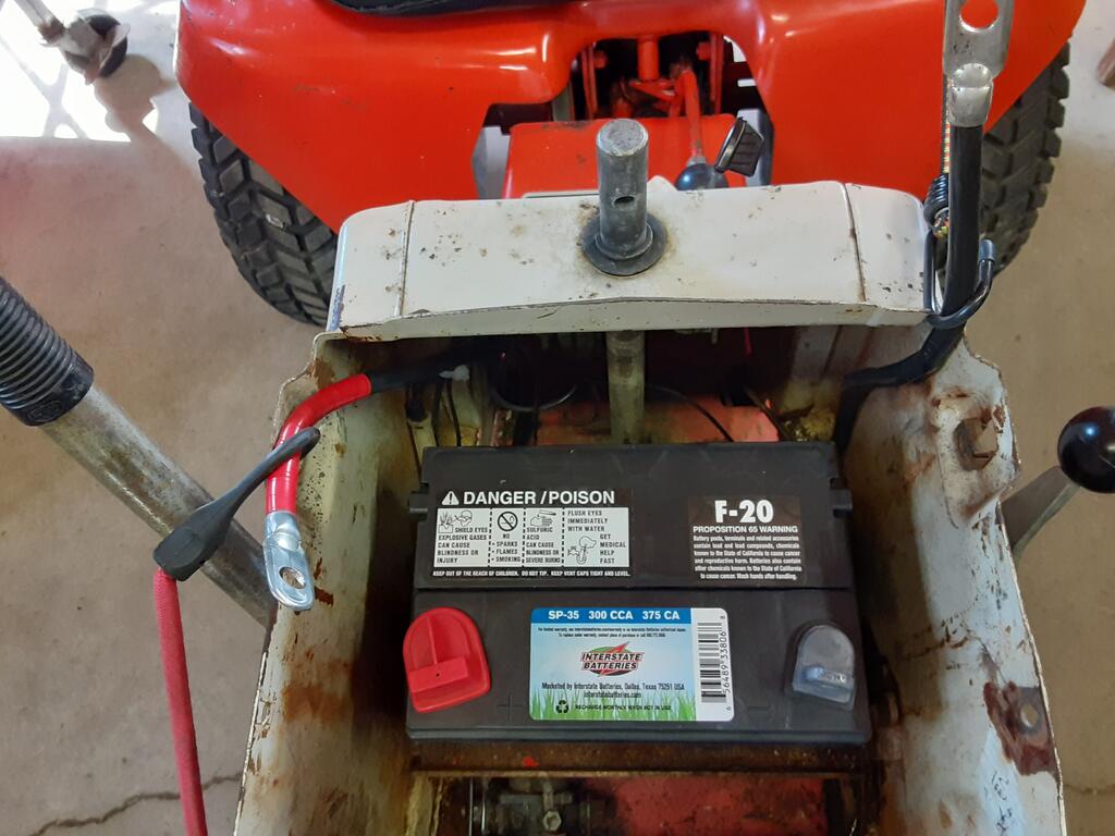

squonk 47,508 #18 Posted July 14, 2020 (edited) All you need is a cheap Wal Mart battery. Just be sure you get one with the terminals in the correct position. You also might want to replace that white fuseholder with an automotive blade fuse holder. Those white ones are know to cause issues as they get old. Edited July 14, 2020 by squonk Share this post Link to post Share on other sites
D_Mac 9,337 #19 Posted July 14, 2020 Thank You. Not sure how to swap out the fuse. I dont have any fittings or anything either. I would be just twisting wires together and wrapping with tape. I will look when I go get a battery and battery cables today. 20 amp ? 15 amp? Share this post Link to post Share on other sites
squonk 47,508 #20 Posted July 14, 2020 Go to Harbor Fright and pick up a solderless terminal kit and a crimper. Strip the wires stick them in a butt connector and crimp Share this post Link to post Share on other sites

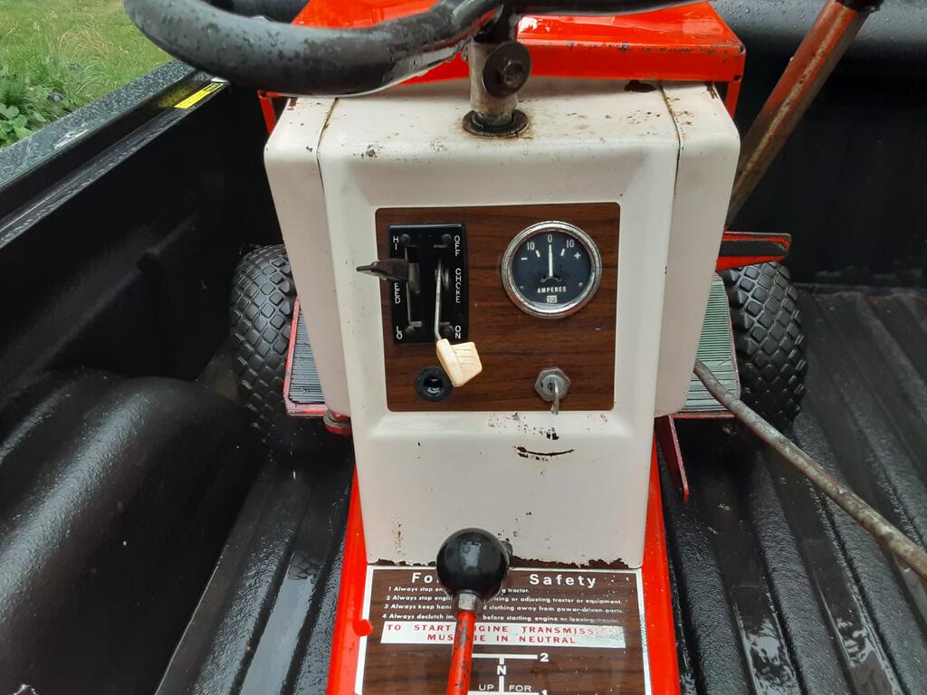

D_Mac 9,337 #21 Posted July 15, 2020 Well you know what they say ... " nothings easy " . I got a new battery, new battery cables, new fuel lines and fuel fitler. Had the gas tank repaired. Installed them all, turned the key, and nothing ! No turning the engine over, no click, no nothing. Ouch. So while I still had it all together I wrapped a rope around it gave it a pull and it started but would only run if I had choke wide open. So it looks like its back to the drawing board. I have to pull the tank and the battery out again to get to the solenoid. Not exactly sure how to test the key switch. Comes to electrical problems I am the worst. It is at my friends house so I am limited to when and how long I can work on it. I am disappointed as I thought it would fire right up. Guess I can just rebuild the carb and wrap the rope around it if I cant figure it out. I know when it was at my cousins we used a jump box right to the S/G and it started. So I am guessing its my ground, or the key switch, or the solenoid. Disappointing.... I was thinking I would be riding it today.... Nothings easy. Share this post Link to post Share on other sites

squonk 47,508 #23 Posted July 15, 2020 Depending on how it's wired (or was wired) it could be that fuse holder I mentioned that I see you didn't change. I don't see any lights on that thing so I don't know what else that fuse is for. Check your wires on the ammeter too. Share this post Link to post Share on other sites
D_Mac 9,337 #24 Posted July 15, 2020 @squonk That fuse goes to the Amp meter. I checked the fuse it was good. Since electrical isnt my strong suit I am thinking I might just use a rope to start it and not play with the electric start. I am wondering what can I get for it in the end. Really dont want to put a lot of money into it. I wont be working on it again for a few days. Still at my friends house. He was going to look at it see what he finds. Share this post Link to post Share on other sites
squonk 47,508 #25 Posted July 15, 2020 (edited) Where does the other end of the fuse go? The fuse isn't the problem, it's the spring inside the holder that's the problem. They rust, they corrode,they break and they don't allow electricity to flow. You would get a hell of a lot more for it if it started with the key. Edited July 15, 2020 by squonk 1 Share this post Link to post Share on other sites
