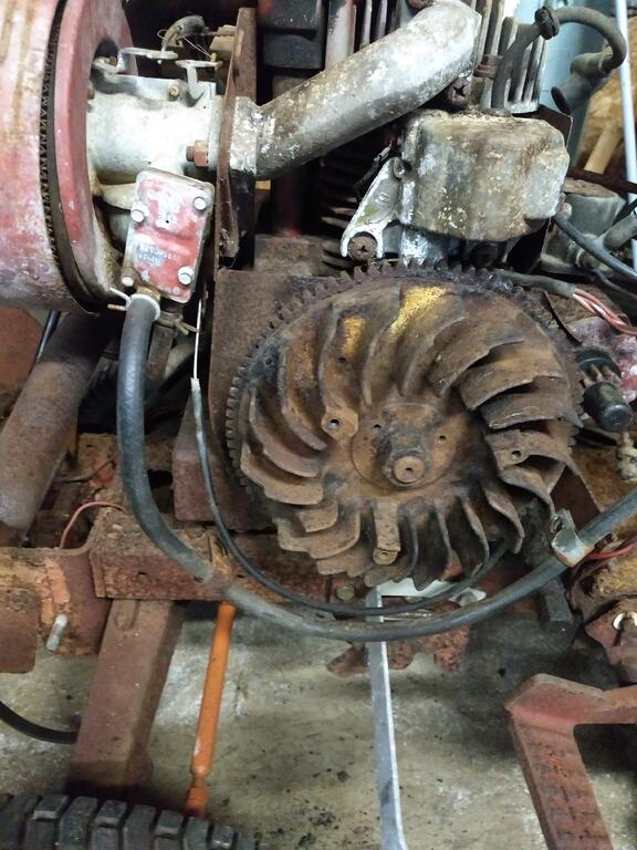

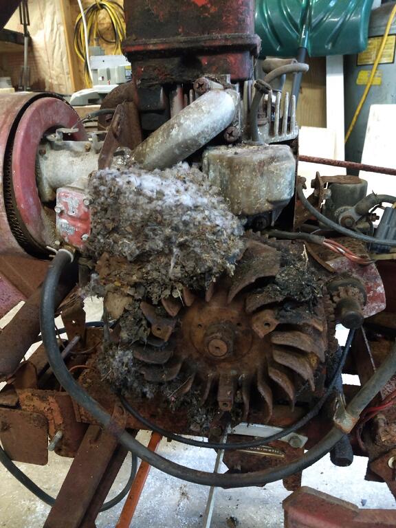

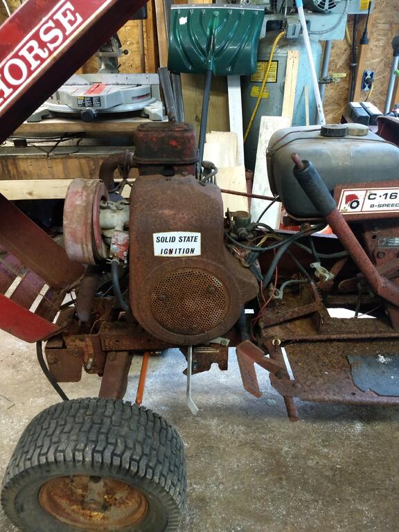

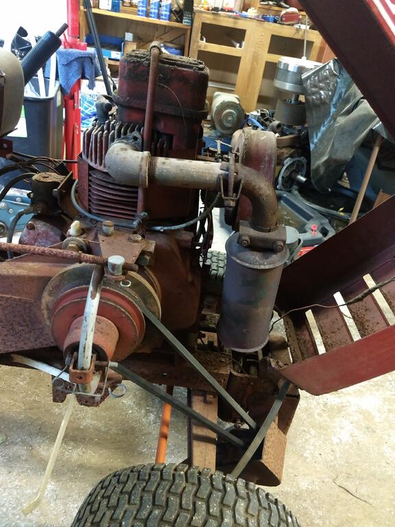

I removed the engine tin and cleaned out the Rodent Ramada.
The drive belt spun off the transmission pulley which is rusted to the point of breakage. That's good because it saved me removing the belt. :lol:
There are some places/things about the tractor that are quite solid.
Steering wheel has the original cap. Steering system is nice and tight.
Seat back has been replaced and is nice. Seat base is original and very good.
The hitch pin and one hub are loose.
The muffler is an OE Nelson and rock solid.
@Docwheelhorse
I did find why it may have been parked originally. The voltage regulator wires were leaning heavily on the steering shaft and worn through. From what I understand about SSI systems it's likely not working because of that but we'll see later.
Over the years the transmission has frozen up. Not a serious issue as we have a couple spares.
Here's the post cleaning picture
The belt is BESIDE the pulley.
  • Like 3

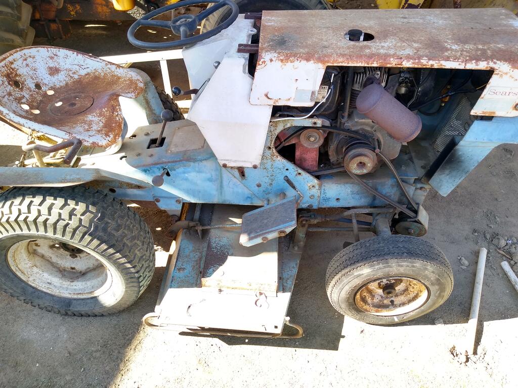

A while back I acquired a 1966 Sears Suburban that had been repowered with an OH160.  When I saw how a replacement carb cost, I almost scrapped the engine! Luckily I came across an obscure post noting that a Kohler K341/K321 carb could be made to work. I know this is a long term project and I wanted to drop this note in here in case it becomes relevant later.   $20 instead of $200+.
ebinmaine
Thanks!!
No idea if this carburetor is any good. It's free and moving so that's a good sign. I do have a spare Kohler 16 horse carb.
I appreciate you dropping that note so I can look back at it later.
Any thoughts how to find the post that you had looked at?
Vurge
1 hour ago, ebinmaine said:
Thanks!!
I think this is the place I saw it:
https://www.mytractorforum.com/threads/tecumseh-hh160-carb-question.1084882/
And here's a pic of it installed in the Suburban.  IMG_20200706_085748731_HDR.jpg.731158dcdf4db928ca241f3b276eeaba.jpg
