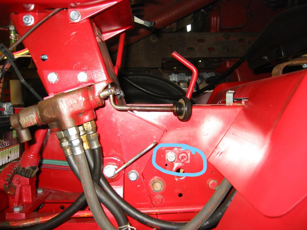

If the lift fails at the same time as tractor refuses to move then acceleration valves or charge pump relief valves are suspect.  If the lift works but the tractor won't move it could be the plate on the left side of the tractor at the end of the motion control cross shaft had broken and allows the motion control to slip some times.  Circled in Blue.
