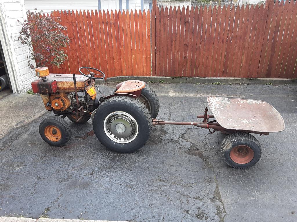

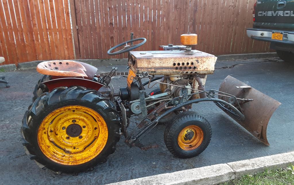

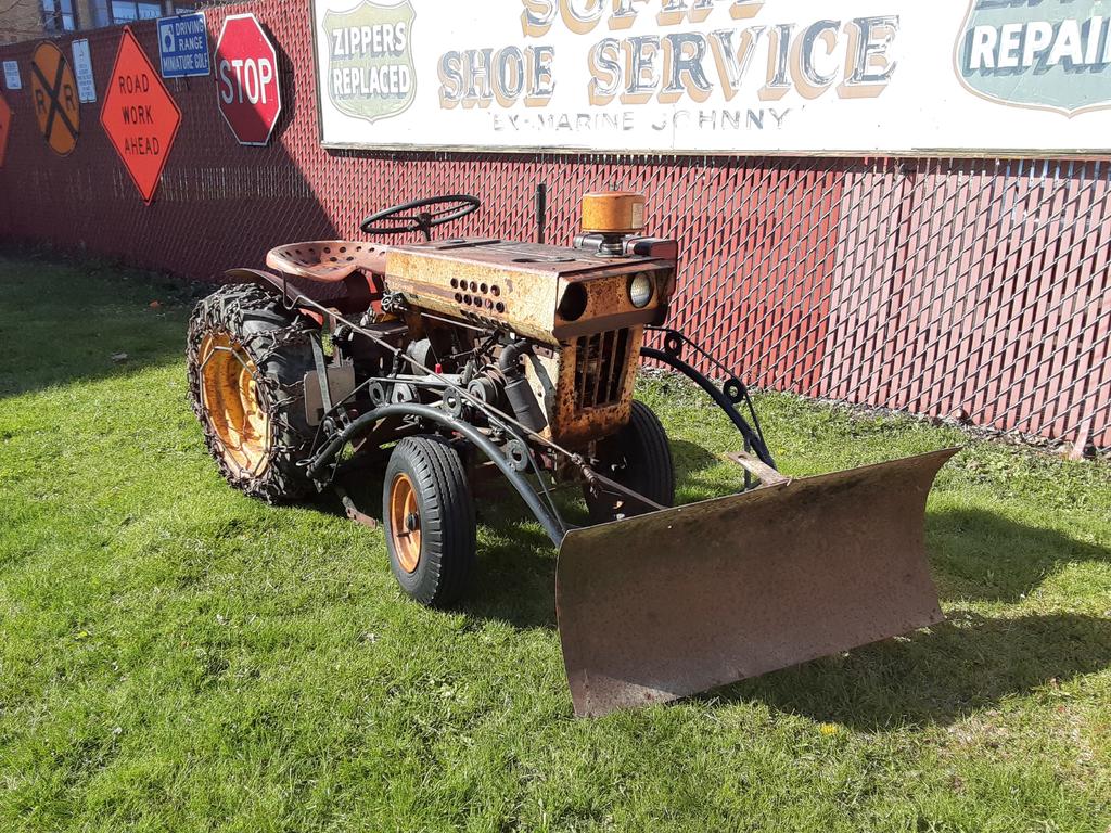

D_Mac 9,337 #26 Posted April 20, 2020 @Razorback yes that is the lever. I can pull it back it lifts the blade but only locks into the first position. The lever hits the rear tire. That why I think if I change the tires I can get it back far enough to go into the next notch. Going to work on that today. here is a pic of the left side but without the plow hooked up 4 Share this post Link to post Share on other sites
Razorback 1,370 #27 Posted April 20, 2020 I think that is a good idea to swap out the tires. For the lift lever, mine starts out at approx. the 10 o'clock position as opposed to 12 o'clock like I see on yours. Any adjustment there? Share this post Link to post Share on other sites

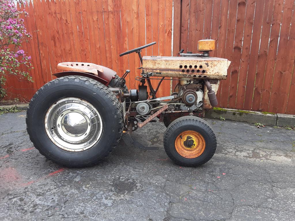

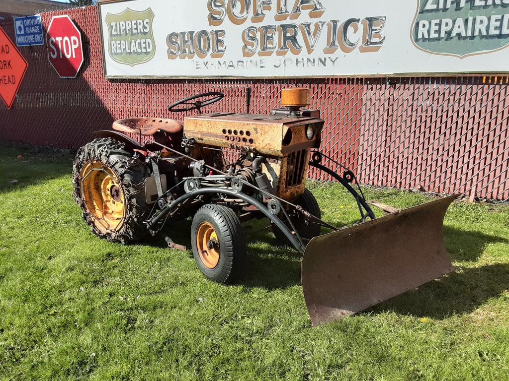

D_Mac 9,337 #28 Posted April 20, 2020 Well I worked on this plow all day today. I cant get the blade to lock into position any higher then 2 inches off the ground. I think I need to drill another hole because the locking pin seams to miss the notches that would lock the blade. It only catches the first notch. Hard to see it without an extra set of hands. I did manage to change the tires and wheels out. I believe the rims are facing backwards but this is the only way they would go on without hitting the fenders. Something must have been done to accommodate the wider car tire that was on it. Now I am undecided as to what set up I like better. Any thoughts ???I am thinking about removing the plow and taking the chains off these tires. That way I can still take it out for some " hot laps" as @pullstart calls them. In the photo thats as high as I can lock the plow. If you hit a pretty good bump in jumps out too. My next question will be how to get the chains off and what direction should the tread be going. I think I have um on backwards? 4 Share this post Link to post Share on other sites
SylvanLakeWH 31,857 #29 Posted April 20, 2020 Tread is correct direction. Both tires look cool. These will be a lot bumpier. Definitely off the chains to save your grass and pavement... 1 Share this post Link to post Share on other sites

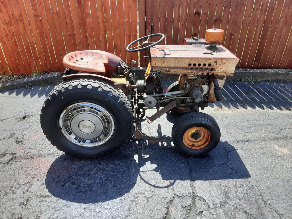

953 nut 67,760 #30 Posted April 20, 2020 1 hour ago, D_Mac said: Now I am undecided as to what set up I like better. Any thoughts ??? Bigger is always better! Ditch the Chevy hubcaps though. 1 1 Share this post Link to post Share on other sites
Pullstart 70,909 #31 Posted April 20, 2020 23 minutes ago, 953 nut said: Bigger is always better! Ditch the Chevy hubcaps though. I agree! Except for the Chevy hubcaps! 1 1 1 Share this post Link to post Share on other sites
Pullstart 70,909 #32 Posted April 21, 2020 Any way to get that plow onto a floor jack and see how high it could possibly get? That would be a perfect place to drill for a travel position pin Share this post Link to post Share on other sites
D_Mac 9,337 #33 Posted April 21, 2020 6 minutes ago, pullstart said: Any way to get that plow onto a floor jack and see how high it could possibly get? That would be a perfect place to drill for a travel position pin It will go above the hood but wont lock it. The pin that locks it is stationary. The notches on the plate that the pin is supposed to go fit in travels. It is arched so when you lift it it misses the pin. I have a hard time believing that the guy can build the whole tractor but misses the mark on this. I keep looking for something I am doing wrong. @953 nut What have you got against the hubcaps ? Is it a Chevy thing? What if i got cooler hubcaps? 1 1 Share this post Link to post Share on other sites

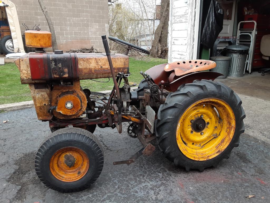

Razorback 1,370 #34 Posted April 21, 2020 Hubcaps or not....... I keep coming back to that sprocket under the tractor. Without having the tractor to look at, I am wondering if that armstrong lever can be utilized with some kind of attachment to that sprocket to rotate that shaft that the blade arms fasten to? Isn't that what is rotating as lever gets pulled back and the blade goes up? Share this post Link to post Share on other sites
Razorback 1,370 #35 Posted April 21, 2020 Also: I know there may be other awesome members near you, but I KNOW that @Chris G is nearby. He is a genius, in my book...... see if you can contact him. 1 1 Share this post Link to post Share on other sites
D_Mac 9,337 #36 Posted April 21, 2020 (edited) @Razorback I was looking at that sprocket today to see if in anyway could help with the raising and lowering of the plow. I couldnt see anyway it was or could be connected. Right now you have to muscle up that blade by pulling that lever. Its very heavy and puts a lot of strain on that lever. I could see it bending or braking. Plus its left side making it harder if your not left handed. I think original Speedex set up has similar set up where that lever raises or lowers an attachment in the front or raises or lowers attachment on the hitch on the back. Is that how yours functions? The hitch in back is welded stationary on this one and that sprocket as well as what it is mounted to was made by who ever built this thing. Yes I wish I could get another set of eyes on it. Coronavirus isnt making that easy. I am not very mechanical that being said also means I dont have the tools to improve anything on my own. I most likely will take the plow off and stash it away. At least that way I can still tool around on it. I also spotted the seat is starting to split where it bolts down.... ugh Edited April 21, 2020 by D_Mac 4 Share this post Link to post Share on other sites

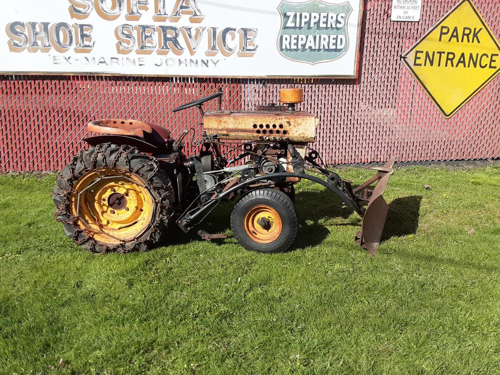

WHNJ701 4,173 #39 Posted April 22, 2020 Looks great in the last pic.. no hub caps! wonder if your missing something, maybe something attached to the upper middle part of the plow, can you change the angle of the plow? 1 Share this post Link to post Share on other sites
D_Mac 9,337 #40 Posted April 22, 2020 You can change the angle of the plow with the long lever. Twist it inward it unlocks it. Push it in you angle it to the left. Pull it back you angle it to the right. What I dont know is what the brackets are for that are between the wheels. If you look at the plow frame where it bolts to the frame of the tractor you see a little dog leg on the tractor frame that something bolted to. Above that mounted on the plow frame you see that long bracket that runs north and south and has a notch and a hole at the top of it. I can not figure out the purpose of either. Since its all custom made I cant see why he made them if they didnt do anything. It is possible I dont have all the pieces. that being said I cant think of a purpose for them. Do not give up on the hub caps !!! Share this post Link to post Share on other sites

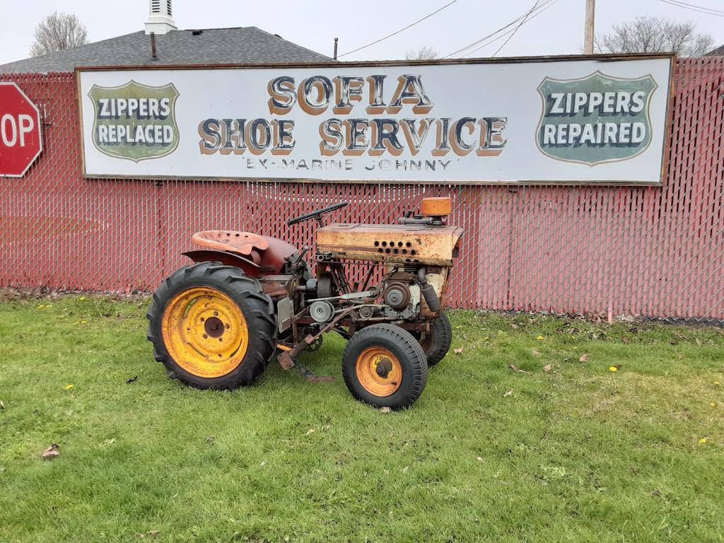

D_Mac 9,337 #41 Posted April 25, 2020 (edited) Well, worked on this thing all morning with little to show for it. My cousin stopped by to see it. He is a good mechanic and I was looking forward to his opinion on it. After his inspection he couldnt figure it out either ..lol. I ended up replacing the brake cable I installed after I got it to a better cable. We welded the seat that had split around the hole where you bolt it down. We also drilled another hole in the seat spring to move the seat back a bit. I am 6'5 so every little bit of leg room helps. After he left I removed the plow. Didnt see my self plowing with it anytime soon and more fun tooling around on it without it. I was going to swap the tires and wheels over but these are starting to grow on me. It also seems to be running better. Started on one pull today. Must be that Seafoam running through the carb is helping. That all being said I think thats as far as I can go with it. Not sure what I am going to do with it. I am happy it didnt find its way to the scrap yard. I will keep all the pieces together. The dump cart, lawn roller could be used on other machines but the plow no. All built by the same guy so all will stay together. I believe the axle used on the dump cart was the front axle from the Bonanza, whos hood and grill was used on the tractor. Here is how it sits now with the tractor tires on it. I have a different set of hubcaps I would like to see on it but alot of negative feed back on hubcaps. I have a pair of hub caps off of a 55 Chevy that I think would look pretty cool. Edited April 25, 2020 by D_Mac 2 3 Share this post Link to post Share on other sites
SylvanLakeWH 31,857 #42 Posted April 25, 2020 Great job with everything! Such a cool piece of unique Americana!!! I applaud you for saving it and keeping it all together as a package. Regarding the hubcaps, aesthetics (if you can use that word related to this beauty) etc. - everyone’s got their opinion but you’ve got the tractor... yours is the only opinion that counts!!! Do what you want and enjoy it!!! Thanks for letting us come along, especially with the pictures!!! 2 1 1 Share this post Link to post Share on other sites
D_Mac 9,337 #43 Posted April 25, 2020 @SylvanLakeWH Thank you. Things worked out as far as be getting it. Soon as I saw the ad on Craigslist that tractor spoke to me. Thats why I called about it. Having been out of work for a year now I was in no financial situation to buy it but like I said that worked out for me too. The owner was happy to see it go to someone who would at least try to bring it back to life and not haul it off to the scrap yard. That is the reason he parted with the rest of it, the plow, dump cart, and lawn roller. He did his part, I did mine, and when I pass it on I hope next owner will take it to the next level. Today I might try to mount a tool box to the dump cart or to the rear hitch of the tractor. Just to carry maybe a chain, pair of gloves, some tools ...etc. Also thoughts on keeping the finish. I rubbed it down with boiled linseed oil. Is there a better way to preserve it? Clear coat ? Clear coat even possible after wiping it down with oil? I see some of you guys wipe it down with WD40 anyone have any input on this? 2 Share this post Link to post Share on other sites

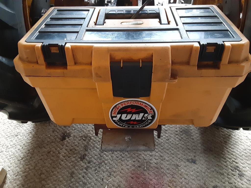

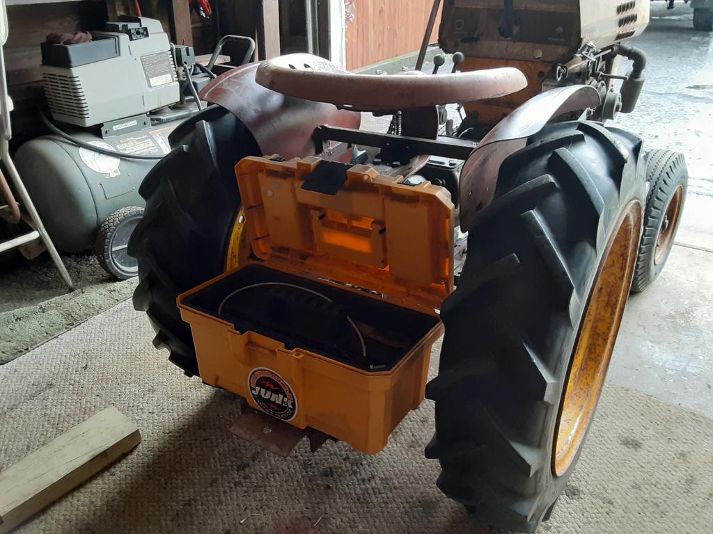

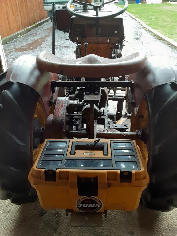

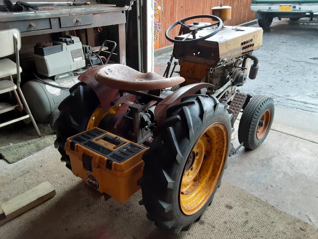

D_Mac 9,337 #45 Posted April 26, 2020 Was out this morning working in the rain. I wanted to fasten a small toolbox on the back hitch. I had a nice old metal toolbox that I was going to use but it was a bit to long so I had to settle for this plastic one. ( for now). Pretty simple, metal plate to extend the hole out so you can still hook up the dump cart and lawn roller. Box drilled a couple holes in the bottom and bolted it through. Now you can carry some tools, chain, lunch...whatever. Going to keep my eyes open for a beat up metal box. Yesterday I did what you guys refer to as " seat time". I hitched up the lawn roller and rolled my lawn ! Felt good. I am reading up on how you change the exhaust. I would like to put a little stack on it. I thought maybe just turn the one that is on it up. To do that I need to extend it out another inch. 2 Share this post Link to post Share on other sites

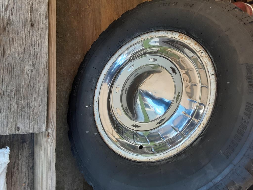

D_Mac 9,337 #49 Posted April 27, 2020 @ebinmaine well thank you for the advice. Today I decided to swap out the tires and wheels again. Ran into a bit of a problem doing so. I guess I tightened the lugs a little to hard when I did this the first time as I stripped to of them. To fix the problem I am just going to make a trip to local hardware store and just put a nut on the back side. Well the new set up looks pretty cool I must say but I think I am going to stay with the tractor tires. I know @jabelman and @953 nut are anti-hubcap and @pullstart is in the bigger is better club. I need to fix what I screwed here before I can do anything else. There are the options 3 Share this post Link to post Share on other sites
WHNJ701 4,173 #50 Posted April 27, 2020 (edited) it's good to have wheel options! Edited April 27, 2020 by jabelman 2 Share this post Link to post Share on other sites
