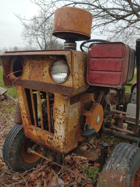

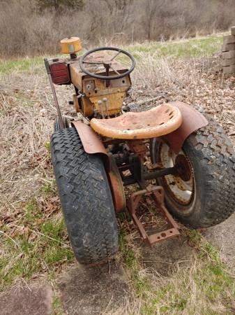

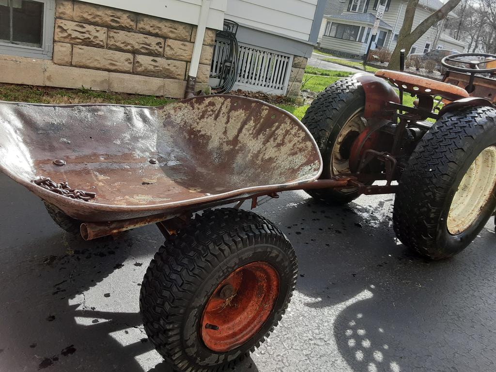

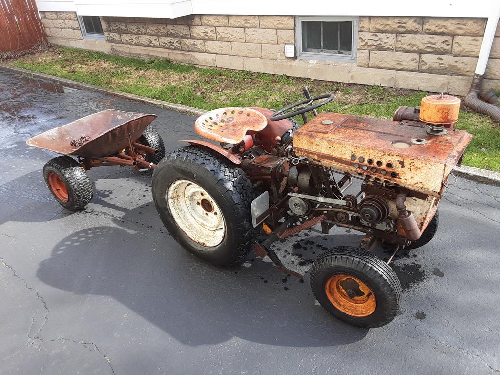

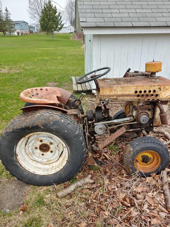

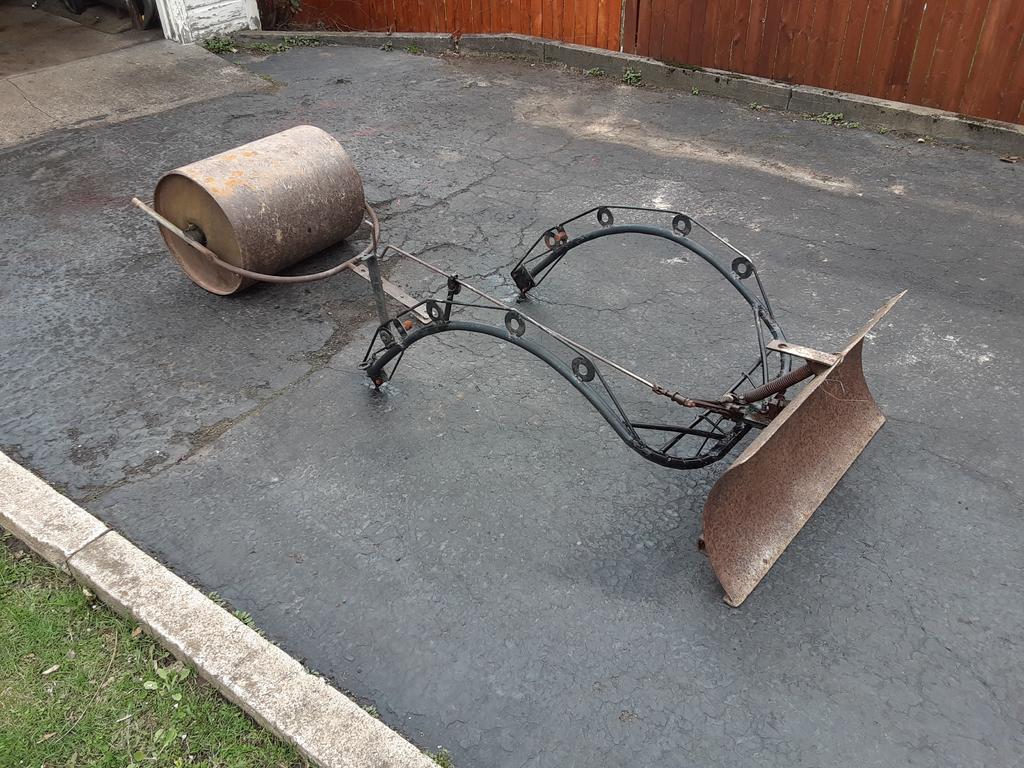

D_Mac 9,339 #1 Posted April 19, 2020 (edited) Well some may have seen this project in different posts. I will run through the story quick. Picked it up last weekend after seeing an ad for it on Craigslist. Owner just purchased the house and things had been left behind that he just wanted gone. He told me I could have the tractor for 20 dollars but later gave me everything for free. My first trip I picked up the tractor and the dump cart. I am not @pullstart so that is all I had room for in my truck. After getting it home and posting it on here we are all in agreement that it is a Speedex frame and rear end, a Borg Warner 3 speed transmission, an Alling-Landers gear reducer, a Briggs 8hp engine and a Bonanza hood and grill. A true Mad Scientist fabrication. Took me little time to get in running and moving under its own power. Surprised as it sat outside for a few years and I have limited mechanical skills. I went back today to get the rest of it today, a plow and lawn roller. Started raining and I have to work in the driveway so I couldnt finish monkeying around with it but here it is so far. I think it is missing some mounting brackets for the plow. Have to try and figure it out when rain stops. What cha all think? Edited April 19, 2020 by D_Mac 1 8 3 Share this post Link to post Share on other sites

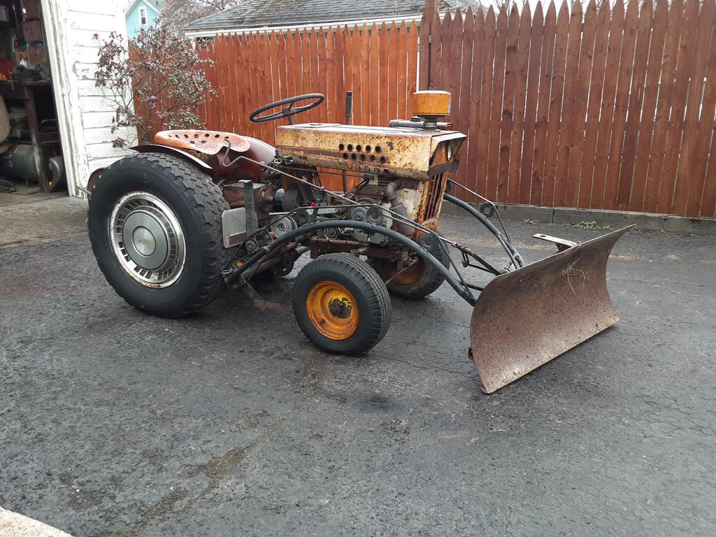

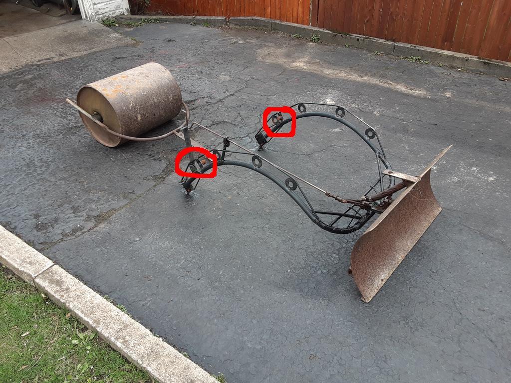

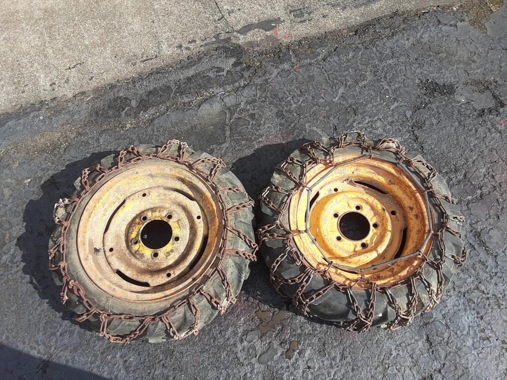

D_Mac 9,339 #5 Posted April 19, 2020 I wont ever paint it. I wiped it all down with some boiled linseed oil. It still needs more cleaning. There was caked on dried out grease and dirt all over it. Scrapped and power washed alot but needs more. I have to figure out the plow. Dosnt seem like it would push a lot without folding up. I can raise it but only about an inch of the ground. I am thinking with the other tires I can lift it higher. I think of Chitty Chiity Bang Bang when ever I see it. But instead of Chitty... Sh&^y Sh*&Y Bang Bang. Forgot to add I got these tires and rims as well. Havent tried putting them on yet. 2 6 Share this post Link to post Share on other sites
D_Mac 9,339 #6 Posted April 19, 2020 @pullstartyou think it will fold up when pushing something? If anyone would appreciate the build of this thing it would be you. I think the guys ideas are great maybe not so much his execution. But hey....... it all works and you wont find another one ! 1 Share this post Link to post Share on other sites

D_Mac 9,339 #10 Posted April 19, 2020 I asked the guy I got them from if he knew anything about the builder. He said the the gentleman passed away in 2018, in his eighties. He was a retired from Gleason Works where he worked as a Maintenance Mechanic. Gleasons made its name in the gear business and now big in fabrication. Explains the tractor. @Razorback That sprocket dosnt do anything be nice if it did. You have to muscle up the blade with the lever. I can only get plow off the ground about an inch. I believe if I swap out the tires I can get the lever back far enough to raise up to the next notch but now the lever hits the wheel and falls short of getting in the next notch. Like I said it started raining when I got the plow home and I only just mounted it. No room in garage to work in. Tomorrow I will see about changing the tires over. 1 Share this post Link to post Share on other sites
Ed Kennell 47,143 #11 Posted April 19, 2020 AWESOME Is that a brake pad on the tire? That could get ugly with the chains on. This may be some of his work. 5 2 Share this post Link to post Share on other sites
ol550 878 #12 Posted April 19, 2020 Let's see now, a bicycle sprocket and a chain wrapped around a rear wheel. Think you need to go back and find the missing parts. There has to be a connection. Share this post Link to post Share on other sites
D_Mac 9,339 #13 Posted April 19, 2020 I think at one time it may have lifted the rear hitch and maybe an original plow set up for Speedex. LOL None of this is original. But I am sure it must have done something because what it is mounted to now isnt an original part of the frame. I am afraid there are some parts that got left behind. I see things mounted on the plow frame that line up with those lower brackets on the frame of the tractor. not sure what went there. 1 Share this post Link to post Share on other sites

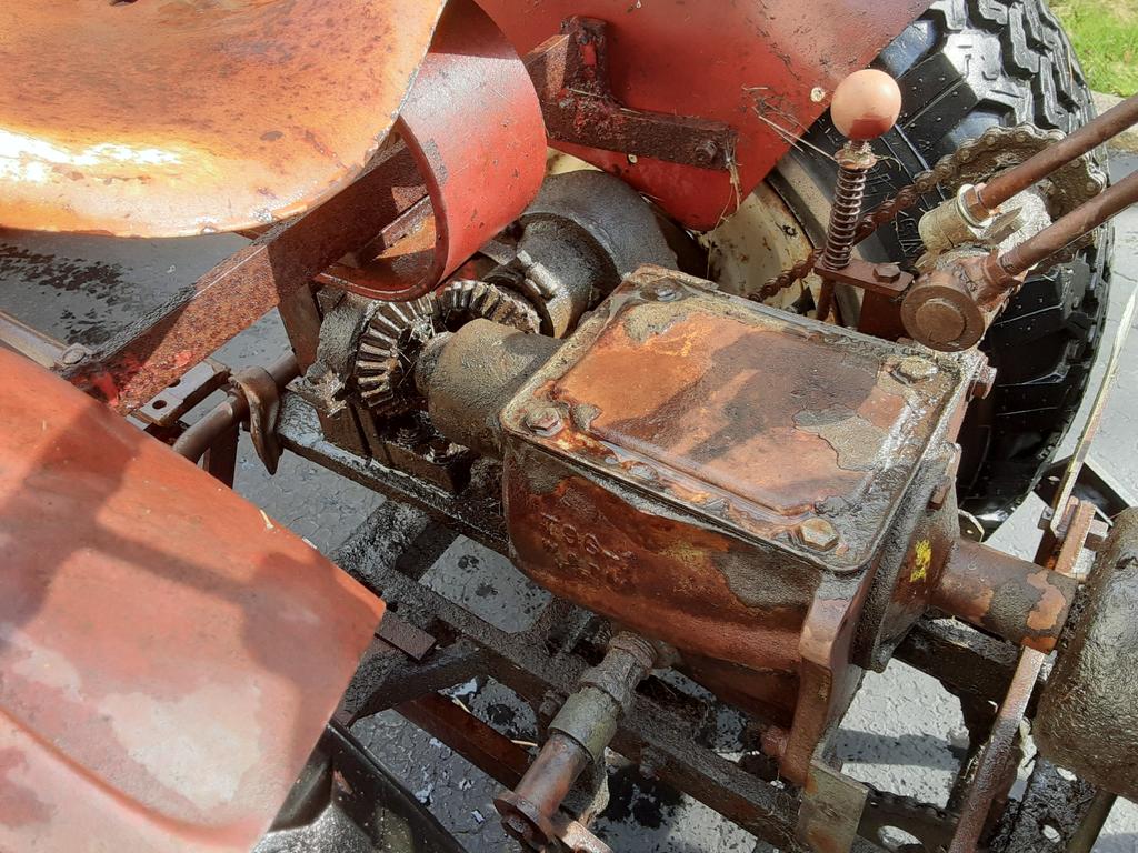

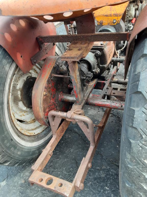

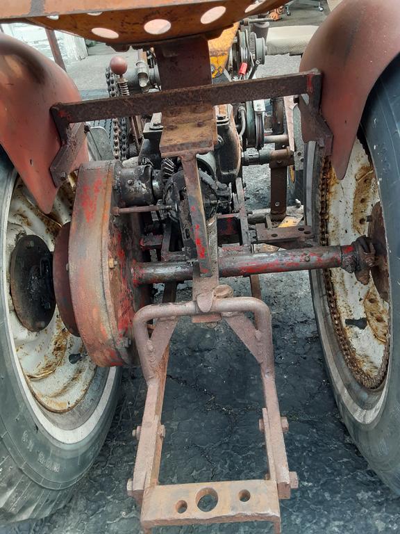

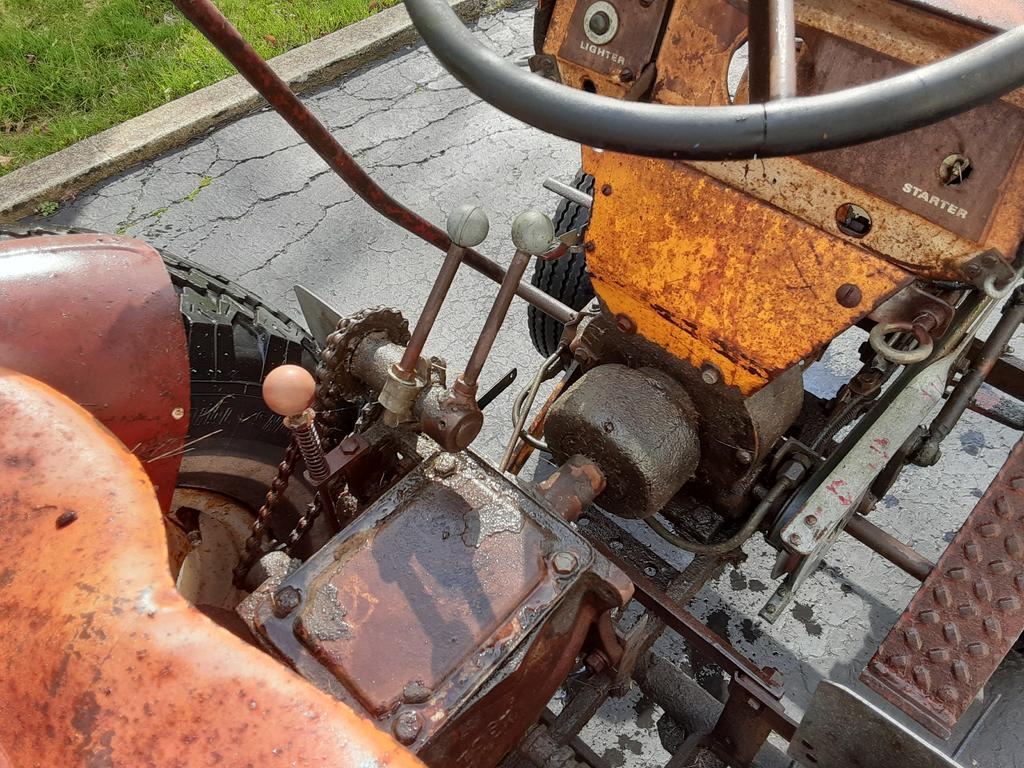

Razorback 1,370 #19 Posted April 20, 2020 (edited) The modification to the rear wheel drive is interesting. Speedex drives the rear end with a chain to the shaft at the top of that tear-drop shaped drive box. This guy modified it to be driven by those beveled gears. The chain that is welded to the inside of the right rear wheel was obviously used to drive something. I see a bracket that must have had something mounted there that had a sprocket on it. It will be fun to learn what was driven by that sprocket under the tractor. Still looking at pictures........ Edited April 20, 2020 by Razorback 1 Share this post Link to post Share on other sites
WHNJ701 4,173 #20 Posted April 20, 2020 as awesome as that machine is, looks way better without those hub caps! 1 Share this post Link to post Share on other sites
Razorback 1,370 #21 Posted April 20, 2020 Is that a belt-driven hydraulic drive to that gearbox?? Belt(s) coming from the engine! Share this post Link to post Share on other sites

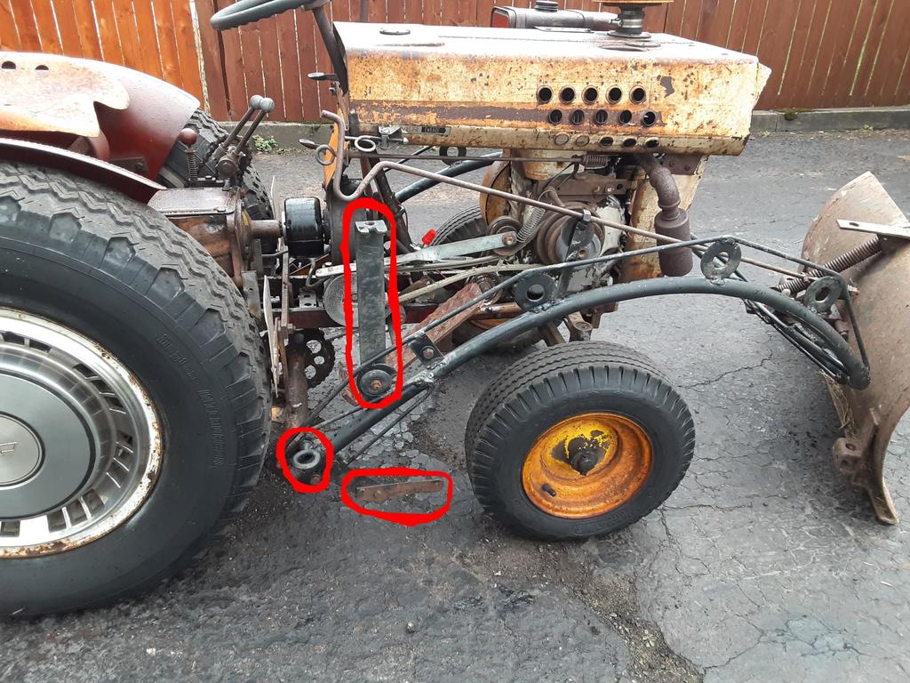

D_Mac 9,339 #22 Posted April 20, 2020 @Razorback Its a belt from the engine to the gear reducer / worm drive. Not hydro. Oddly enough that is also the brake. You see the slack on the belt off of that pulley. You press down on the left foot pedal and that takes up the slack stopping the pulley = the brake. The lever with the red knob locks in the plow height. The outside shorter lever is foward 1st gear, back reverse. The taller inside lever is back 2nd gear, forward 3rd. They areas I circled in these photos are where I cant figure out. I am most like missing some pieces. Any guesses? The photo with just the plow the areas circled are like cylinders with a hole drill through them. The photo with it on the tractor is that long metal bracket has a hole and a notch in it. That eye ring on the bottom and that other part of the tractor frame that obviously had something bolted to it. They almost line up with the cylinder things on the plow frame. 3 Share this post Link to post Share on other sites
Razorback 1,370 #23 Posted April 20, 2020 (edited) Can you get some pictures of the left side of the tractor? The armstrong lever on the left is similar to my Speedex1631...... it is used to raise/lift the rear implements, the belly mower, and I would guess the front blade if I had one...... is that the one that lifts the front blade only 1"? Edited April 20, 2020 by Razorback Share this post Link to post Share on other sites
