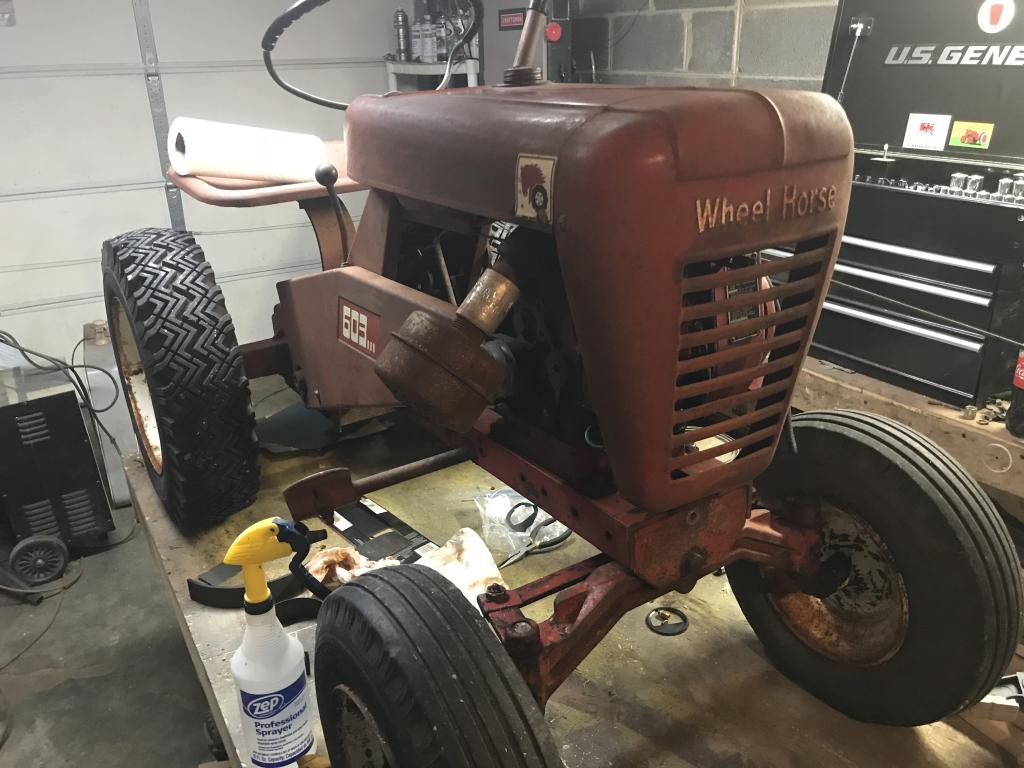

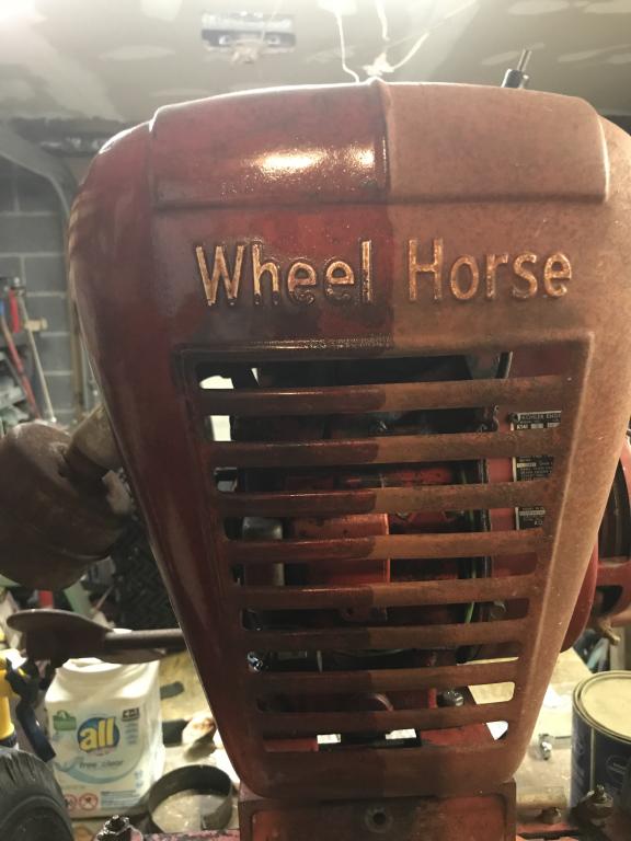

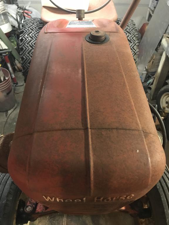

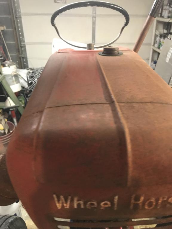

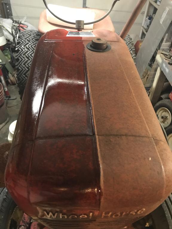

dells68 7,499 #1 Posted January 12, 2020 I bought this beautiful 603 from @Shynon last summer. I’ve been thrilled with it. The carb got some gunk in it the last time I had it out, so I figured I’d bring it home to the garage while I have a chance to work on it. One of Tom’s stipulations was that I not paint the tractor. I agree that it would be a shame to mess with such beautiful patina, so I thought I’d try my hand at enhancing it. I’ve honestly felt like cr_p today, but thought it might perk me up to mess with it a little. I put the carb in the tank to soak, so I took a few minutes to sand 1/2 of the hood with 800 and 1000 grit and then oil to see how it looks. Man does it pop! Ear in mind I will buff it down and it will dry with more of a mat sheen, but retain the beautiful color. The only other thing I’m going to do to this tractor is clean and paint the wheels with a fresh coat of Rustoleum almond. I do have the original hood, but decided to keep this one on for now as I love the look. Hate to admit it, but I think I’m really on board with this patina thing! 10 9 3 Share this post Link to post Share on other sites
The Tuul Crib 7,354 #2 Posted January 12, 2020 Wow! That is a real nice finish. So you used boiled linseed oil during the sanding? 1 Share this post Link to post Share on other sites
dells68 7,499 #3 Posted January 12, 2020 (edited) 24 minutes ago, The Tool Crib said: Wow! That is a real nice finish. So you used boiled linseed oil during the sanding? I sanded with water first. Then, I coated with boiled linseed oil cut with just a little mineral spirits. After it’s wiped down the finish will be more soft and aged looking. It just brings out the beauty of mother nature’s work. Edited January 12, 2020 by dells68 3 2 3 Share this post Link to post Share on other sites

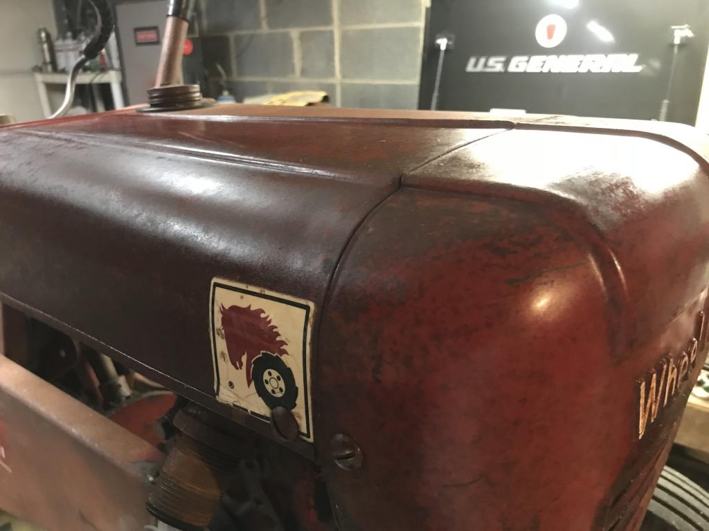

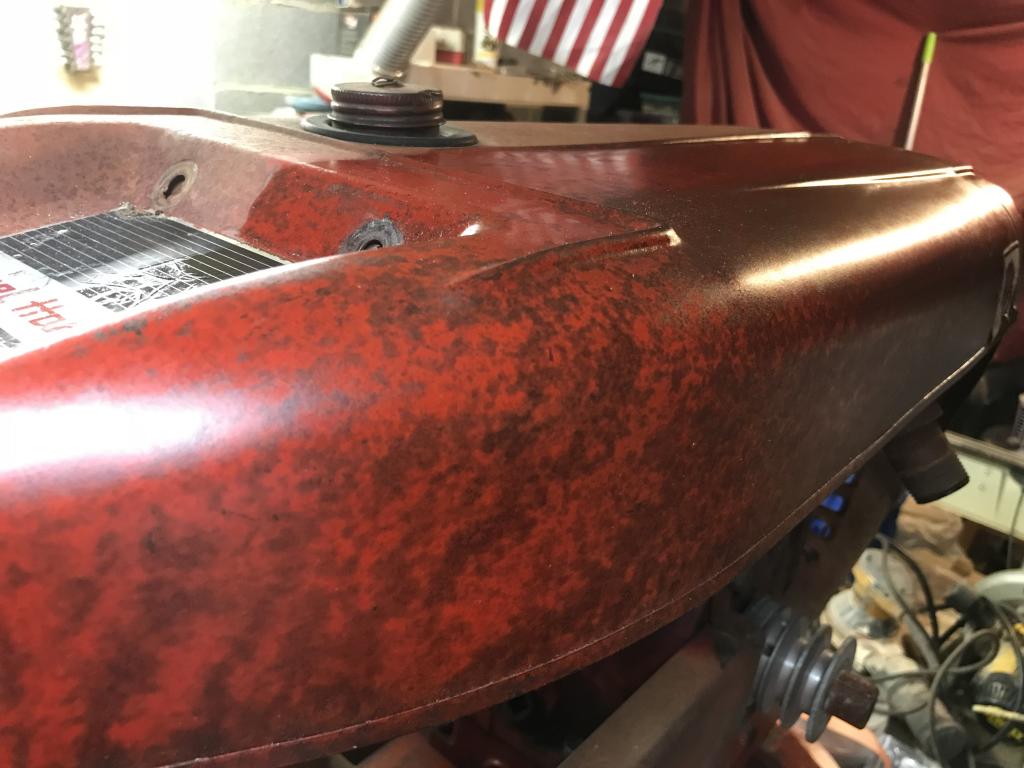

dells68 7,499 #6 Posted January 12, 2020 I just went down and wiped the oil down. I’ve been letting it sit overnight, but this will give you an idea of the sheen it leaves @The Tool Crib. It’ll dry down a bit more, but will still keep a luster. 4 6 1 Share this post Link to post Share on other sites
oliver2-44 11,820 #7 Posted January 12, 2020 Looks good Dells. I've seen several comments about people using oil for a finish and wondered what they used? I was using Tung Oil finish on my rocking horse today, I'll have to go wipe some on a piece of sheet metal and see how it does. However I've always thought of it for interior finishes, i wonder how it would do with moisture. @Dells after it's dried thoroughly, can I ask you to test a small inconspicuous spot of your Boiled Linsead Oil finish with some simulated rain water? 1 1 Share this post Link to post Share on other sites
The Tuul Crib 7,354 #8 Posted January 12, 2020 16 minutes ago, dells68 said: I just went down and wiped the oil down. I’ve been letting it sit overnight, but this will give you an idea of the sheen it leaves @The Tool Crib. It’ll dry down a bit more, but will still keep a luster. That is a really nice look Dells. Is that something that you could spray clear over or would you have to keep applying boiled linseed oil to the surface? 1 Share this post Link to post Share on other sites
rjg854 13,422 #9 Posted January 12, 2020 That's a nice finish, really like that. I just might try that on the next tractor. 1 Share this post Link to post Share on other sites
dells68 7,499 #10 Posted January 12, 2020 13 minutes ago, The Tool Crib said: That is a really nice look Dells. Is that something that you could spray clear over or would you have to keep applying boiled linseed oil to the surface? Thanks Crib. I would be hesitant to try to clear over it, even after it had sat for quite a while. I would think you’d have to remove all of it to keep the clear from fisheying. Most of the rat rod patina guys reflag every 45-60 days on their rides. I would love hunk stored indoors that this should last longer than that. What’s nice about it is that it gives all surfaces a nice deep color - even cast parts like axles or transmissions. It just doesn’t take away the originality that clear coat does. 2 Share this post Link to post Share on other sites
dells68 7,499 #11 Posted January 12, 2020 49 minutes ago, oliver2-44 said: I was using Tung Oil finish on my rocking horse today, I'll have to go wipe some on a piece of sheet metal and see how it does. I may be wrong, but I think ting oil would be very similar to regular linseed oil and dry tacky leaving a coating that would collect dust. From what I’ve read, that’s why it is important to use boiled linseed oil - to avoid a sticky surface when dried. Share this post Link to post Share on other sites

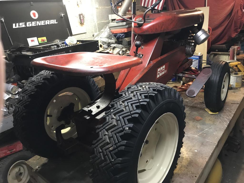

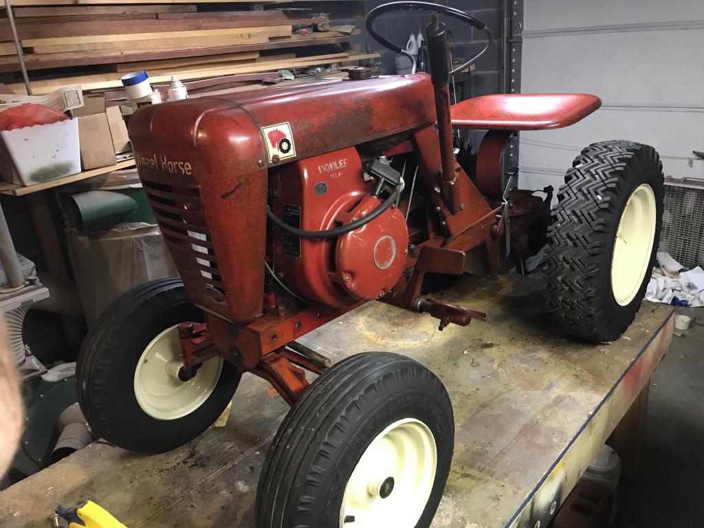

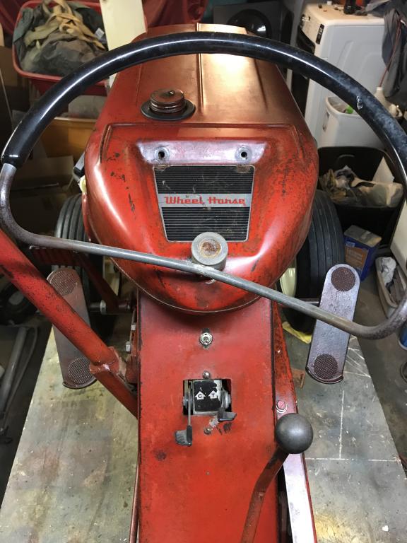

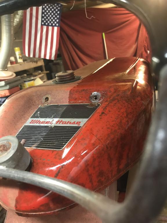

dells68 7,499 #21 Posted January 22, 2020 I finally had enough chances to mess around with the 603 to get almost finished. I still need to reinstall the knurled nuts on the hood, but otherwise it’s pretty much finished. I cleaned the entire tractor, sanded all tins with 800 and 1000 grit paper, followed by a generous application of linseed oil. I did make one mistake - I liked the hood and just meant to leave it overnight, but it was almost another 12 hours before I got back home from work. When I returned anywhere it was too heavy had gotten quite sticky - took a lot of work to get rid of that sticky residue. Moral - dry it down before you leave it for the night. All the red paint you see is what she left the factory with! I then removed the wheels and painted the rims with Rustoleum almond, followed by painting the tires with Miller’s tire paint. Looks great I think. I want to put rubber caps on the front hubs, but am not sure if I want red or black. I can’t wait to get it out in the sunlight and see it after this polar freeze passes! 1 6 2 4 Share this post Link to post Share on other sites
rjg854 13,422 #22 Posted January 22, 2020 I like it Dells Nice satin finish, any idea how long it might last before you need to do it again? 1 Share this post Link to post Share on other sites
Pullstart 71,520 #23 Posted January 22, 2020 Well did, Kid! That’s what I always tell my monsters, figured I’d share with a fellow teacher and dad! 1 1 Share this post Link to post Share on other sites
WHX?? 58,347 #24 Posted January 22, 2020 (edited) Some how missed this thread early Dells but that tractor looks great! I had taken Tom's advice on the linseed thing more than once and it does look nice but one thing I have found is it does attractor, pun intended, dust. It does protect the metal tho. This 'Burb was done like that. I'd say at least once a year rjg. @Shynonwill chime in. Matter of fact fellas this girl is in the shop right now trying to get the Clinton to run even half @ssed......and a refresh on the patina. OK I know how out you guys are hard on yer pics ... Pullstart told me to to tell you Dells stuff it ...not tryin to steal your thread.. as @JCM said it's all good! Edited January 22, 2020 by WHX24 8 Share this post Link to post Share on other sites
dells68 7,499 #25 Posted January 22, 2020 Thanks guys! @WHX24 I wondered if it would attract dust. Well, for the use most of my machines get, it should be fine. @rjg854 I’m not sure on longevity, I’d suspect Jim is dead on with at least once a year, maybe twice if you have to wash it up very often. Right now, I’m digging the look because I don’t feel like I’ve done anything to hurt the originality of the tractor. 1 Share this post Link to post Share on other sites
