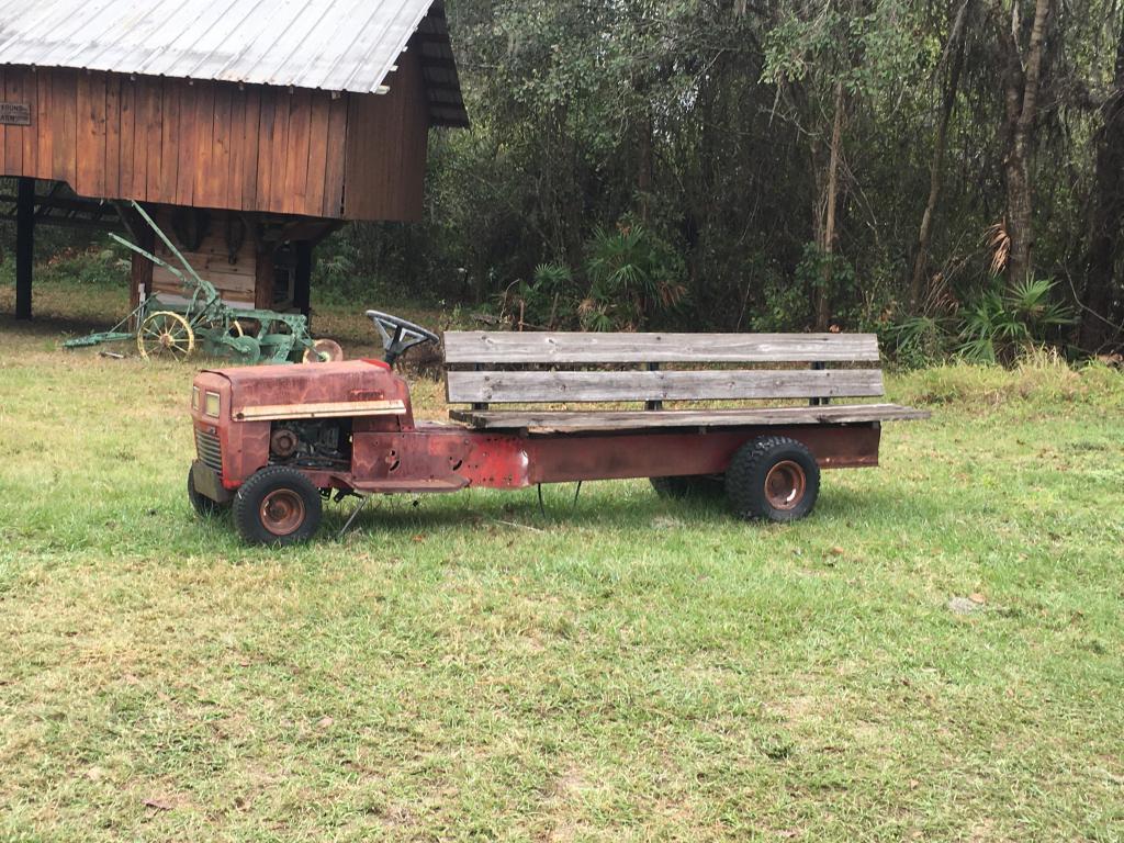

19richie66 17,935 #376 Posted February 21, 2020 Thought of you today. Saw this at the Flywheeler’s show 8 3 1 Share this post Link to post Share on other sites
WHX?? 58,157 #377 Posted February 22, 2020 Right up his alley Richie ...you run into Lane Ranger ther? Share this post Link to post Share on other sites
oliver2-44 11,753 #378 Posted February 22, 2020 To bad it's not a Wheel Horse. A "Mobil Bus Stop" like that would get a lot of mileage at the Big Show 1 5 Share this post Link to post Share on other sites
8ntruck 9,304 #379 Posted February 22, 2020 Looks like the driver might have to sit sidesaddle on that rig. Share this post Link to post Share on other sites
953 nut 69,373 #380 Posted February 22, 2020 10 hours ago, oliver2-44 said: A "Mobil Bus Stop" like that would get a lot of mileage at the Big Show What say you Mike, @squonk? 1 2 Share this post Link to post Share on other sites
squonk 48,130 #381 Posted February 22, 2020 1 hour ago, 953 nut said: What say you Mike, @squonk? I'm thinking a lot of us including me would be banned from sittin in the middle! 4 Share this post Link to post Share on other sites
rjg854 13,360 #382 Posted February 22, 2020 But does Mikey like it @squonk Share this post Link to post Share on other sites
squonk 48,130 #383 Posted February 22, 2020 23 minutes ago, rjg854 said: But does Mikey like it @squonk As long as I can drive it through the parade! 1 1 Share this post Link to post Share on other sites

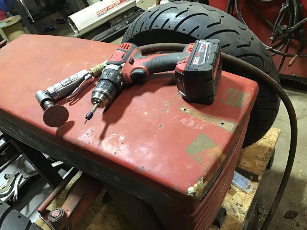

Pullstart 71,259 #384 Posted February 28, 2020 Cleaning house a bit... set this hood here. Maybe I should change my plans a bit? I’m not really, but don’t it look sweet? 3 1 2 Share this post Link to post Share on other sites

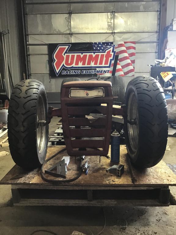

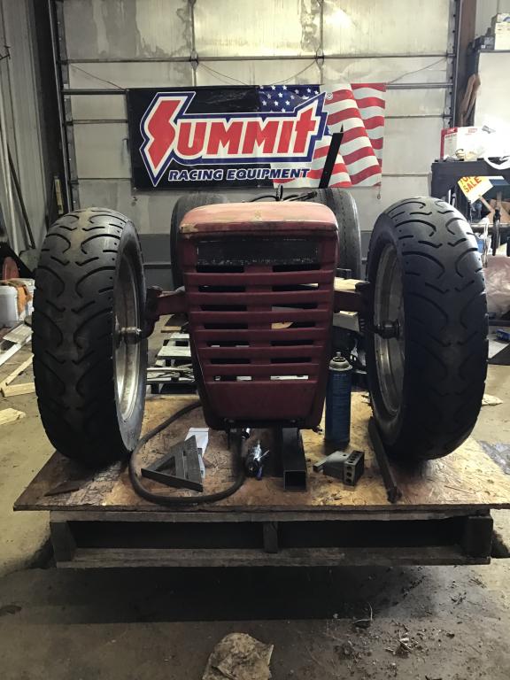

Pullstart 71,259 #385 Posted February 28, 2020 I still like this square hood better... 3 1 Share this post Link to post Share on other sites
ebinmaine 80,745 #386 Posted February 28, 2020 I'm normally a fan of the 70s hood and Trina of the 60s square hood. In this case I'd have to say the 60s hood is BETTER. 1 1 Share this post Link to post Share on other sites

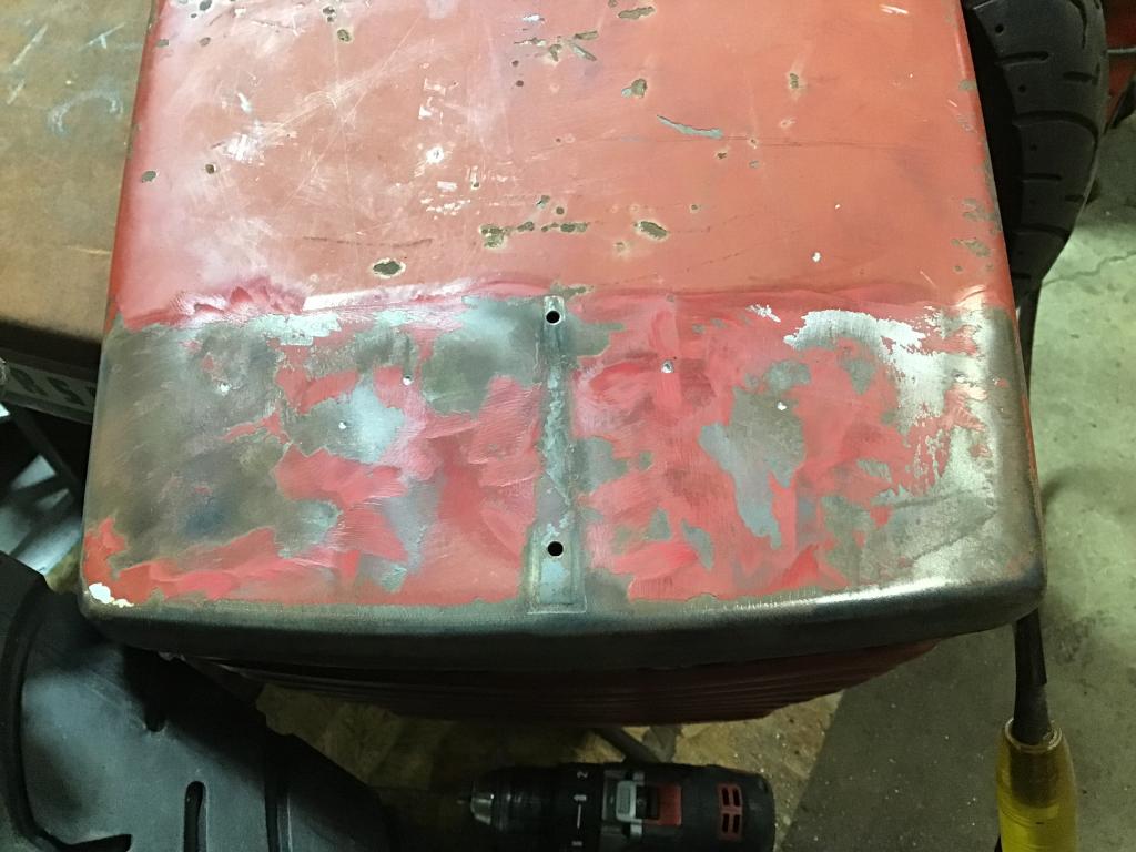

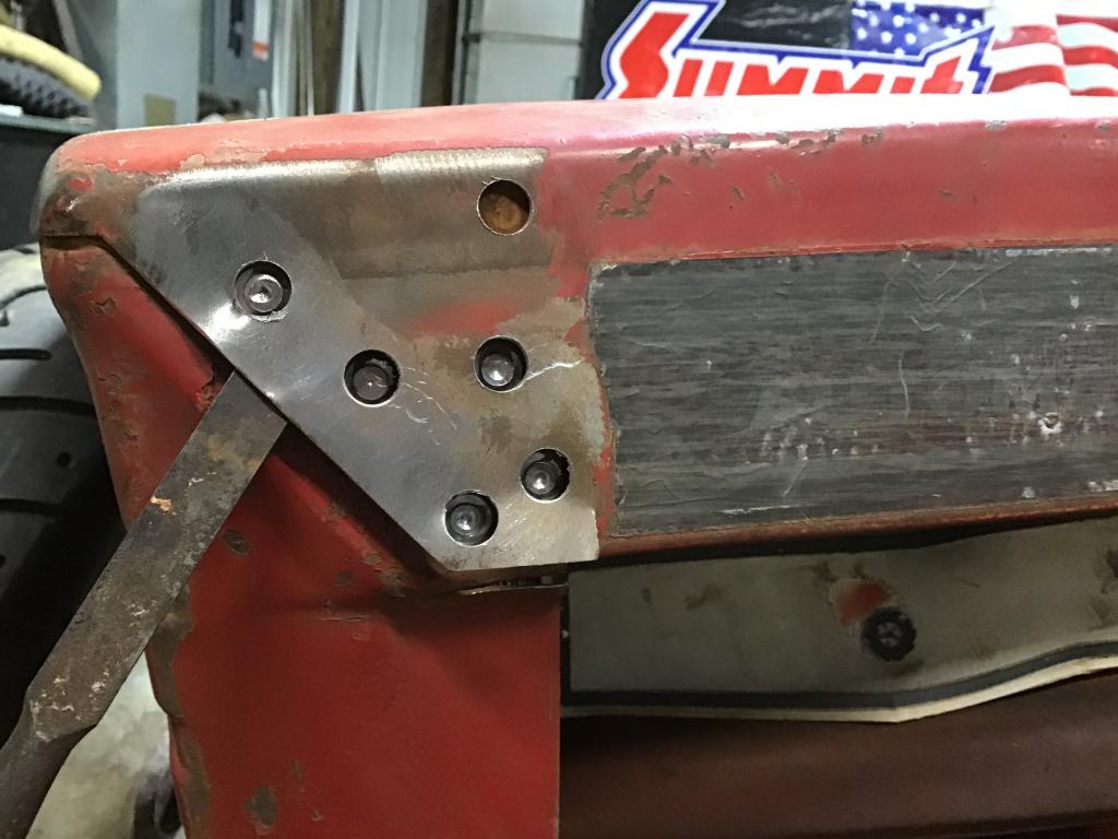

Pullstart 71,259 #397 Posted March 2, 2020 Last night I played with trying to find spot welds on the top skin of the hood. It’s not that easy every time! I found plenty of spots they aren’t! Switching to a wire wheel on the disc grinder made it a little easier to strip paint and not metal, but it was still a challenge. Finally I flipped the hood over and gave the really rusty areas a good scuff. They popped pretty well and I will try to measure them and drill from the other side. I also thought about maybe drilling a small pilot straight through that would be easy to weld shut. 4 Share this post Link to post Share on other sites
