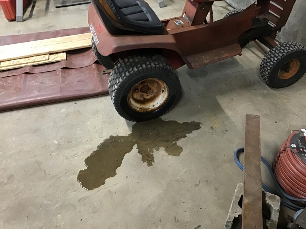

Pullstart 71,561 #1 Posted January 6, 2020 Ok, I am about ready to get back into the shop, now that my bathroom project is coming close to the final stages! I was going to get this thing built and finished then do an @Achto style unveiling but this might need some input from the peanut gallery. I also enjoy the interaction from y’all while it’s coming together! So here’s where I’m at. I have an old Commando 800 rolling chassis that came from the local auction. It’ll get a square hood from the 60’s. Maybe the hood will be shortened... how far I’m not sure yet. The chassis might even get a slight stretch, as I see fit. I grabbed a rolling automatic chassis from @fast88pu at last year’s big show, with hydro lift. It’ll be mated out back with some 15” race car tires. I’m going back to my roots with a @pullstart engine. @elcamino/wheelhorse gave @19richie66 a Predator 6.5 horse engine at 2018’s Big Show, who gave it to me. It should work just dandy, with a dual exhaust dumping out back. The Commando tower has manual lift which I’ll try to retain for underside attachments, since the hydro cylinder will be used for the dump box. Yep, it’s a UTV/Gator inspired build. I still need to find a decent Ohio Steel trailer for the box, or I might add some Wheel Horse flair and use some hood skins to build box sides. I am not sure if I’ll make this a bench seat or single seat vehicle. There are still some some surprises in the works with a special @Vinylguy decal package, but that’ll stay under the radar until we’re closer to completion. Here’s to finishing this thing before June! 4 2 4 Share this post Link to post Share on other sites

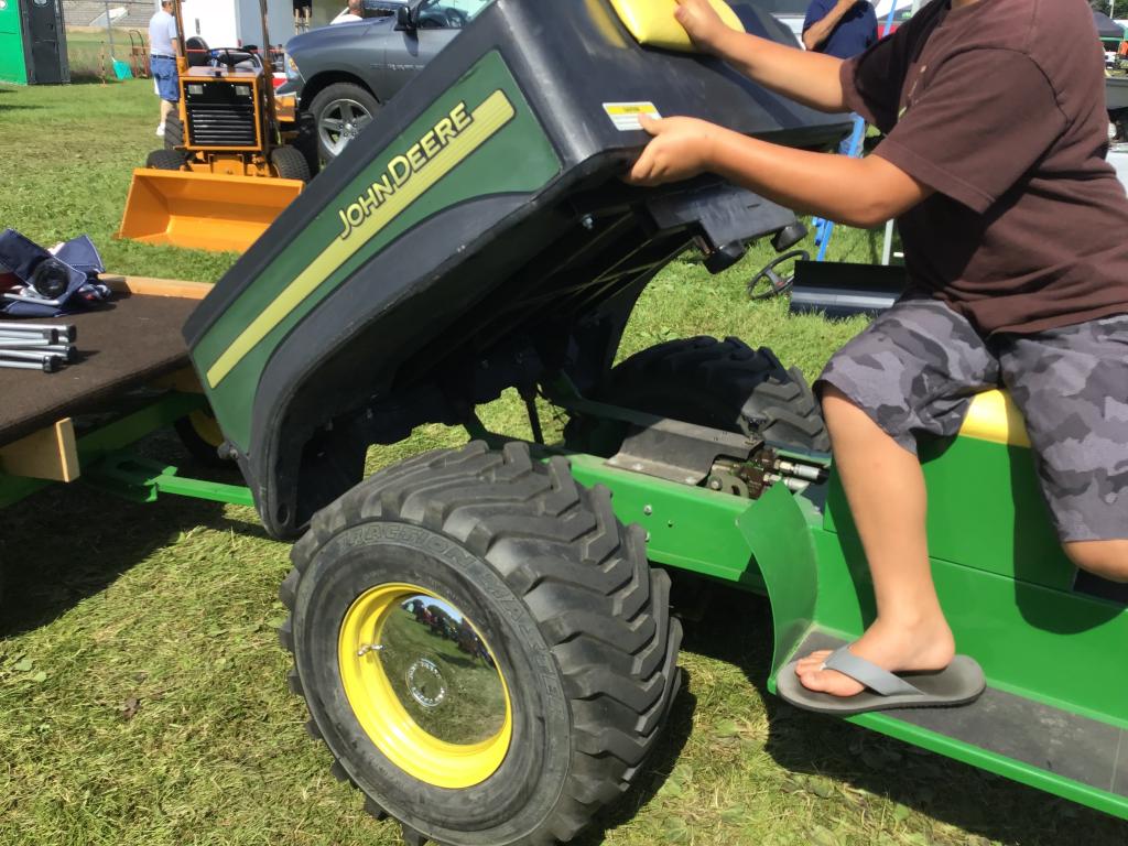

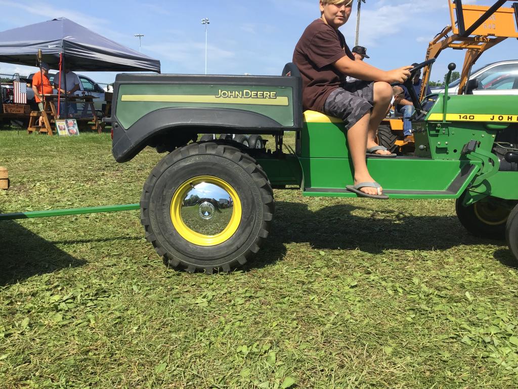

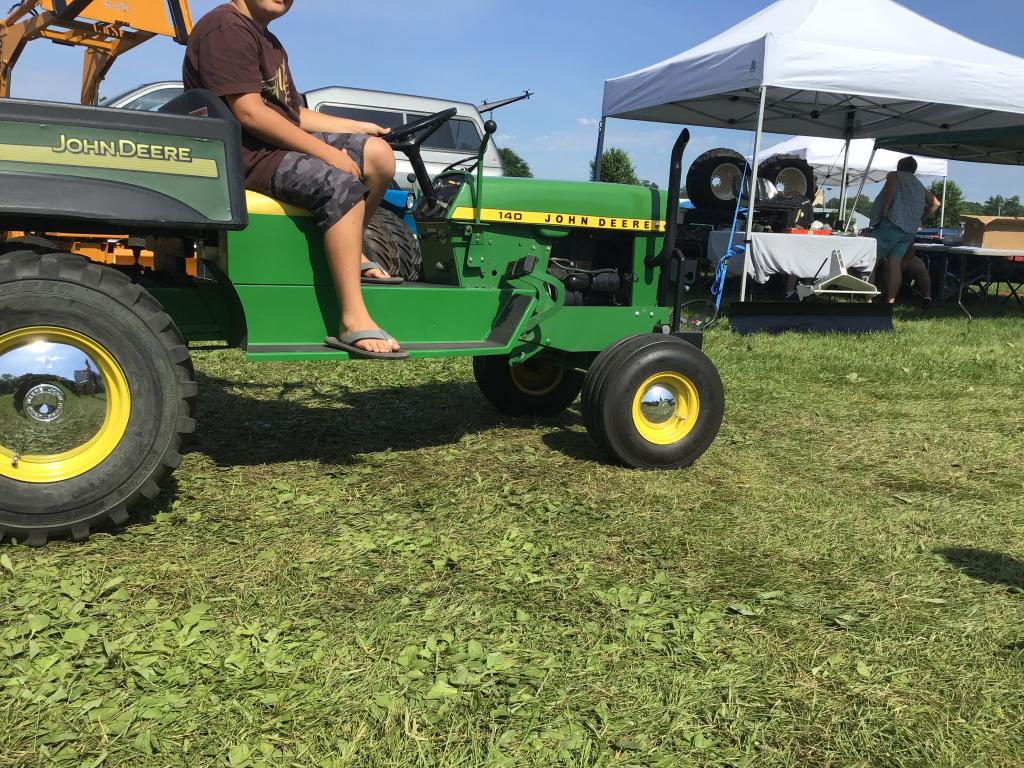

Pullstart 71,561 #2 Posted January 6, 2020 It was about May when I started dreaming this project up. We saw this nice JD 140 at the Portage, WI show. The young man was nice enough to show me the box action. I think hydraulic dump would be the cat’s meow! 9 Share this post Link to post Share on other sites

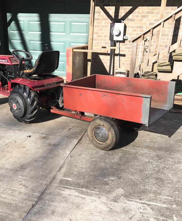

The Tuul Crib 7,354 #8 Posted January 6, 2020 Here is the kind of box that you would need on that machine 4 Share this post Link to post Share on other sites

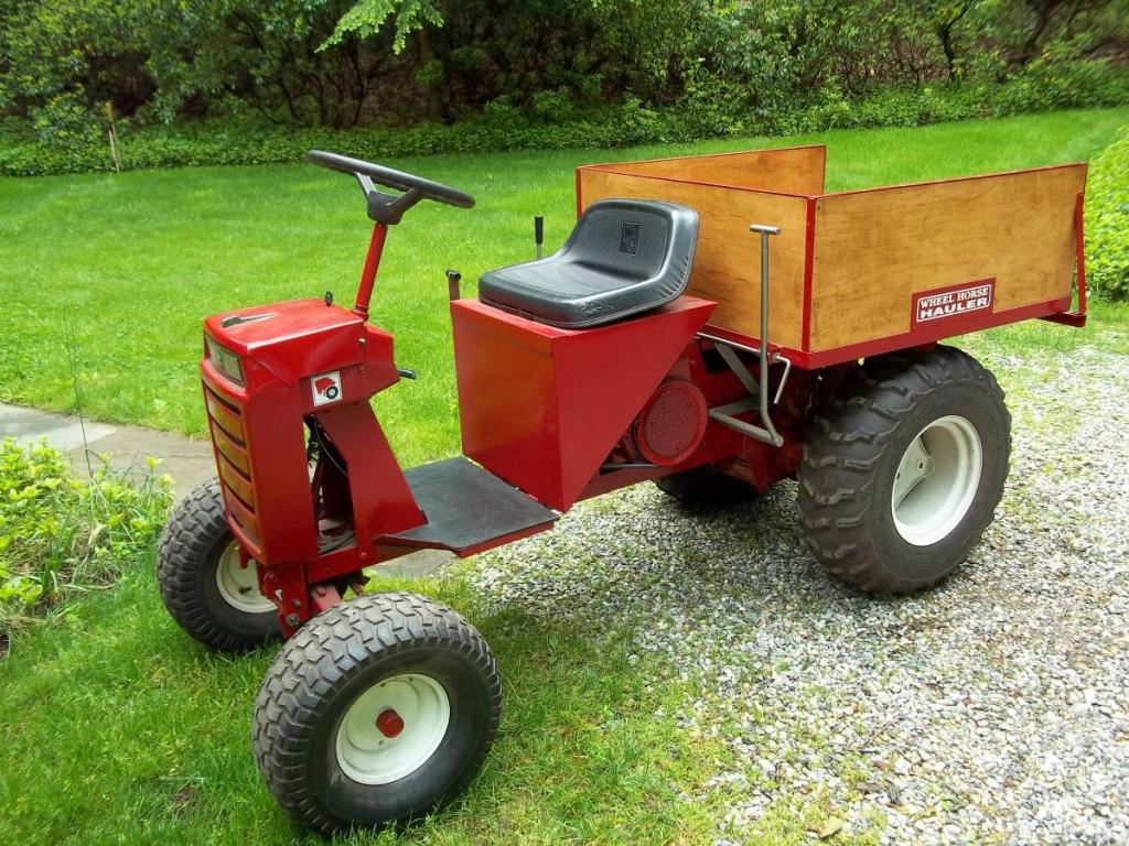

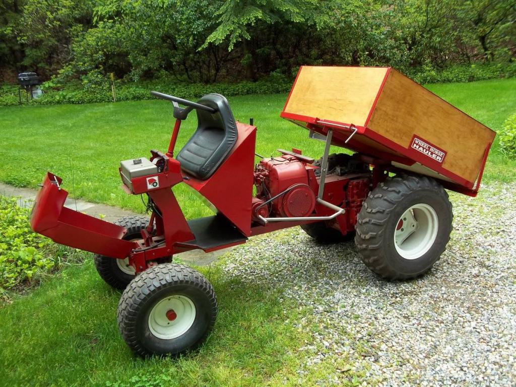

JAinVA 4,638 #11 Posted January 6, 2020 Here is another take on the idea. 2 6 3 2 Share this post Link to post Share on other sites
Pullstart 71,561 #12 Posted January 7, 2020 2 minutes ago, The Tool Crib said: Here is the kind of box that you would need on that machine Yeah, that’s what I’ve been looking for! I need to scour the junk classifieds, maybe look behind grampa’s barn... you know. The usual spots! 2 Share this post Link to post Share on other sites
Pullstart 71,561 #13 Posted January 7, 2020 1 minute ago, JAinVA said: Here is another take on the idea. I’ve been thinking about a woody paneled box too. I think the steel box would hold up to the real life abuse it’ll see cleaning out the chicken coop, hauling wood or rocks or dirt, etc. 4 Share this post Link to post Share on other sites
