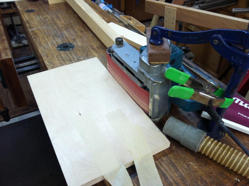

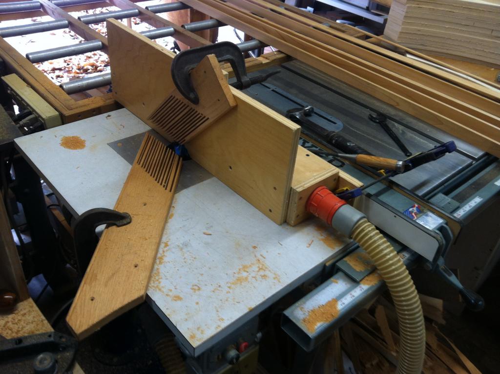

formariz 12,381 #8 Posted December 6, 2019 (edited) What tools/machinery/activity do you use that create dust? the best way is always to minimize it or collect it at the source..Different tools require sometimes different methods depending on what type of dust is created and how it is projected into the space. For example, both a table saw and a band saw can create an equal amount of dust from similar operations. They however project that dus very differently into the work space. Where a shop vacuum will be sufficient to collect dust from the band saw, it is totally useless on a table saw.The very fine dust one finds on top of horizontal surfaces even when dust collection is used requires very special filtration and even with that it will always be found. Perhaps with a shop layout showing machines used I can better help with suggestions. Shop vacuums work well in many instances but when coupled with a cyclone separator they become much more efficient and maintenance free. I do a lot of handwork but also use machinery for a lot of the prep work. I don't have anything fancy or that expensive, just stuff that has proved efficient from trial and error and experiencing it all through the years. Since my shop is also part of the house, dust collection and control is the first priority. After over 30 years here I am still constantly trying to control and improve the dust collecting/creating situation. One thing that became absolutely a forbidden activity here is any finish spraying .That stuff is so insidious that it is impossible to totally control Edited December 6, 2019 by formariz 1 1 Share this post Link to post Share on other sites

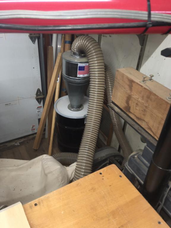

The Tuul Crib 7,354 #13 Posted December 6, 2019 Here's another idea they can be a little costly. Got lucky pick this one up off of craigslist for 250 with all the connections . It does a great job! 1 Share this post Link to post Share on other sites

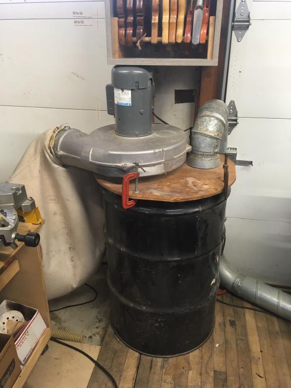

82Caddy 851 #14 Posted December 6, 2019 1 hour ago, Racinbob said: I'm not sure if you want to spend this much Eric but I'm in the process of closing off part of the basement and making it my woodworking shop and am seriously thinking about one of these. https://www.harborfreight.com/2-hp-industrial-5-micron-dust-collector-97869.html?_br_psugg_q=dust+collector Current coupon price puts it at 179$ I use one of those with a higher micron filter. I also added a 55 gal drum before the dust collector to pick up the bigger pieces and keep them out of the blower impeller. It does have wheels on the bottom of it so it can be moved around. 1 Share this post Link to post Share on other sites
formariz 12,381 #15 Posted December 6, 2019 4 hours ago, The Tool Crib said: One idea I had is to screw a couple pieces of OSB about 2 ft tall to the sides of that table and then make a port for a Shop-Vac in a corner. If that is a table which you use to work on sanding and doing miscellaneous small tool operations you van make an additional top with holes drilled through it mount it with about one inch of space to original top, enclosed on sides and with a port for vacuum. That's pretty much how a dedicated sanding table is done. It will collect any dust that falls on it and airborne dust close to table. As for machinery you will need to improvise and close as much of machine as possible to direct dust into collector hose. There is not one solution for everything. Here are some photos of set ups that I use. You may not need to get that involved but it will give you some starting points. Many times I rig up some insane looking set ups for special operations that only get used once. Some of the stuff shown such as the shop vacuum cyclone separator are available in less expensive smaller plastic form which Bob gave you a link to. Although for occasional use they are OK ,I do not use any plastic drums or cyclones or bags for safety reasons. Static build up and discharge on moving air within a closed system containing dust is dangerous. I use only metal components and they and every hose are internally grounded into electrical system. Below main collector. Two stage allowing only fine dust to go into bag. Solid bigger stuff and most dust falls into drum before. Mainly used for bottom of table saw and 2 joiners I use Perhaps the most important one in shop. Collects dust from above table saw directed at your face and acts as a very effective guard. It has its own dedicated collection system. Collection system for above table saw. Dedicated motor and separator. Bag never really gets any dust, it falls into drum from cyclone. Band saw collection. Used with a shop vacuum with a cyclone. Its just held with magnets. Totally encircles blade getting most dust at the source. Router table collection from shop vacuum. There is also usually the hose from main collector underneath table. This one is always messy regardless how hard you try but its mainly chips. Quickly improvised edge sander dust collected into sanders bag and shop vacuum. Very efficient with basically no dust anywhere. Chop saw set up. Collected from saw to shop vacuum and main collector on back of box through shown cutout which has a special fitting for it. Very efficient on a really messy tool. Probably the second most important one in shop. Cyclone separator for shop vacuum. 99% of everything falls into it before reaching shop vac. If you keep it from overfilling you almost never have to clean vac filter and have consistent suction. These are through out place. Automatically turns on collectors when tools are switched on. 2 2 Share this post Link to post Share on other sites

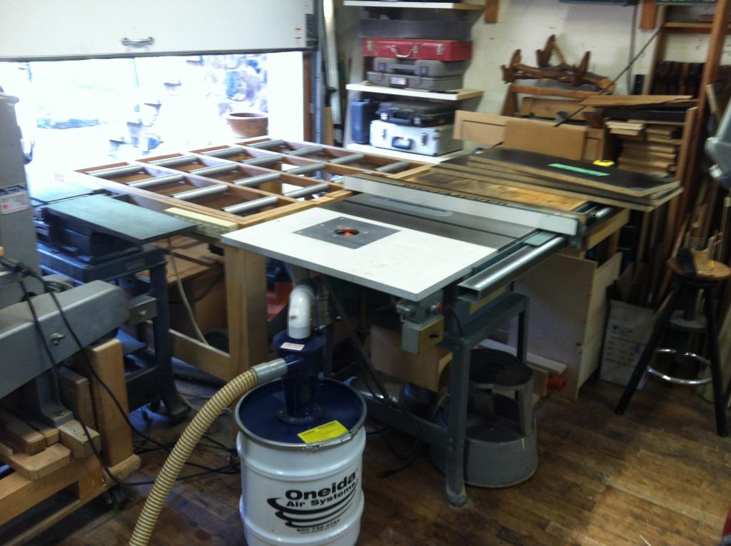

82Caddy 851 #16 Posted December 6, 2019 Here's another idea using a 5 gal bucket and a shop vac to keep the gunk out of the shop vac. https://www.homedepot.com/p/Dustopper-High-Efficiency-Dust-Separator-12-in-Dia-with-2-5-in-Hose-36-in-Long-HD12/302643445?fbclid=IwAR2q3NvY-E_pEviuB95KV45fZAdW1hzR96OhyicUr79GY3o-6S8XXhg6Gyo Interestingly enough there is a discussion going on in a Facebook group about this same topic that started with this video... 1 Share this post Link to post Share on other sites
Lee1977 7,805 #17 Posted December 6, 2019 There is a Fein 27060090920 Vacuum on Amizon that attaches to small saw and sanders that comes on with the power tool. It's not cheap but it's good quality . 1 Share this post Link to post Share on other sites
formariz 12,381 #18 Posted December 6, 2019 System in video works relatively well and it is easy to do. Many different methods similar to that one. They are all good for the occasional user and that is probably what most need. It however requires a lot more frequent maintenance on vacuum filter since air inside buckets is constantly moving even right above dust collected on bottom bucket keeping dust suspended and being drawn into filter. With an actual cyclone outside bucket that does not happen and filter stays clean for much longer. There are actually no name brand plastic cyclones similar to the Oneida (actual copies) that one bolts to the top of a bucket. They cost $21.00 as opposed to over 40 for the same size Oneida or similar. Taking that into account one spends probably that in fittings and buckets and some time in the other version. 1 1 Share this post Link to post Share on other sites
