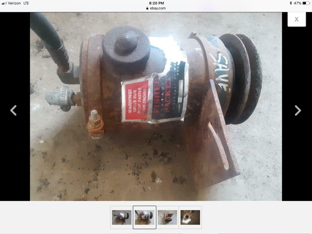

Pullstart 71,163 #6 Posted July 19, 2019 (edited) I fave a few Fisher truck snow plow pumps I believe. They are a pump and reservoir in one and are driven off a V-belt. If it will work on my 8’ plow, I don’t see why it wouldn’t work on a garden tractor... Edited July 19, 2019 by pullstart Spelling and picture... 2 1 Share this post Link to post Share on other sites

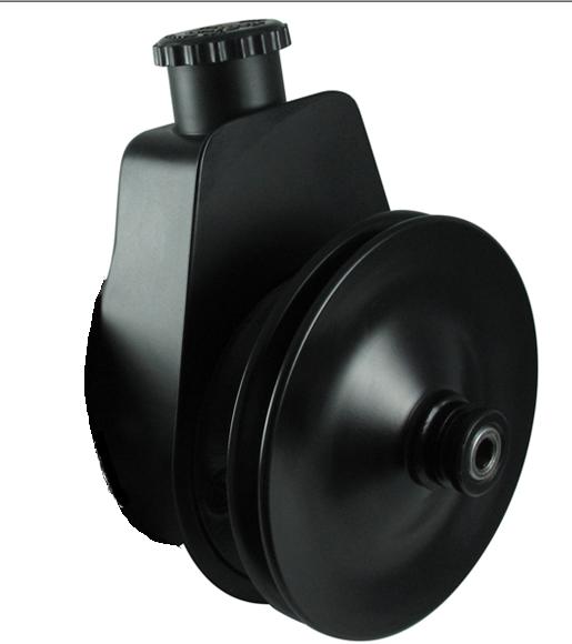

RandyLittrell 3,945 #7 Posted July 19, 2019 (edited) I have seen quite a few cub guys use one of these. Its an older GM power steering pump. Randy Edited July 19, 2019 by RandyLittrell 4 Share this post Link to post Share on other sites
WVHillbilly520H 10,379 #8 Posted July 19, 2019 42 minutes ago, pullstart said: I fave a few Fisher truck snow plow pumps I believe. They are a pump and reservoir in one and are driven off a V-belt. If it will work on my 8’ plow, I don’t see why it wouldn’t work on a garden tractor... How about the old Meyers electric snow plow pumps power up and gravity down...https://www.amazon.com/MEYER-ELECTRIC-MOTOR-15054-S5054SP/dp/B078Z44FLW... OR... https://rover.ebay.com/rover/0/0/0?mpre=https%3A%2F%2Fwww.ebay.com%2Fulk%2Fitm%2F123446954548 ... Leaves the PTO drive open for a mower deck, snow blower, tiller ect . 2 Share this post Link to post Share on other sites
