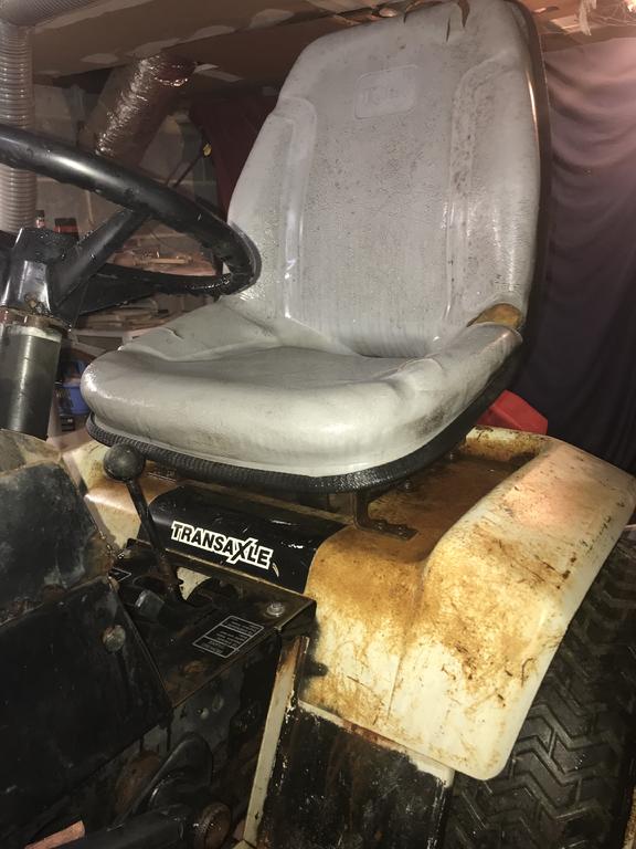

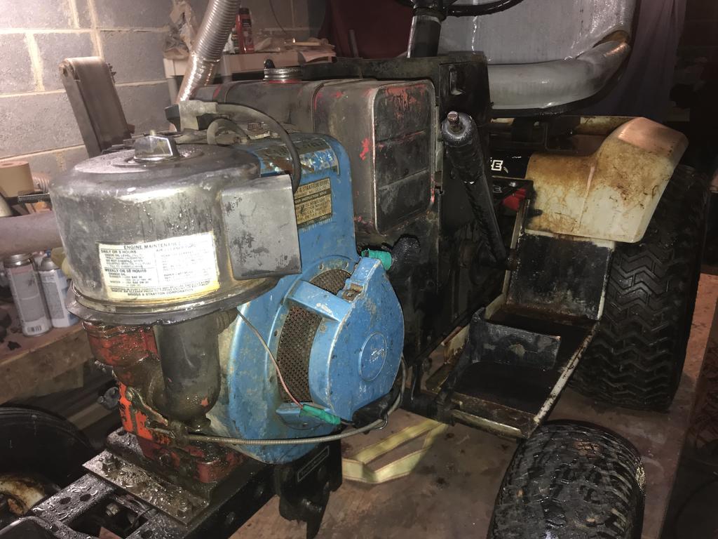

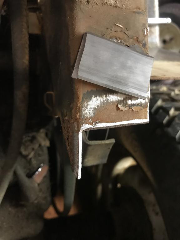

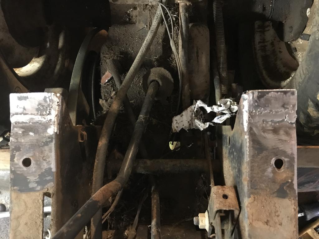

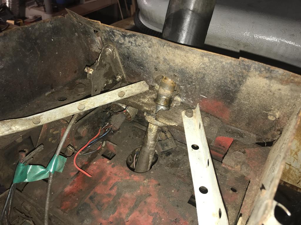

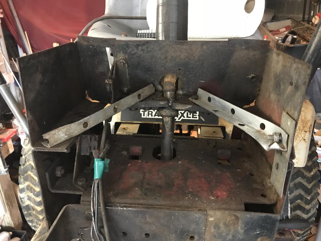

dells68 7,499 #1 Posted December 1, 2018 Well, I bought a ratty ole Work Horse for the deck and rear wheels at my local club’s annual show last July. Emory fell in love with it. I did rob the deck and front wheels for my 312-8. Ever since Emory has been asking if I would build it for his Christmas this year. He was wanting an rj or suburban, but neither has come along, so here goes the 1100. Below are a fee pics of it’s current condition - broken steering brace, cobble welded hood, and cobbled up steering/dash tower. Seat could almost go in the ugly seat contest. Engine is a worn, difficult to start pull start Briggs. It’s going to be replaced with a fresh rebuilt k241. I’m optimistic I’ll get it done by Christmas and went ahead and ordered a set of @Vinylguy‘s patriotic decal sets. Keep your fingers crossed! Oh, by the way @WHX21, Jim, the shop isn’t any cleaner yet - maybe after Christmas, then maybe not😂. 4 5 Share this post Link to post Share on other sites

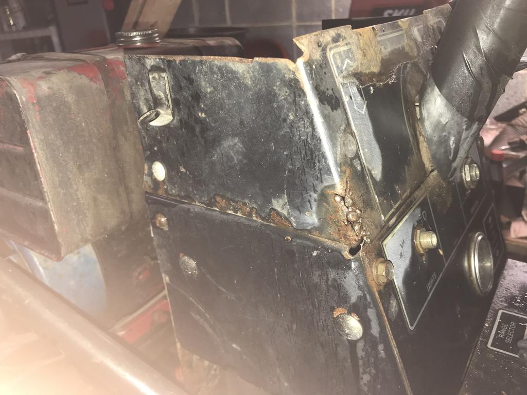

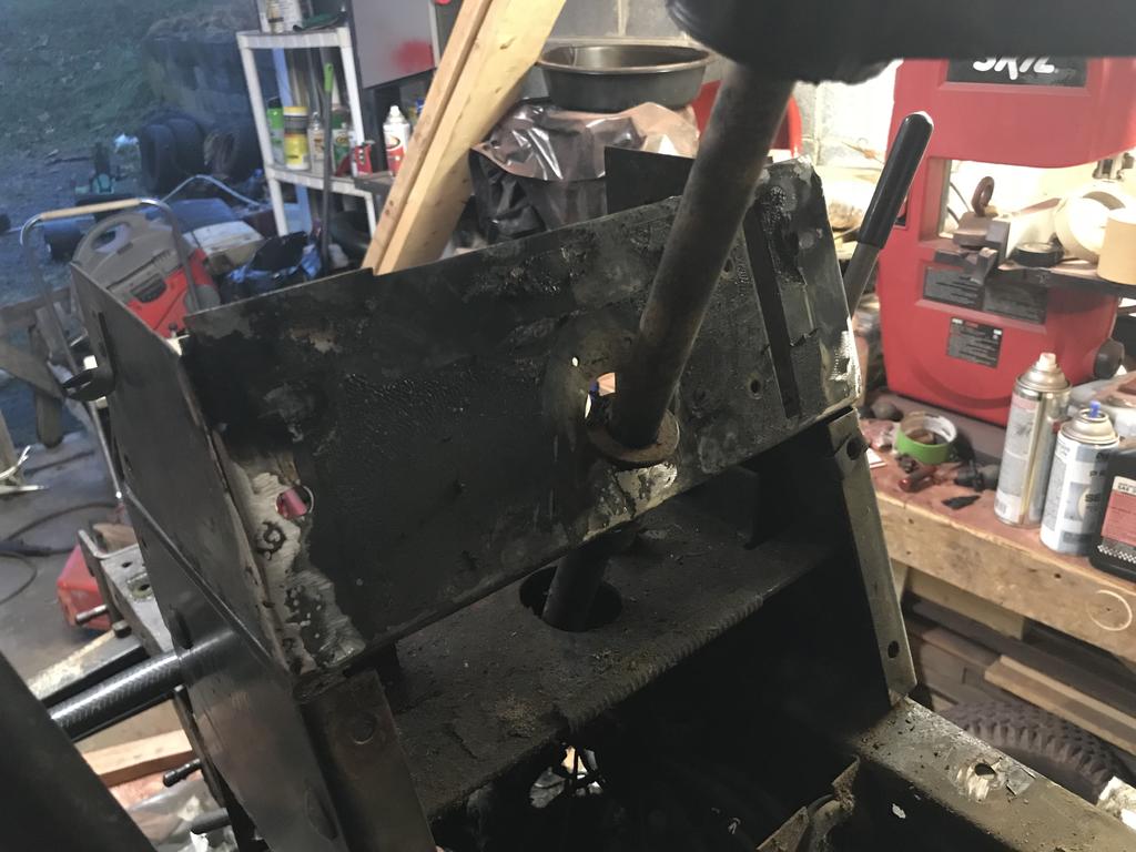

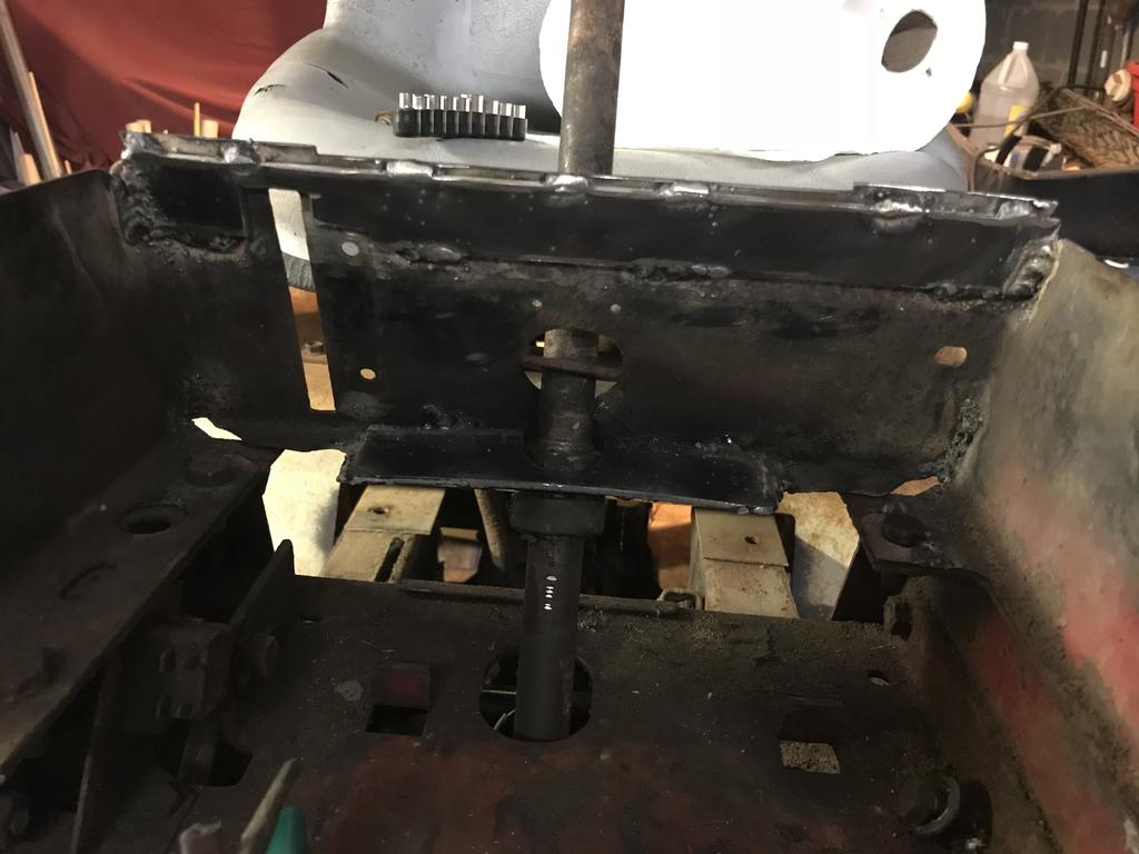

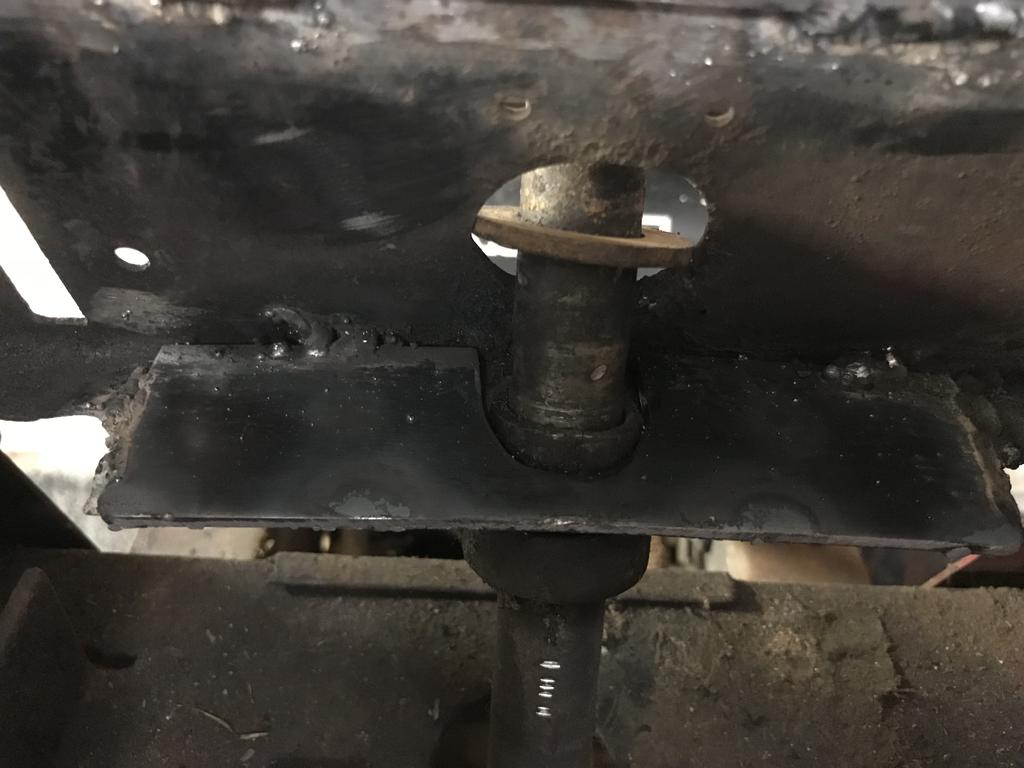

dells68 7,499 #13 Posted December 1, 2018 Well, I pulled off the dash stand, straightened it, welded up all of the fatigued spots, and added reinforcement plates to the top and area surrounding the bushing. I use a flux core and am no pro by a long shot, so please ignore my welding! Getting ready to go back and tackle the hood. More updates later. 5 2 Share this post Link to post Share on other sites

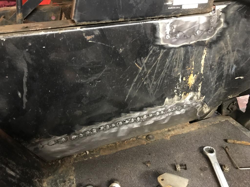

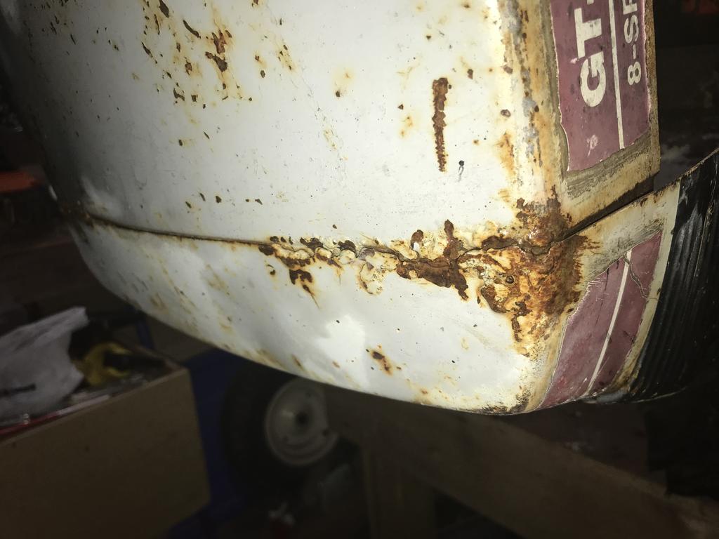

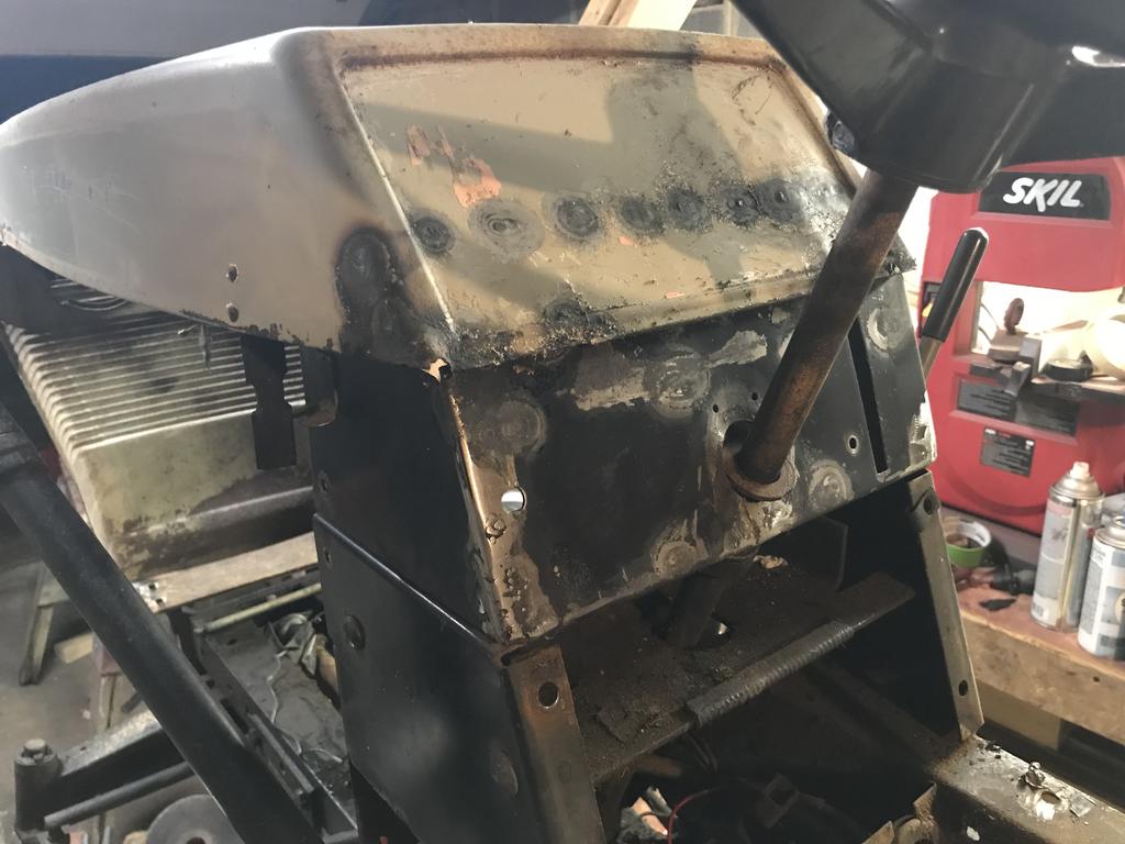

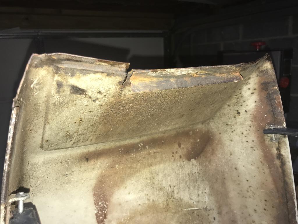

dells68 7,499 #14 Posted December 2, 2018 Just now quitting for the night. I did manage to weld the front and top of the hood together to make one piece. It was already butchered with a stick welder when we got it and the factory spot welds were broken loose. I had to weld the bottom of the hood, as the sheet metal was fatigued from flexing. I also put a strip of steel under the rear of the hood to stiffen and straighten the back. All told, it looks and fits better now. Now I dread the mud work! 4 1 2 Share this post Link to post Share on other sites

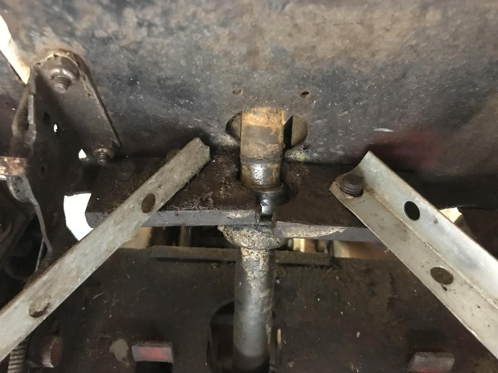

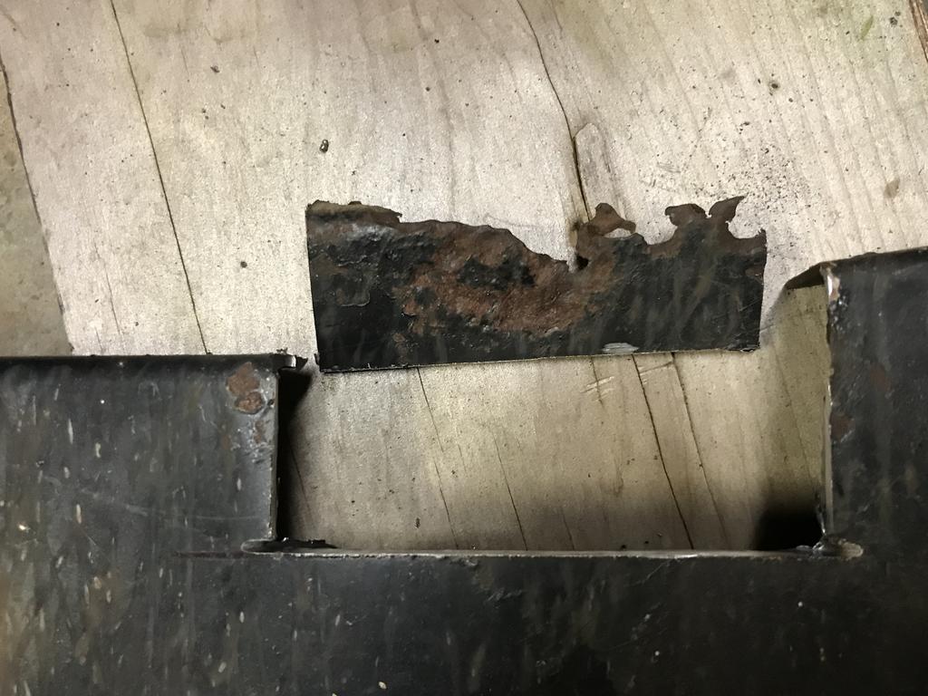

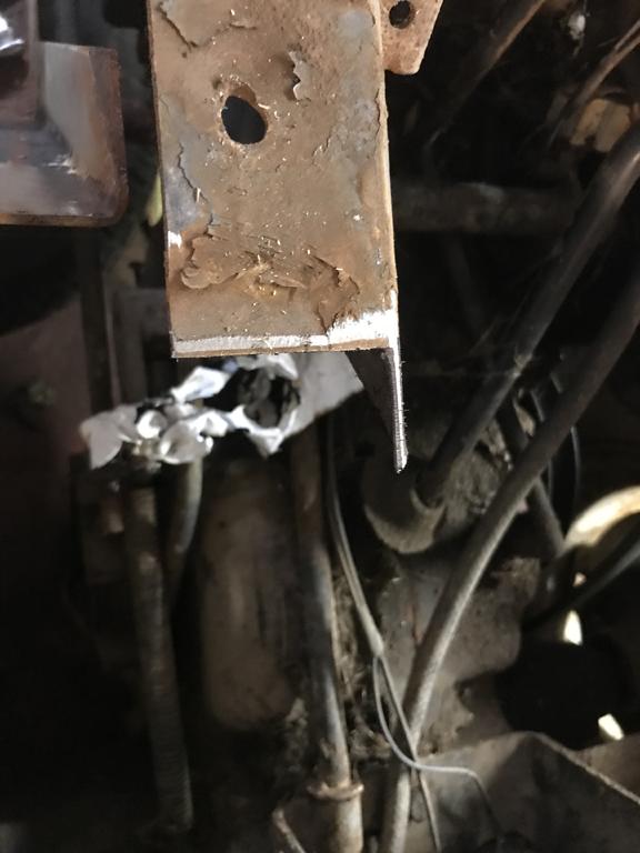

dells68 7,499 #18 Posted December 4, 2018 Took a few minutes and cut the broken tabs to mount the seat pan and welded in some fresh metal. Not pretty or real smooth. But I think they should do the job and will be hidden anyway. That’s it for tonight. Had just a few minutes to work after decorating our tree. 3 Share this post Link to post Share on other sites

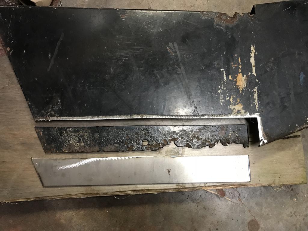

dells68 7,499 #25 Posted December 5, 2018 Got about an hour and a half to work tonight, so I tacked the last couple of spots I needed to hit on the hood and replaced the rusty parts of the belt guard. I probably should weld the seams solid, but I’m trying to avoid as much distortion as possible on the guard. 6 Share this post Link to post Share on other sites
