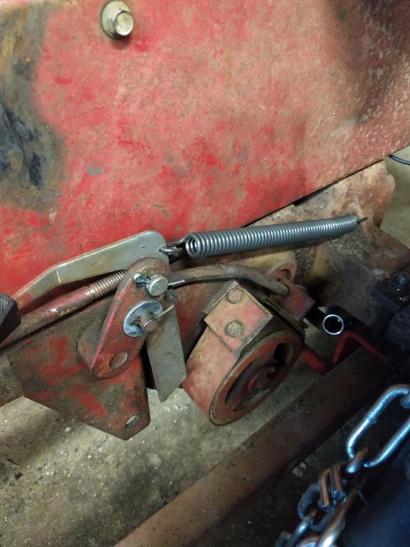

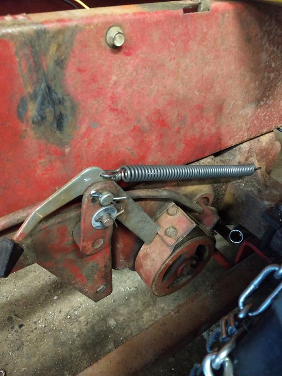

Racinbob 13,075 #52 Posted November 30, 2018 I just now saw this and am coming in kinda blind but a couple things stood out. Your 1267 should have a 5060 transmission (10 pinion 6-speed). If the brake band is mounted like your B/C series it's been swapped out. But I don't think that's your problem. I agree that the idler arm looks to be too far back. Your belt size is correct so, to me, it's gotta be in the pulley size or something is wrong with the idler arm linkage. The difference in the spring length you pictured shouldn't matter either and still wouldn't account for the idler arm position. I agree thet the little roller thingy by the input pulley is simply a spacer for the belt guard. I've done that on machines that have lost the welded on tab. 1 Share this post Link to post Share on other sites
Pullstart 70,962 #53 Posted November 30, 2018 Since the engine and trans pulleys are in a fixed position and the tensioner pulley relies on, well, tension, linkage adjustment won’t affect the position of anything but the pedal and brake band... correct? Possibly the engine has been moved back? Belt guard from another tractor, or modified? I’m with @wallfish, a shorter belt would be the only way to “move” the tensioner forward... shy of a larger pulley. 1 Share this post Link to post Share on other sites
ebinmaine 80,002 #54 Posted November 30, 2018 8 minutes ago, pullstart said: Since the engine and trans pulleys are in a fixed position and the tensioner pulley relies on, well, tension, linkage adjustment won’t affect the position of anything but the pedal and brake band... correct? Possibly the engine has been moved back? Belt guard from another tractor, or modified? I’m with @wallfish, a shorter belt would be the only way to “move” the tensioner forward... shy of a larger pulley. I discovered last night after taking the brake and idler system apart that it has been changed and the effective length of the rods is longer the way it is. I don't have the correct brake band to use unless I take it off of the 867 which I might do. I would like to get it correct so that future repairs would be easier. Share this post Link to post Share on other sites
Racinbob 13,075 #55 Posted November 30, 2018 11 minutes ago, pullstart said: Since the engine and trans pulleys are in a fixed position and the tensioner pulley relies on, well, tension, linkage adjustment won’t affect the position of anything but the pedal and brake band... correct? Possibly the engine has been moved back? Belt guard from another tractor, or modified? I’m with @wallfish, a shorter belt would be the only way to “move” the tensioner forward... shy of a larger pulley. That's true. Regardless of the linkage being messed up that arm would have to be in that position to tension the belt. I would verify the pulley sizes and belt size. The 76" x 1/2" is correct but is it really that size? If everything is per factory sizing this shouldn't happen. I didn't think about the engine issue. 1 Share this post Link to post Share on other sites
ebinmaine 80,002 #56 Posted November 30, 2018 Just now, Racinbob said: That's true. Regardless of the linkage being messed up that arm would have to be in that position to tension the belt. I would verify the pulley sizes and belt size. The 76" x 1/2" is correct but is it really that size? If everything is per factory sizing this shouldn't happen. I didn't think about the engine issue. I don't have any way to measure a belt specifically but I do have three different belts from three different companies and they are all within a very very short length of each other if not exactly equal. So I have to assume that the 76 in is correct. what I discovered about the brake system is that the band has been turned completely upside down which moves the rod to a completely different position which makes the clutch pedal go forward several inches. It really makes a huge difference. I thought I would be lucky to move it an inch or two. It went forward like 4 or 5 inch or more. I'll try to remember to take some pictures but it might be a couple days before I can get back to this thing. Share this post Link to post Share on other sites
Racinbob 13,075 #57 Posted November 30, 2018 There's something screwy going on but like @pullstart said, the idler arm would have to be in that position to take the slack out of the belt. What's going on with the other side wouldn't matter. I'll be looking for the pictures. I've never swapped a 6-speed for an 8 or vice versa but it shouldn't be difficult to get it right. 2 Share this post Link to post Share on other sites

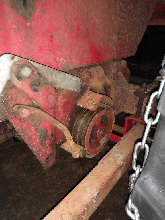

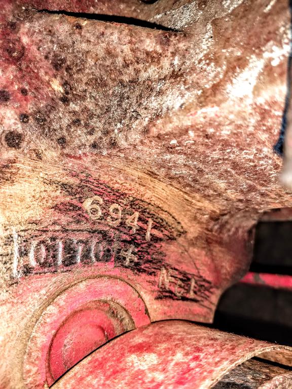

stevasaurus 23,772 #63 Posted November 30, 2018 Eric...post a couple pictures of the brake shaft side of your trans...including the brake drum and the fill plug. See if you can see the casting date up by the shifter. This will tell us if you have the right or changed out trans...could be your problem. Share this post Link to post Share on other sites
ebinmaine 80,002 #64 Posted November 30, 2018 4 hours ago, stevasaurus said: Eric...post a couple pictures of the brake shaft side of your trans...including the brake drum and the fill plug. See if you can see the casting date up by the shifter. This will tell us if you have the right or changed out trans...could be your problem. Here's a couple pics. I forget to get one of the fill plug. ignore the fact that everything is undone. I was experimenting with how things would line up if I turned the brake drum upside down which I clearly cannot do. Notice the casting number is not actually up by the shifter but right next to the brake drum. I believe those numbers are 6941 and 0170. I actually had to stick the phone in behind the tire to get that picture. Also notice the brake drum location. It is in the next lower hole from where it is located on the 867. Also notice the brake pull-rod. It is bent like a b or c series. I know this because I looked at the others. The 867 is straight. Share this post Link to post Share on other sites
stevasaurus 23,772 #65 Posted December 1, 2018 Well, that is definitely not a #5060 transmission. #6941 is the part number for that half of the transmission case. Don't quote me on the casting number in this case, but if it is Jan 1970, it should be a #5073. The #5073 is an 8 speed, 10 pinion, limited slip and it should have a dip stick.. The brake drum is on the cluster gear shaft. Your original transmission was switched out and because of where the brake drum is, your linkage has been modified to try to make it work. If you have a 1" extension on that transmission where the fill plug is, it is a 10 pinion LS...but the #5073 may not have that feature. I'm not sure. The 6 speeds did have that feature. Short of tearing it down, you could put the front of your horse against a tree or fence post...put it into 1st gear and let out the clutch...do this on snow or ice. If both wheels are spinning, it is a LS transmission. 1 Share this post Link to post Share on other sites

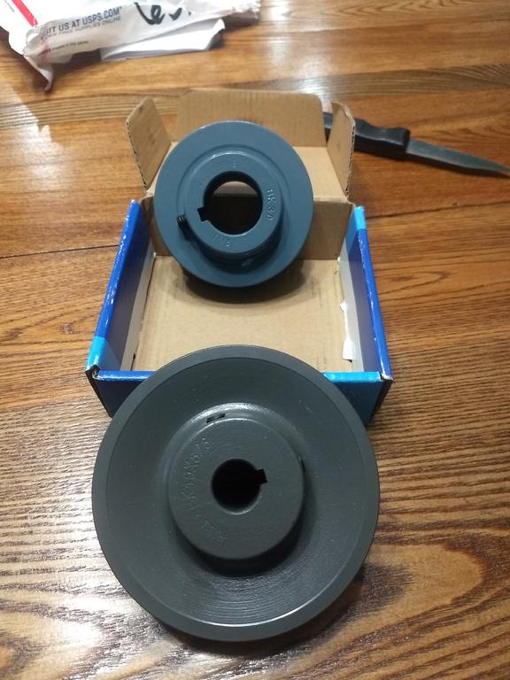

ebinmaine 80,002 #67 Posted December 9, 2018 @stevasaurus @wallfish @pfrederi I spent some time today to remove and clean up the engine pulley as much as could be done to it. Turns out it is too worn to use. Also was quite a bit more rusty than I expected. I ground down the rust and of course the belt was sitting even more deeply in the pulley. The rear pulley on this tractor isn't right so I'm replacing all 3. I've ordered a replacement 3" for the front and a 4" for the transmission, both 5L/ B groove size. As for the brake/clutch linkage and rods... They too were ummmmmm Mickey mouse engineered. What was happening was the rod connecting the brake drum to the clutch/ pivot was too short. When you push the clutch pedal on these models the brake is engaged as well. One motion. Because of the brake rod being too short I had nowhere near the amount of free play I needed to set the park brake, and also the belt idler would not move down enough to allow the installation of the 1" shorter belt as discussed in previous posts. I took a rod from a B/C series and straightened it in the vise. Then using the old rod as a guide I bent the new longer rod to the right position. It took a fair amount of experimentation to get the pedal in the right place and get the park brake adjusted. Here's a couple of pics. One showing the brake engaged. One not. I also threw a set of used but better than what was there tie rods on. 5 1 Share this post Link to post Share on other sites
wallfish 20,372 #68 Posted December 9, 2018 You got a handle on it now! That brake band and linkage looks much better. It certainly had a combination of different things creating the problem 1 1 Share this post Link to post Share on other sites

ebinmaine 80,002 #71 Posted December 15, 2018 Got these in the mail today. Installation attempt tomorrow. 4 Share this post Link to post Share on other sites

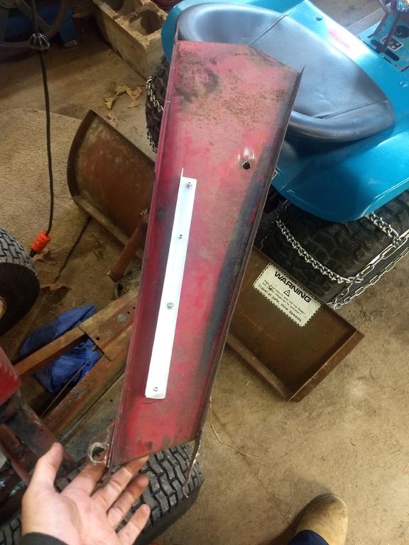

ebinmaine 80,002 #73 Posted December 24, 2018 Well about a week ago I installed the three new pulleys and belt. That turned out to have mixed results. I'm headed the right direction in that I can actually drive the tractor in 3rd gear now without slippage and I'm not smoking the belt anymore. What I mean by mixed results is that I can only get belt increments of 1 inch and I think I need a half size. I added this flange lip today... This is to support the top of the belt and keep it from sagging when I press the clutch pedal. It does its job and it does help but I'm just not quite there yet. The belt still doesn't quite come to a complete stop around the engine pulley so I can shift gears without grinding and crunching and other interesting noises. I'm going to order a Gates belt in the same size as what I'm using because they are very slightly narrower & that may be just enough to get me to a point of being usable for plowing. If not, I'll still be able to use the tractor for pulling heavy stuff around the property. Share this post Link to post Share on other sites

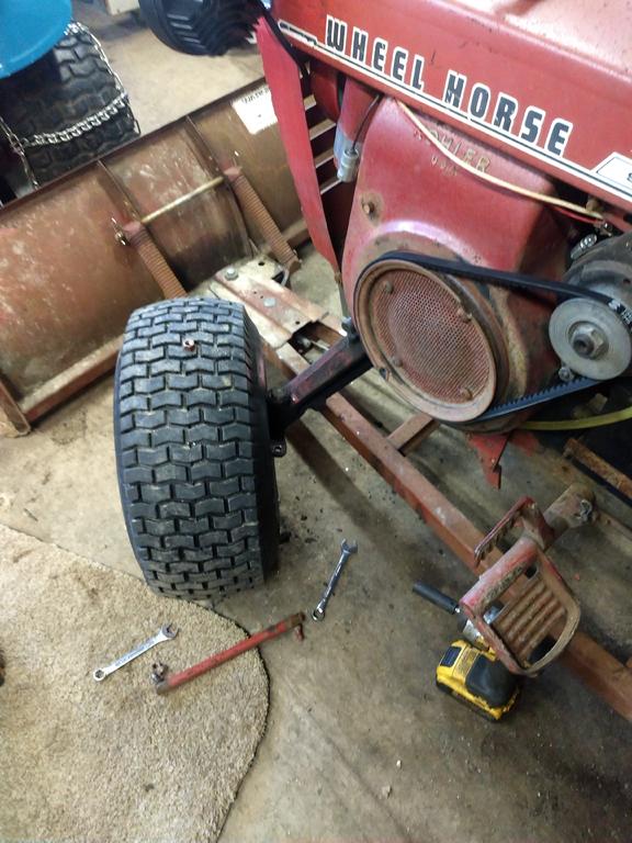

ebinmaine 80,002 #74 Posted December 28, 2018 Made some great progress on the tractor this evening. I installed the Gates belt and....... It worked !!!!! Push in clutch. Belt stops dead. Awesome. I did have to fiddle around with the belt guard a bit more. Remember all 3 pulleys have been changed and the belt is wider than the original. I had spaced the guard out away from the frame so as to make space for the wider belt and pulleys. Some PO had bent up this belt guard pretty badly in the past. I had to do some more straightening at the back by the transmission pulley. Now we need a little snow... Testing time. 6 1 1 Share this post Link to post Share on other sites
