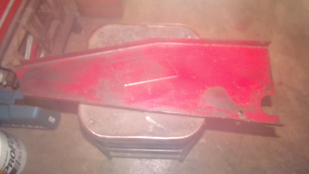

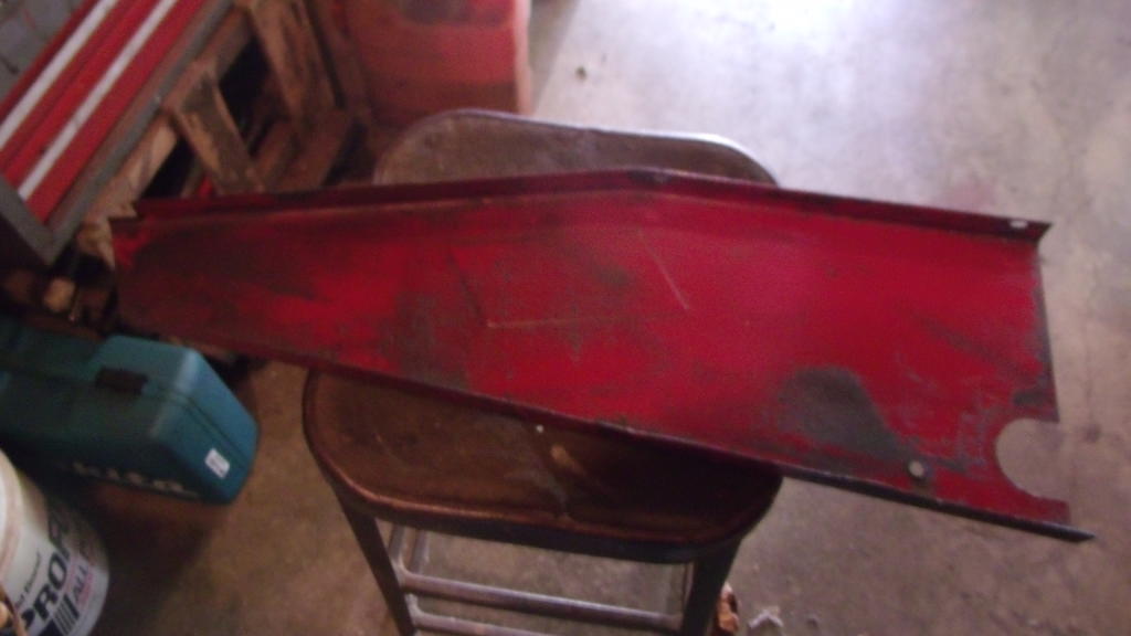

ebinmaine 80,002 #16 Posted November 28, 2018 Can somebody post a drawing or picture of where that flange or fin should be on this belt guard? Share this post Link to post Share on other sites
pfrederi 20,969 #17 Posted November 28, 2018 (edited) Inside a couple inches above the lower edge of the guard lower run of the belt almost sits on it You may not have one not all models did... Edited November 28, 2018 by pfrederi 1 1 1 Share this post Link to post Share on other sites
ebinmaine 80,002 #18 Posted November 28, 2018 4 minutes ago, pfrederi said: may not have one Thank you for the picture Paul. I'll double-check that of course, when I go to put the new belt in. I don't think I had one of those. I'll look in that approximate location to see if I can find any old spot welds or anything. Share this post Link to post Share on other sites

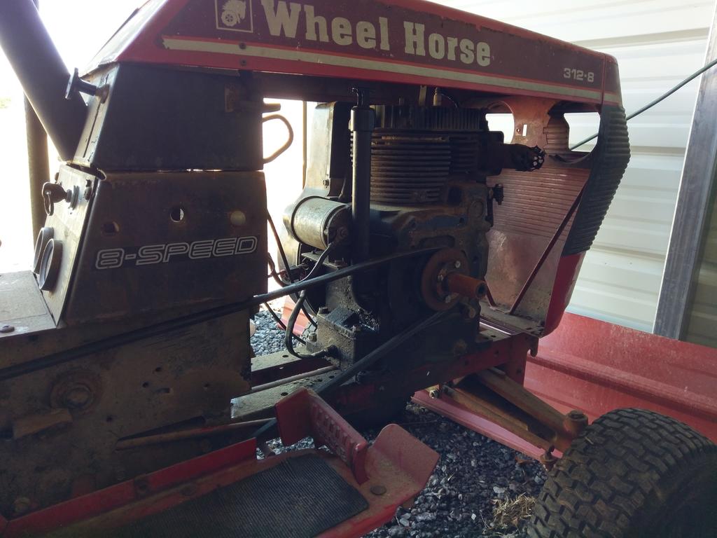

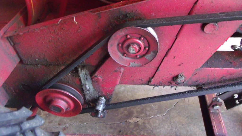

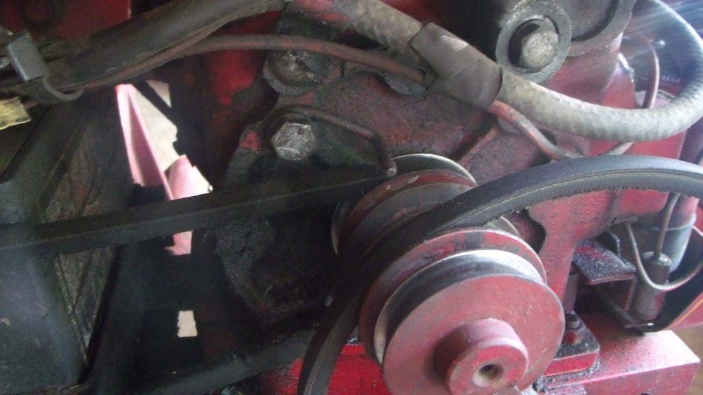

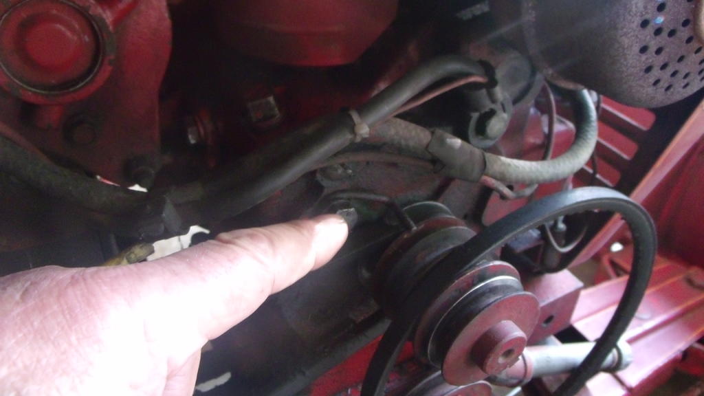

stevasaurus 23,775 #23 Posted November 28, 2018 I don't know it yours is the same as my 857, but here are a few pictures. Maybe that little roller by the input pulley. Notice the bent piece of wire used for a guide on top of the engine pulley. 2 Share this post Link to post Share on other sites
