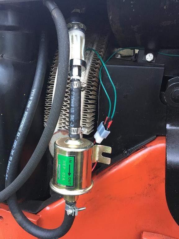

Machineguy 877 #14 Posted September 22, 2018 I’ve had two and found heat and a mounting location are key. I’ve mounted this downward from the tank pulling a siphon as electric pumps push far better than pulling. Also you’ll note it on the outside on the hydraulic cooler that pulls air in directly through the main cowling on my CCKB Onan. Once I put this unit there it’s been golden! Keep’em cool and keep them primed on the suction side they’ll last. BTW, it’s a different brand tractor! Lol 3 Share this post Link to post Share on other sites

WVHillbilly520H 10,379 #16 Posted September 22, 2018 40 minutes ago, Machineguy said: I’ve had two and found heat and a mounting location are key. I’ve mounted this downward from the tank pulling a siphon as electric pumps push far better than pulling. Also you’ll note it on the outside on the hydraulic cooler that pulls air in directly through the main cowling on my CCKB Onan. Once I put this unit there it’s been golden! Keep’em cool and keep them primed on the suction side they’ll last. BTW, it’s a different brand tractor! Lol Check out that "MR GASKET" hotrod see thru fuel filter, @dells68 that must be secret to fuel pump zen , on a different note, have you tried wiring with a relay instead of just fused to power source? All my added electronics on the 'BU are relay wired, (inner fender above overflow tank happens to be for its electric fuel pump), Jeff. 2 1 Share this post Link to post Share on other sites
Machineguy 877 #17 Posted September 22, 2018 The cheap paper filters will kill these pumps on suction! I should’ve mentioned that. Just like having the wrong micron filter on a hydro unit. You’ll lose suction and performance which develops heat and heat destroys everything. 2 1 Share this post Link to post Share on other sites

Machineguy 877 #20 Posted September 22, 2018 I’d say it’s a combination of all the above. Check your incoming voltage while running to rule that out. Then locate the pump closely but lower than the tank away from heat. I highly recommend a good automotive filter such as a visible that you can monitor for contamination. Poorly grounded pumps will develop heat too. Don’t give up! I’ll come there myself before I let this beat you buddy!!! 2 2 1 Share this post Link to post Share on other sites
