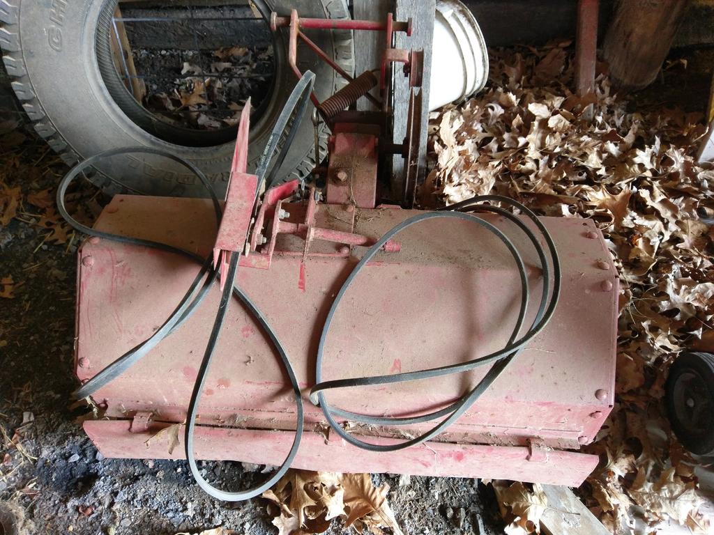

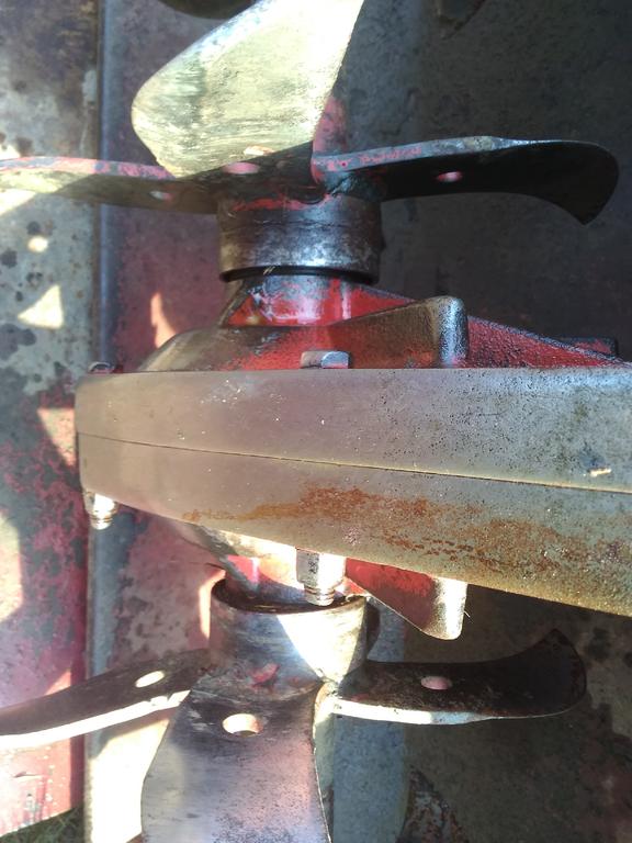

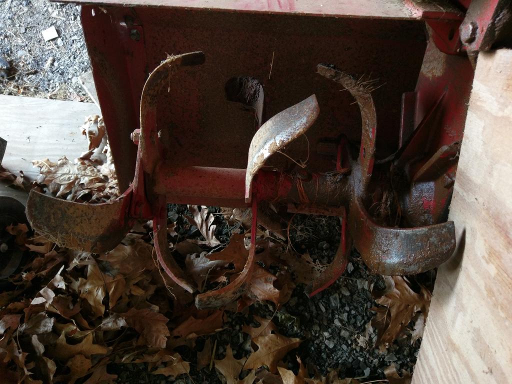

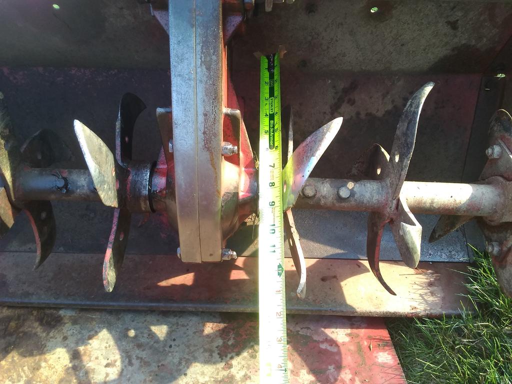

GREYGHOST 65 #15 Posted April 14, 2018 Just picked this up yesterday. PO, didn't know anything about PM. This season my plans with this boy is to bust up the soil after I've plowed it. I know, the tines are shot and I'm looking for replacements. So far it looks like ill be doing some weld repair. I'm sure the axle seals are shot. Took me quite a while to cut off ALL the garbage that was twisted as tire as a rope around both shafts. Ill have to keep an eye on the fluid since I'm expecting it to run out as soon as I refill it. Share this post Link to post Share on other sites
WVHillbilly520H 10,378 #16 Posted April 14, 2018 9 hours ago, GREYGHOST said: Just picked this up yesterday. PO, didn't know anything about PM. This season my plans with this boy is to bust up the soil after I've plowed it. I know, the tines are shot and I'm looking for replacements. So far it looks like ill be doing some weld repair. I'm sure the axle seals are shot. Took me quite a while to cut off ALL the garbage that was twisted as tire as a rope around both shafts. Ill have to keep an eye on the fluid since I'm expecting it to run out as soon as I refill it. That gear oil stays in there a bit longer than you think even with leaking seals but yes keep an eye on the level, yep those times are rather worn and replacements aren't cheap. Share this post Link to post Share on other sites
