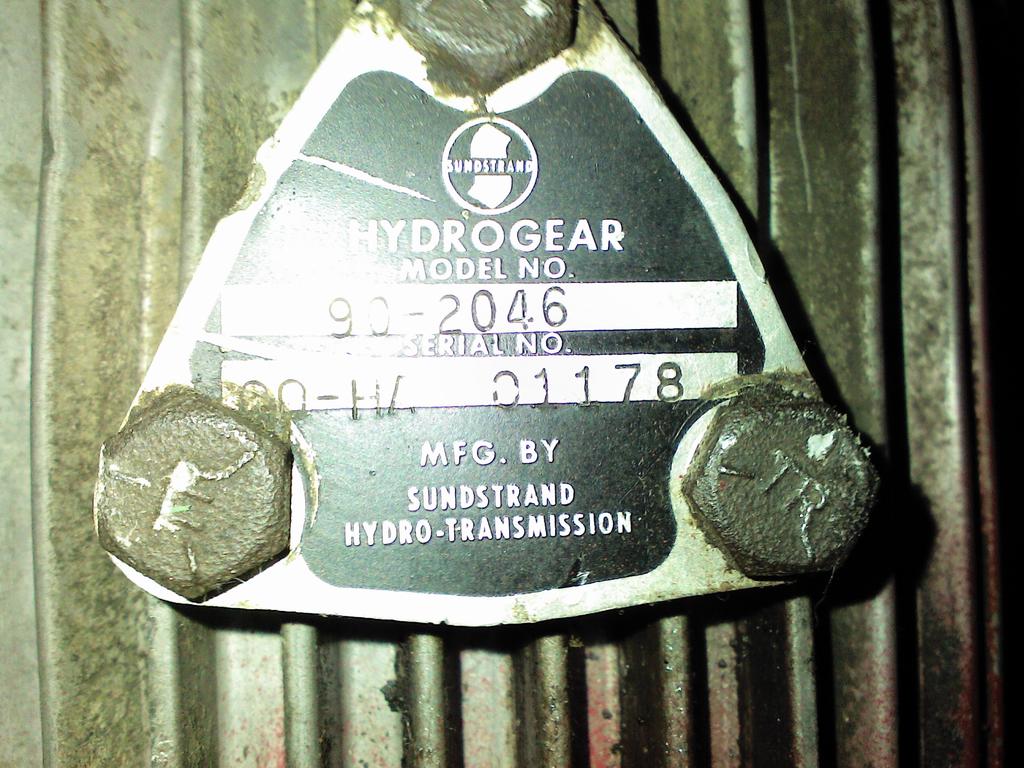

JimmyJam 542 #20 Posted February 26, 2018 (edited) Sorry guys! ...that I polluted the original post, I should have made my own post. I just thought that..."While we are on that subject...." Here's my original pump tag. I also have an complete replacement transmission from Joe's Outdoor (he claims it was working & use to be a vendor here on RS) ++ I have another one on a "No-Name 12" parts tractor. Thoughts???? Edited February 26, 2018 by JimmyJam Share this post Link to post Share on other sites

Sarge 3,473 #22 Posted February 26, 2018 The '68 would have had the hydrogear in it , which is what the 90-2046 pump is listed as and it's also described on the tag. Should use ATF originally, but if it was flushed at one time it may have been changed over to engine oil . Again, unknown history machines can be a nightmare trying to diagnose what oil is in them and many end up getting mixed varieties. Someone put Hy-trans in my 1277 at one time and it destroyed the pump's piston block/piston retaining ring - the whole thing basically exploded internally. Prior to that , the pump was strong as an ox...lesson learned. That tractor still has the older hydrogear from a '66 876 model in it - works perfectly and still runs ATF. In my opinion, the ATF is the best choice for the older hydrogear but it must be changed yearly and more often than that if worked really hard - oil is cheap. Sarge Share this post Link to post Share on other sites
