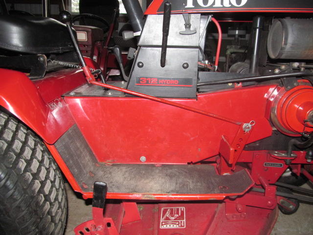

I have a foot throttle on the Crazy Horse.  It works fine for hot rodding, but I wouldn't want it on a working tractor.    I do have foot motion control on all my hydros and  would never go back to hand control especially for blowing and plowing snow in close quarters.
                                                                                                                 FOOT THROTTLE PEDAL
                                                MOTION CONTROL PEDAL
  • Like 5

I have one of Matt's foot pedals on my 95 520H.  I really like it.  Especially when blowing snow.  Much more control with less effort.  For mowing, I like it that I can quickly slow down when needed.  Using that 520H lever on the dash was always a bit awkward.

I am not familiar with the motion control on the 1076 Jim, but I have added this pedal to all the hydros on my Cs, 3, 4, and 500s.
It is an easy addition to any hydro that has the console mounted lever that can be connected directly to a pedal with a rod, and it works great especially for plowing and blowing snow.

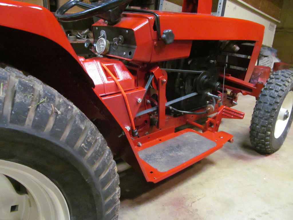

To make a foot control on the older style Sundstrand transmission you have to add an arm to the mechanism where the direction control arm is attached to the boxed frame - that's how the original foot control kits were designed. This allows the clutch/brake pedal to still work and independently control the hydro to stop the tractor - but if your foot is pushing on the hydro direction control via the foot pedal mod the two will fight each other and it won't stop. @gwest_ca can probably find the installation sheets for the early version foot controls...? It's tough to describe how these things are engineered, but with the instructions it gives a clearer picture of how they did it.
Is that a homemade rig Ed?...could you provide more pics and info on it?...looks real handy and cheaper by a lot than the bought ones....:)
