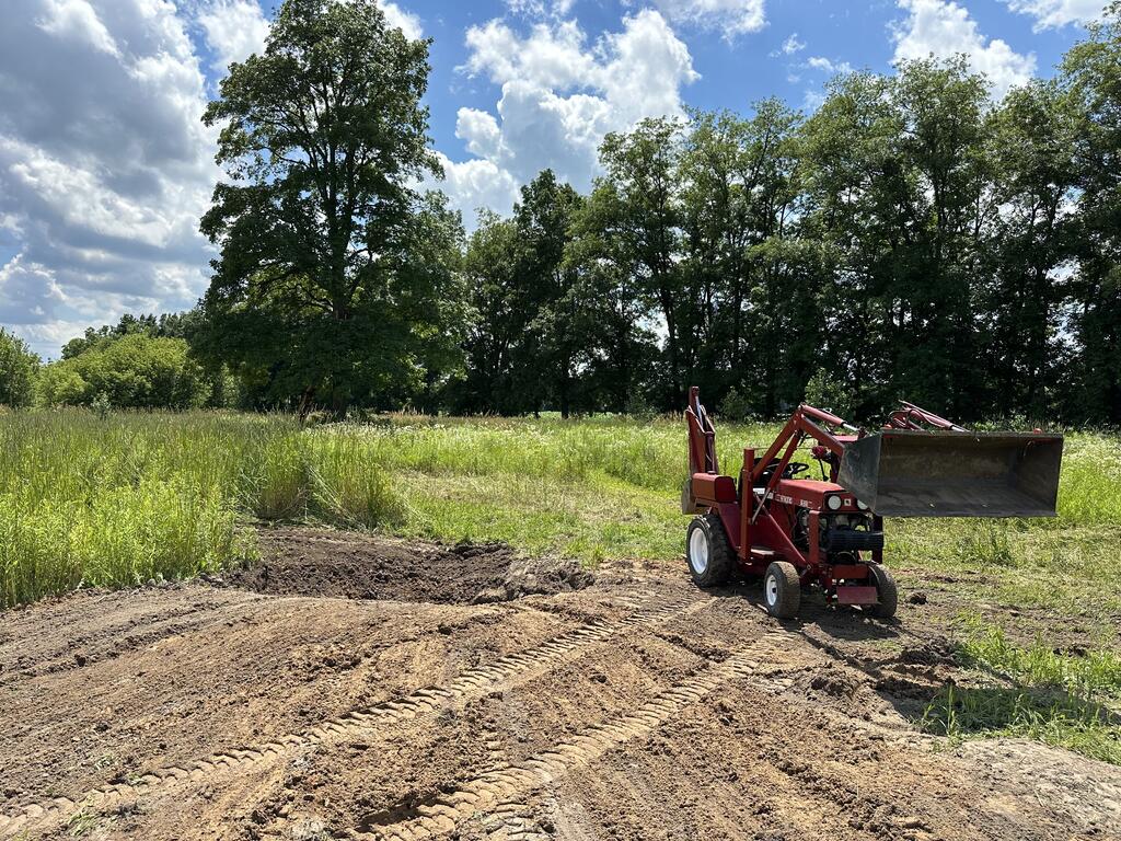

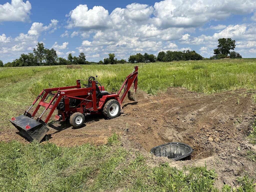

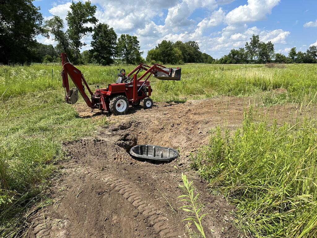

Hello gentlemen!!! I recently bought a d180 with loader and backhoe. Im looking for serial number.. there is a plate under the steering wheel but its been pajnted over and i can make it out. Can y'all tell me another location and was this tractor pruchased originally with these attachments and any info would be greatly appreciated... Thanks fellow Wheel Horse enthusiasts !!! !! !!!
