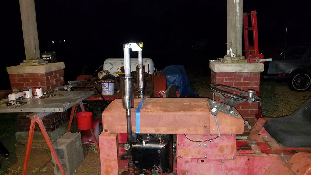

Test firing Big Ugly and the new exhaust
16 minutes ago, Sarge said:
camera's microphone will show the sound too well , but so far I like it
You HAVE had a fun time with the "Big D" I dearly love them but when one breaks it can be a handful!
Your exhaust is similar to what I have done to my 180 & 200. I used a muffler listed as from "Cub Cadet" they are very reasonable and with the throttle at speed the sound sends cold chills down my spine:woohoo: I love it!
  • Like 6
Sweet  sound............:)
I think they sound great!!
  But is your throttle really that hard to move up and down?
Yeah - the throttle is that stiff - need to address it . The F/R linkage was the same way - took care of that when I was swapping out the pumps , just needed every single part of it cleaned and properly lubed . Someone had used what I think is chain lube on lots of these parts - but the stuff got extremely sticky and hardened . Brake cleaner will barely touch it .
The tubing I used is 1-1/4" to match the port size exactly up to the mufflers - then it's 1-1/2" from there . Gives it a unique tone but under a hard load it does bark a bit . I found a slight leak last nite after the second burn-in run on the paint - not the hydraulic line manifold but with a mirror it appears to be one of the aluminum pump housing bolts - will pull the left side panel today and figure it out . This pump is extremely smooth and seems to have a lot more response than the original .
I'd imagine the engine will pull a lot better than with the stock pipes - they were plugging up inside from all the rust flakes pretty badly , now it can actually breathe .
I agree , love the big D's but when they break they are a true pia....

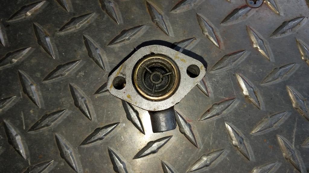

Anyone truly familiar with the twin K's crankcase breather system ? This engine is starting to develop a few small areas where it wants to weep oil - front pto bearing plate and the dip stick itself particularly ...??

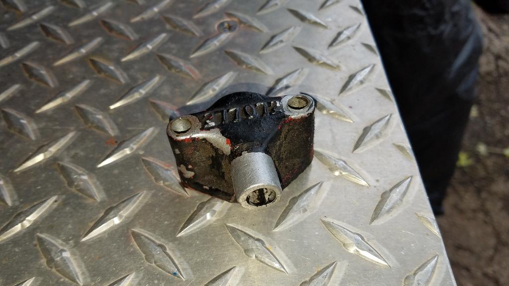

After the initial test firing and obligatory "ride around the block" I had found a slight oil leak . Almost looked like it was coming from the aluminum pump housing or something - even with a mirror it's tough to get a look at anything in there . Took the left side panel off and checked every fastener in/around the pump , nothing found . A closer look at that time showed everything dry but there are traces of oil that were slung around from the engine flywheel screen . Hmmm...
So , I suspected it's possibly from the engine itself and not the hydro pump system . Pulled the breather and gave it an inspection and cleaning . Ran it again last night for a bit to get it to full temperature - no leaks . Been hunting on the net for a replacement breather element - seems they don't exist now at all . I do have a question about the mounting face side and a small recess that appears to be machined into the body -
The valve and it's 277072 part number -
Note the half machined hole/recess in the gasket area - the valve can bypass there a little when testing it -
I cannot find a new replacement , assume they are NLA as many other parts for this engine series are retired . The main seal does hold any are flowing in the direction of the crankcase to create a slight vacuum except for that machined recess - it appears the governor side gasket would cover up that hole just fine although the gasket is hard and not compliant - wonder if that's a problem ??
Anyone know much about these breathers ? Seems these were only used on the K-482/532/558 engines and the K-662 used a breather on top of the valve box instead .

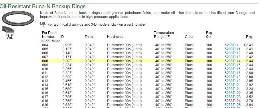

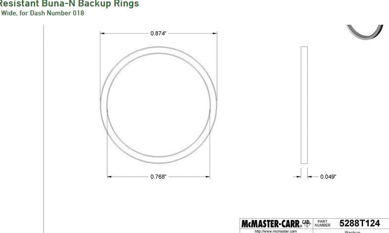

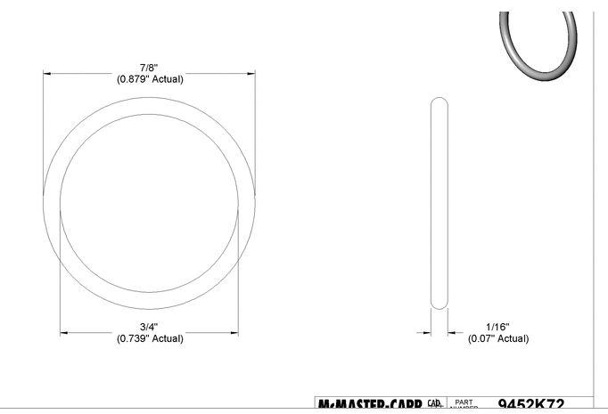

I happen to have two Toro sourced backer rings.  They measure .049 inches thick...exactly the same as the ones i got from McMasters (Dash 018)  I really do not think they are proprietary custom jobs.  Anyway mine hasn't leaked for several years...
Maybe the originals came from sundstrand but toro substituted the standard dash 018 to fill parts orders????

.093 is the depth of the groove on a spare manifold I have.  The stacked Dash 018 ring and backer measure .103 (Combined spec thickness of . 07 o ring .049 backer of .119, but teh oring fits into teh backr ring a bit....(Mind you I do not have pro quality measuring equip so plus or minus a bit.)  I measured the groove depth on a hydro motor got .0935  You do not have leakage on the motor end (same o rings)...could the groove in your manifold be a tad to deep???

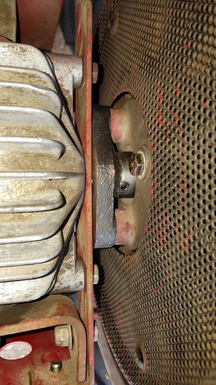

Like I said - that gasket was indeed leaking once I had it apart and a closer inspection performed - someone has been in here before for sure . The slippers and everything look new , not kidding and are highly polished . Same deal with the valve plates and such as well as the swash plate - all nice and shiny with no scratches at all .
Now that it's back together , a new leak has cropped up - this time at the swash plate shafts on both sides with the left one being far worse . Pump works good and feels stronger than ever , but the direction control seems far too sensitive and it constantly wants to creep no matter how many times I've gone through the adjustment procedures . It's almost like it has no neutral point now - maybe linked to the leak in the swash plate shafts ?? I've gone through the linkage drawing for the '74 model that fits everything on this beast - all parts are assembled correctly and I've corrected some wear in the cam plate with a bronze sleeve bearing to remove the excessive slop it had .
I need to read through the Sundstrand manual again and re-visit the procedures for putting the housing section back on the pump - maybe I missed something . I know for certain I got the valve plate oriented over that indexing pin , remembered that from the manual and paid extra attention to it during the reassembly process . Maybe something moved with the swash plate pins or those parts when I opened it - need to figure that out and repair those leaking shafts as I don't want oil being sucked into the engine's flywheel screen and coating the fins in the big K . I know I probably did the reassembly somewhat backwards - I centered the pump block on the plate and lowered the housing onto the block section - I think the manual wants it done the other way and maybe that's the reason for the direction control's operation being so weird .

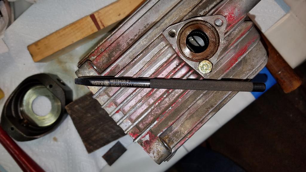

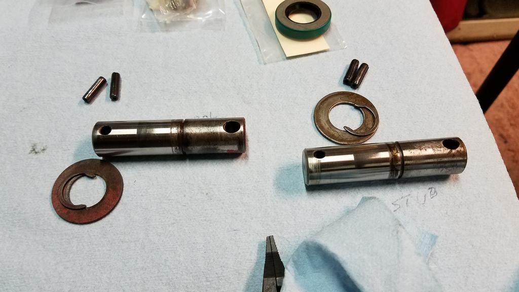

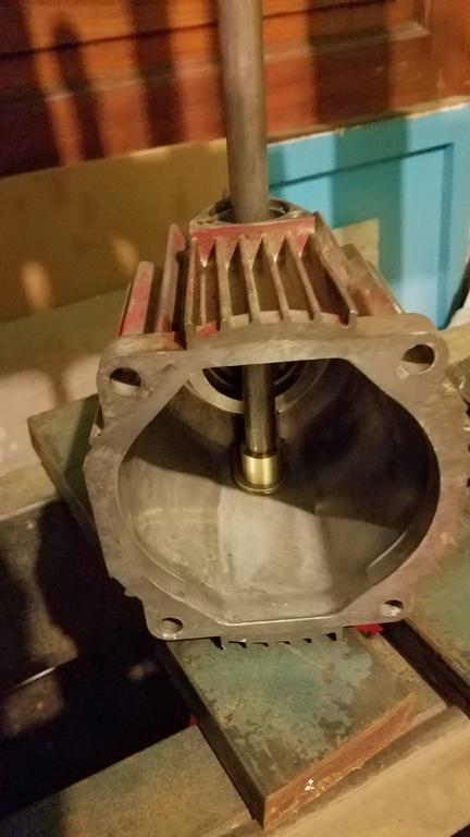

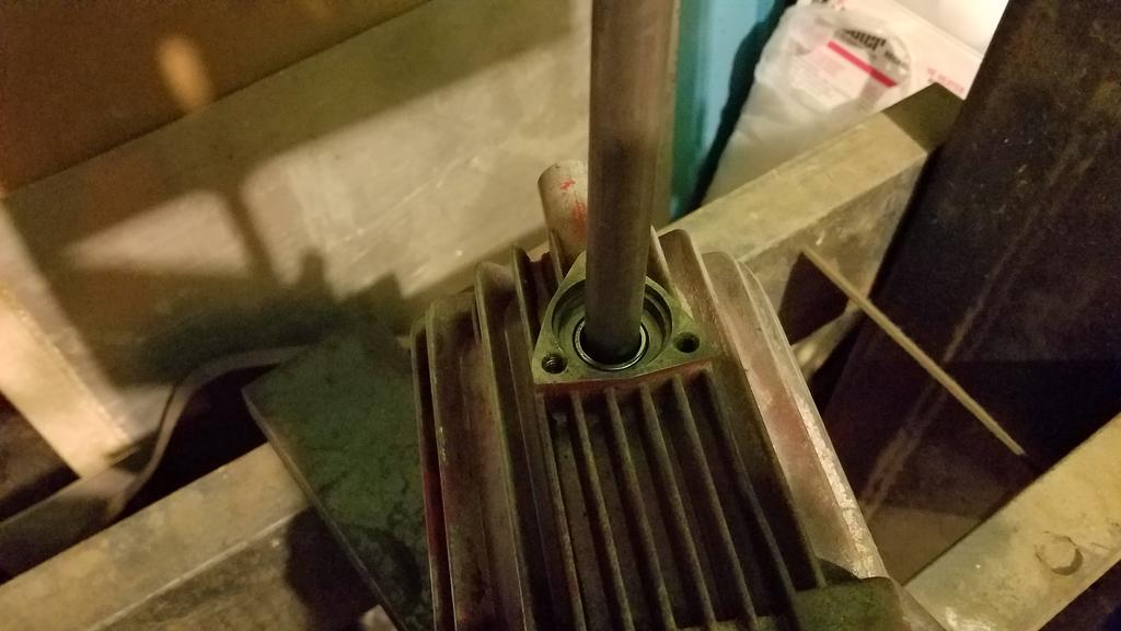

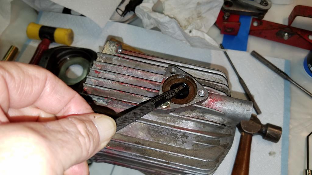

Spent some time and moved the crippled 1277 out of the 10x12 shed and did some sealing work so I can heat the shed at least to some extent . The D is in there in pieces , again and the pump is in the basement . Worked last night to clean and disassemble the aluminum housing section and replace those pesky trunnion shaft seals - both were hard as a rock and one was even cracked in the rubber ring section - found the leak . Both needle bearings were in decent shape but it got two new bearings and seals anyway - enough of taking this thing apart time and again already . Had a tough time digging out those seals without destroying the aluminum housing - those smaller sized seals are a pain - then I realized I have a specialized tool for that - duh .
Insert that tool into the seal , hold forward pressure on the end of it and strike downward with a hammer - pops them right out easily . I used a short 1/4-20x1/2" bolt to protect the housings casting around the seal area . That tool is some seriously hardened steel - almost no flex at all and works quite well in some tight spots . The tool is part of a Toyota/Lexus front axle lock nut removal set that comes with a socket to fit the front wheel drive cars - I need to ask the Matco guy if they can get that tool separately - would like to have a spare as I use it a lot around here .
Upon inspection - only very light wear just starting to show on the trunnion shafts themselves - will flip these 180* from their original orientation to prevent damage to the new needle bearings . I don't even want to ask what these shafts cost to replace - they are hardened and polished .
When it came time to push those needle bearings out I spent a few minutes making a brass insert and a steel rod with a pilot end to fit into the brass part on the lathe - helped a lot pushing those bearings out straight and installing the new ones . Was surprised how tight they fitted these needle bearings but that is how they set the final shaft fit .
I'll have to check around today and see if I can source another CR7475 input shaft seal - got ahead of myself and installed it after doing the needle bearing seals , duh - it has to wait until the main shaft and circlip is installed first . No way to extract and re-use it - shouldn't work so late at night as it's too easy to make mistakes .
I spent some time inspection the swash plate and piston block assembly - all are in very nice shape and the parts look like new . Same with the thrust plate . I can find nothing in this pump that would explain why the direction control linkage/arm is so far off when the pump is in it's neutral position - makes no sense whatsoever . Last time the only way it would sit still running was with the linkage adjusted all the way to the one end and the direction control handle halfway in the forward position - no way at all to hit the neutral point on that control handle . It also constantly wanted to go in reverse - this part I can't make any sense out of it - been through the linkage drawings and such several times , had the linkage completely off and nothing is out of place or assembled incorrectly .

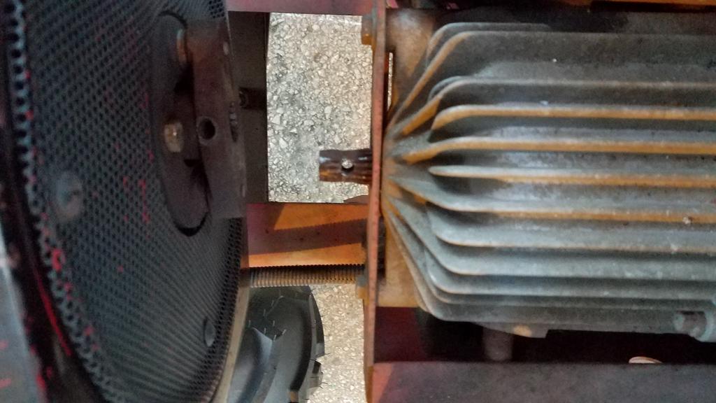

Even trying to adjust the eccentric to it's limit it makes almost no difference - that has been driving me nuts - anyone else ran into this ?? If it is placed into the park position regardless of how the parking brake is adjusted as soon as the engine is started it's trying to go in reverse and jamming the park brake . Going to dive into that linkage one more time and compare it to the assembly drawing for the '74 - which fits this model .
Is there a chance this pump is different in it's control arm ? I have no idea what year it was from or what model D , bought it used so that's about all I can possibly think of - the only linkage setup I have is for the '74 and I see no reason they would have changed orientation of the pump arm clocking position ?
If anyone has insight on this - I'm all ears for sure .
