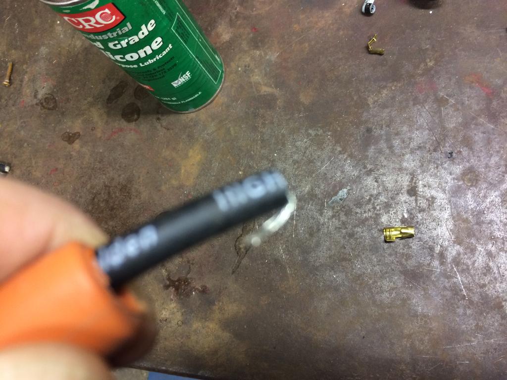

squonk 46,095 #12 Posted November 5, 2017 Strip the wire about 3/4" Spray silicone into the plug boot and on the last few inches of the wire. Slide the boot on and then fold the bare wire over and crimp on the plug terminal. Then pull the wire so the plug terminal slides into the boot. I use a phillips screwdriver to line up the terminal and seat it into the " 90" of the boot. 5 Share this post Link to post Share on other sites

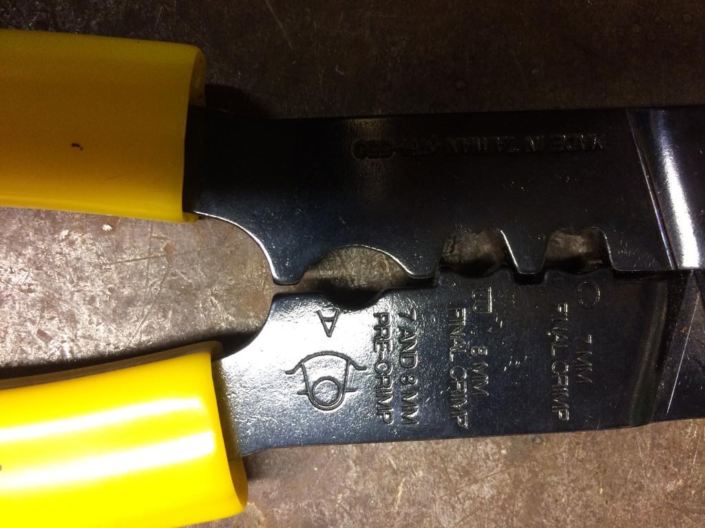

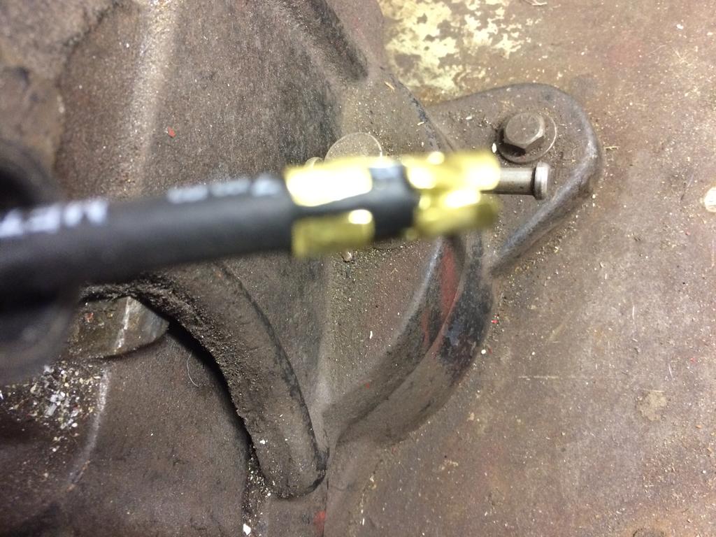

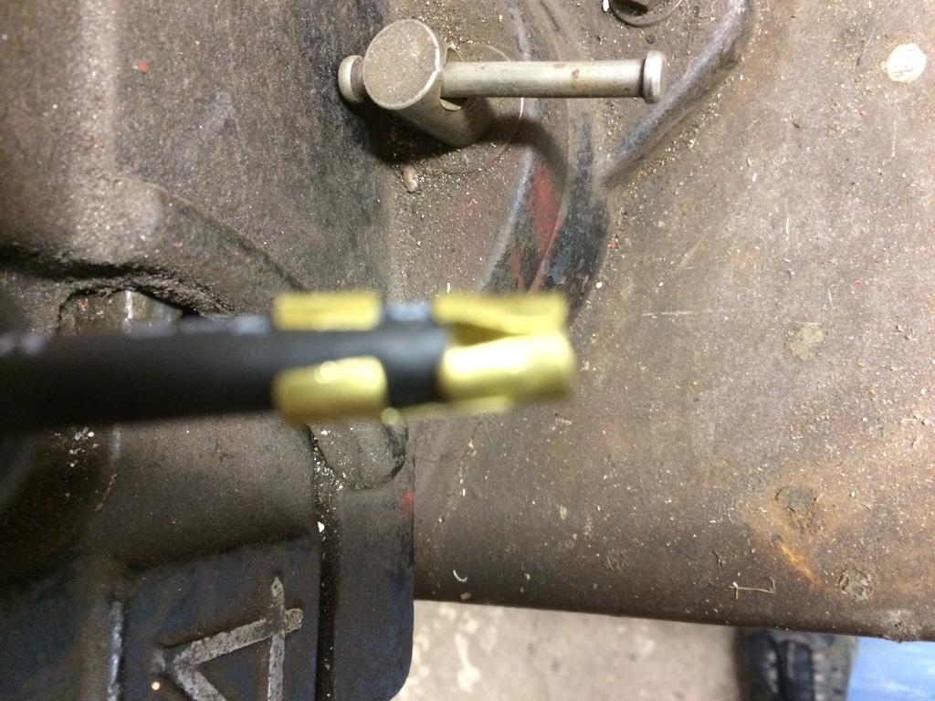

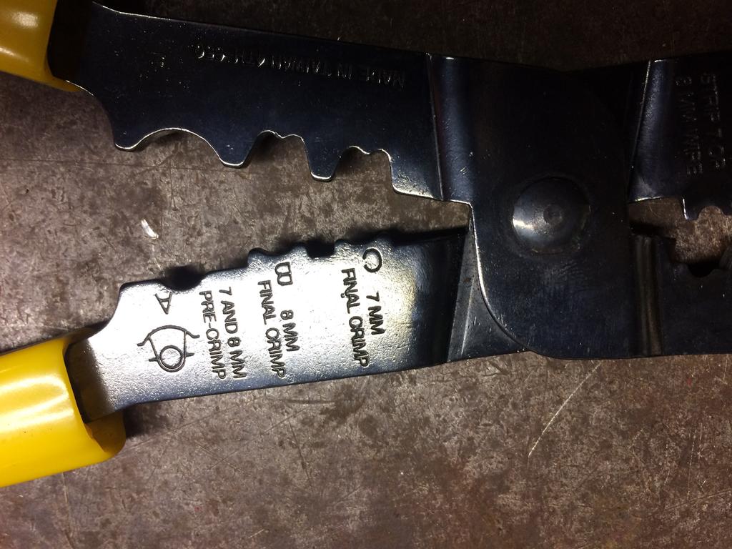

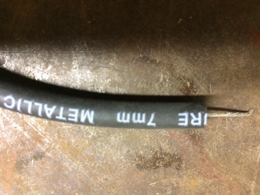

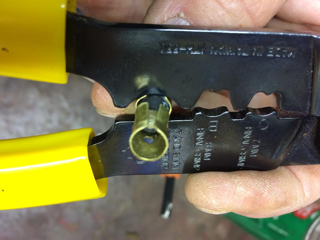

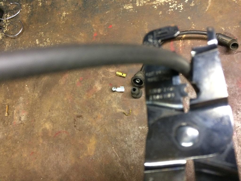

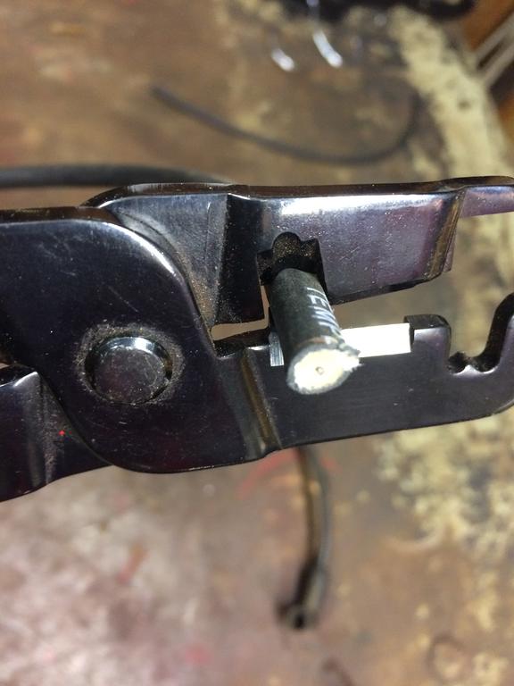

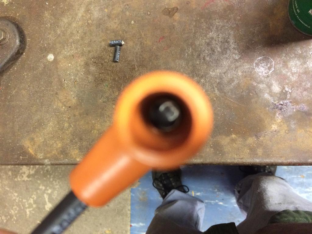

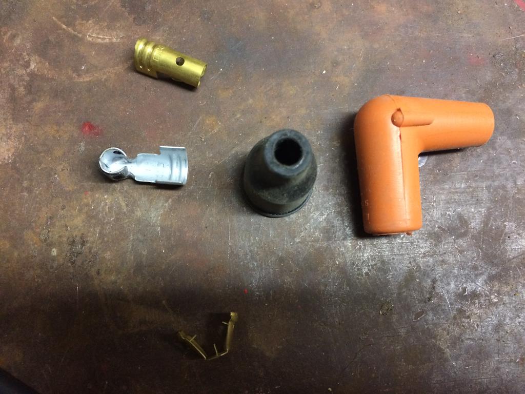

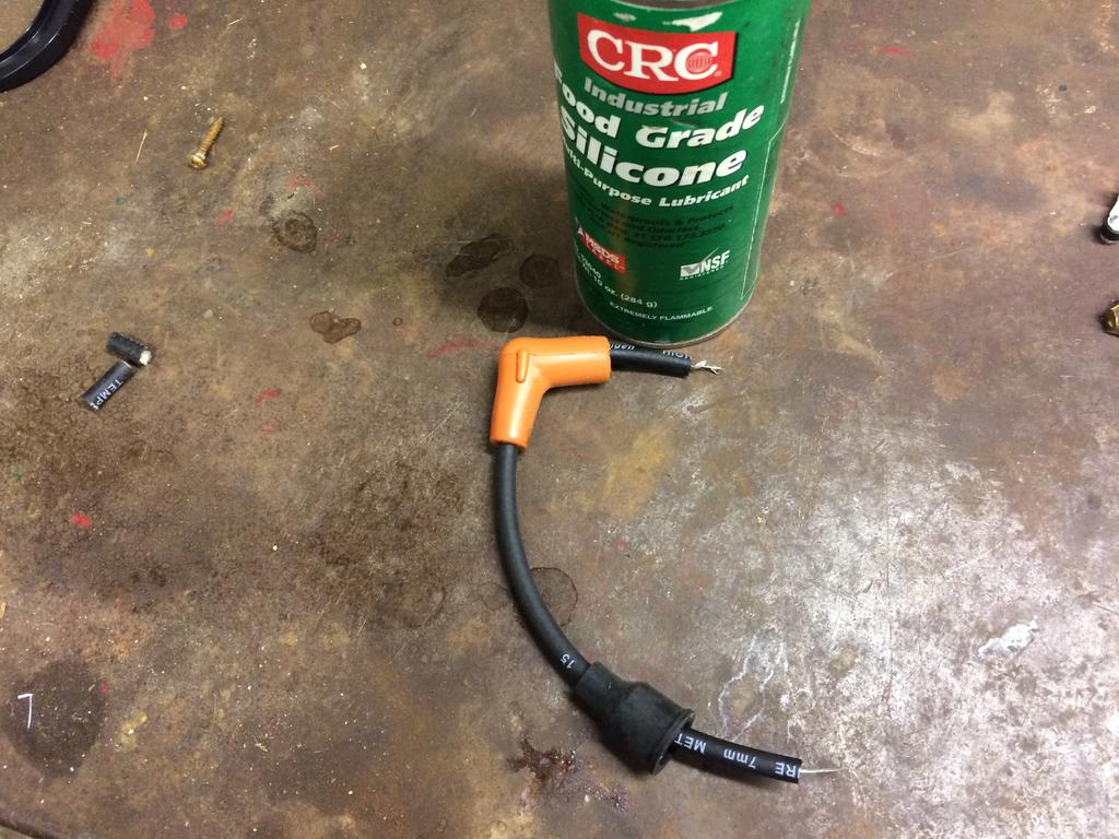

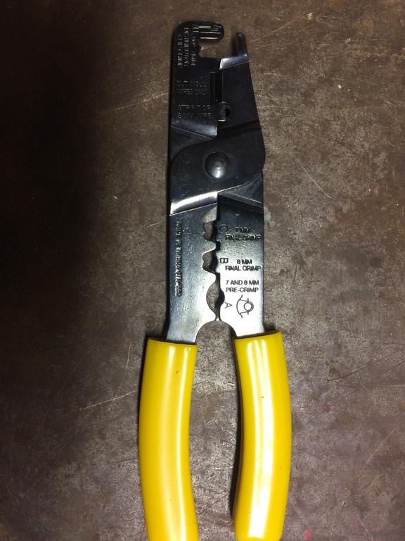

squonk 46,095 #20 Posted November 9, 2017 (edited) @tunahead72 Here's the wire making process: I needed to make one for my C-160 anyway! Sorry for some blurry pics. My phone wouldn't focus on a couple of them for some reason The special crimp tool. It has a cutter, stripper, 7 & 8MM pre-crimp slot and 7 and 8 *MM final crimp slot. On the end is a 90 deg distributor crimp slot. The parts laid out. the clip on the bottom is a coil terminal used on some older engines. I haven't run across one of these in years but I keep one just to have. first cut the wire to length. Strip ends. silicone the wire and slide the boots on Fold the wire over Slide the terminal on the wire making sure the bare wire is opposite the crimp. Put it in the "Pre Crimp slot. End pre-crimped final crimp Same process for the plug end. After crimping I give the boot and wire a good shot of silicone and pulled the wire into the boot. This one slide right in and I didn't have to give it any help to align and seat it. Edited November 9, 2017 by squonk 2 4 Share this post Link to post Share on other sites
