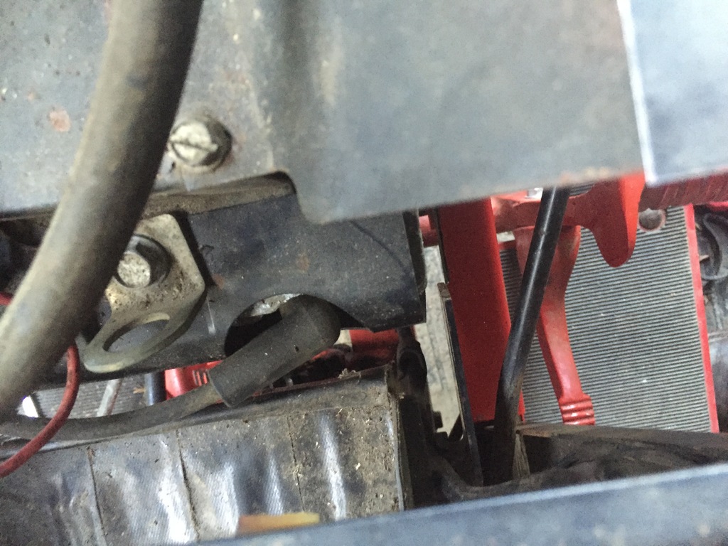

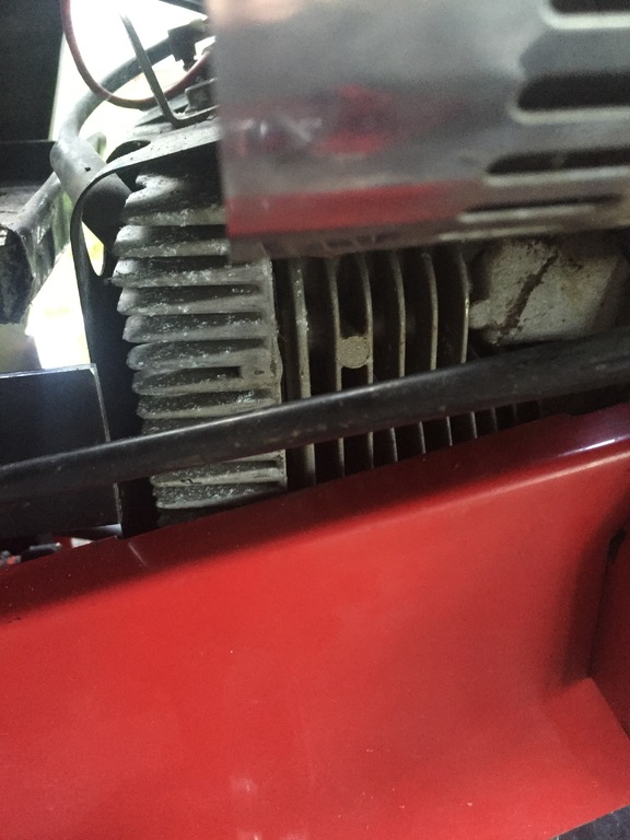

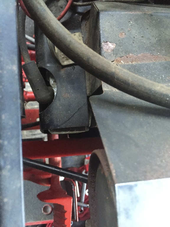

Bert 804 #2 Posted June 7, 2017 (edited) The rear cylinder is shrouded and holds heat. Myself and other members have noticed that the belt guard bracket is up against the fins near the valves. The valve seat failures are a common problem like you said you read. I trimmed my belt guard and brace and can feel a noticeable increase in the hot air blowing out the side. Edited June 7, 2017 by Bert 5 Share this post Link to post Share on other sites
Ed Kennell 46,233 #3 Posted June 7, 2017 Anything you can do to increase the air flow across that rear cyl can only help. Those Onans really throw off a lot of heat. That was one reason I designated my 520 a snow machine only. It was too hot to use for mowing. With the belt guard vented and a collector around the rear cyl., the cab stays about 35deg above outside temp. which is perfect for snow chucking. 5 Share this post Link to post Share on other sites

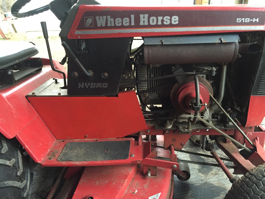

Bert 804 #11 Posted June 8, 2017 2 hours ago, Cee245 said: @Bert, I can see in your 3rd photo how much lower the drive belt cover is, how did you do it? Do you have a similar photo further back on tractor? Thanks The belt guard is in the stock location. Unfortunately the tractor is at the family farm right now. However I have a pic of my 520 HC with 518 hood that may put a better perspective on the location of the parts in question. The belt cover was damaged so I just cut it off. Follow the belt and you can see it doesn't overlap the valves at all, in my opinion the belt guard bracket is more of an obstruction then the guard. 3 Share this post Link to post Share on other sites
