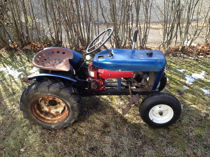

So here's a couple of better pictures of the front tires on the machine. And the requested full screen shots.  I put the motor on today, threw in a temporary plastic fuel tank, set the hood on for giggles and gave it a couple laps around the yard.  Still have  a few things fine tune and a handful of pieces to paint but I'm getting close.
AMC RULES
WOW! Thanks Rich...those things really do look sharp.
Look perfect on our little   :wh: round hoods.
Hood looks AWESOME!     :handgestures-thumbsup:

Thanks Craig. I'm very pleased with how they look. Almost as good as a pair of clean originals.  I was pretty lucky with the hood.  It was straight and only had some small dents and a couple of small cracks and tears.  Was able to pound out some of the small stuff, welded up some of the cracks and tears.  There's some filler here and there to smooth out the top and the nose. Made a few mistakes painting it, followed by some wet sanding and a respray but I managed to make them disappear.  All in all I'm very happy with how it's coming out. Learning a lot for the next one.  This is what I started with.
