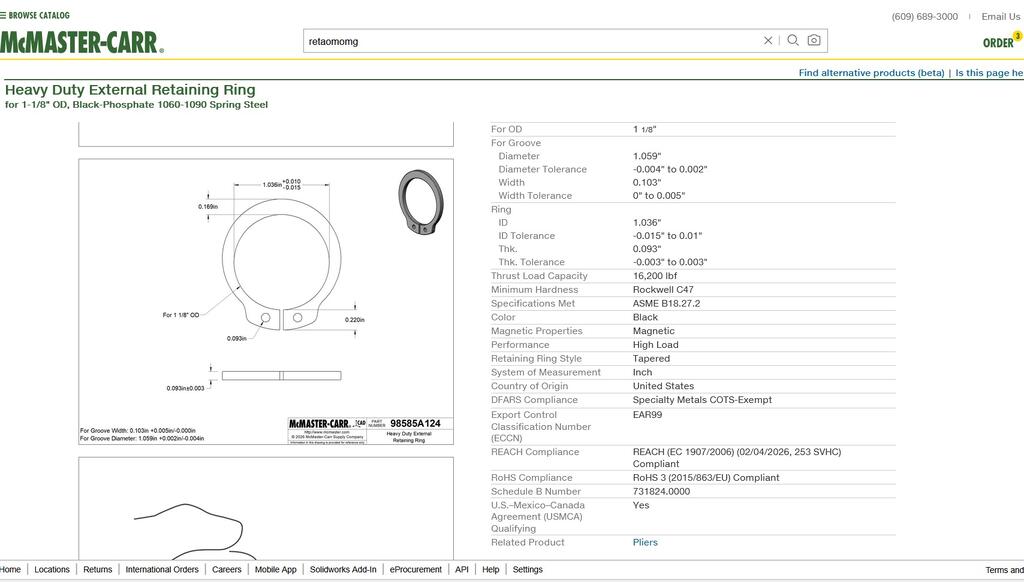

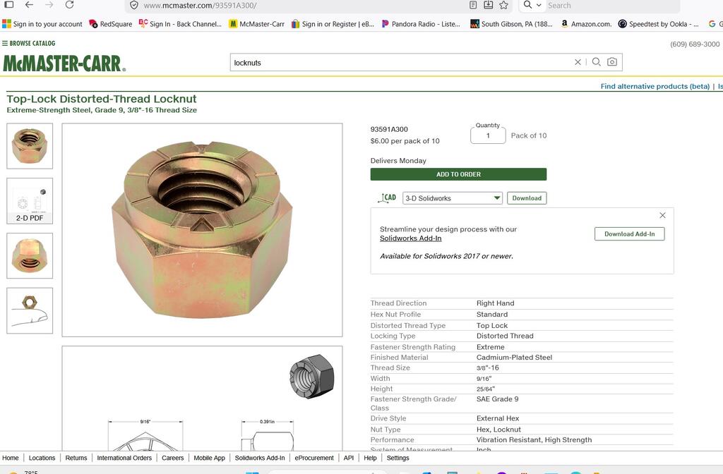

953 nut 69,187 #6 Posted June 4 3 hours ago, 608KEB said: reattach clip that holds each shaft together in center of transmission. Also what would a suggestion be as how to place transmission, so it's easy to work on There is a HEAVY DUTY snap ring on each axle that retains them in the differential. You should mount the snap rings with the sharp edge toward the opposite axle when installing them. You would be well advised to replace Flex Top lock nuts on the differential bolts, McMaster-Carr is a good source if you don't have a good local source. https://www.mcmaster.com/products/nuts/locking-type~flex-top/ Engine stand mounting would be good for cleaning but once you are beyond that point it is a table top project because the housing needs to be split. 2 Share this post Link to post Share on other sites

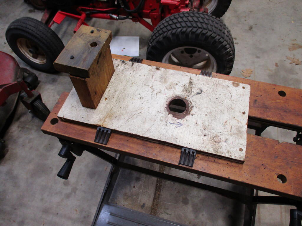

Achto 32,650 #8 Posted June 5 I recently replace the axle bearings & seals on one. I use a table that the top two pieces separate on, this allows the tranny to be placed with the right hand side up. 4 1 Share this post Link to post Share on other sites

953 nut 69,187 #12 Posted June 5 29 minutes ago, Achto said: I was easily able to remove the right hand side to replace axle bearings without removing the pump. I started with this method once while replacing a broken axle. The taking apart portion was fine, but the reassembly and keeping the gasket in place while getting shafts into the needle bearings while finessing the heavy casting into place just wasn't my cup of tea. The "Work Mate" like Dan @Achto pictured above is a much better way to do it. 9 hours ago, oliver2-44 said: With a hydro cleanliness is paramount. Clean the outside to a sparkle before you split it open. Any dirt that gets inside will shorten the life of any hydro. If you don't have a pressure washer at home load it up and take it to the self-service car wash. 2 2 Share this post Link to post Share on other sites
Achto 32,650 #13 Posted June 5 (edited) 38 minutes ago, 953 nut said: The "Work Mate" I use and abuse that little table A LOT. It's handy as heck, has a good work height, and stores small. I have had to replace the top boards once or twice in it's 15+yrs of service, mainly do to abuse. https://www.walmart.com/ip/BLACK-DECKER-WM125-Workmate-Portable-Project-Center-and-Vise/8054746 Edited June 5 by Achto 2 Share this post Link to post Share on other sites

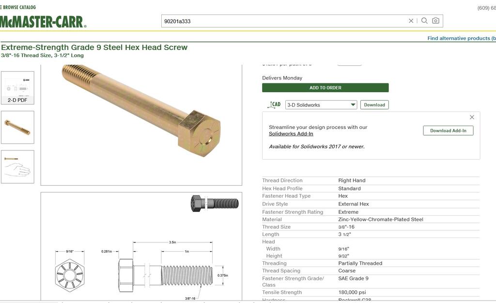

pfrederi 21,145 #15 Posted June 5 Another vote for workmate with a custom jig the hole in the vertical is for the brake arm shaft. These are what yo want for bolts (180,000psi) nuts and rings. 2 1 1 Share this post Link to post Share on other sites
