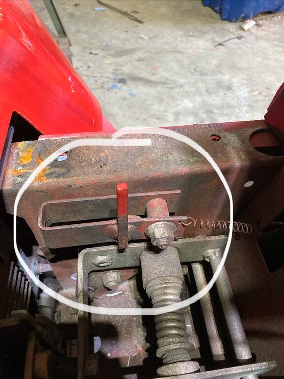

MainelyWheelhorse 3,133 #1 Posted October 9, 2025 Hi all, lately I’ve been working on the C-141 Automatic tying up loose ends. I’m working on the parking brake, and aren’t sure if the spring setup is like the 8 speeds, Or if it’s just the one spring like what’s on it now. I’ve looked it up online. The schematic pictures don't really show well how the brake goes together. Any assistance on figuring out the parking brake setup is appreciated. TIA. 1 Share this post Link to post Share on other sites

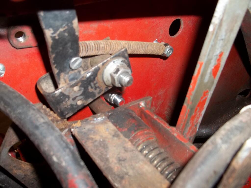

953 nut 69,337 #6 Posted October 9, 2025 (edited) 1 hour ago, ebinmaine said: Eaton trans. A C141 has a Sundstrand. Is the linkage the same? Eric, your pictures probably will be helpful to @MainelyWheelhorse though I think the parking brake linkage is the same on the Eaton 1100. When I changed from the Sundstrand Hydro-gear to Eaton 1100 the linkage was very different but the later piston to piston on the C-XX1 has about the same parking brake set-up as the Eaton's. 1 hour ago, MainelyWheelhorse said: I didn’t see any noticeable springs that returned the lever to unlocked like the 8 speeds do. You are looking for the spring that connects to the parking brake cam or lever inside the tunnel where the direction control lives, is that correct? I have a photo of the spring that returns the parking brake as installed on my GT-14. I had to use some 10-32 bolts in place of the Wheel Horse attachment points due to this being a modification but the hook up should be the same as yours. Just found the picture. Edited October 9, 2025 by 953 nut add photo 1 1 Share this post Link to post Share on other sites

MainelyWheelhorse 3,133 #9 Posted October 9, 2025 I’m looking for how this (white circle) is set up. Looking at it now, It looks like it’s set up right looking at @953 nuts pictures and @gwest_cas picture. I figured there would be some sort of return like the 8 speeds but I guess not. My return spring is pretty shot though. Thanks for the help! 1 1 Share this post Link to post Share on other sites

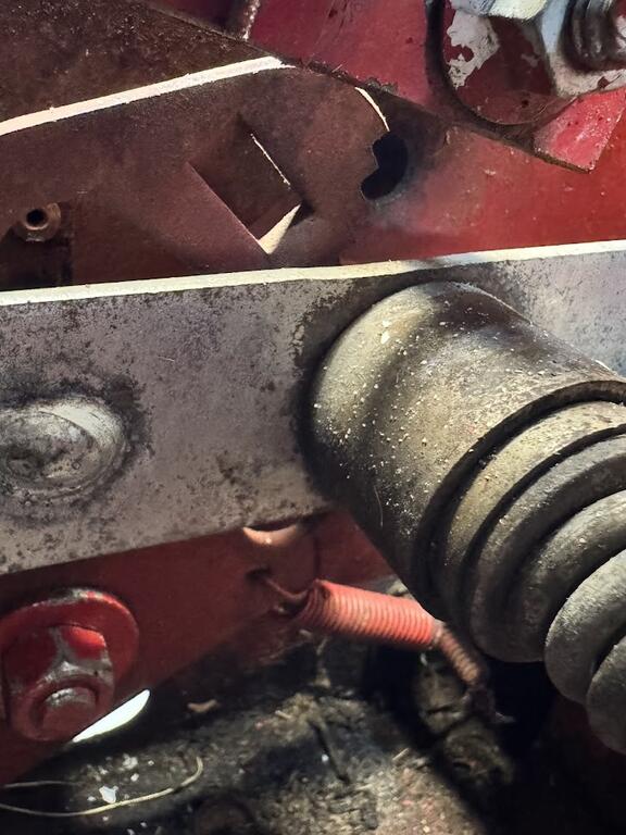

Bar Nuthin 3,242 #13 Posted October 11, 2025 The brake pedal spring is a tough one to get a picture of. 1 Share this post Link to post Share on other sites
