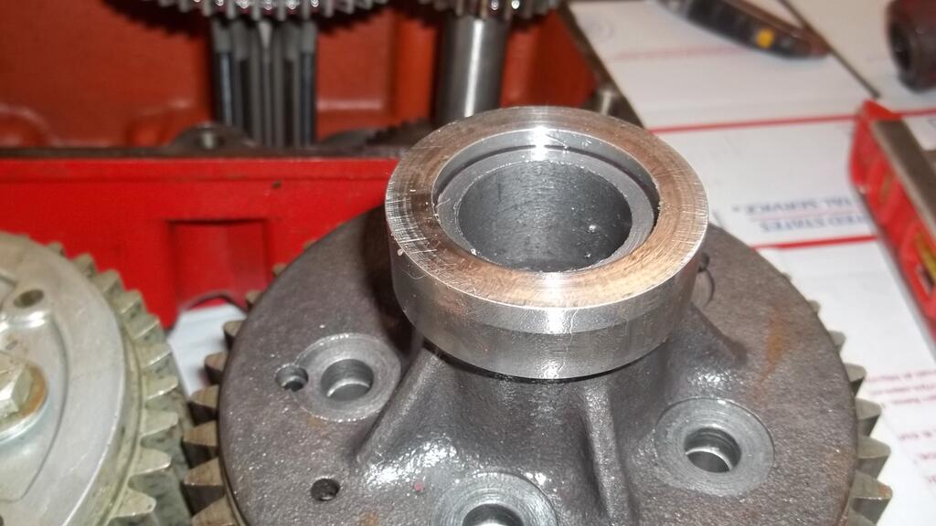

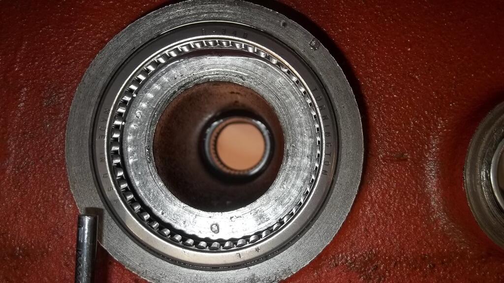

oliver2-44 11,248 #18 Posted October 10, 2025 7 hours ago, stevasaurus said: It seems you guys want to change a 6 speed case to an 8 speed case or change out an 8 speed case to a 6 speed case. Both will bolt in directly, but now you need to deal with all the linkage and brake drum. You also need to swap the cluster gear shafts, the mushroom gears, the cap and threw bearings on the left side of case. The bull gears and the small gear of the 11/44 tooth gear will mesh, but the length of the gears cut into the mushroom gear may be an issue. Yes Steve, I have 8 speed cases and 8 pinion differentials, and want to build a 6 speed sourcing the minimum number of gears. I do recall a post where a member had to grind the end of a mushroom or 11/44 gear for clearance. @ebinmaine if you can look at you 2 transmissions and determine if the brake mounting flange is the same on both cases, I think the internals are sounding positive. 1 1 Share this post Link to post Share on other sites

stevasaurus 23,619 #21 Posted October 10, 2025 @oliver2-44 Hi Jim, You should be able to do what you are looking to do. Remember that the 11/44 gear teeth is positioned different because the axles on the 8 pinion are equal length...the axles are different lengths with the 10 pinion differential. 1 1 Share this post Link to post Share on other sites
