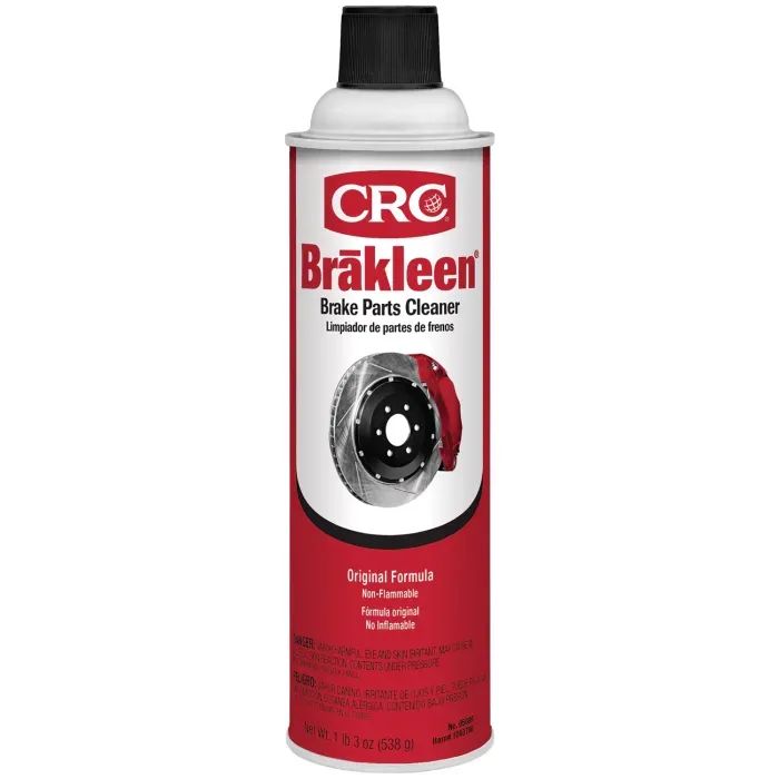

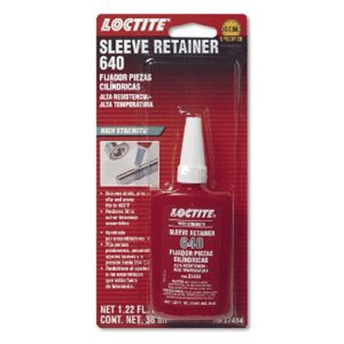

squonk 48,427 #5 Posted August 14, 2025 Use Loctite green bearing retainer on the outside of the seal. Clean the surfaces good with non-flammable CRC Brakleen in the red can. 4 1 Share this post Link to post Share on other sites

WHX?? 58,388 #8 Posted August 14, 2025 Just a reminder loctite won't do any good if surfaces are greasy or oily. 3 1 Share this post Link to post Share on other sites
