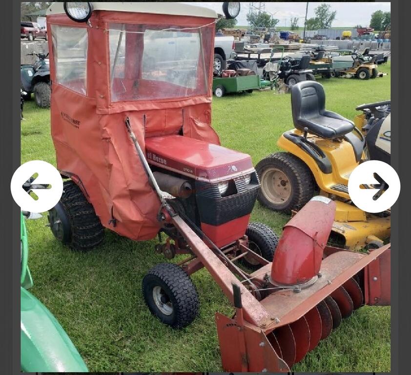

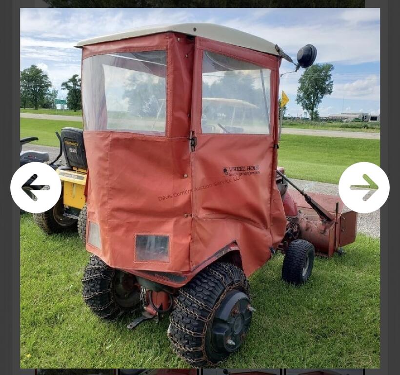

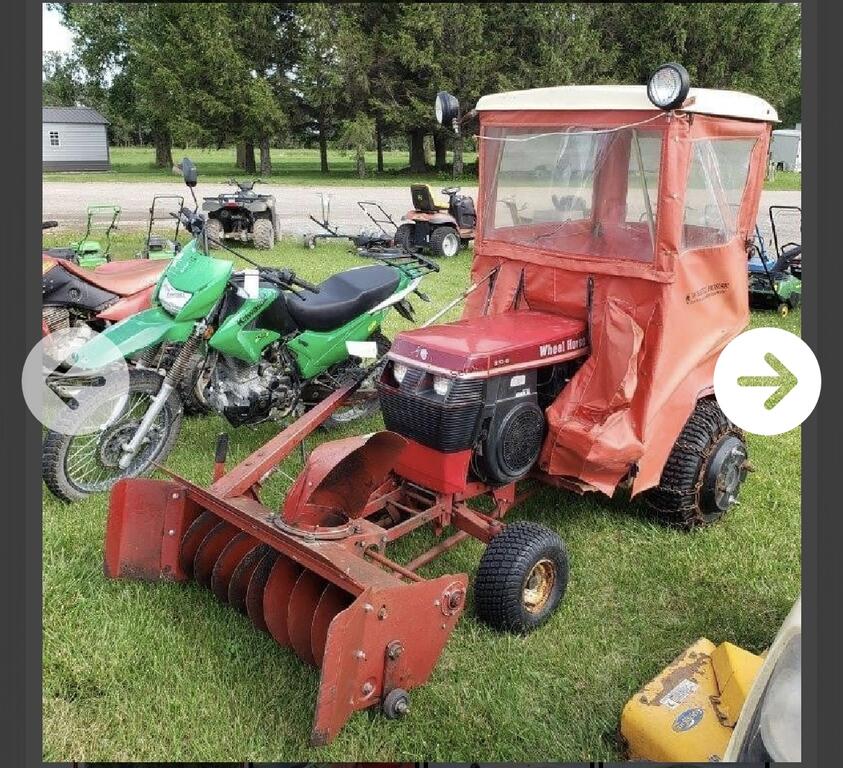

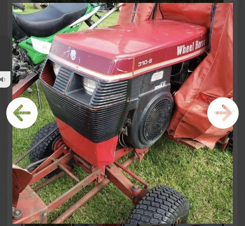

Keaton 466 #1 Posted July 14, 2024 I just got a wheel horse 310-8 tractor with a snowblower, the ultimate show plowing mechine, it has a 42inch snow blower, rear plow mount on it, a cab, wheel weights and chains and lights on the cab, did they come standard with them? and aren't cabs kind of a rare option? and is there any other form of id on the wheel weights than the sticker? I don't have it home yet, I was about 3 hours away at a grandparents house, and went to a auction there. I got that wheel horse for $600 I feel like I got a decent deal.it runs and drives thought all gears something in the back squeaks a bit I think or something does and it has 1400 hours on it.. I will go get it soon. 1 4 Share this post Link to post Share on other sites
wallfish 20,618 #2 Posted July 14, 2024 Looks like the lights were added by the previous owner. Some came with a single light on the top. The glass wind sheild with a wiper was also an option. 3 Share this post Link to post Share on other sites
cleat 9,335 #3 Posted July 14, 2024 (edited) Looks like it has the idler pulley for the tiller under the engine. If so then it may have the rear tach and rear lift as well. Bonus parts if so. Edited July 14, 2024 by cleat 1 Share this post Link to post Share on other sites

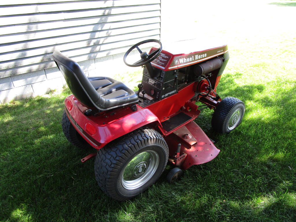

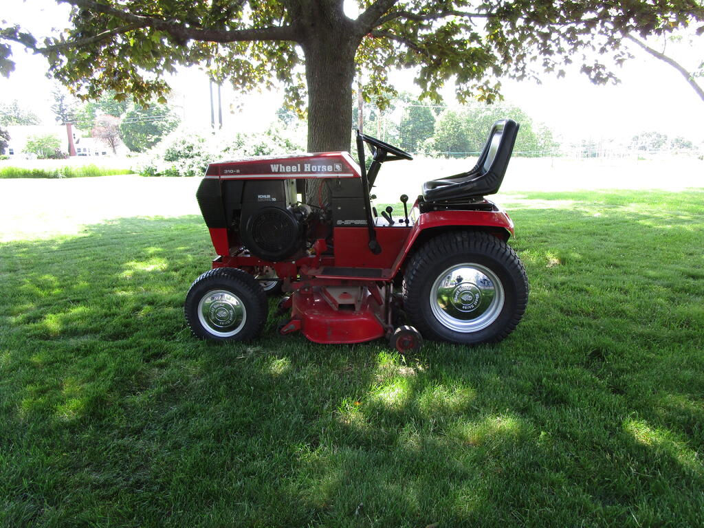

JCM 11,415 #19 Posted July 15, 2024 This 89 310-8 was sold last September to a RS member at the Meet & Greet minus deck and chrome hubcaps. This was used with a 42'' Side Discharge deck on a well maintained lawn, cut dry and never had any issues. Keep your decks CLEAN. @Keaton Good Luck 2 Share this post Link to post Share on other sites
