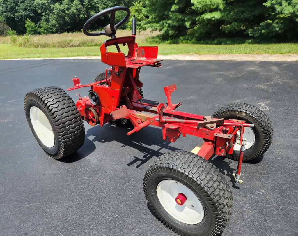

Lee1977 7,813 #26 Posted June 16, 2024 18 hours ago, Racinbob said: I'm strongly leaning in that direction. Besides, I like to try using a hvlp spray gun with some Rusty Regal and hardener. I've had the gun for years and have never tried it. I painted this one with a HF gun with Rustoleum IH red, Acetone and hardener. 3 4 Share this post Link to post Share on other sites

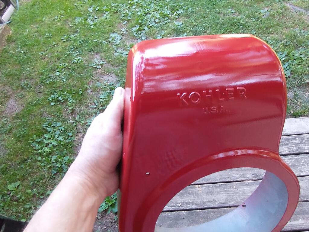

squonk 48,429 #27 Posted June 16, 2024 What clear are you using? I'm no painter and aren't doing anything special. But working at Napa I made and sold a lot of paint and listened to every body shop guy I ran into. Hardener seems to make the enamel dry faster but it still seems brittle to me. I think maybe the Rustoleum maybe is a low solids paint. I just painted this blower housing for my 1467 a couple of weeks ago. It's replacing a dented one. I got it at the show last year and screwed up and painted it Regal Red with clear over it. About an hour after I did it I remembered I had painted the tractor a slightly different red. It was a color I picked out in a chip book at Napa and I sprayed it as a single stage Urethane. So I let the housing sit 6 months or so. I got a spray can of the red I used mixed up at Napa and then tested things. Took a piece of metal and sprayed Regal Red and cleared it and let it sit a few weeks. Then I sprayed the Napa paint over the Rustoleum and cleared that with the Rustoleum clear. Looked great so went ahead and sprayed the Napa paint with the Rustoleum clear right over the year old paint with no sanding or scuffing. I think it came out pretty decent. I got a run it it but I'm not to worried about it as the hood will hide some of it. 3 2 Share this post Link to post Share on other sites

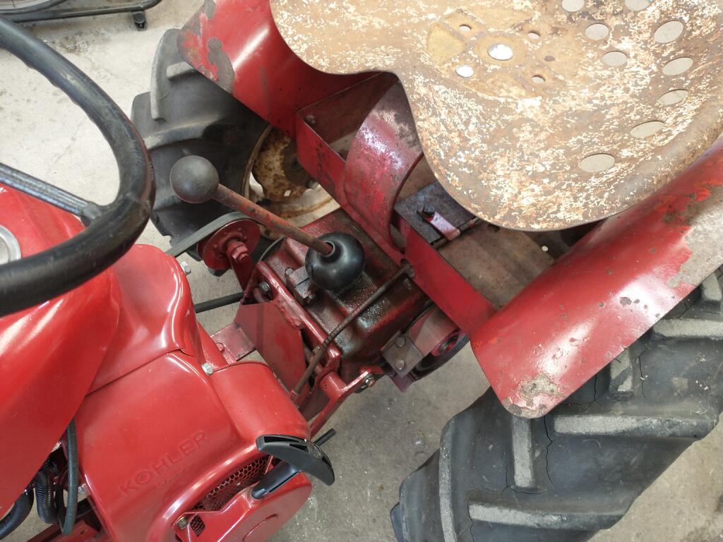

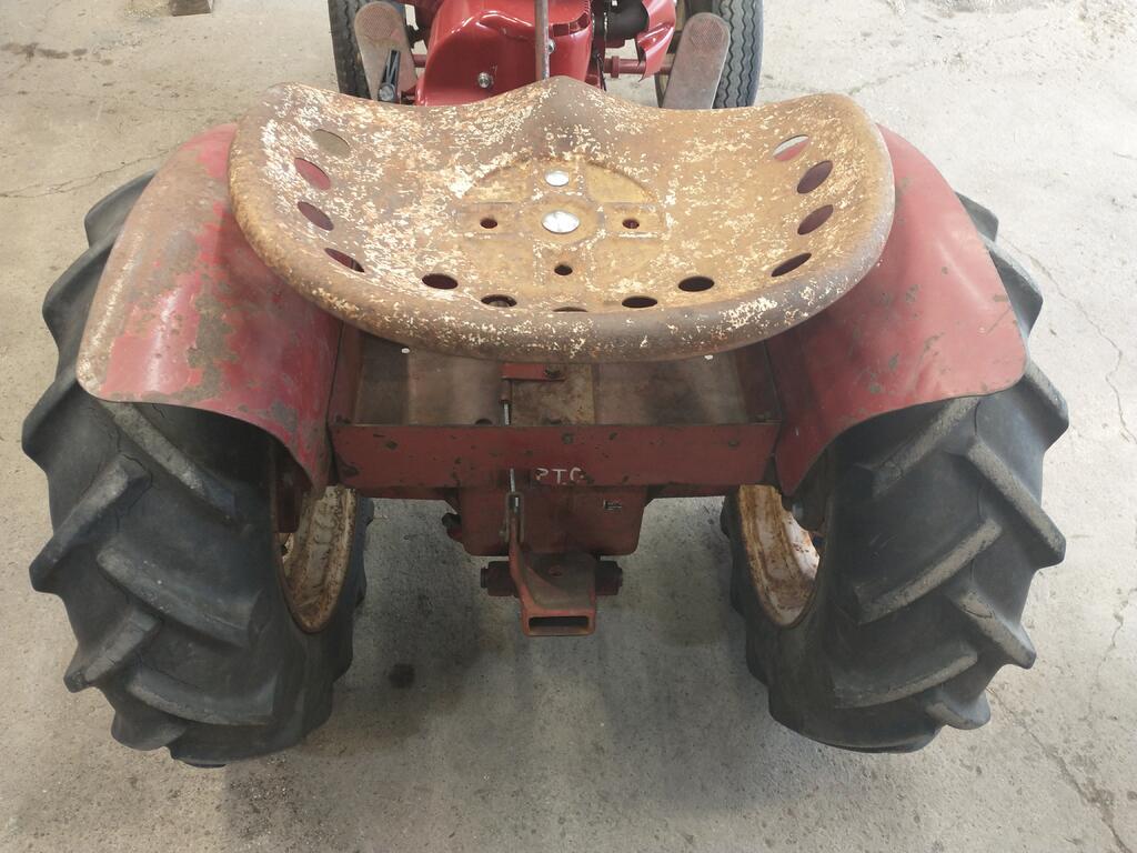

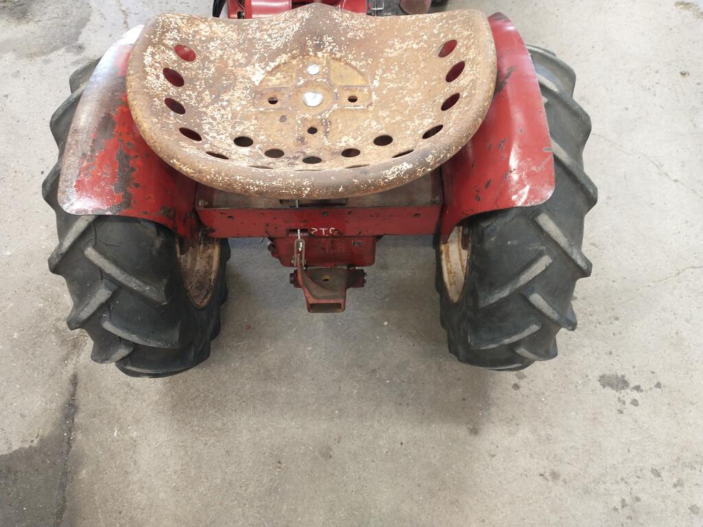

Racinbob 13,290 #31 Posted June 17, 2024 I've decided to leave it as in. A conversation with my daughter, who lived next to Louan and Larry this afternoon pretty much sealed the deal. When we were living in Florida they were kinda their local parents. A bit more than they needed or wanted but they meant well. I'll pressure wash it good when I get the engine off. It doesn't have any rust on it and a lot of people that see it in person say how nice it looks. Besides, I'll be pushing dirt, brush and logs in the woods with it as well as snow so I won't have to fret over it. 3 4 Share this post Link to post Share on other sites

Racinbob 13,290 #33 Posted June 17, 2024 6 minutes ago, Marv said: Bob, I don't want to hijack your thread here. I am just trying to show how the feelings work here. I have my daddy's B80. It had a good working life. When daddy died I got the tractor. I built a 16 horse and put on it so my son could mow his three acres. He wound up getting a larger tractor. So, my son in law used it. When he decided he wanted a "new' tractor (B80/C160 was still going strong) I got it back. I used it for several years myself. I then decided (because of nostalgia) it needed a rest. I did a nut and bolt restoration and installed a 14 horse on it. It is now a B80/C140 I painted it with Valspar International Harvester red. No hardener or clear coat. I hadn't at that time heard of Squonk's method. It is now kept under cover in remembrance of daddy. If I stepped out of bounds here. I apologize. Marv It's not possible to hijack one of my threads Marv. That's a great story. Thanks for sharing it. All the years I had the 16hp on mine I wanted to have Terry make up some B-160 8 Speed tower decals but I never did. I took the original B-80 tower decals off when I first did the swap and now I regret it. 5 1 Share this post Link to post Share on other sites

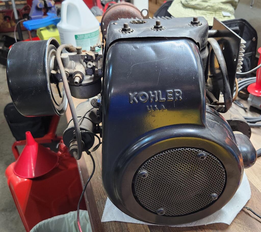

Racinbob 13,290 #34 Posted June 18, 2024 (edited) Had a fun day today. I drove up to Middleville to see @Pullstart and pick up the K-181 engine I'm going to use on this revert back project. I think it's going to be great. It didn't hit me until I got home that I have the option of using the freshly painted red tins from the 181 I swapped out on the 854. The black looks fine so I can go either way. The things some guys have to ponder. Even better was chatting with Kevin and seeing the shop where he does his magic. The old saying "He who dies with the most toys.....wins". Well, I think Kevin is in the lead. So cool seeing everything and hearing the stories. There wasn't nearly enough time as I didn't want to interfere with his tee time. Another highlight was meeting his lovely wife. It was brief as she was on her way to work. But guys, I can vouch for him. Those of you who figured he must have photoshopped her into his pictures to improve his image, he didn't. Let's not forget the awesome sound of that turbocharged Suburban as she pulled out the drive. Thanks for a fun morning Kevin. Edited June 18, 2024 by Racinbob 2 2 2 Share this post Link to post Share on other sites

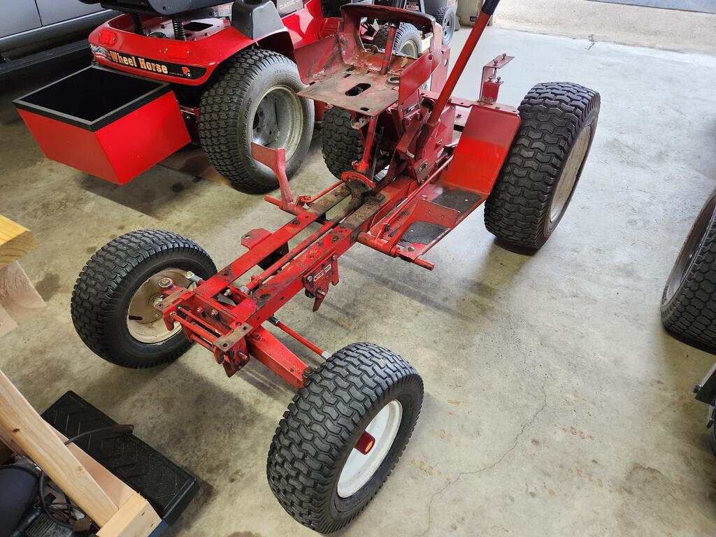

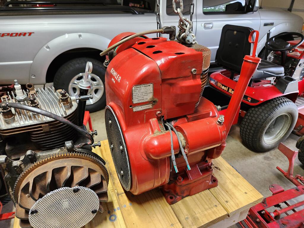

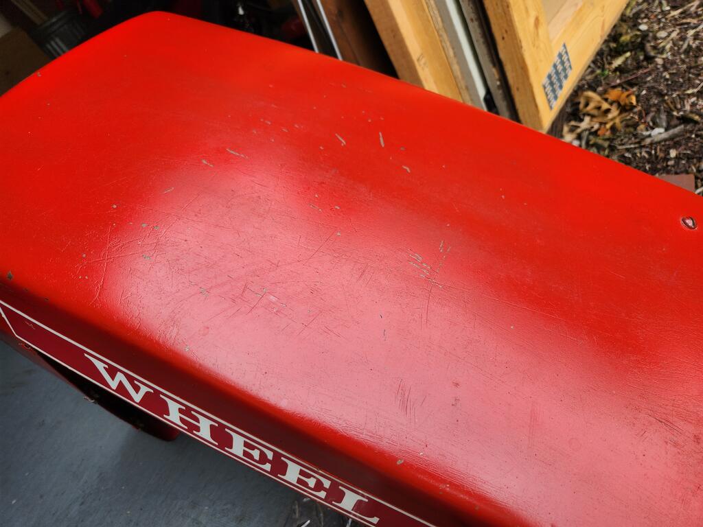

Racinbob 13,290 #37 Posted July 9, 2024 Had a chance to get back to this project. Got the 341 pulled. I haven't decided if I'm going to open up the top or not. For now I want to get the reborn B-80 done. Got it down to a rolling chassis. The electrical was showing it's age so I removed all of it. I'll do a complete rewire. I'll degrease and pressure wash it real good. I'm still pondering how far I want to go. You guys talked me out of a full resto due to this tractors history. Now I'm thinking about Flood Penetrol. Do the frame first and see if I like it. The hood is another thing. The repaint someone did just isn't good but it looks OK from 10'. Patina isn't there but the surface wasn't properly prepped prior to the paint. It looks like it was coursed sanded then painted. You can get the idea here. Now, short of a total repaint how do you think the Flood would do on it? Should I just go over it or lighting sand with a fine grit first? Or should I simply leave it as is? 3 2 Share this post Link to post Share on other sites
Lane Ranger 12,167 #38 Posted July 9, 2024 Bob. I used that flood penetrol with a quart can of Rustoleum Regal Red several years ago on a 1054. I bought a very good bristle paint brush and I thought the job came out great and the finish dried very smooth. 4 Share this post Link to post Share on other sites
Racinbob 13,290 #39 Posted July 9, 2024 (edited) Cool Lane. But I'm thinking just the Flood. I've been watching some videos and the results look good. Much like a linseed oil rub down but with benefits. It seems to work great on patina. I would think somebody here has tried it. Doing the frame should give me a good idea how it looks without committing the sheetmetal to it. Edited July 9, 2024 by Racinbob 4 Share this post Link to post Share on other sites
Lane Ranger 12,167 #40 Posted July 9, 2024 Ok. It is not as thick as boiled linseed oil and I would think it would have to be reapplied regularly. But let’s see how it does. 2 Share this post Link to post Share on other sites
Racinbob 13,290 #41 Posted July 9, 2024 One video I watched was a guy did half of his truck with Flush and the other half with boiled linseed. A year later the Flush was holding up much better. We can believe that cuz we saw it on the internet........... I'll experiment and report back. 2 2 Share this post Link to post Share on other sites

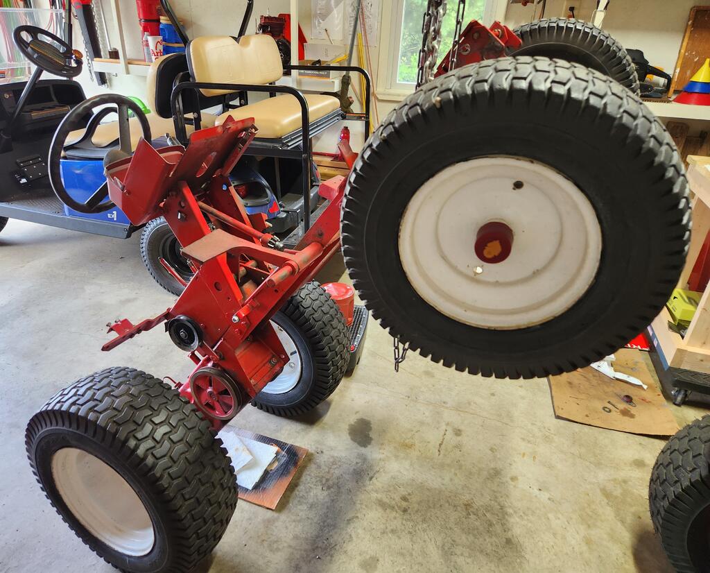

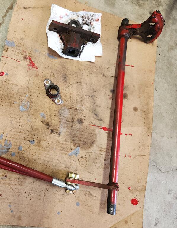

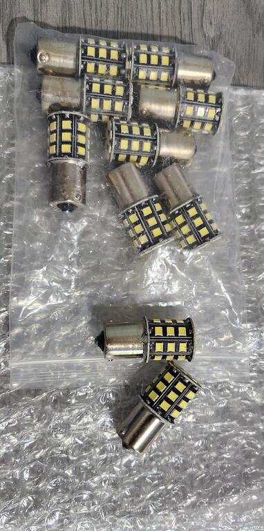

Racinbob 13,290 #45 Posted July 14, 2024 Got the rolling chassis degreased and pressure washed yesterday. The steering was surprisingly tight considering the age but as long as I have it this far I'm going to put bushings in it. I picked up a new 6472 bearing for it as well. I made new tie rods not long before the engine issue. Just for giggles I picked up some 6000k led bulbs for it. 2 1 1 Share this post Link to post Share on other sites

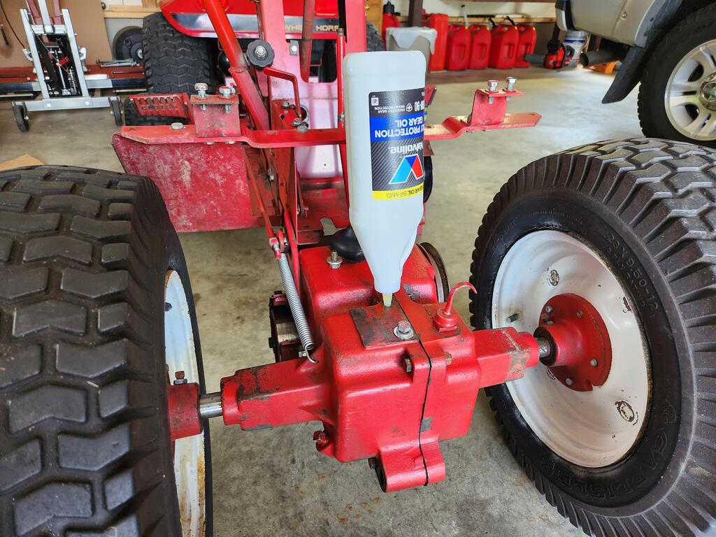

Racinbob 13,290 #46 Posted July 15, 2024 Drained the tranny. Hope I got all of it past the humpy thingy. Then a couple of 80w90 IV's. Parts are arriving and I'll be putting it back together again real soon. 2 4 Share this post Link to post Share on other sites
ebinmaine 81,282 #47 Posted July 15, 2024 3 minutes ago, Racinbob said: Drained the tranny. Hope I got all of it past the humpy thingy. Mebbe...... 3 Share this post Link to post Share on other sites

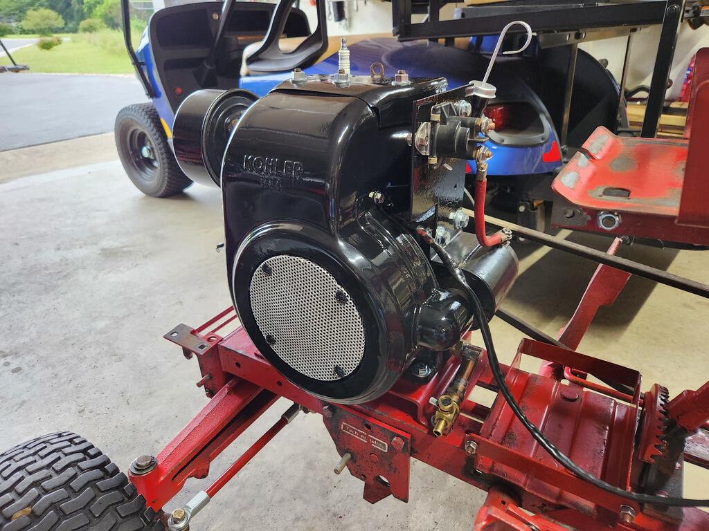

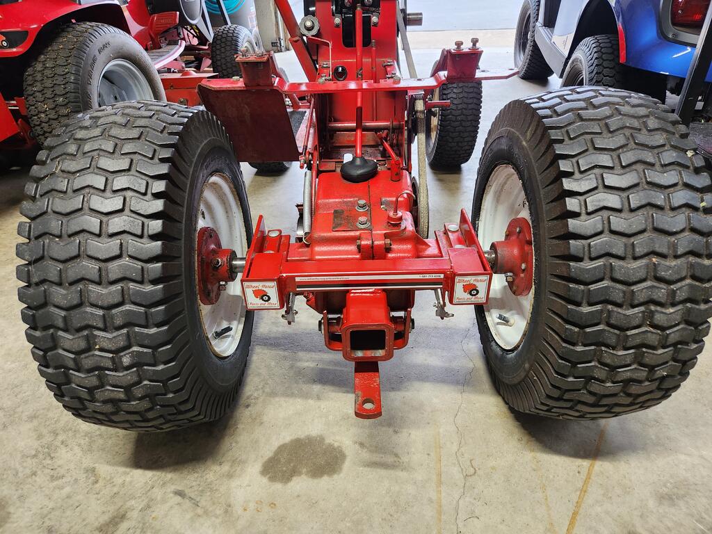

Racinbob 13,290 #48 Posted August 1, 2024 Had a chance to play with this one this morning. Got the @Pullstart B-80 mounted along with a few of the components. The charging harness is a plug and play into my rectifier. This shroud is screaming to try out the Kohler USA decals @Vinylguy makes so I have that on order. When I parked this tractor in the barn as I decided what to do with it I pulled the @wheelhorseman receiver hitch and put it on the 314-H but now that I'm reviving this one I swapped it back. It will be better utilized. You can see a peek of the one on my 2005. 1 4 Share this post Link to post Share on other sites

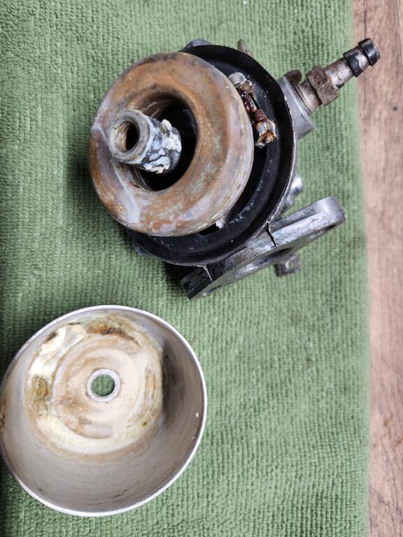

Racinbob 13,290 #49 Posted August 14, 2024 I'm waiting on a couple parts for this one. I wasn't going to open up the carb but I decided to since I knew it had been sitting for quite a spell. Probably a good thing I did. I'm guessing booze in the fuel did it's thing. A good soaking and a new kit and it should be good to go (forgot the after pics). Hopefully the fuse block I ordered will get here today and I can get this one wrapped up. 2 2 1 Share this post Link to post Share on other sites
ebinmaine 81,282 #50 Posted August 14, 2024 6 hours ago, Racinbob said: I wasn't going to open up the carb but I decided to since I knew it had been sitting for quite a spell. Probably a good thing I did Glad you did that Bob. I'm at a point where EVERY carb gets rebuilt. Along with ALL new fuel line. Amongst many other things..... Share this post Link to post Share on other sites
