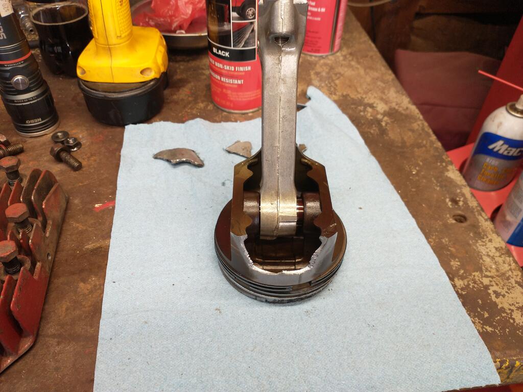

squonk 48,133 #11 Posted June 14, 2024 My C-160 was running fine with a little rattle for a long time. It finally got a little worse so I put a spare bullet in I had on the shelf. Opened it up and found this: You say you bought it as a "fresh rebuild." Was it bored? Lots of guys skip boring because the cylinder "looks good" A worn out of round cylinder will rear it's ugly head as the engine gets hotter. 4 1 Share this post Link to post Share on other sites
Racinbob 13,193 #12 Posted June 14, 2024 That's pretty wild Mike. I would have thought the piston would have totally come apart with that much damage. Gotta wonder about parts floating around. I doubt that I will pull the pan but I look at the cylinder wall. It did immediately start blowing smoke. Not a lot though. 1 Share this post Link to post Share on other sites

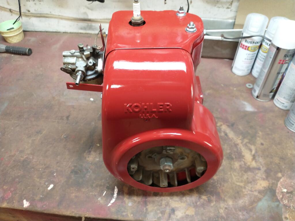

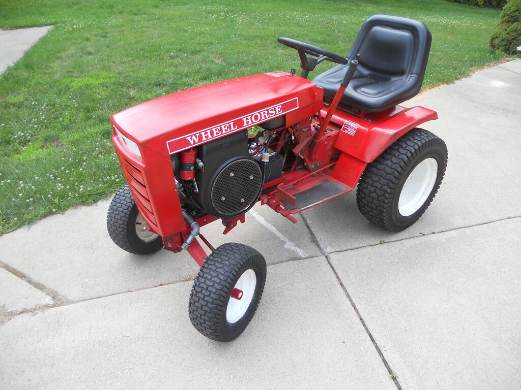

Racinbob 13,193 #18 Posted June 15, 2024 It doesn't surprise me that a plan is coming together real quick after starting this thread. I'll head up to see Kevin Tuesday to get the engine. Mike is relaying a couple parts back to Indiana via Lane This is gonna be fun. But now I have a decision to make. As you can see from the picture the tractor looks good. But sometime during the 17 year hiatus it was repainted. The decals were left on but they did a nice job masking them off. But it looks like it was sanded with 100 grit before the final coat. You can see two 1/4" holes in the top of the hood (don't ask ) that could stand to be properly repaired. Since this tractor won't be critical to get back in service there will be no rush. In one ear something is screaming to tear it down and repaint. Not a full blown resto but a nice refurbish. In the other ear something else (wife) would be screaming that I don't have the time right now. Hmmmmm.......... 4 1 Share this post Link to post Share on other sites
ebinmaine 80,754 #19 Posted June 15, 2024 I can't hear your wife from here Bob. I'd say fix and repaint. 1 4 Share this post Link to post Share on other sites
Racinbob 13,193 #20 Posted June 15, 2024 I'm strongly leaning in that direction. Besides, I like to try using a hvlp spray gun with some Rusty Regal and hardener. I've had the gun for years and have never tried it. 3 Share this post Link to post Share on other sites
squonk 48,133 #21 Posted June 15, 2024 My . If I was going to go hog wild and redo a tractor with Regal Red, First buy an extra HVLP Gun. Spray the red without hardener and immediately after the last color coat when it's still wet with the other gun spray on a coat of Rustoleum Chrystal Clear. Then a 2nd coat of clear in like 15 minutes. I bet it will dry faster than the red with hardener and you'll like the results better. That's how I paint everything now only with spray cans. 5 2 Share this post Link to post Share on other sites
Pullhosen’s Pony Express 98 #22 Posted June 16, 2024 I really like the way it looks right now. It’s not mine, but I vote leave it be and get it going again 2 Share this post Link to post Share on other sites
oliver2-44 11,753 #23 Posted June 16, 2024 9 hours ago, Racinbob said: I'm strongly leaning in that direction. Besides, I like to try using a hvlp spray gun with some Rusty Regal and hardener. I've had the gun for years and have never tried it. I’m sold on using regal red with hardener. Soon I’m going to spray some parts with regal red and hardener, them immediately follow up with crystal clear with hardener. I have a HF hplv set that has a regular size and small size gun. I wish the cup were a little bigger on the small gun. But it really is a good size for 80% of a tractor. It’s perfect for 2” (frame) and under and good for 4” wide parts. That just leaves the hood, rear fender and belt guard. I feel the small gun helps me from getting runs on parts that have a lot of different shapes whereas a big gun would have multiple overlaps to cover such a part. 1 Share this post Link to post Share on other sites
Racinbob 13,193 #24 Posted June 16, 2024 7 hours ago, Pullhosen’s Pony Express said: I really like the way it looks right now. It’s not mine, but I vote leave it be and get it going again I'm pulled in that direction too. For years when we visited our kids in Walkerton I would often see the neighbor mowing but I didn't know it was my tractor. He was too far away. They had 5 acres and he mowed all of it 1-2 times a week. Shortly before moving back up here in 2017 we were planning a trip up to visit and my daughter said Larry asked if I'd look at his tractor when I was up there. Ya gotta ask?? I had restored a Commando 800 for our grandson and he loved it. I went over there and was shocked to see that it was my old tractor. I drove the Commando over there and knew the second I pulled in the driveway. That was the first time I had met him and we really hit it off. He really took care of his stuff and we had so many similarities like tractors, firearms, woodworking, OCD and more.. A year or so after we moved back he was diagnosed with a terminal brain tumor and only lasted a couple months. I helped his wife, Louan, with a few things and when she told me that it was Larry's favorite tractor and he'd only want one person to have it. It was a happy, sad moment. It had the 48" deck that I had purchased new in about 1980 and, in spite of the tremendous amount of mowing it was 100% rust free. After every mowing I always scraped the clumped grass off allowing it to air dry. I figured he must have too. I asked Louan and she said 'I don't know but he was always under there doing something after he mowed'. We were two peas in a pod. I pondered doing a refurb at that time but I hesitated because that tractor and deck would not have still been in that condition had it not been for him and his finicky ways. It was my little tribute to guy who would have been a great friend. That's still on my mind. 4 Share this post Link to post Share on other sites

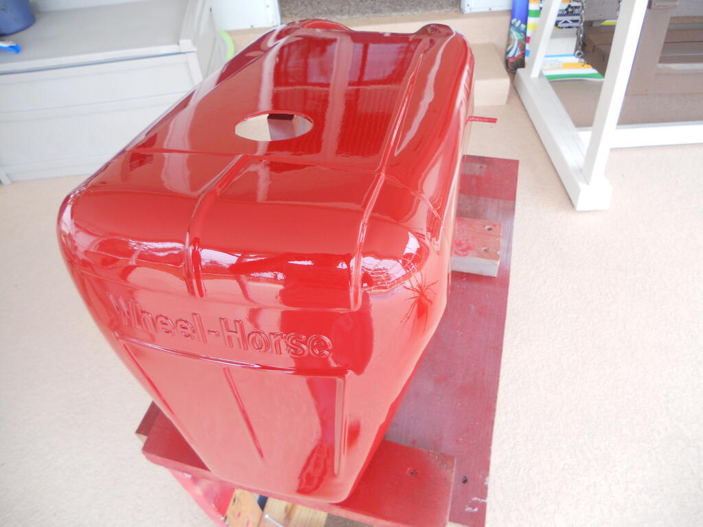

Racinbob 13,193 #25 Posted June 16, 2024 16 hours ago, squonk said: My . If I was going to go hog wild and redo a tractor with Regal Red, First buy an extra HVLP Gun. Spray the red without hardener and immediately after the last color coat when it's still wet with the other gun spray on a coat of Rustoleum Chrystal Clear. Then a 2nd coat of clear in like 15 minutes. I bet it will dry faster than the red with hardener and you'll like the results better. That's how I paint everything now only with spray cans. I've always used Rusty in cans too and get great results like this Suburban hood. But it's just not very durable. That's why I was thinking hardener. Every time I've tried clear over I have issues. Either orange peel or cloudy. I'm doing something wrong. Does the clear add to the durability? Share this post Link to post Share on other sites
