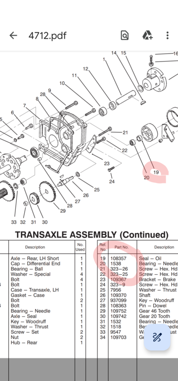

rmaynard 16,885 #2 Posted March 3, 2024 (edited) Try looking here: I think the brake seal is the same as the 8-speed, but I'll check my book. WRONG 108357 Edited March 3, 2024 by rmaynard Share this post Link to post Share on other sites
c-series don 11,461 #3 Posted March 3, 2024 @stevasaurus @rmaynard thanks for your responses, however Steve I didn’t see anything in your post referring to the Eaton 1100 brake shaft seal? And yes Bob I too thought it was the same as an 8 speed seal, but it is not. I actually quite surprised that this is not readily available information! So the search continues…… Share this post Link to post Share on other sites
Lee1977 7,566 #4 Posted March 3, 2024 Toro parts list gives the same number as rmaynard No.108357. It was part No.10 on the couple of Toro parts list I looked at. Share this post Link to post Share on other sites

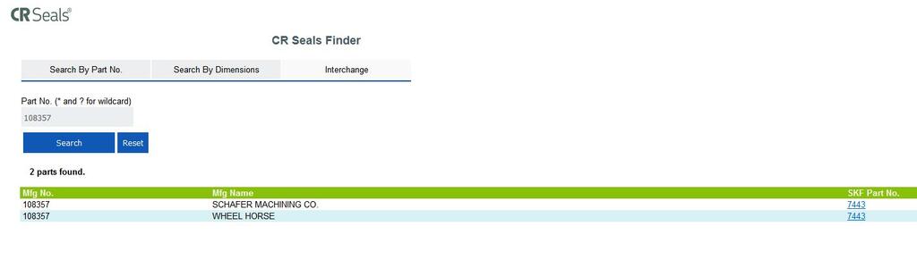

Bill D 2,604 #5 Posted March 3, 2024 (edited) @gwest_ca posted a file called seals 1.0.0. Not sure how to share the link. Should be SKF7443 Edited March 4, 2024 by Bill D Share this post Link to post Share on other sites
c-series don 11,461 #6 Posted March 3, 2024 I’m sorry I guess I miss read Bobs post, and now I have the SKF Number thanks to @Bill D thanks everyone! Tomorrow a trip to the auto parts store! 1 Share this post Link to post Share on other sites
squonk 45,590 #7 Posted March 3, 2024 7443 is a .25" thick seal for a .75" shaft with an O. D of 1.254" check these dimensions with your old one. The Toro # 108357 did not cross in the Napa interchange Share this post Link to post Share on other sites
