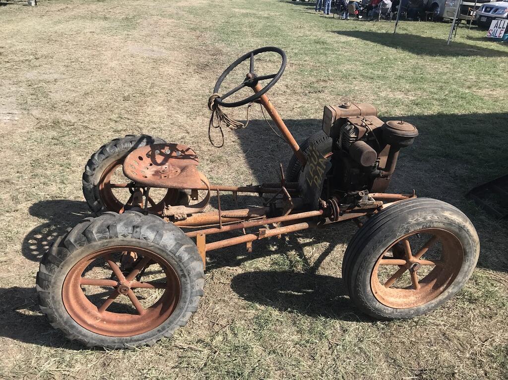

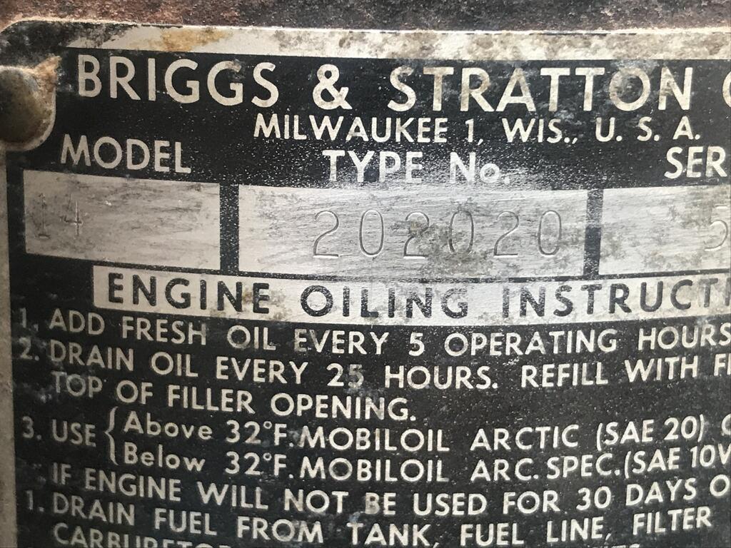

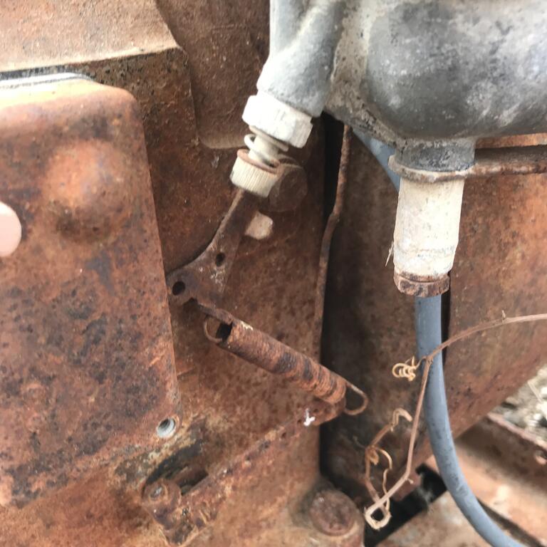

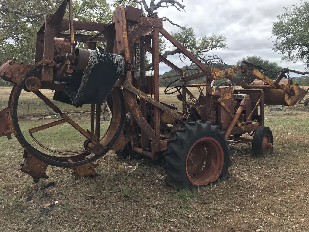

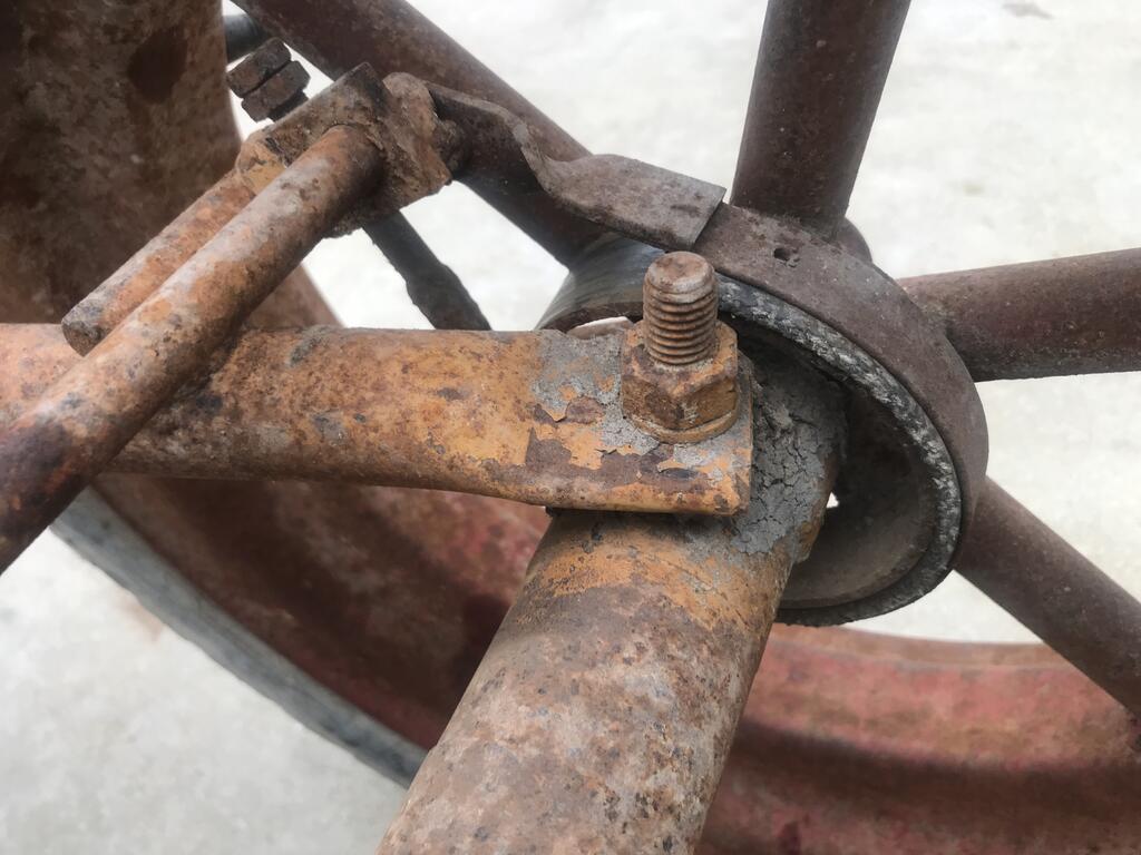

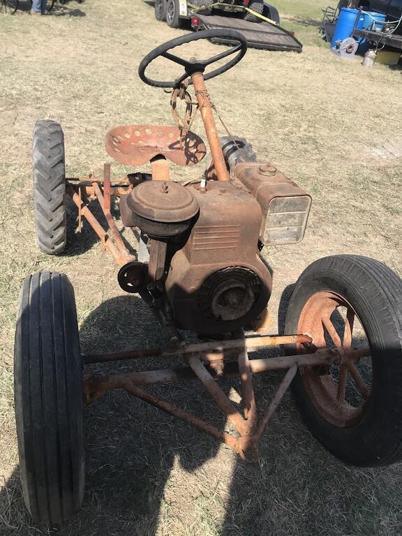

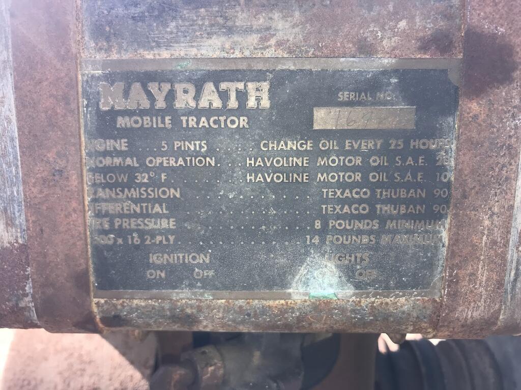

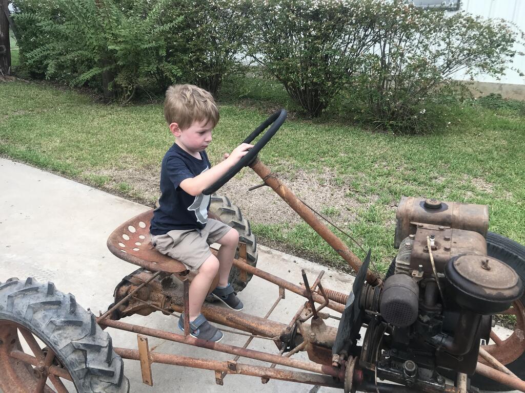

oliver2-44 11,758 #1 Posted October 12, 2023 (edited) I bought this at the Temple Tractor Show Saturday. Had a full little trailer, so a friend and I went to pick it up today. Very excited with this tractor and got to spend 2+ hours wandering around 20/30 acres of antique cars, tractors, machinery, etc. The two old brothers sell parts, and restore Model A's, T's, and tractors when their not running goats on their old family ranch in the middle of no-where. The brothers were a wealth of knowledge, and super friendly. We Drooled like two kids in a Candy Store! Mayraths were built between 149-52. Reportedly about 500 were built. This is a Standard Model, The Deluxe Model had a sheet metal body. The Mayrath Co. built grain augers, so this has a rear PO that could power an auger and sickle mower. you could also get a front plow, rear plow and other implements for it. I have a video of it running and driving, but need a little Love. I need to learn how to create a Youtube account to post videos'. Grandson already claimed it! Serial #167 Briggs Model 14 engine, runs but needs a spring on the throttle/governor linkage. Found an identical Briggs Model 14 on a sheep shearing rig and got measurements on the governor spring I need. T92 transmission used on many old garden tractors such as Power Kings. Top speed reportedly 25-30MPH...WOW Dana gears in rear end. Very simple brakes, on each side. Ross Steering Box Steering tube was cut, probable for a repair sometime in its past. Very weldable. Now will the steering wheel carefully come off to fix it right! The engine is mounted on a hinged platform. The clutch pedal tilts the platform to slack the drive belt. A large spring keeps tension on holding the engine platform down. Everything is very simple on this tractor. This is a picture of the Deluxe Model with sheet metal This is a picture of a Basic model like mine, restored. My wife likes it painted up colorful like this. I'll gently clean it up and see how much original paint is really left. For now it will stay with the patina look and get the mechanicals fixed up. Here's a few of our other fun spottings for the day! @Pullstart could make this custom super short school bus body Maybe a Homolite garden tractor? Late 50's/early 60's Cadillac DeVille Fordson with and "Industrial conversion kit that gave it a wider/heavier front end and a heavy rear axle with a "pin" to move old semi trailers around, like a shipping yard tractor @ebinmaine Case tractor with a bucket wheel trencher and a front end loader 5 man sheep& goat sheering rig. There were a ton of Model T's and A's parts and carcasses. We were ask not to take pictures of the restored ones they had in buildings. They had a beautiful original condition Model T with a wood grain box bed. IMG_0282[1].MOV Edited October 12, 2023 by oliver2-44 10 12 2 5 Share this post Link to post Share on other sites

AMC RULES 37,259 #5 Posted October 12, 2023 Awesome score. Clean it up. Make it glow. Please don't just over "restore" it because you can. 1 Share this post Link to post Share on other sites

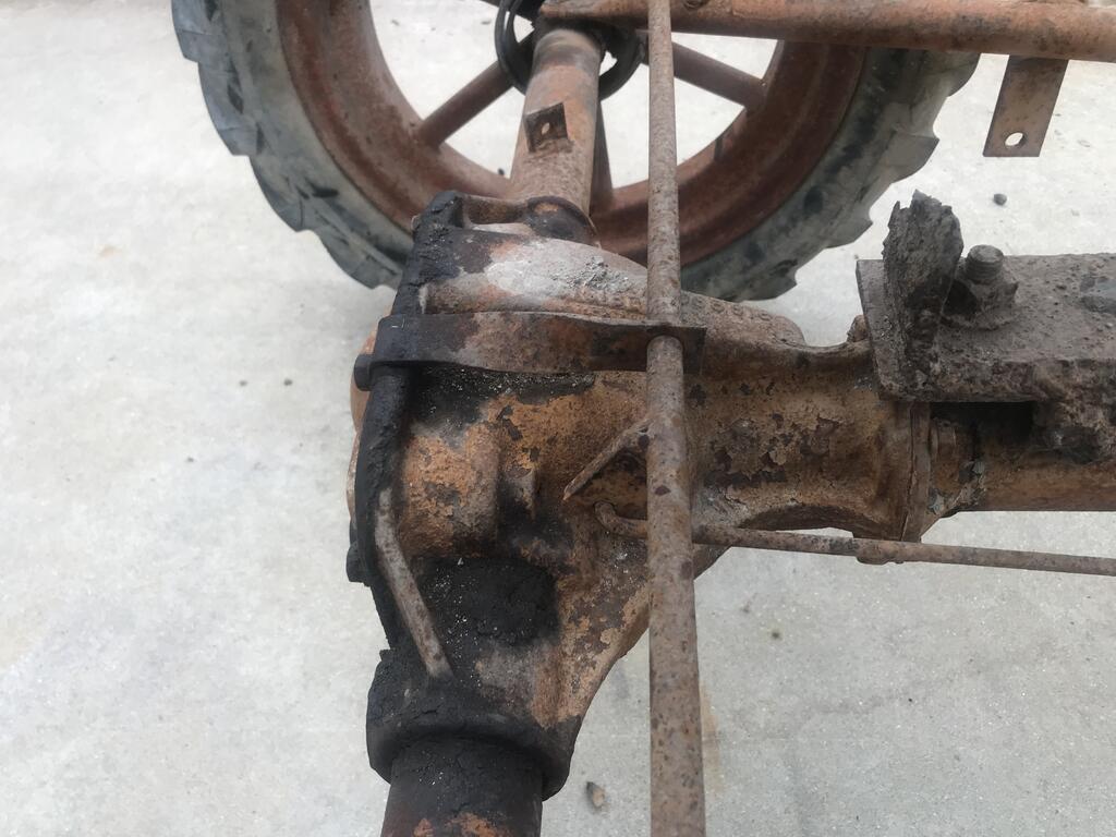

953 nut 69,433 #9 Posted October 12, 2023 11 hours ago, oliver2-44 said: Very simple brakes, on each side 11 hours ago, oliver2-44 said: Top speed reportedly 25-30MPH...WOW Somehow these two statements don't seem congruent! Share this post Link to post Share on other sites

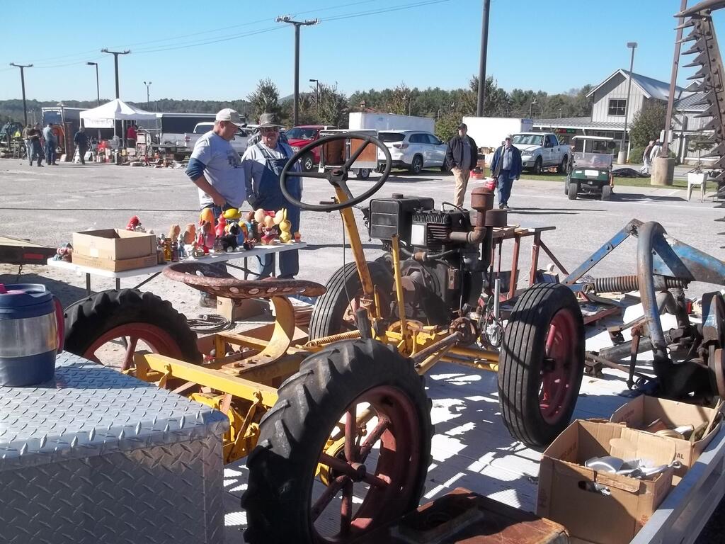

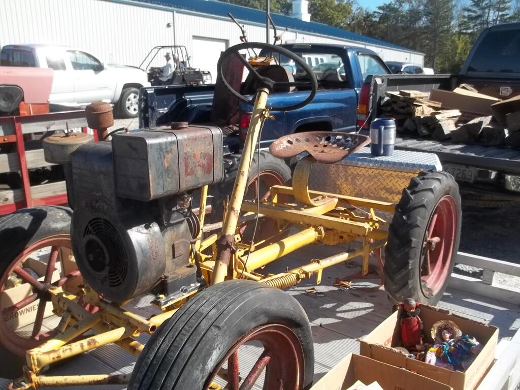

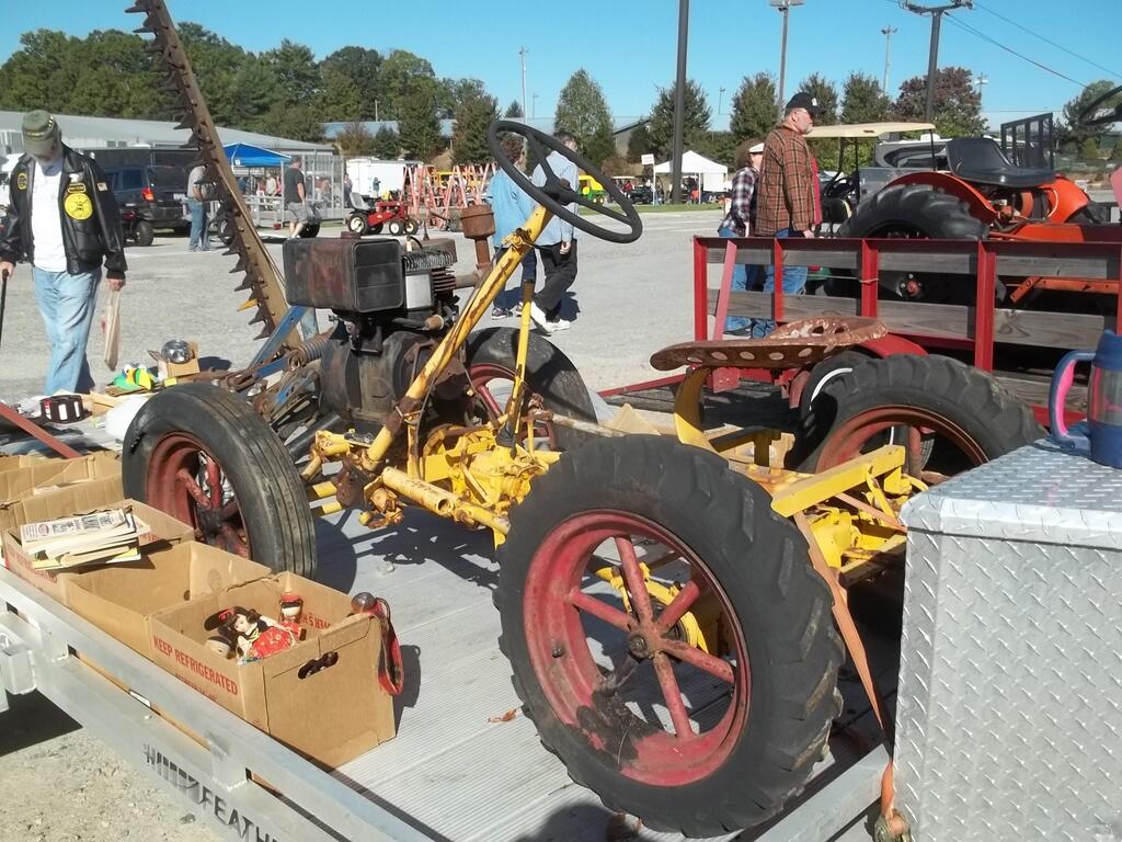

953 nut 69,433 #14 Posted October 13, 2023 While looking for another photo I came across a few pictures of a Mayrath from a local show here in North Carolina. 1 Share this post Link to post Share on other sites
oliver2-44 11,758 #15 Posted October 15, 2023 Thanks @953 nut That one has some cross angle iron that the seat is mounted to that mine doesn’t have. I wonder if those supported the rear seat body some had. Share this post Link to post Share on other sites
953 nut 69,433 #16 Posted October 15, 2023 11 hours ago, oliver2-44 said: Thanks @953 nut That one has some cross angle iron that the seat is mounted to that mine doesn’t have. I wonder if those supported the rear seat body some had. They do raise the seat up several inches. If memory serves me right the fellow who owned it knew very little about it. He had accepted it as a trade-in on something else he had sold a few weeks earlier. Can't remember what he was asking for it but it was more than I wanted to give for it. Share this post Link to post Share on other sites
