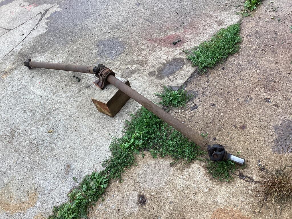

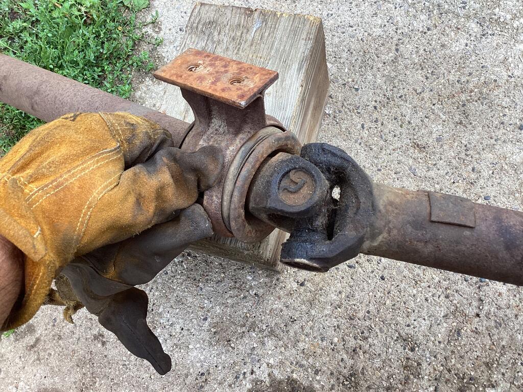

Pullstart 68,981 #1 Posted August 7, 2023 The old ‘69 Chevy needs a carrier bearing. I found one at the local auto parts store. I grabbed new greasable u-joints while I was at the store. These old u-joints are tight and are also greasable. I had to take the center joint apart to remove the bolt on driveshaft yoke in order to swap the carrier bearing. Do I replace the old u-joints with new metal from who knows what toaster foundry? Keep what I can, reassemble the old u-joint, give them all the ole’ Greasy Pete and toss the new u-joints in the glove box? @peter lena @953 nut @JCM @WHX?? @Achto what say you fellas? 2 Share this post Link to post Share on other sites

peter lena 9,782 #7 Posted August 7, 2023 @Pullstart greasable fittings are good , make sure you you have a green grease flush out of seal areas ,verify smooth solid function , would also give that , center carrier bearing rubber contact areas , some super lube , lubricant , also lube the center mount bolt threading . thats what i would do , pete 1 1 Share this post Link to post Share on other sites

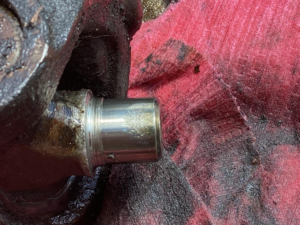

Pullstart 68,981 #15 Posted August 7, 2023 Well, after a little elbow grease cleaning needle bearings and the joint body, I found some light galling. That solves my question, it’s getting replaced! Makes me think too, the other two joints were subject to the same amount of revolutions. If I’m doing one, I might as well do ‘em all! 1 Share this post Link to post Share on other sites
Handy Don 16,017 #16 Posted August 7, 2023 (edited) 16 minutes ago, Pullstart said: Well, after a little elbow grease cleaning needle bearings and the joint body, I found some light galling. That solves my question, it’s getting replaced! Makes me think too, the other two joints were subject to the same amount of revolutions. If I’m doing one, I might as well do ‘em all! I dunno, that isn’t friction damage, it’s corrosion. Hey, wouldn’t a dab of JB Weld fix that right up? Edited August 7, 2023 by Handy Don Share this post Link to post Share on other sites
