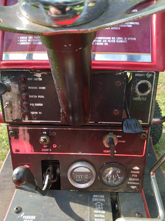

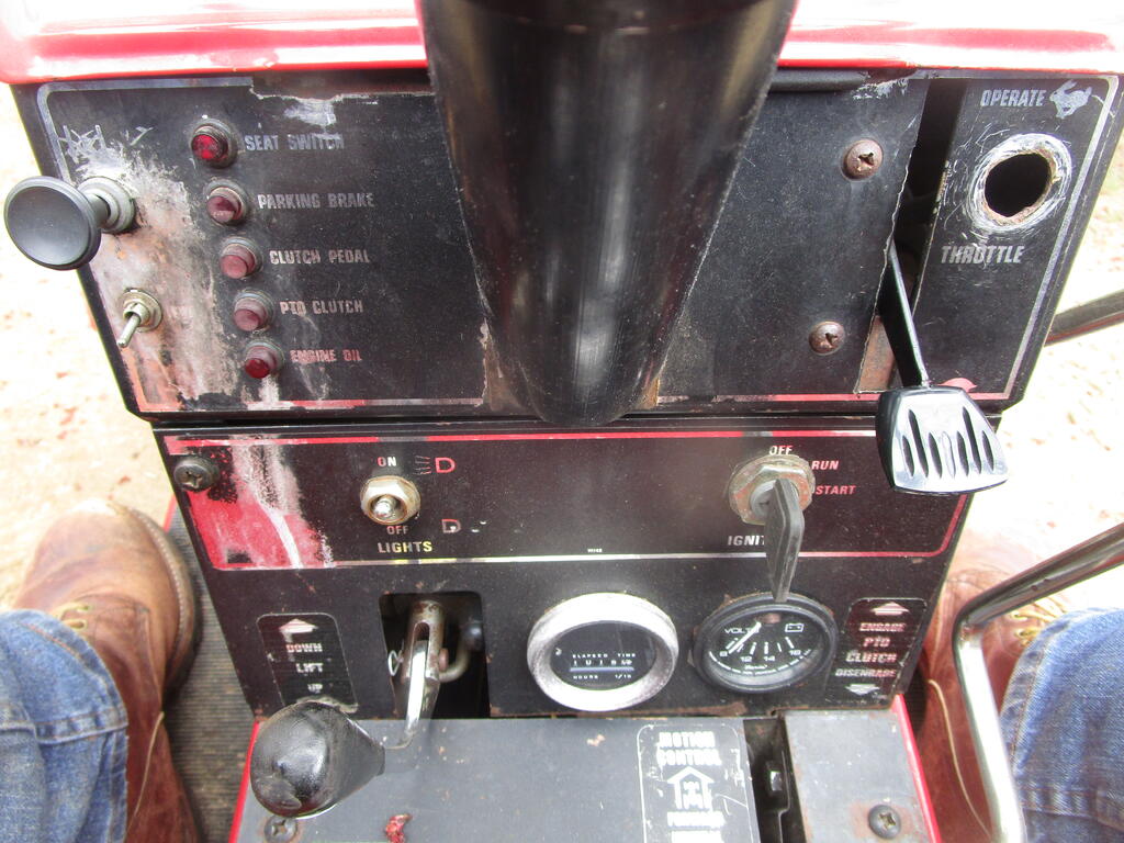

JCM 11,164 #12 Posted July 8, 2023 Hard to imagine spending $ 8000.00 for a 420 with a 48'' SD mower and treating it like this. The hole to the right of the throttle is cute. Maybe for a horn ? , don't see the need myself. I have a new dash/ steering console on it's way . New decals have been waiting patiently in the basement. The three other panels, light/key switch ,gauge and shift panel have been stripped to bare metal, primed and painted. I was warned that the original decals would resist removal and that was the case. I believe chrome/mylar backing for lack of a better term required some labor which is now behind me. I will post pics as I proceed. Thanks guys for your help so far. 1 Share this post Link to post Share on other sites
c-series don 11,963 #13 Posted July 8, 2023 @JCM I totally agree Jim, who decided “I’m going to drill a big hole in this dashboard, it’s a good idea” ? I As far as decal placement goes I wouldn’t dare try it without soap and water. Maybe if it was a small one like the Tach-a-matic, I’d do it dry but anything bigger I’d soap it. I definitely don’t know the ratio of soap and water but I don’t think you need much soap. I remember when I did my first restoration and Ed Mayhew delivered my hood decals to the big show. I had never installed any large decals such as the hood ones. When I attempted to do it at the show people gathered around me like I was some kind of expert or something. I was so nervous I was going to mess it up but I just used soap and water and a credit card. Soon enough it appeared as if I knew what I was doing! I got them in place and slowly pushed out the air bubbles with the credit card and they came out perfect! 2 1 Share this post Link to post Share on other sites

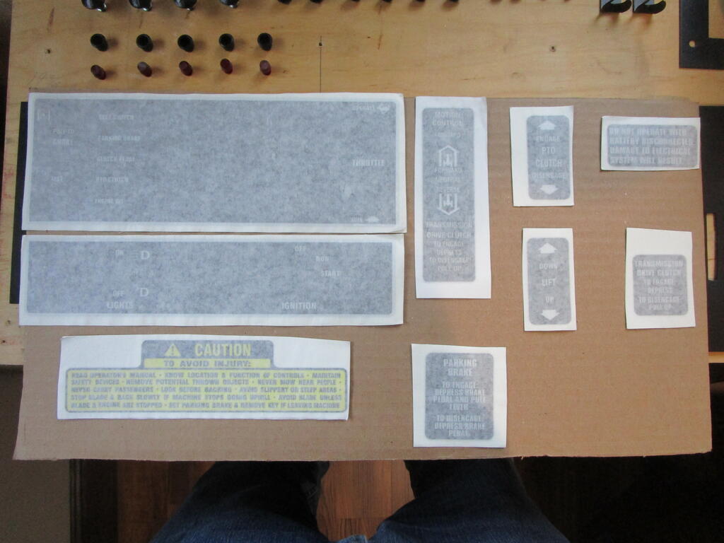

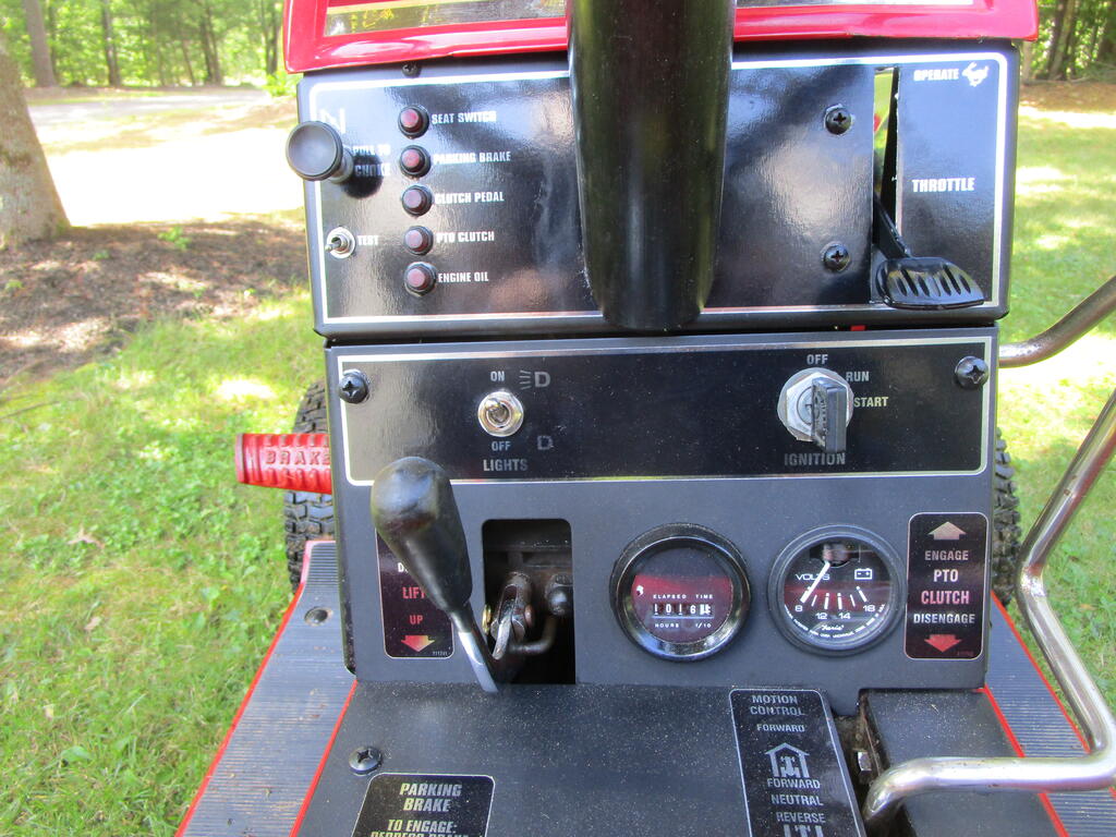

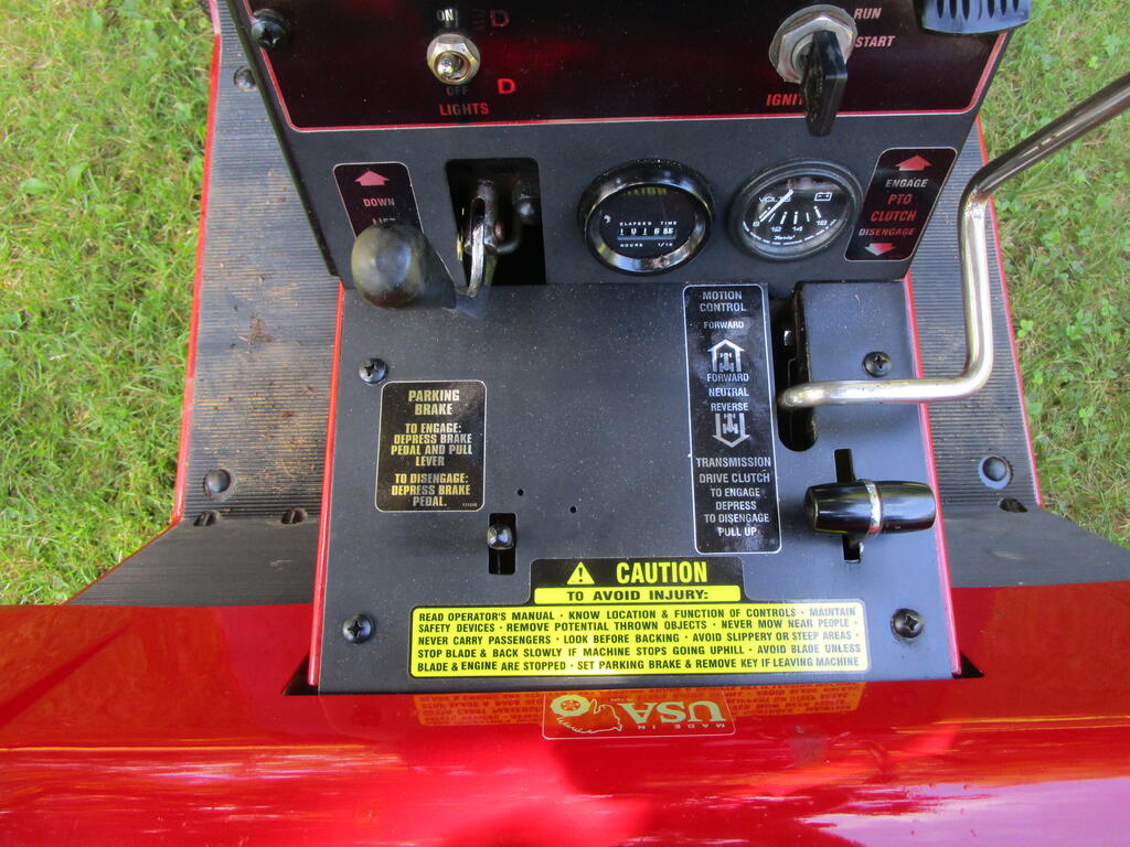

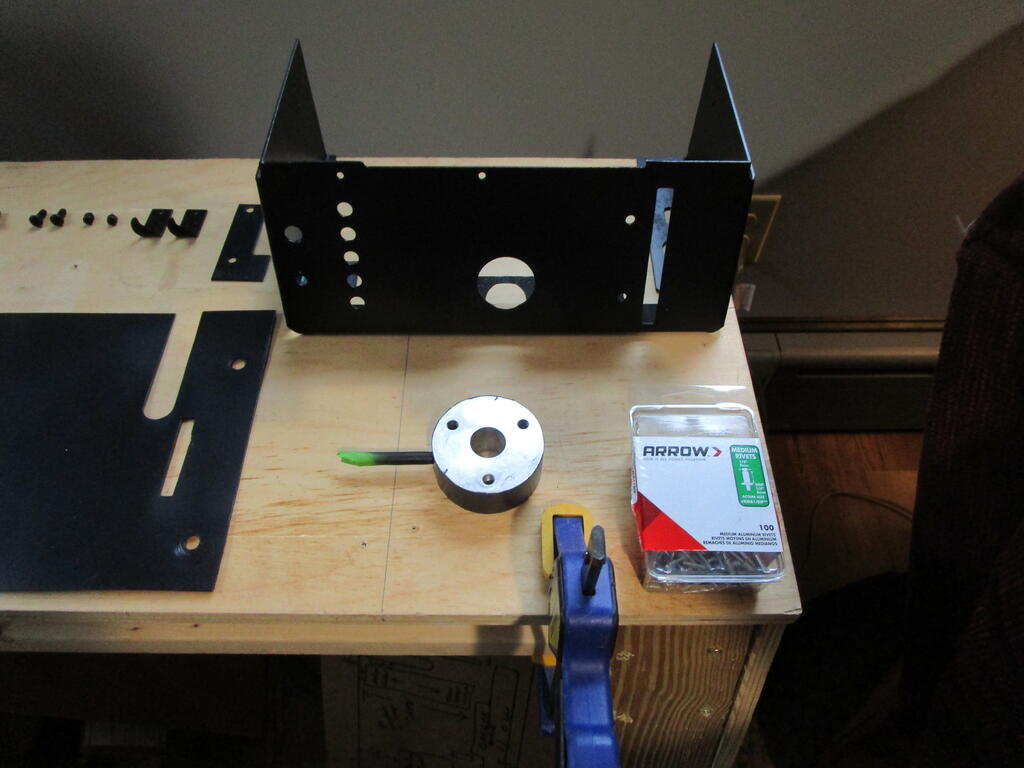

JCM 11,164 #16 Posted July 29, 2023 Dash refurb update. At this point I am about ready to apply the decals. Prep work is all done. With the heat wave I decided to move indoors to finish up with the A/C on. Been way to hot in the shop. Some more pictures of the progress made.Will post more pics when I screw up / finish the decals. Meet & Greet will be here before you know it and would like to have the LSE be in the line up with everyone else. 2 4 Share this post Link to post Share on other sites

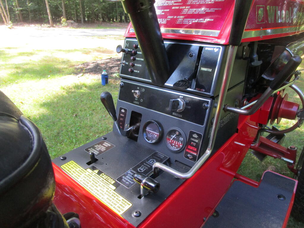

JCM 11,164 #17 Posted August 13, 2023 Some more pics of the decal project on the 420. I did get carried away a bit and did the shift console for the 417-8 and 418-A as well while I had everything out needed for that. Always a little more to do but the 420 needed to go to the next level after previous owners neglect. Trying to make it better than when I purchased it for the next owner eventually. 2 4 Share this post Link to post Share on other sites
c-series don 11,963 #18 Posted August 14, 2023 @JCM Looks great Jim! I’ll definitely sleep better knowing that giant hole in your dashboard is gone!! As we talked about, I can’t imagine who would do that? ESPECIALLY to an LSE ? Seriously though, nice job 👍🏻 1 1 Share this post Link to post Share on other sites
