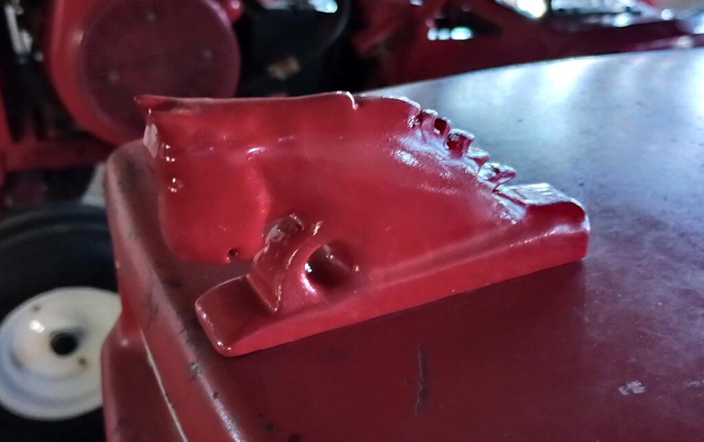

AlexR 3,137 #52 Posted August 19, 2023 (edited) Got the hood ornament done. Edited August 19, 2023 by AlexR 1 1 Share this post Link to post Share on other sites

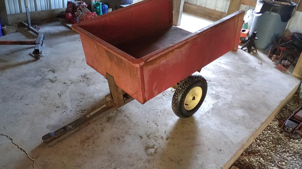

AlexR 3,137 #53 Posted August 27, 2023 Got a loadhog trailer to go with the B100, Painted up the rims and got new tires. Now I just gotta use the penetrol on the tractor and trailer. 1 Share this post Link to post Share on other sites

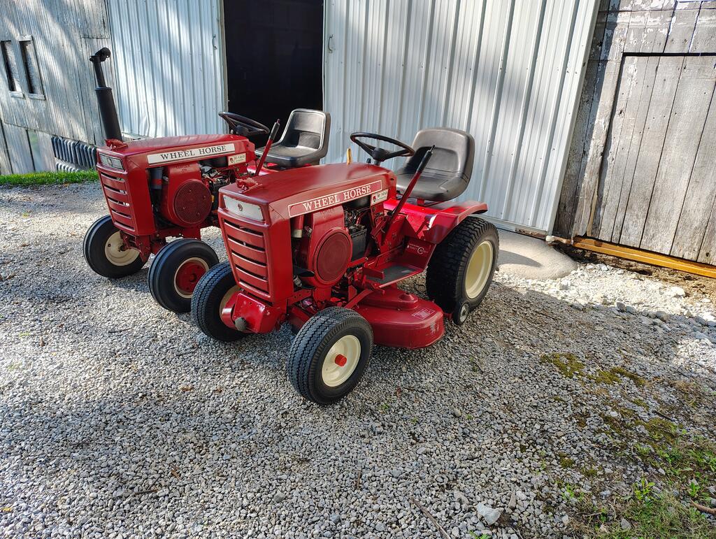

AlexR 3,137 #54 Posted September 13, 2023 I still have a couple little adjustments to do to the neutral location and the choke cable. But otherwise she is pretty much done. 1 6 Share this post Link to post Share on other sites

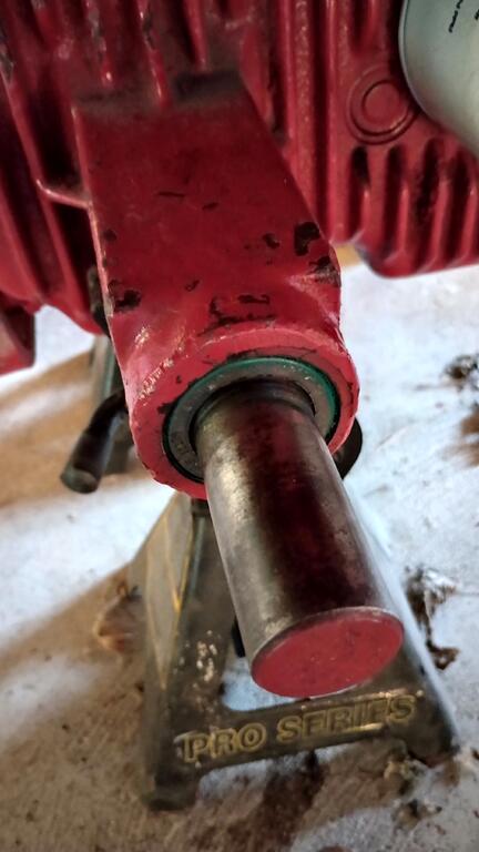

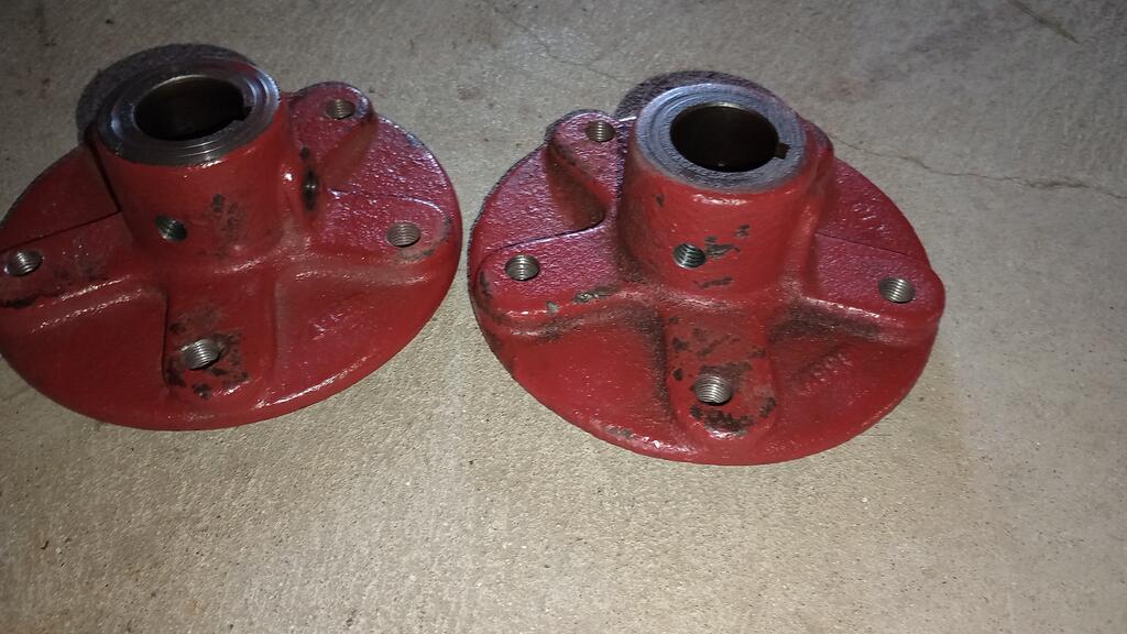

AlexR 3,137 #56 Posted June 25, 2024 Starting to do some more work on the ole B100 Installed some new axle seals, then drilled and tapped the hubs for the extra set screws, Out of curiosity have any of you had issues pulling hubs off because of the extra set screws, creating dimples on the axles which then cause drag on the hub trying to get it off? 1 Share this post Link to post Share on other sites
kpinnc 19,043 #57 Posted June 25, 2024 (edited) 40 minutes ago, AlexR said: Out of curiosity have any of you had issues pulling hubs off because of the extra set screws, creating dimples on the axles which then cause drag on the hub trying to get it off? Unless the dimples are really bad, it shouldn't create much issue. If it does next time you remove the hubs: Use a flat file (fine) and gently run with the diameter of the bare axle until it skates over where the dimples were. It will only remove what is sticking up. Don't bear down on the file. It doesn't take much to remove the protruded section. I do the same on the keyways before changing axle seals. One layer of packing tape then prevents damage to the new seal. Edited June 25, 2024 by kpinnc 3 1 Share this post Link to post Share on other sites
AlexR 3,137 #58 Posted June 25, 2024 7 hours ago, kpinnc said: Unless the dimples are really bad, it shouldn't create much issue. If it does next time you remove the hubs: Use a flat file (fine) and gently run with the diameter of the bare axle until it skates over where the dimples were. It will only remove what is sticking up. Don't bear down on the file. It doesn't take much to remove the protruded section. I do the same on the keyways before changing axle seals. One layer of packing tape then prevents damage to the new seal. Thanks for the help!! Was mainly concerned about getting the hub off.. but better then it being loose haha. 1 Share this post Link to post Share on other sites
rjg854 13,419 #59 Posted June 25, 2024 11 hours ago, AlexR said: Out of curiosity have any of you had issues pulling hubs off because of the extra set screws, creating dimples on the axles which then cause drag on the hub trying to get it off? You could also file the area a bit deeper after you mark where the set screw sits, using the set screw while in the hub. That way you shouldn't end up with anything sticking up that might bind on the hub. 2 1 Share this post Link to post Share on other sites

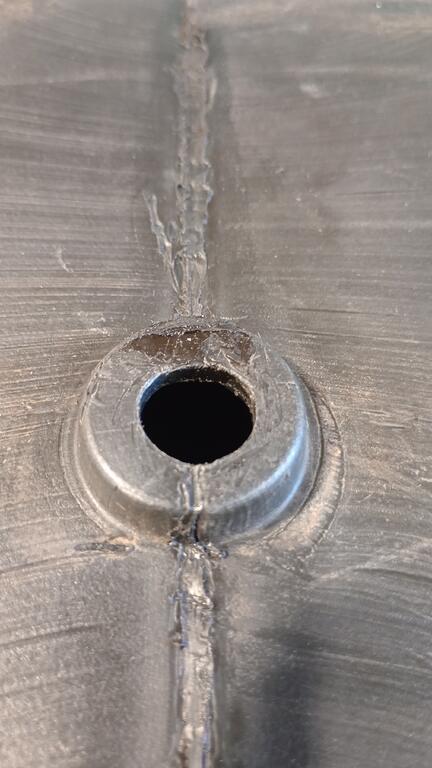

AlexR 3,137 #60 Posted June 27, 2024 So my gas tank has a crack in the seam at the bottom of the tank at the grommet and shutoff. So most people have said it's junk at that point and the only way to fix the plastic tanks is to weld the plastic.So I know the reason it's difficult to do that is getting it smooth enough to get the grommet to seal, but has anyone ever actually fixed a gas tank? There doesn't seem to be any aftermarket tanks and the used market seems pretty scarce. So I want to as least try to fix it. Share this post Link to post Share on other sites

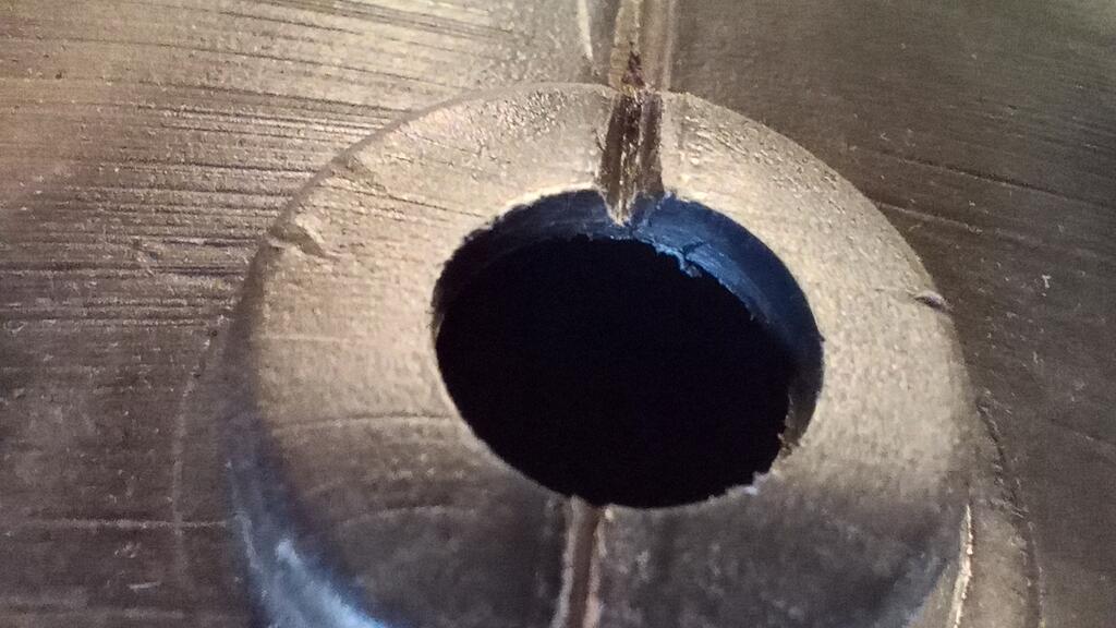

AlexR 3,137 #61 Posted June 28, 2024 So this is the crack I am dealing with and cut a V on the bottom of the tank and will try to plastic weld it that way. Filled the tank with water a couple of times all the way to get all the gas and fumes out and just letting it sit and dry and air out. 1 Share this post Link to post Share on other sites

AlexR 3,137 #64 Posted June 28, 2024 (edited) Well I am fairly happy with the results going to use some 2000 grit sandpaper real lightly on it then we will see if it holds gas. Used a black ziptie to add plastic. I used a soldering iron to do all this I used it in the v groove before even adding plastic to try to get that crack welded. Edited June 28, 2024 by AlexR 7 2 Share this post Link to post Share on other sites
19richie66 17,950 #65 Posted June 29, 2024 I have done that on a water tank for a spray rig. Worked great and held for a couple years. Yours looks good. Nice job. 1 Share this post Link to post Share on other sites
AlexR 3,137 #66 Posted June 29, 2024 31 minutes ago, 19richie66 said: I have done that on a water tank for a spray rig. Worked great and held for a couple years. Yours looks good. Nice job. Thank you very much! Share this post Link to post Share on other sites
WHX?? 58,347 #67 Posted June 29, 2024 Metal yes plastic no for me. Let us know how it works. 1 Share this post Link to post Share on other sites
AlexR 3,137 #68 Posted June 30, 2024 It's holding so far but its only been a couple of hours I will keep a eye on it for the next couple days and see how it does. 1 Share this post Link to post Share on other sites

AlexR 3,137 #70 Posted June 30, 2024 (edited) I got the choke cable fixed and the neutral position adjusted all that is left is applying the flood penetrol Edited June 30, 2024 by AlexR 2 1 Share this post Link to post Share on other sites
AlexR 3,137 #71 Posted July 3, 2024 Gas tank is still holding up with no leaks 4 Share this post Link to post Share on other sites
