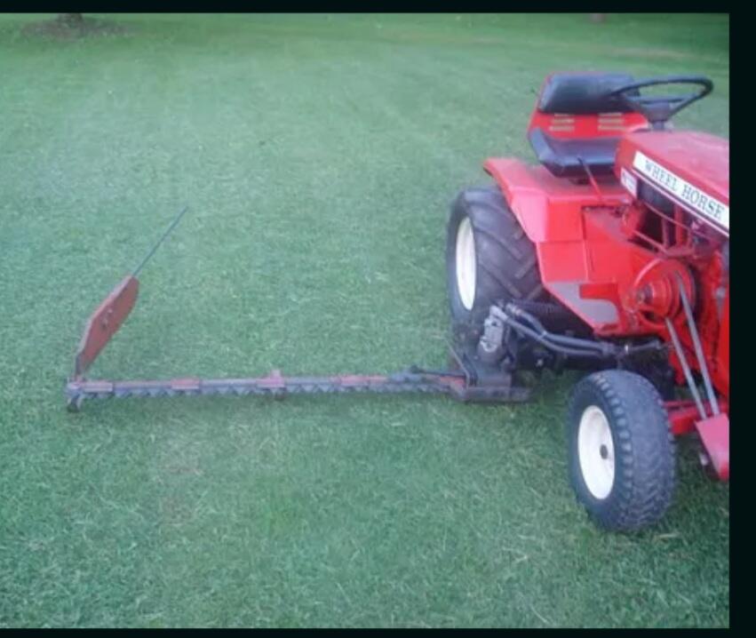

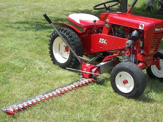

Cody 285 #35 Posted March 31, 2024 Here's one of my Didier sickle bars on a C160. I should dig them out for better pictures 4 Share this post Link to post Share on other sites

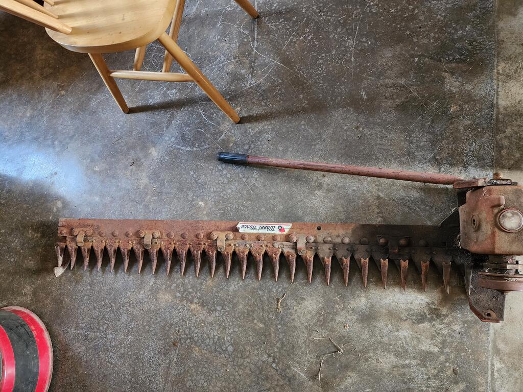

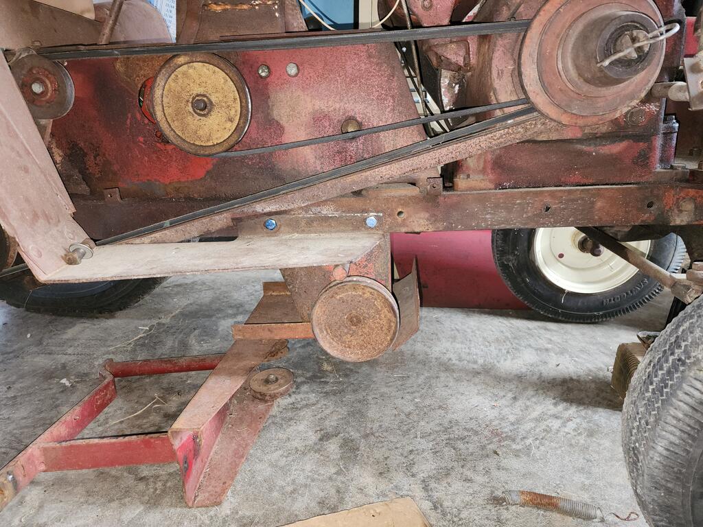

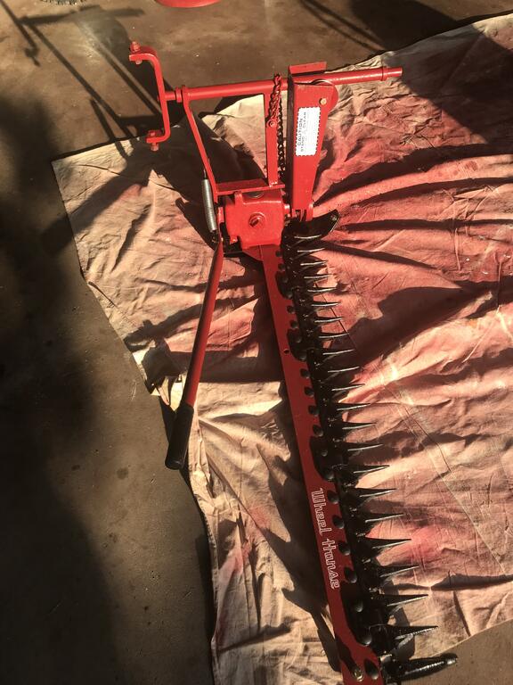

cafoose 3,883 #45 Posted May 5, 2024 On 4/3/2024 at 8:07 AM, Lane Ranger said: I will get you some information and photos. @Lane Ranger did you get the photos of the 953 SMS-50 yet? I got my 953 in the garage today and trying to match things up looks like the shaft support is too far back but it's the only frame holes that match up Share this post Link to post Share on other sites
Lane Ranger 12,167 #46 Posted May 6, 2024 On 4/3/2024 at 9:16 AM, Treepep said: @Lane Ranger. Did you manufacture the guards on your sickle mowers? I ran one on a DB as a child. It was a bit unnerving and unfortunately some critters gave the ghost in the process. I would love to find another for my 2 wheel tractor but not a priority right now. the guards on the blade are those plastic covers used on chain link fences at little league and high school baseball fields. They sell on eBay in colors. 1 1 Share this post Link to post Share on other sites
Lane Ranger 12,167 #47 Posted May 6, 2024 22 hours ago, cafoose said: @Lane Ranger did you get the photos of the 953 SMS-50 yet? I got my 953 in the garage today and trying to match things up looks like the shaft support is too far back but it's the only frame holes that match up caboose: do you have the correct manual for your sickle bar mower? If not start with finding that first! Share this post Link to post Share on other sites

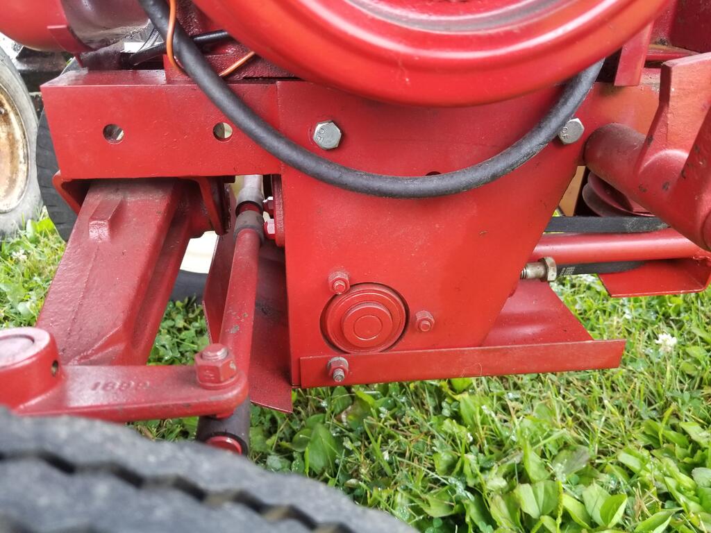

cafoose 3,883 #48 Posted May 6, 2024 (edited) 2 hours ago, Lane Ranger said: caboose: do you have the correct manual for your sickle bar mower? If not start with finding that first! I downloaded it and also found a hard copy for the SMS-50. I just checked my side plate setup. @Pullstart mentioned that your side plates are on the outside of the frame and mine only fit on the inside of the frame. I have a couple 63-64 round hood frames and the side plates I have will fit the outside of the frame on those round hoods. Also they have holes in the frame by the attachomatic that line up perfectly with the holes in my side plates. Therefore, I think my side plates are for a round hood and the actual sickle is for a 953/1054. These pictures were taken at the show in 2022. This looks exactly like my side plates. Edited May 7, 2024 by cafoose 2 Share this post Link to post Share on other sites

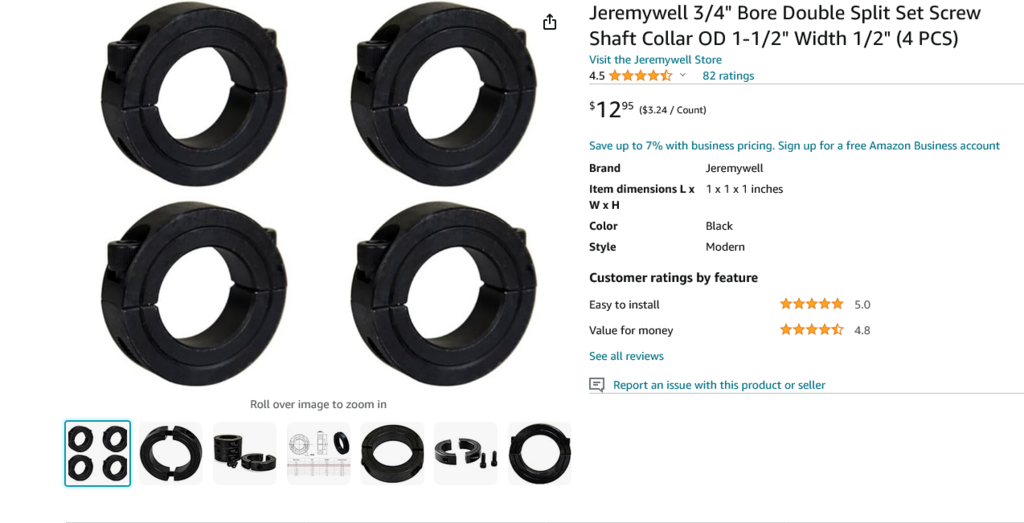

cafoose 3,883 #49 Posted May 7, 2024 Just put in an amazon order for these to mount the sickle bar. The shaft is 26" long Share this post Link to post Share on other sites
Lane Ranger 12,167 #50 Posted May 7, 2024 19 hours ago, cafoose said: I downloaded it and also found a hard copy for the SMS-50. I just checked my side plate setup. @Pullstart mentioned that your side plates are on the outside of the frame and mine only fit on the inside of the frame. I have a couple 63-64 round hood frames and the side plates I have will fit the outside of the frame on those round hoods. Also they have holes in the frame by the attachomatic that line up perfectly with the holes in my side plates. Therefore, I think my side plates are for a round hood and the actual sickle is for a 953/1054. These pictures were taken at the show in 2022. This looks exactly like my side plates. so you have a “married” set of sickle bar parts. Share this post Link to post Share on other sites
