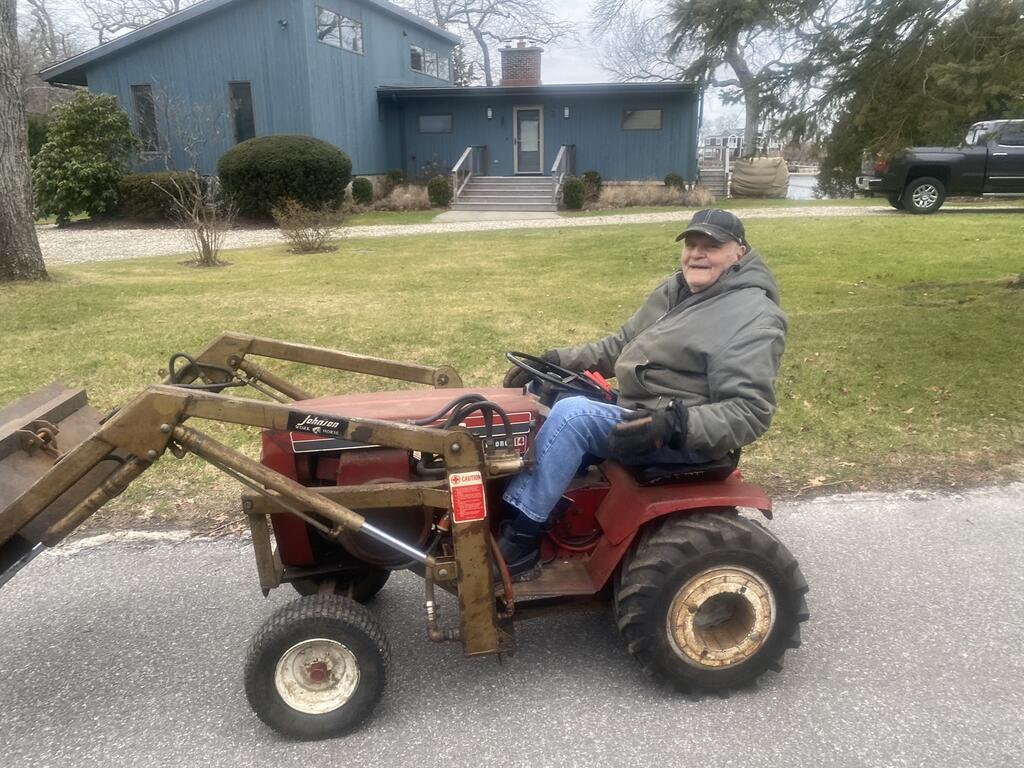

c-series don 9,649 #29 Posted January 22, 2023 (edited) Update: I fixed the charging problem, couple loose connections and a bad ground. Also a battery that would no longer take a charge. Then did a complete service on it. The electric clutch had a bad bearing, thanks to @daveoman1966 for posting the proper way to remove the clutch. I used this method and it came right off! I was doing this for the owner of the tractor who I think is well into his eighties and the original owner of this machine. I mentioned earlier that I wasn’t charging him anything, I am just very happy to be able to help him. He really loves his Wheel Horse! Upon reading this post Blasterdad contacted me to say he had a clutch, he informed me that there would be no charge since I was just helping this gentleman. He sent me the clutch and even covered the shipping cost! So a BIG SHOUTOUT to @Blasterdad to say I genuinely would like to thank you for making both myself and my buddy Bill happy! Thank you to all that chimed in to help. @ebinmaine @Bill D @953 nut @pfrederi @peter lena @Handy DonHe’s back up and running now and drove it home yesterday. Amazing how much joy these tractors bring all of us! Here he is on his way home. Edited January 22, 2023 by c-series don 6 5 Share this post Link to post Share on other sites
TractorEd 639 #30 Posted January 27, 2023 On 1/22/2023 at 6:38 PM, c-series don said: Amazing how much joy these tractors bring all of us! Here he is on his way home That is so darned awesome! Great! 1 2 Share this post Link to post Share on other sites
