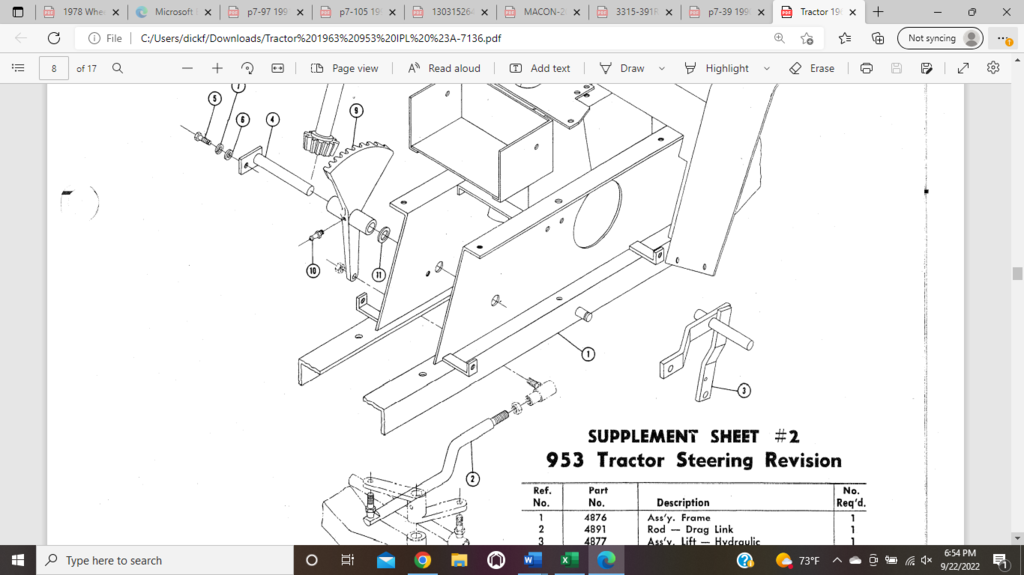

Ed Kennell 46,138 #1 Posted September 22, 2022 The steering on Fred needs attention. The wheel turns 1/4 turn and raises about 3/8" before engaging with the fan or worm gear. I assume there is a thrust bearing to prevent the shaft from lifting. I could use a drawing of the assembly and/or some advice on the best way to tighten up the steering. The spindles and tie rods are good. All the slop is in the upper shaft. @953 nut @gwest_ca Thanks 1 Share this post Link to post Share on other sites
gwest_ca-(File Mod) 12,259 #2 Posted September 22, 2022 This operator manual includes what you need 1 1 Share this post Link to post Share on other sites
953 nut 66,342 #3 Posted September 22, 2022 (edited) The fan gear is supported by a 3/4" (I think) rod, # 6, that is supported at both ends by the dash tower, sounds like one end may have come out. Edited September 22, 2022 by 953 nut Share this post Link to post Share on other sites
Ed Kennell 46,138 #4 Posted September 22, 2022 19 minutes ago, 953 nut said: The fan gear Thanks Richard, but mine has the worm gear and pin design. So I'll try adjusting the tube plug and the tapered pin as detailed in the manual Garry supplied. 1 Share this post Link to post Share on other sites
