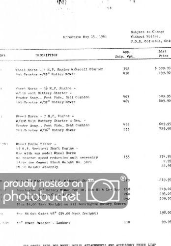

  10. Free
    Price list 1961.pdf
    Poor copy
    2 pages 354KB
    116 downloads

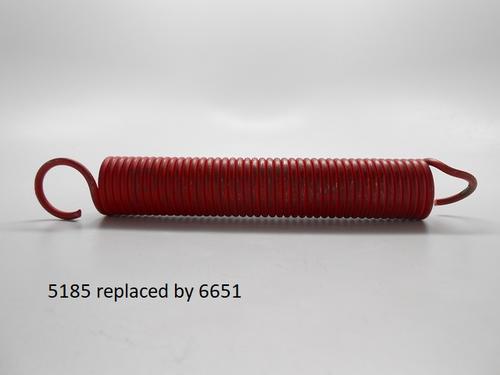

    5-3/4" between hooks
    .100" wire
    7/8" coil OD
    .675" coil ID
    4.350" coil length
    43-1/2 coils

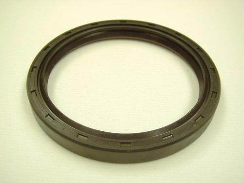

    Seal 112658 replaced by 56-3130.pdf
    Eaton 1100 selector shaft seal
    112658 replaced by 56-3130 and no longer available from Toro
    Eaton part number ER92999 replaced by SKF/Chicago Rawhide 7465
    Photo does not represent the 7465 seal

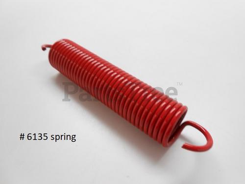

    6135 spring still available from Toro 05-06-18
    3-5/16" between hooks
    coil 5/8" diameter 2-3/8" long
     34 coils of .070" wire
